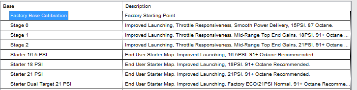

I got my K Tuner V2 today, locked my ECU to the unit, downloaded the software, registered, watch the setup videos a half dozen times, and now... I have no idea which map to install, so I'm looking for some guidance. Here are the facts:
- 2019 Sport Hatch 6 MT with just over 3,000 miles, no bolt ons or other performance mods yet. Just K Tuner.
- Daily driver, 20 minute mostly highway commute to and from work, minimal traffic most days
- I don't auto cross or do track days and probably never will. Not that interested
- I really just like the fun factor and having a bit more zip
Here is what is available I think?
11th Gen Honda Civic K Tuner Initial Install upload_2019-4-13_11-7-19
Any thoughts? Thanks for any input

As long as you're running 91+ octane, open up the dual 15/21 PSI starter tune. Factory boost in ECO, increased boost on normal mode.
Use the quick enables to remove rev hang and enable quick spool.
Then hop over into the quick adjustments and play with throttle response, turbo ramp, etc. to your taste. The Ktuner help files will tell you what each option does.
All of the above is perfectly safe on the 6MT as long as you don't abuse a cold motor. I use all the above settings in my daily commute (40 km, 80/20 highway/city).

If your not planning on going and adjusting any parameters make it simple and click stage 2.
That's what I have on my 2018 SPORT HB and its great. I relfashed it to that at 5k miles and I'm at 13k miles now, not a single problem.
Since then I've done some other mods so Im planning on doing one of the "end user" maps so I can adjust some stuff soon
I will give that a shot. I set up 3 buttons with Stage 1, Stage 2, and the Dual Target Eco 21. I just went for a test drive on Stage 1 and it was a very nice bump. I'll flash to Stage 2 and give that a try.. Woo hoo! the fun factor just went WAY up!
I'm not finding any tabs or menu items labeled "Quick Enables". I've clicked through everything, read the help files, and don't see anything labeled "Rev Hang" or "Quick Spool" even though I read about it in the help files. I have the "Quick Adjustments" tab, but not "Quick Enables". Any suggestions?
Did you flash the "stage" tunes or the "starter" tunes? Stage tunes are locked, you can't play with them as much as "starter" tunes.
I did the Dual Target Starter tune

Hmm. This may be an initial release as it's a 2019 ECU? @KTuner could confirm. Further support may come in an update.
They did. I emailed them, and they had an amazingly fast response. "You have a 19 model and your ECU was recently added with initial support with the included tunes. More features will be released later."
That's awesome customer service to respond that quickly. Thank you K Tuner!
