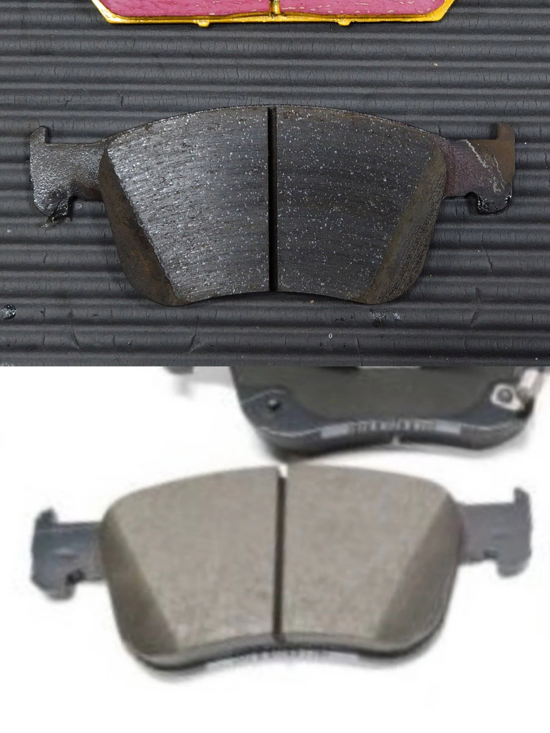

Thank you for checking. It almost looks like the 10th gen (top picture?) has slightly more pad material. I've also never seen a backing plate shaped like the pads in the bottom picture.
At any rate, it can't be too long before Hawk, Porterfield, etc. make pads for these cars.

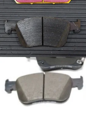

Thanks for the comparison picture.
In the past two months I’ve been searching for pads on and off. Recently I ran almost all the OE pads in my past two track days and it became urgent.
Good news, by some photo collage, I believe the 11 gen Si is using 18-20 2.0T Accord calipers. Going to inspect my brother’s 2.0 Accord tonight and gonna buy some Autozone pads to confirm the fitment.
For those who are interested, the part numbers I ran are 45022TVCA02, 45022TVCA51. Also rotor sizes match which is very promising.
Bad news, even with the part numbers, and assume it’s the right pad, there are no high performance pad option available.
End of year 2022 according to one major USA manufacturer.
No specific date from another global brand.
The end my buddy helped me find a manufacturer that is willing to work with me for a set of custom brake pads, essentially OE backplate with their compound.

Just took a look at my brother’s 2.0T Accord and confirmed the front and rear are the same exact calipers as 11th gen Si. I’m servicing my car and his car this weekend. So there will be clear pics. Maybe measurements if Seattle doesn’t rain. :)
And sure thing, I’m open to share the company. It is Carbotech. They can do custom pad applications and they are pretty good to work with.
