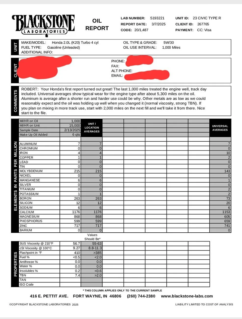

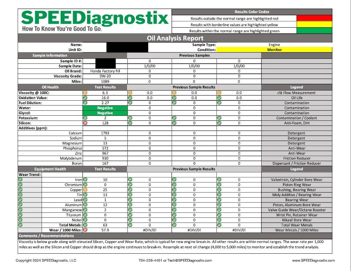

Just posted this over on the DE5 forums as well.
I got the result back for my break in oil change. I'm not a big fan of the factory fill for these cars given that it's sheared out of grade in 1k miles. Glad I didn't run it any longer, this might be the lowest viscosity I've seen on a UOA for the factory fill on the first oil change for these cars. Unnecessarily high level of calcium for a turbo DI engine as well.
No short trips, no track mileage, and the fuel dilution was somewhat high relative to what I've seen from others. Only run premium gas from Chevron, Shell, or 76 and I use Redline SL-1. Other cars in my family fleet have lower fuel dilution with worse driving habits.
I'm about to do my second oil change now that I'm at 3k miles and that will show results for Pennzoil Ultra Platinum 0W-20. Will likely be running PUP, Amsoil, Driven, or HPL from now on.
