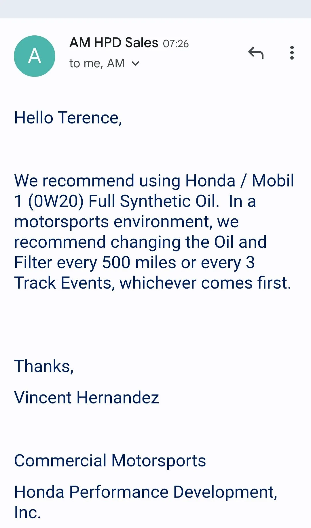

Honda calls for ACEA A5/B5 and API SN (according to the owners handbook in Australia at least) - I have yet to find a 0W30 oil which complies to both those standards. Do you have any suggestions?
I am still not convinced stepping up in viscosity is the solution on track unless you're seeing oil temps go way outside of the normal window and even then the better solution is to control the oil temp rather than simply going thicker.
Honda recommends 0w20
HPD also recommends 0w20 even in a motorsport application
I think I'll stick with the factory recommended. Afterall, Honda has built the engine with its intended viscosity in mind, one would assume the bearing clearances are optimised for the OEM viscosity, and they're willing to put a 5 year unlimited km warranty if anything was to go wrong (again, here in Australia at least) so all the evidence is there to support sticking with the OEM factory fill viscosity.
