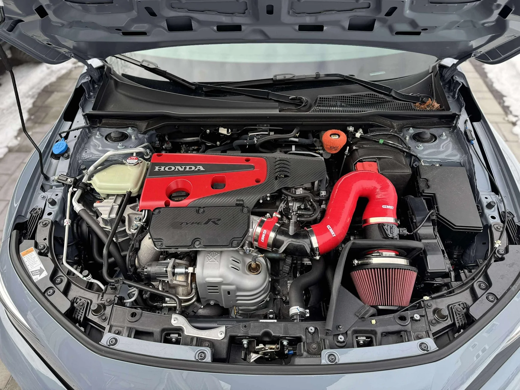

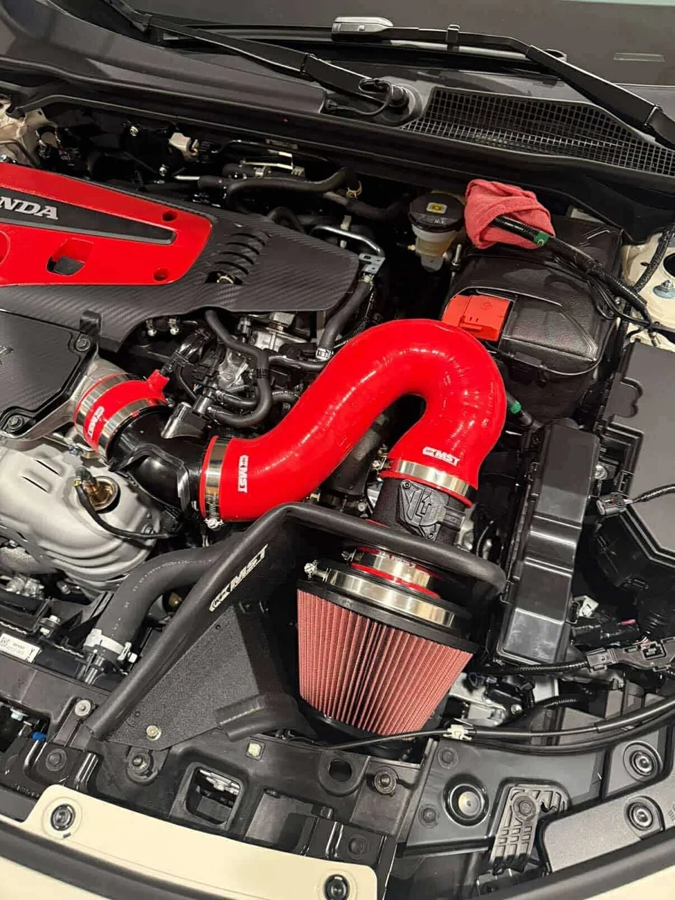

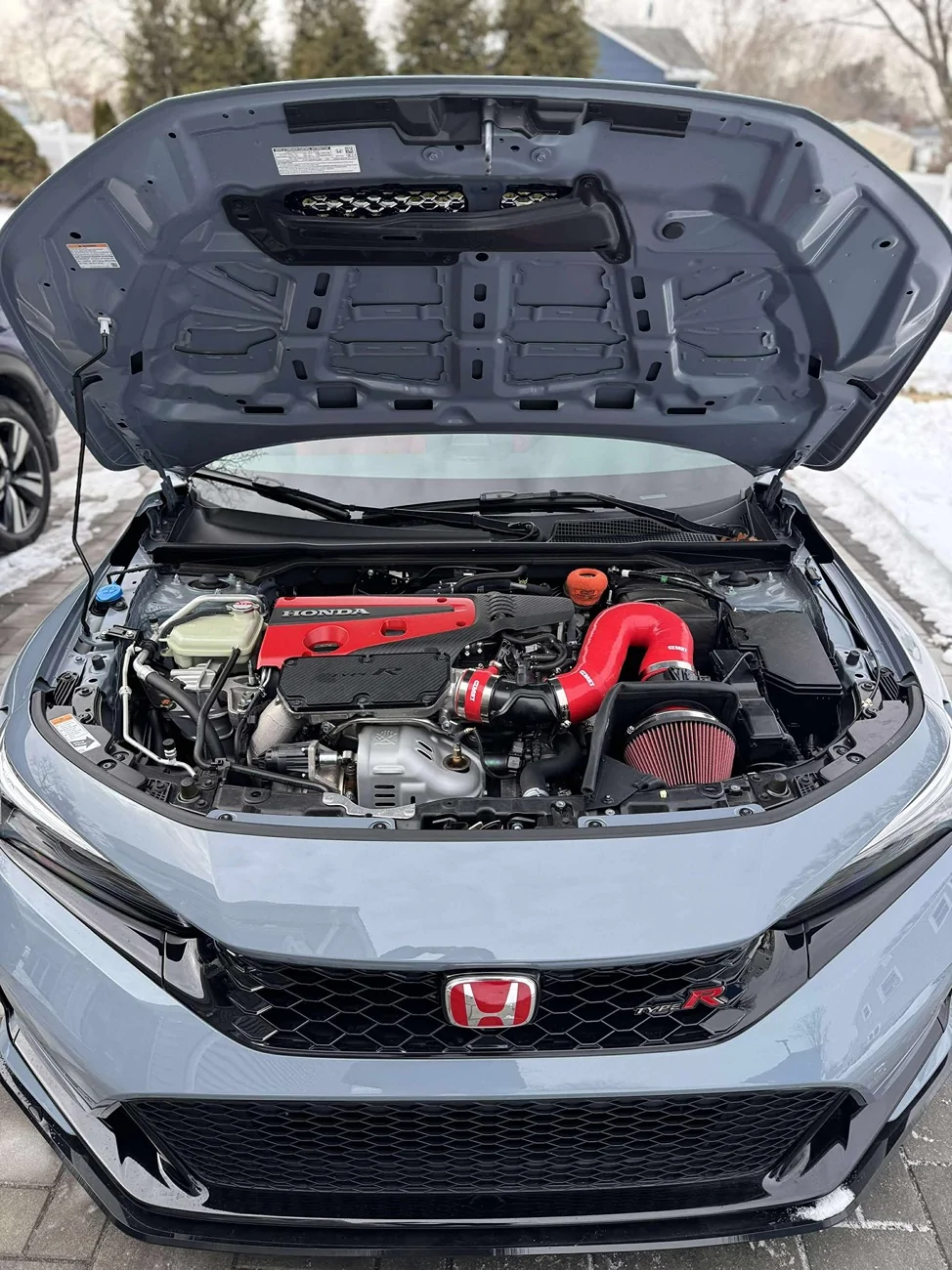

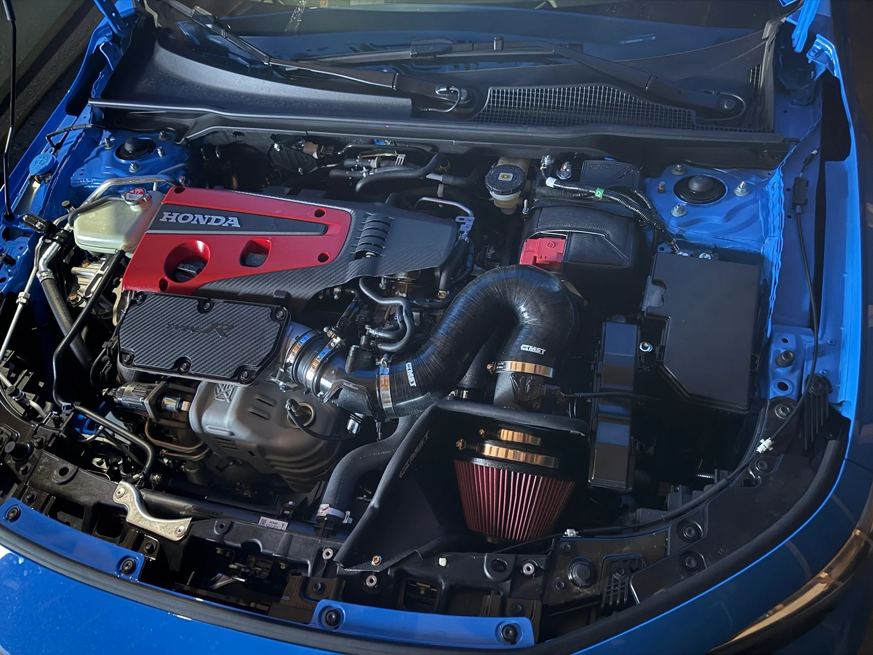

@gotham put it in ASAP lol.. my videos arent great and my car is dirty.. sue me. Super easy install IMO.

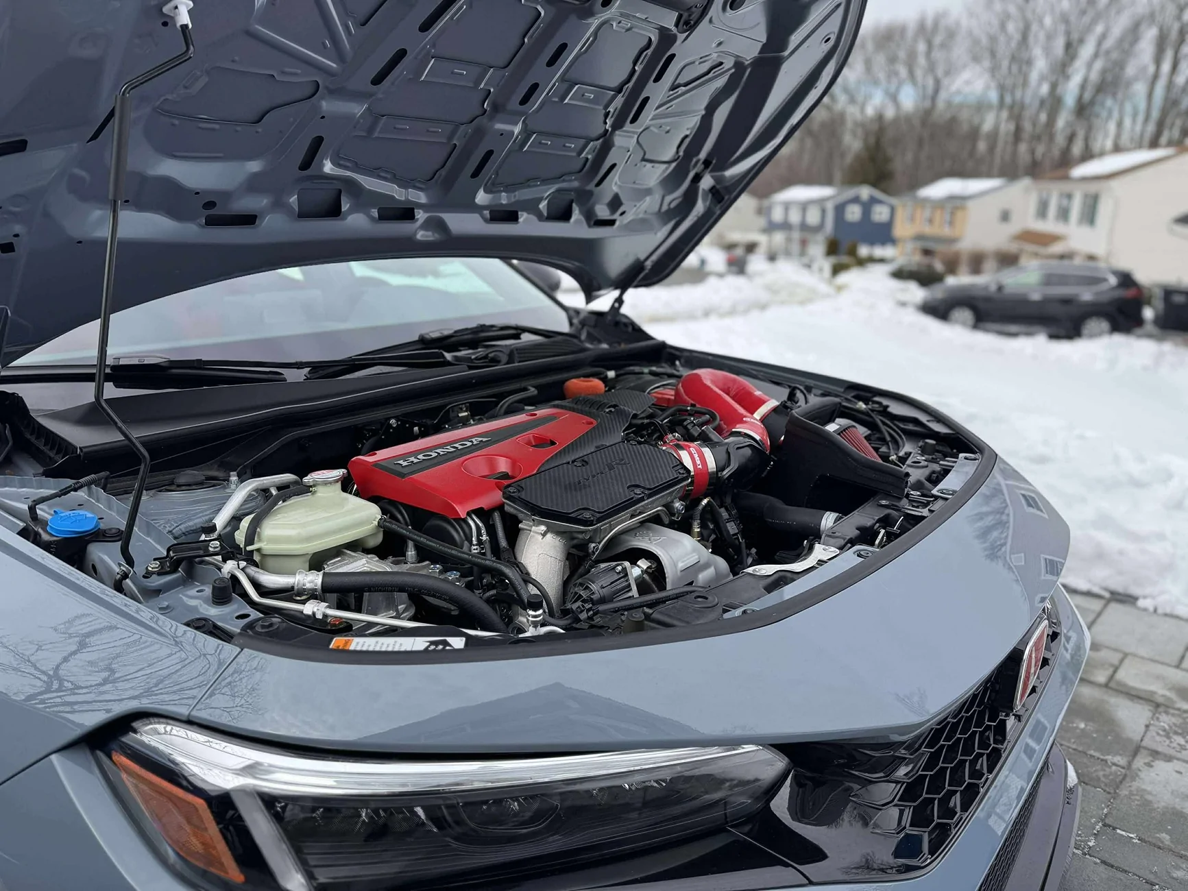

PRL vs MST for sound reference...Different tone for sure. I will have a customer do the fuel trims for you!

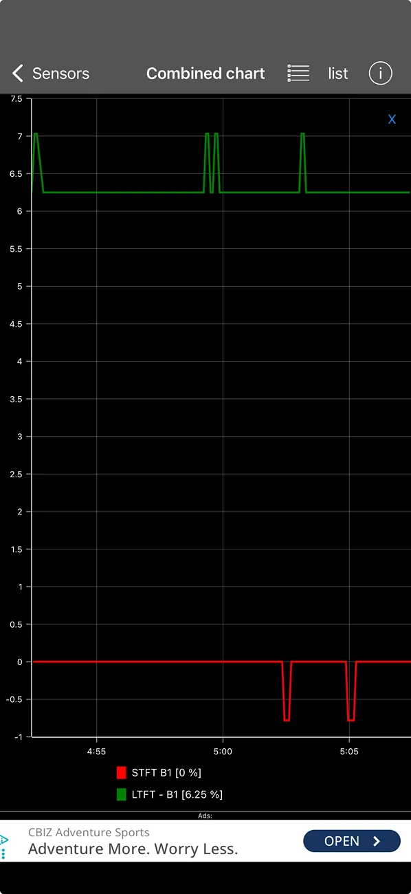

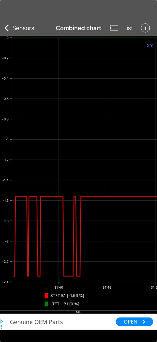

I don’t know why I didn’t drive it more first.. I replaced the other coupler this morning and drove it less than a mile to the gas station to get a free shitty touchless car wash.. need to drive it more still but here’s where I’m at after a spirited drive.. I’m still getting a strange hesitation at closed throttle after spirited driving (dropping from 90mph-80 around 3200 rpm no brakes).. seemed to change range (was around 2700rpm) after replacing the other coupler. Need more time driving it now obviously
EDIT: I know why i did it now.. misfire counts i really wanted to check misfire counts lol - i had 0 after driving it.. quadruple checked that when i saw the new LTFT..
