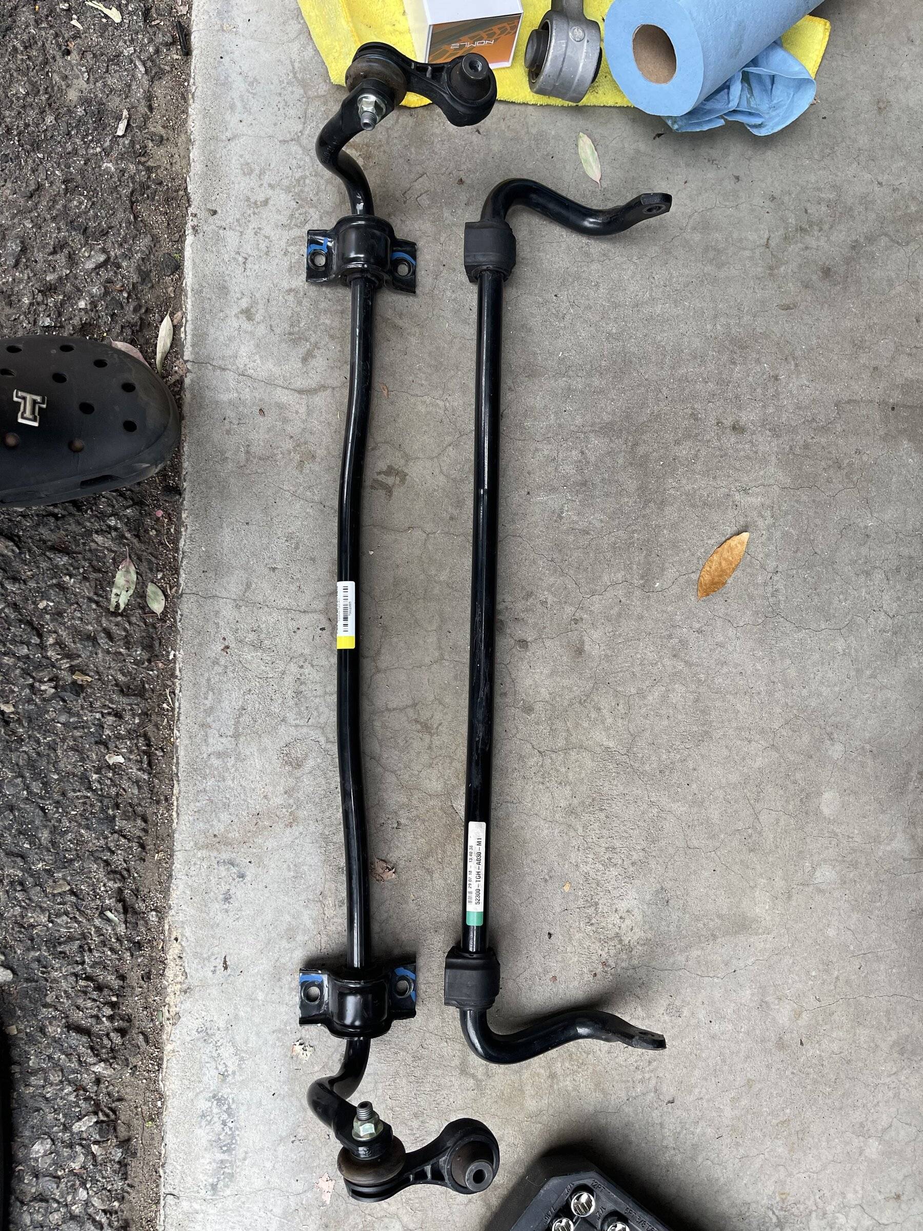

?? Yeah, makes sense.

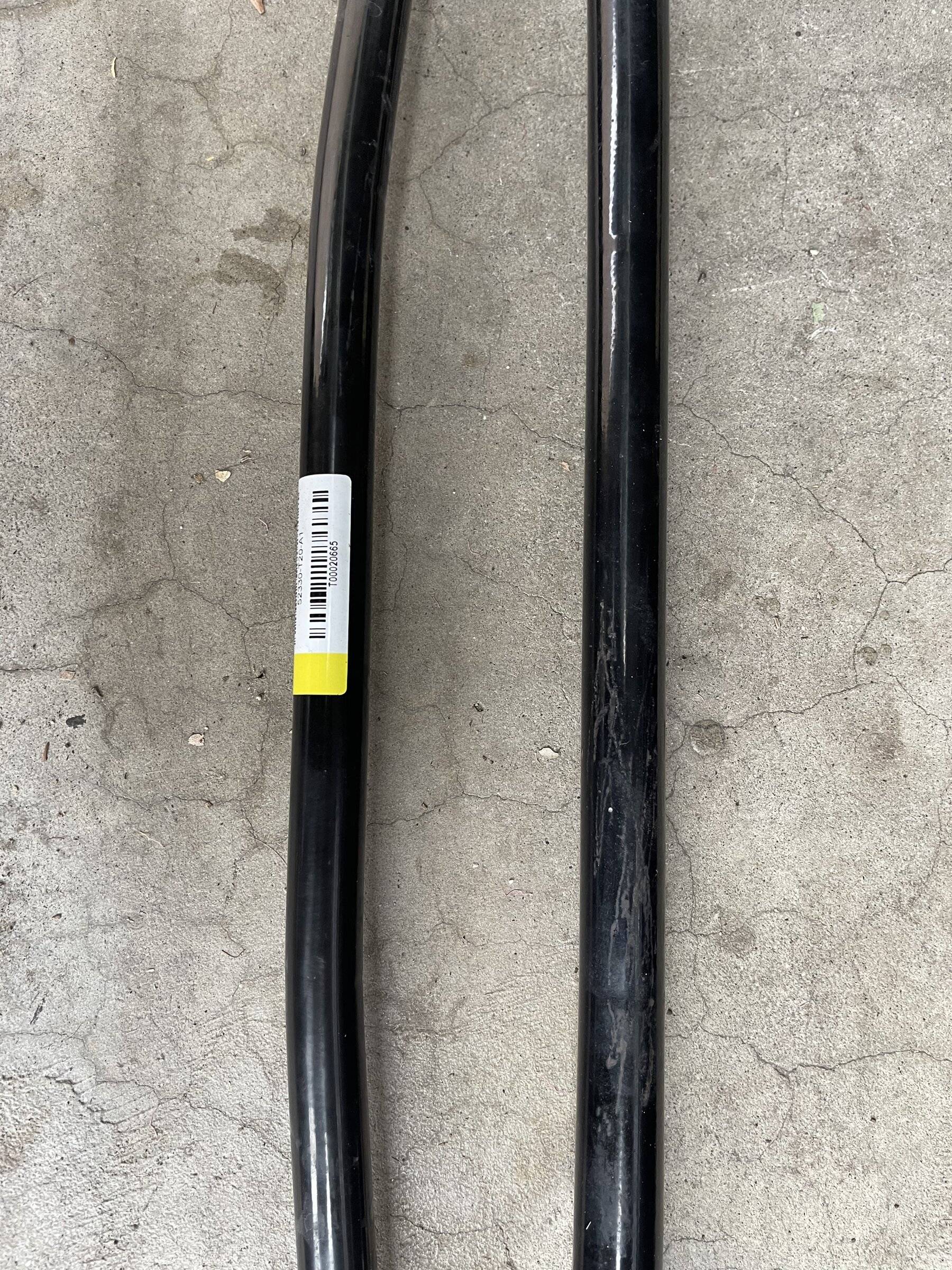

and….??‍♂….prob costs way less than a progress 22mm, and the 1.5mm loss vs the CTR bar will be too minimal to notice.
Picked up the progress 22mm rear sway bar and mounted right up. No issues.

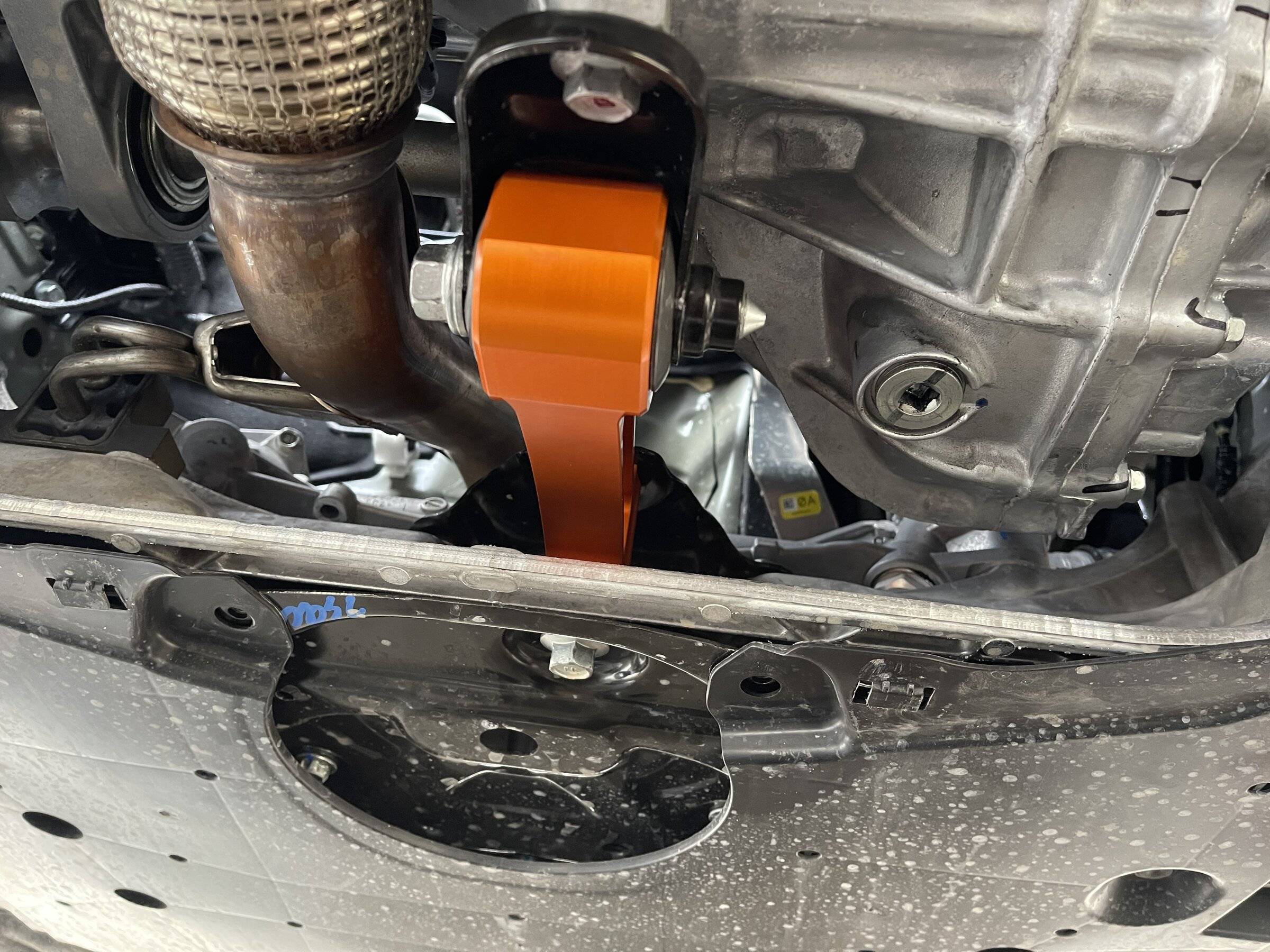

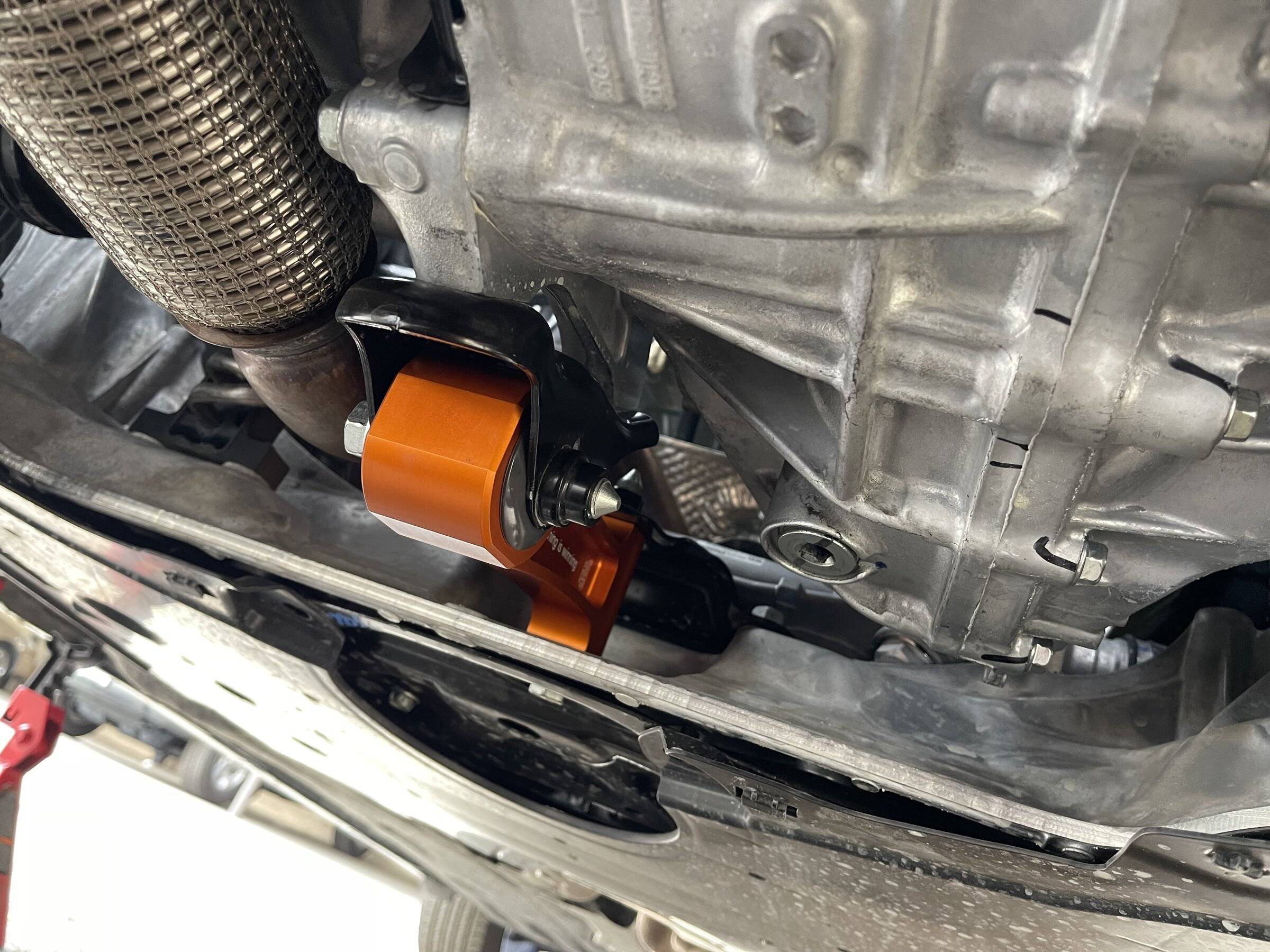

27 won rmm fit right in and CTR sway bar fits ? car is very very responsive now, I can actually tell where the rear end is now in a corner. NVH isn’t terrible with the motor mount, after the 1000 miles it should be barely noticeable. Next is HKS coilovers and Michelin PS4s tires all around

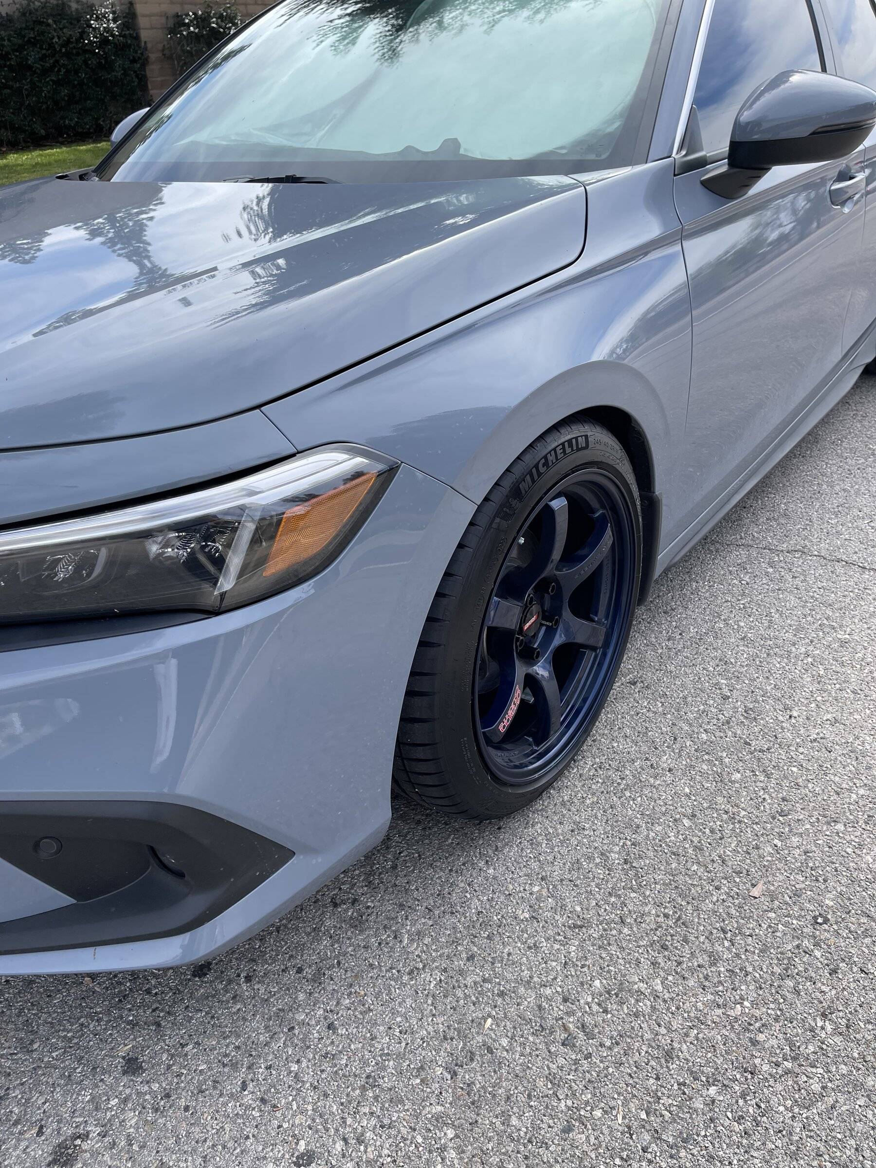

245/40/18 Pilot Sport 4s on ? and screw fedex Coilovers should have been here Thursday, but hopefully today!
Did you use the CTR endlinks or the stock ones?
nice fitment, any springs or suspension mod? did you mention something the endlink did you use the accord endlinks? can you give me some input regarding the 27 RMM? how about the NVH?
In that picture it's on H&R springs, but Im installing my coilovers this weekend. Yeah for the rear sway bar endlinks I used the metal endlinks from an accord over the cheap stock ones. rear motor mount aint bad, after break in the only NVH i have is when taking off from a dead stop, other than that I forget its there.

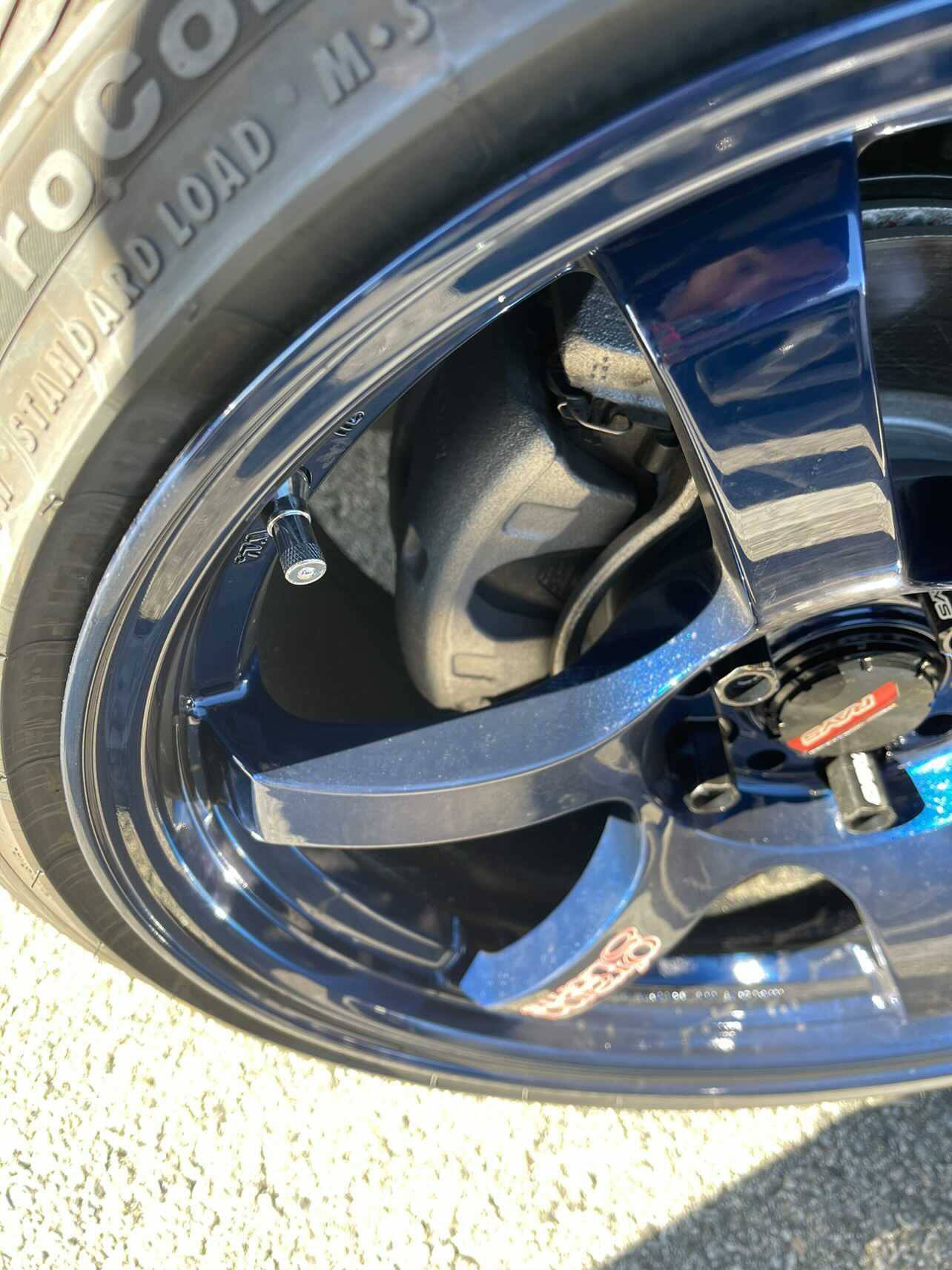

18x9.5 on the stock tires? If so, is the tire stretch crazy, or not bad at all?
yeah I was on the stock goodyears then. It was a SMALL stretch if they had a square sidewall I dont think it would have been stretched.
