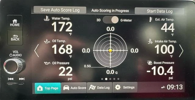

I am still breaking the FL5 in but can already tell that I have some concerns with its ability to dissipate heat. Past experience (particularly with rotaries), shifted my focus to look at cooling efficiency on every car that I have owned to ensure that priority number one should be thermal efficiency and heat dissipation.
While driving conservatively , I do not like how the IAT seems to fluctuate between 20-40 degrees F above ambient when the vehicle is in motion below 50 MPH. When stopped at a traffic light and after 30 seconds, IAT jumps well over 50 degrees F over ambient.
11th Gen Honda Civic New to the Forum: FL5 Added to the Lineup image0 (2)
There are quite a few other threads where individuals have posted concerns regarding heat buildup. Having multiple parallel systems reliant on the coolant complicates things.

Not saying that the FL5 has overheating issues. Just that I can see that some components may warrant upgrading to help shed heat in the most optimal manner.
One can see variants in oil & coolant temps when stabilized during driving and how the they go up in stop & go traffic. Temps don’t reach the danger zone in that case but it gives one a better understanding how the stock configuration attempts to expel heat.

I'm looking and learning...The FL5 now has a little over 300 miles and is still being broken in gradually. The front mount turbo is new to me. Cool for upgrading but not for keeping components under the hood actually cool.
Stock wise, IAT numbers are way too high over ambient. Even when cruising above 20 MPH, I am seeing IAT at the output of the filter box averaging over 45 degrees F higher. One then has to factor in the turbo inlet tube heatsink running directly over the turbocharger assembly that makes intake air even hotter before ultimately being compressed to produce boost and even higher air temperatures. This situation forces the intercooler to have to work in overdrive to expel heat that then transfers to the radiator and ultimately into the sealed up engine bay.
My thoughts on the first upgrade to my FL5 have changed. No dumping cash on an upgraded intercooler or radiator are necessary until IAT numbers can be significantly lowered and controlled. The stock intercooler may actually function well but constantly pushing it into overdrive because IAT is too high may not be giving it a fair shake.
