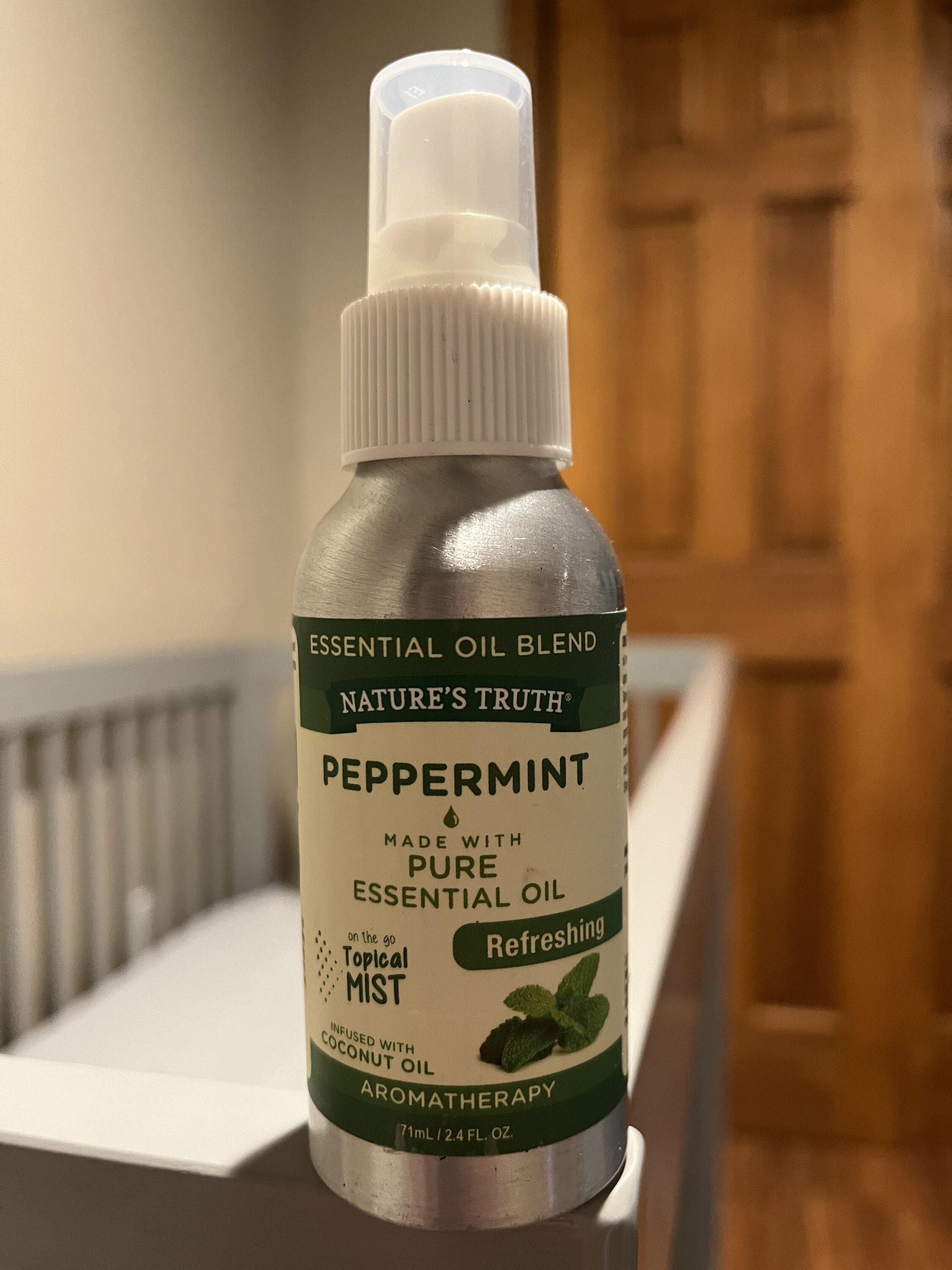

I’ll check into getting the spray. Is it something that’s available on Amazon?
I’ll verify tomorrow the one I actually have to make sure I’m getting you the right info. The one that looks similar says it has coconut oil blended with it, but I’m fairly certain mine says 100% oil. I usually spray roughly once a month in the colder months.

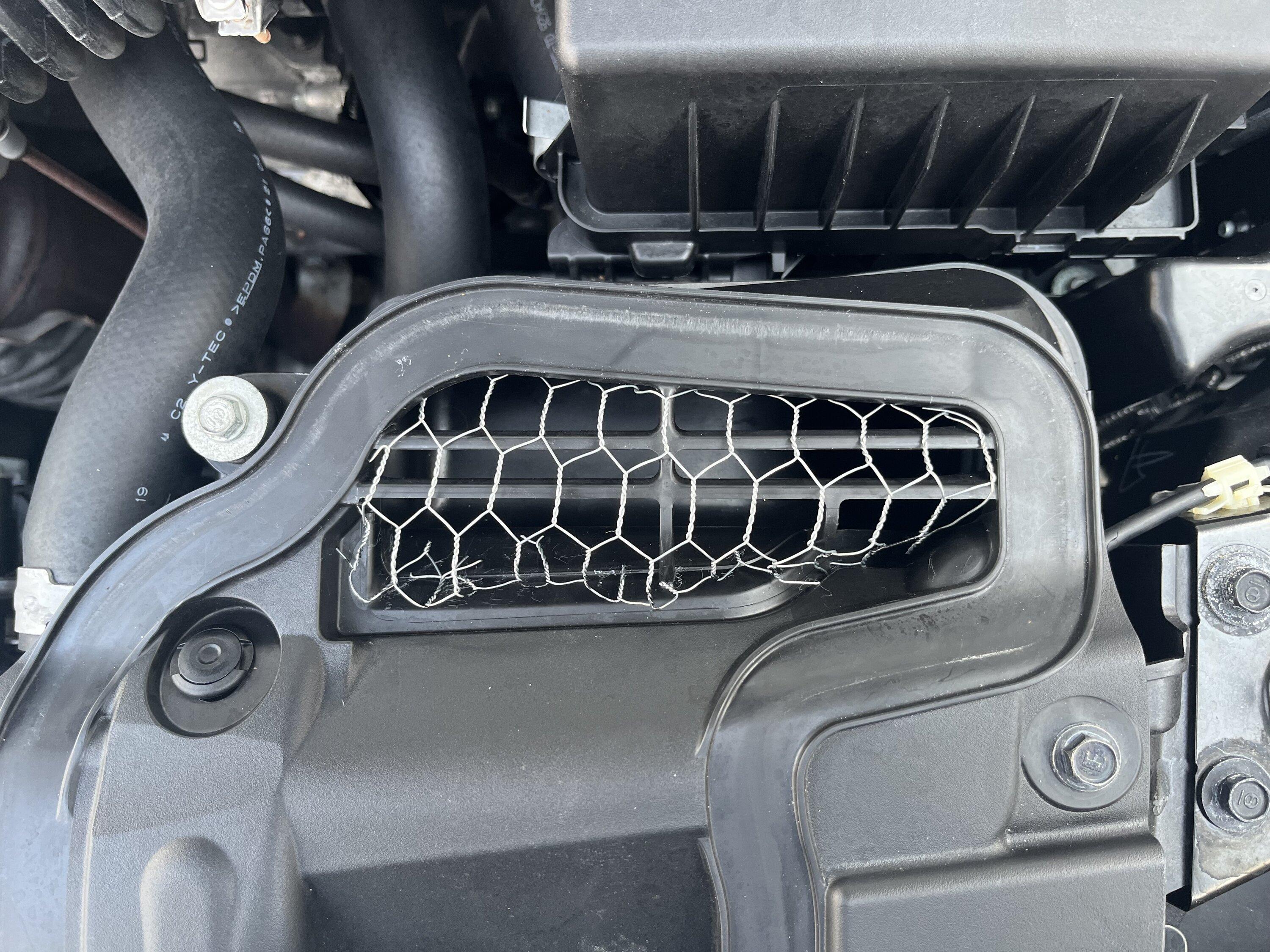

For those that are interested - this is what I did today. Let's see if it keeps the furry little bastards out of my air box. Now, how to keep them out of my cabin air filter area???

Here’s the one I’ve been using successfully. Turns out it does have some coconut oil in there, but that may actually help with keeping it to stick to the surface a little bit perhaps. ??‍♂

No problem at all man, just hope it helps! Fortunately I’ve only found nut remnants on top of my battery blanket & around the oil fill area ? been dousing it ever since lol I tried dryer sheets & moth balls before also in my Jeep. Dryer sheets don’t last & moth ball smell will seep into the cabin. Ugh it’s disgusting. Potentially harmful from what I’ve “read”.

One other cars, I've had the luck with placing chicken wire screen (1/4" spacing) over the intake, which I bought at Home Depot. I also covered the trunk cabin air exits after finding a nest inside the trunk.
The screen wire is fine, so minimal affect on airflow. Also galvanized against corrosion.
On 11th gen Civics, I would sandwich the screen under the hood rubber seal, at the airbox entrance. I found hickory nuts stashed with the moth balls I once used, so moth balls proved useless and stinky.
