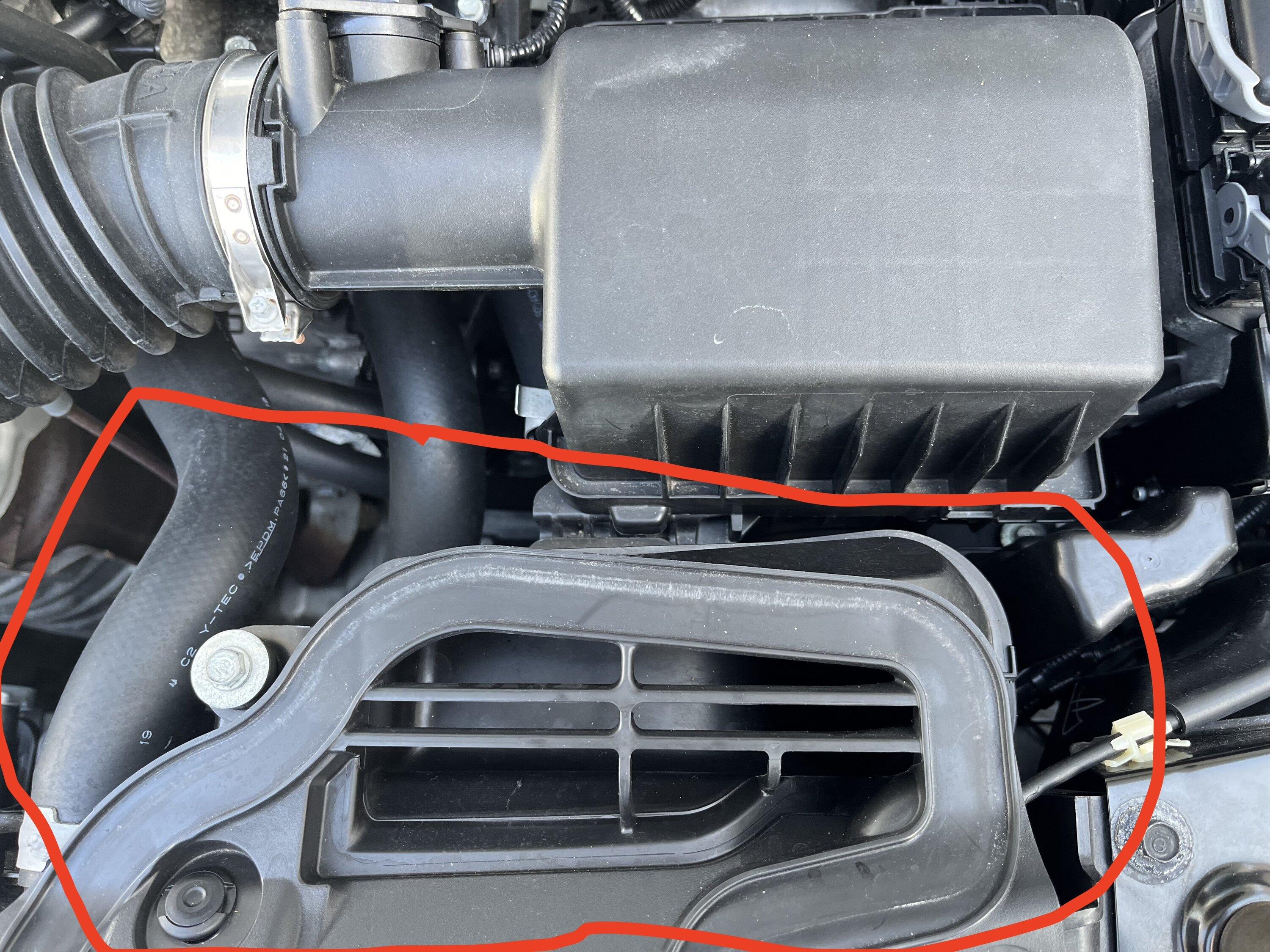

My original question was - where is the first entry point for the air before it gets to the air filter box. In the attached picture am I correct that this is what I'm looking for?. If so I want to try putting a piece of chicken wire to cover this. Am I correct and if so do you think it would help in keeping the acorns ( and the critters) out?

Yes, some wire screen wedged in that intake should help. We had a Z4M Coupe show up at Watkins Glen for a BMW track event once. Guy drove all the way from Ontario, Canada. During his first session, he said the car felt underpowered. Some other guys started troubleshooting with him, and when they opened the airbox, SIX red squirrel pups scrambled out, hiding in various spots in the engine bay and grill! Took them another 30 minutes to grab all of the squirrels out of the engine bay.

LOL!! At least my find wasn't alive! Thanks for the confirmation. I'm going to give it a try.
