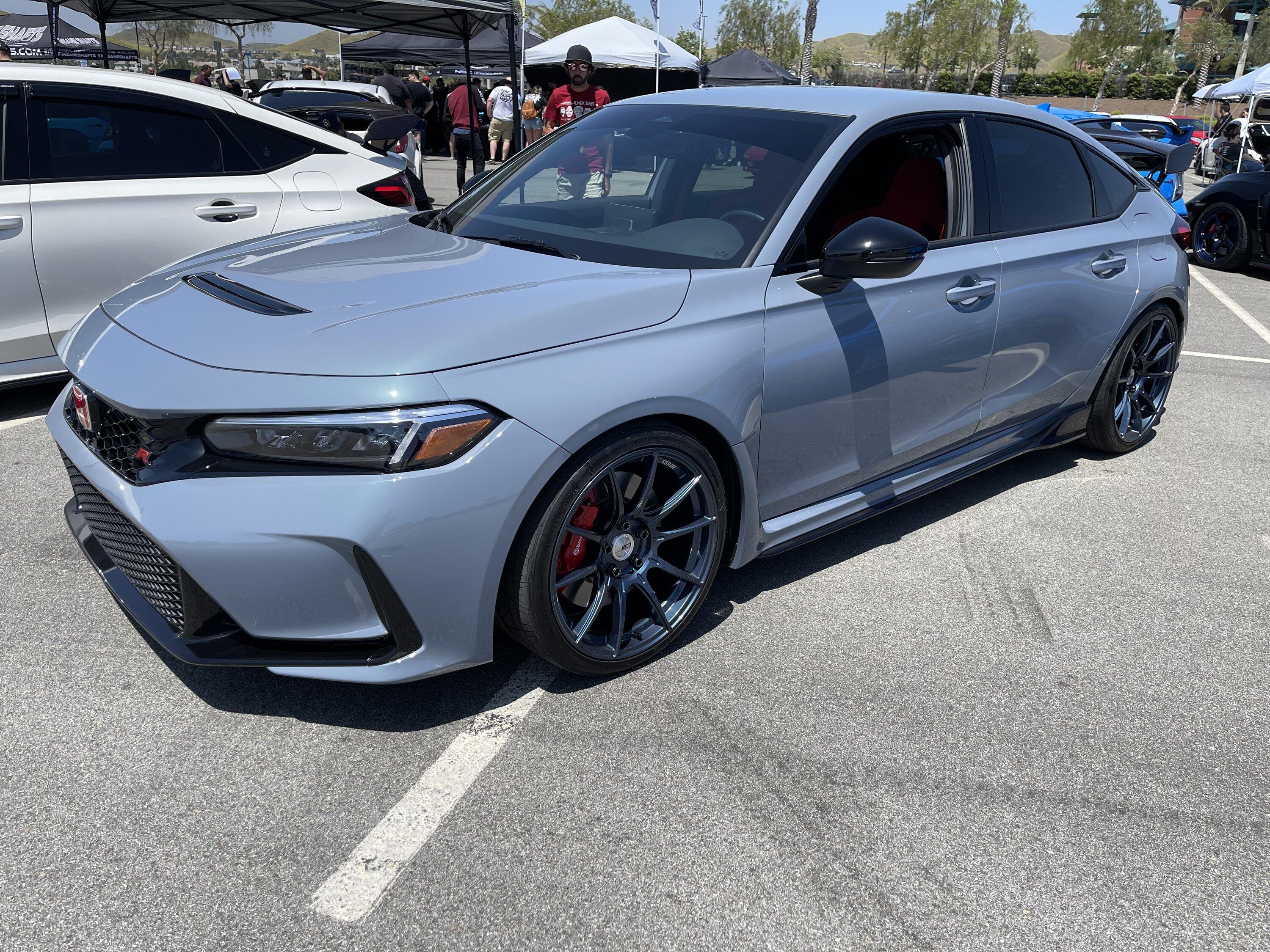

Yes I run these exact wheels:thumbsup: you will need aftermarket lugs the factory ones will not work, I used Project Kic’s on mine.
11th Gen Honda Civic Just bought a new set of SSR GTX01 19x9.5 et38, will factory nuts work? IMG_5864

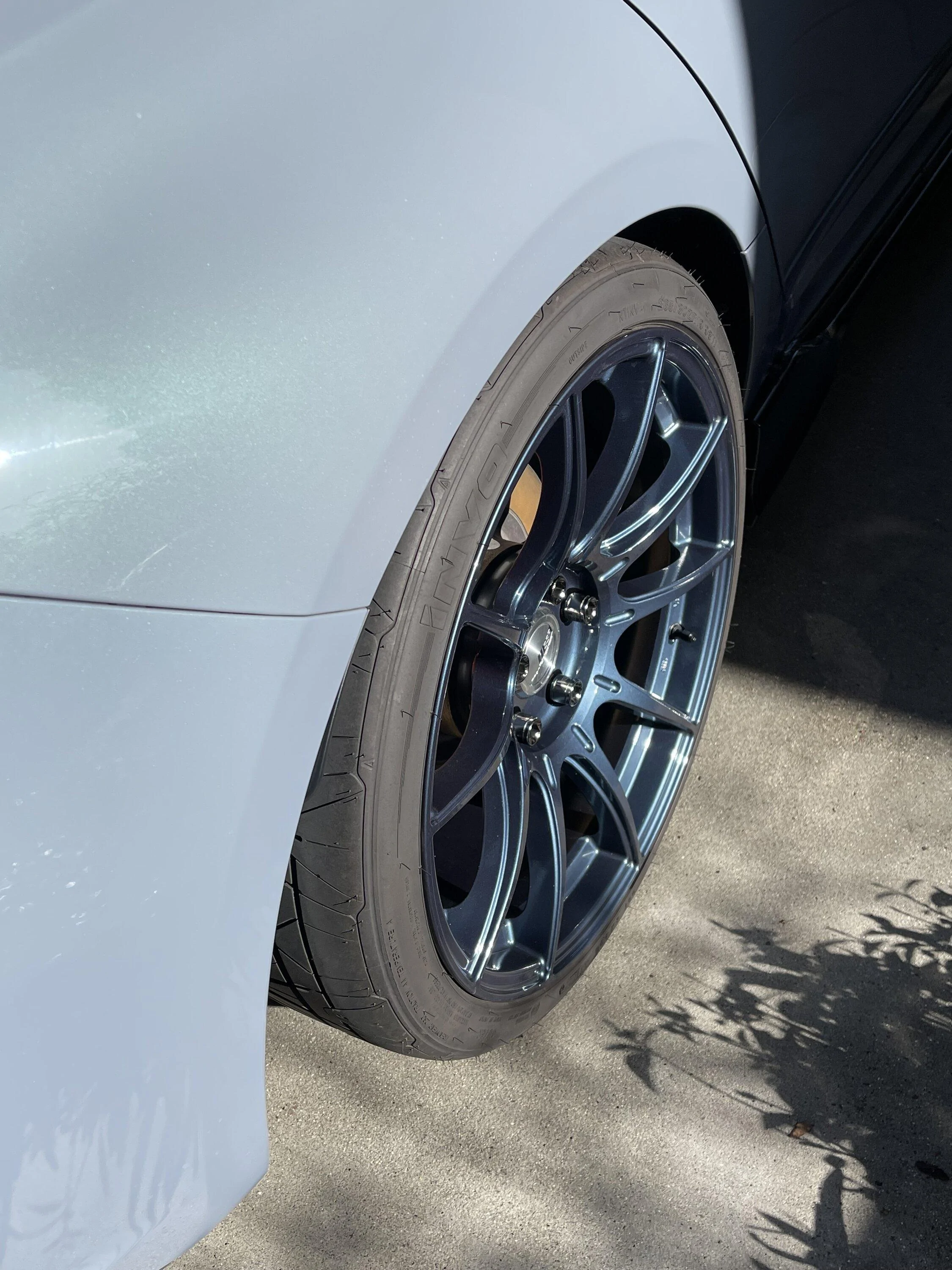

11th Gen Honda Civic Just bought a new set of SSR GTX01 19x9.5 et38, will factory nuts work? IMG_6127

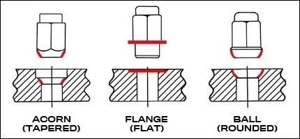

Do not use factory lugs on aftermarket wheels, the seat on OEM wheels and lugs are a ball shape, and aftermarket wheels are generally coned/tapered. You'll mess up your wheels if you do. There are tons of different lugs to use. Should be a 14x1.5 thread for the Type R. Project Kic is really good, they make sets that will help prevent any marring on your wheels.
