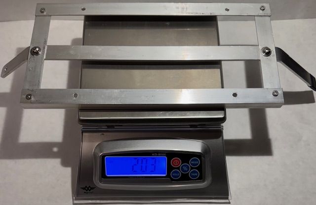

Nice fab work, I like the bushing to dampen vibration and hold it in place. How well does it work? Is the unbolted end resting against the the black trim pocket?

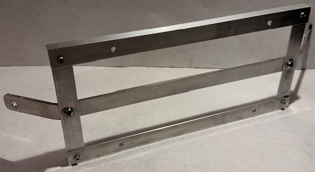

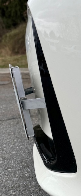

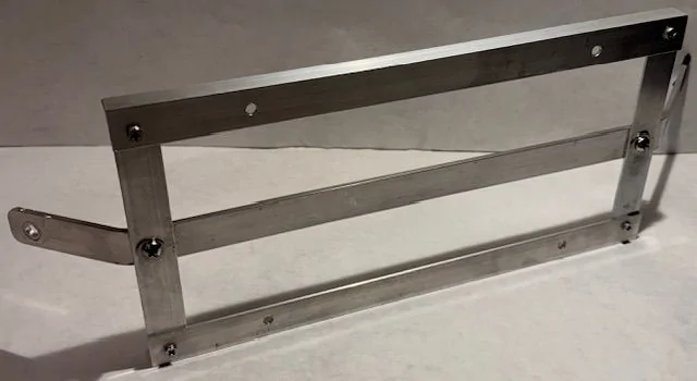

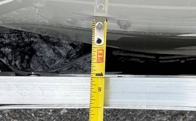

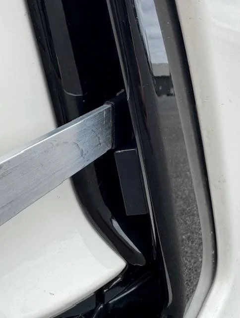

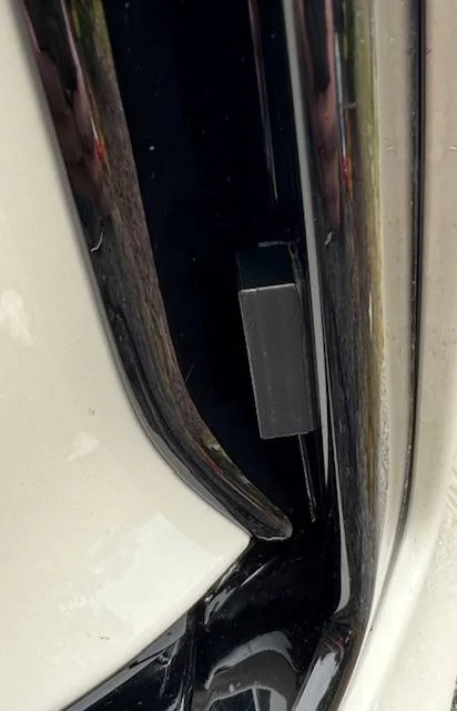

Thanks...It is working out very well. I covered the unbolted end of the bar with electrical tape and it held in place under tension after the bracket was installed. To give it better support from slipping down while driving and bouncing around, I used black Lego pieces wrapped with electrical tape around the sides and then secured the bottom and half of the back side with body side molding tape to function as a stop (MacGyver it up).

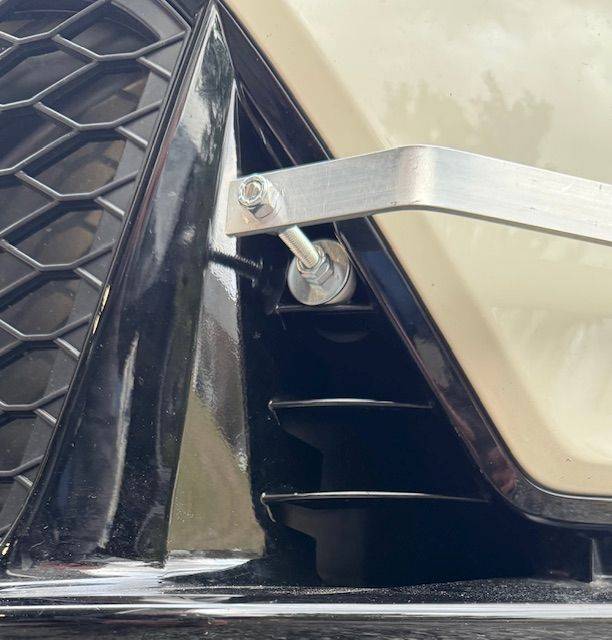

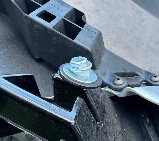

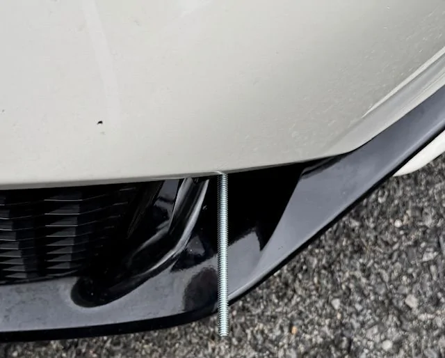

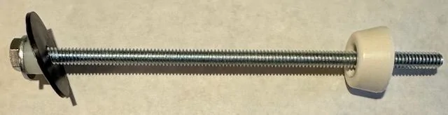

Two things I would be concerned about long term is contact wear on the brake duct trim and the trim pocket (dust, dirt), and the all-thread fasteners vibrating loose. It looks like nyloc nuts, maybe you put some thread locker on it too.
I think contact wear over time on the brake duct trim should be minimal. There is a rubber washer on the back side where the front uses a modified 1" screw-on rubber foot that sticks out a little from the hole in the black mesh. A metal washer was then installed, tightened snugly in place with a nut and then double nutted to prevent spinout. Once secured, only rubber components come into contact with the black mesh.
For the threaded rod, I also double nutted the other side where it functions as a stop for the bracket when attached. A nylon lock nut secures the bracket to the threaded rod. When installed, the front license plate bracket is firmly attached and did not shift even after several hours of driving at various speeds and road conditions today.

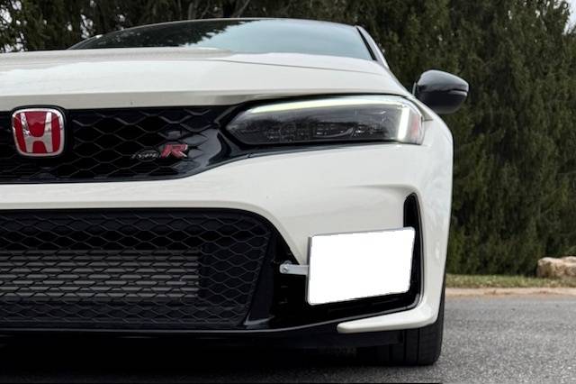

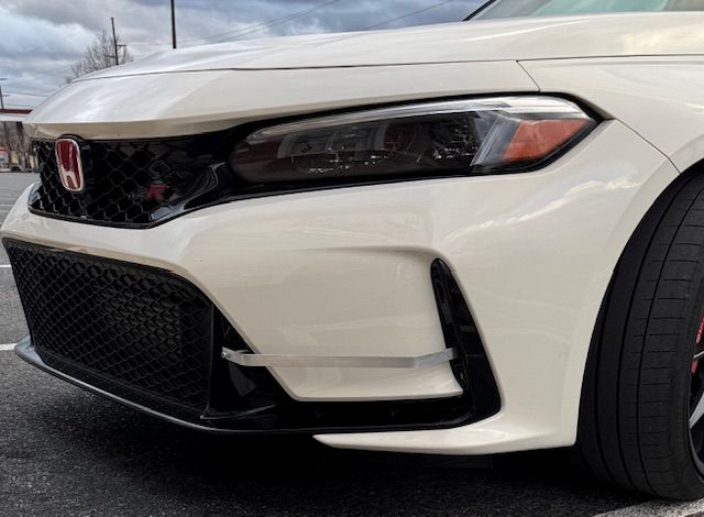

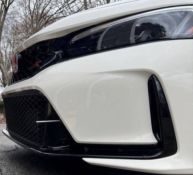

Now that it works, the next step will be to paint it all black and clean up the bolt connection area so it does not look like threaded rod sticking out. Here are some other PICs:
11th Gen Honda Civic Offset Front License Plate Bracket (No Drill) IMG_1268
11th Gen Honda Civic Offset Front License Plate Bracket (No Drill) IMG_1270
11th Gen Honda Civic Offset Front License Plate Bracket (No Drill) IMG_1262
11th Gen Honda Civic Offset Front License Plate Bracket (No Drill) IMG_1269

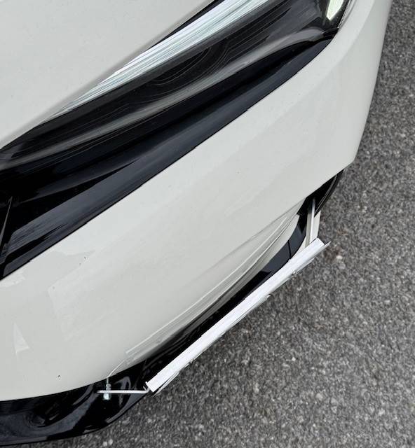

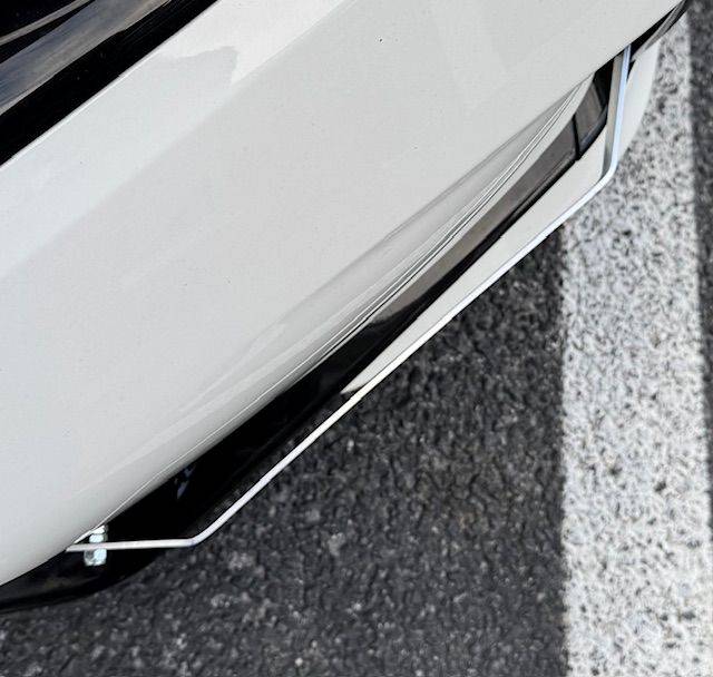

I removed the front bumper this weekend. Here is a PIC from the other side:
