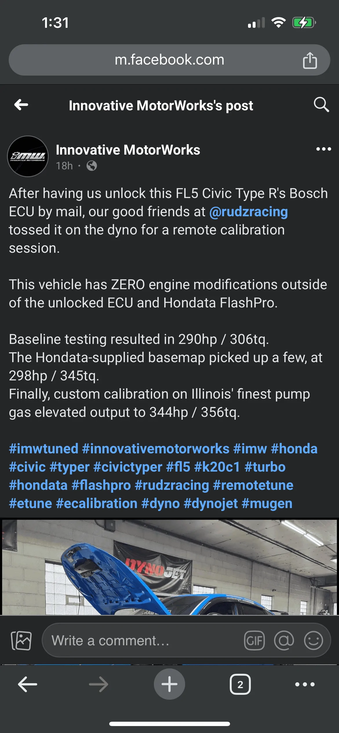

I disagree, based on this from IMW. Custom tune on an entirely stock car was quite the change from the OTS Hondata tune.
I think he was referring to a OTS map from one of the vendors not the Hondata one.

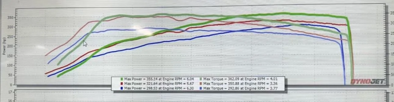

This was mine comparing stock vs Hondata vs my custom tune. Only mod was a intercooler rest of the car was stock.
Remember that all OTS tunes are not created equally. :) The Hondata base maps are extremely conservative and... lacking. However our TSP Stage 1 tune has been tested on various FL5s and then custom tuned by Derek afterwards (same day, same dyno) and the difference is typically in the single digits.
Agree the Hondata maps leave a lot on the table.
