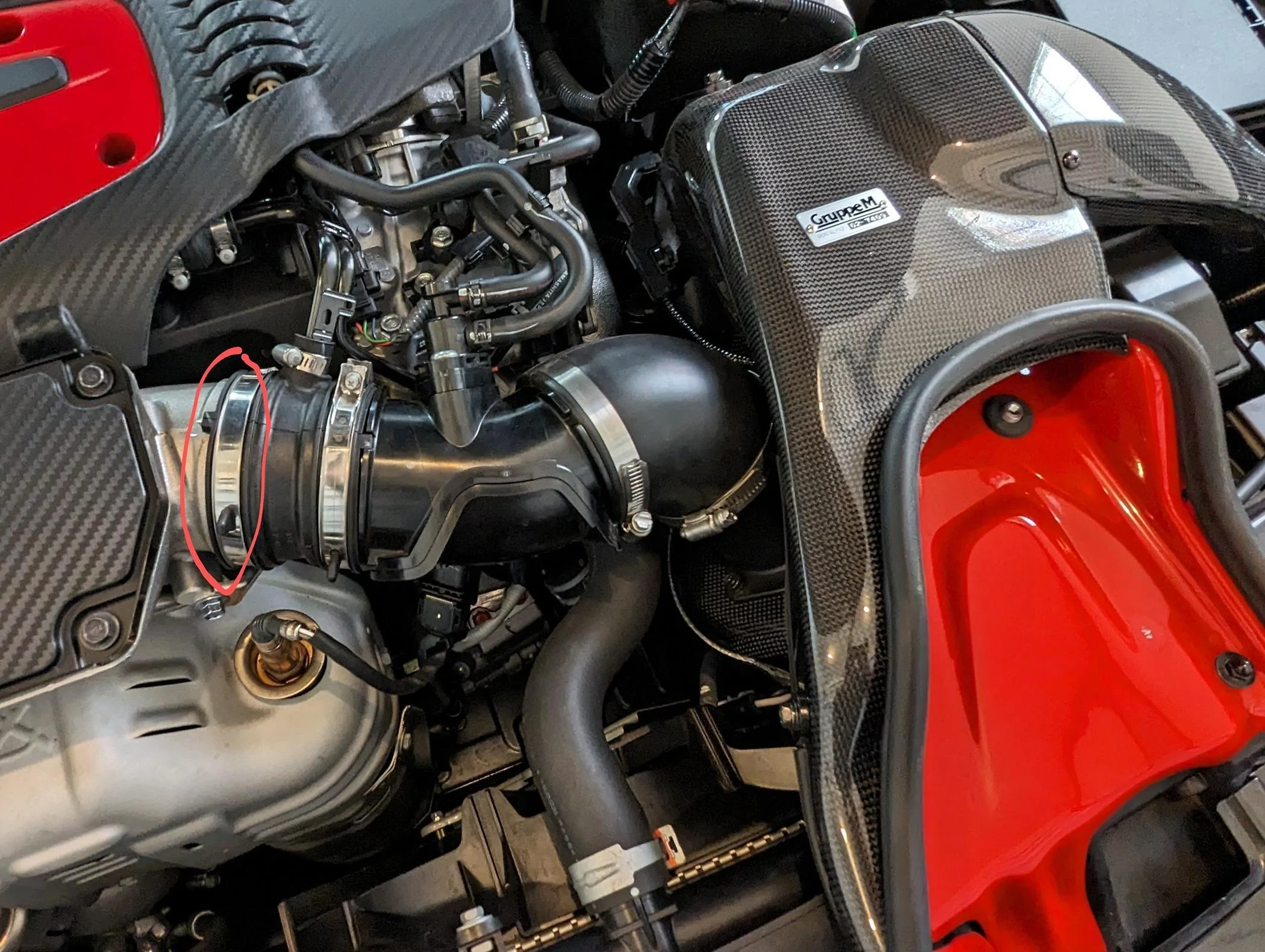

Just had this code pop up today and only mod I've done that might have triggered it is an intake...gruppeM. I've had the intake on for 3 weeks then allll of a sudden I get this lol.
Cleared the code and will do datalogs and see if my tuner can see anything. Love these kind of codes.
Edit:
Last night I got a chance to check over everything. One coupler (factory one) was slight angled wrong. I can't believe that was the cause, but, today...idle is perfect and no CELs. I'll keep an eye on it...but try checking simple stuff like that if you run into the issue again.

Edit:
Nice. If you get a chance, can you post a picture of that specific coupler?
