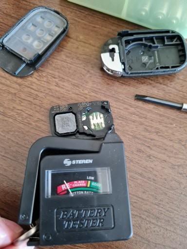

I was experimenting same issue; now using the other remote control (second one provided with the car) and looks that issue is not happening again.
The battery tester indicates that battery from initial control in use needs to be replaced, it should be noticed in the user's manual to avoid any concern on the car body control module function (BCM).
If issue returns by other cause I'll let you know.
