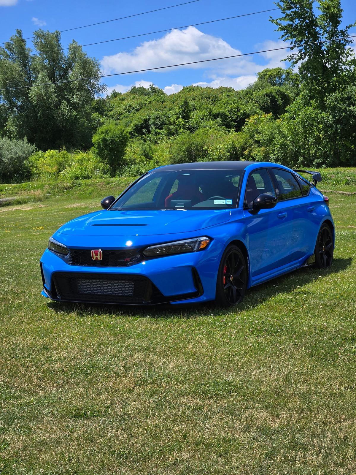

I appreciate the feedback so far. I feel like their supervisor is just telling them to tell me it's normal to have some debris as a means to shut me up. Obviously, that hasn't worked. I know I have high standards, but what I am seeing is not acceptable. I knew I wasn't wrong. Some pieces definitely have no debris, so they were obviously capable of doing it. I may ask for most of my money back and decide to deal with it knowing my paint is at least protected or take it somewhere else.
Oh, my car is Boost Blue.
