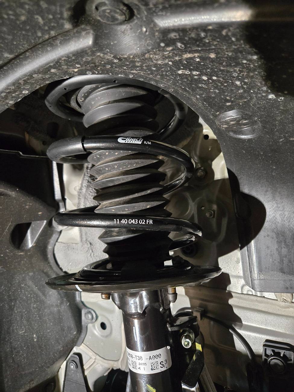

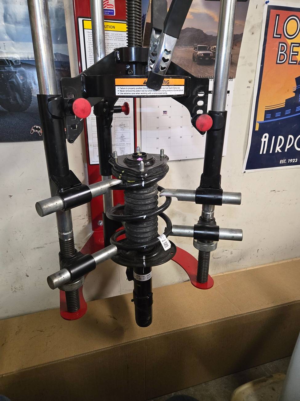

Ok, so I'm a huge fan of Eibach. I've had their shocks and springs on several vehicles. 1998 civic with pro kit, rides like a dream. 2024 civic EXL hatch pro kit, rides like a dream, my 100 series land cruiser I run their front shocks, amazing. BUT...

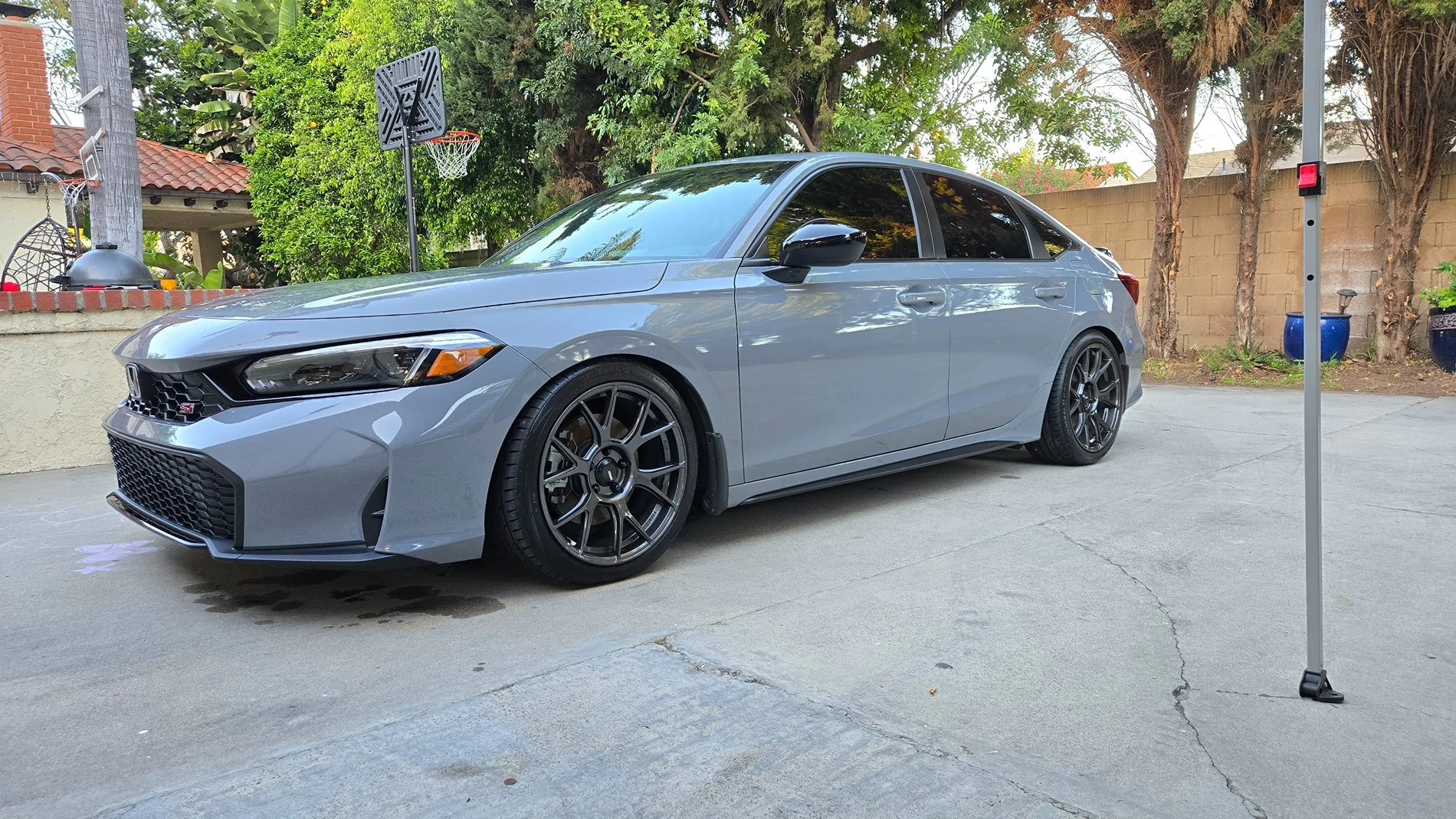

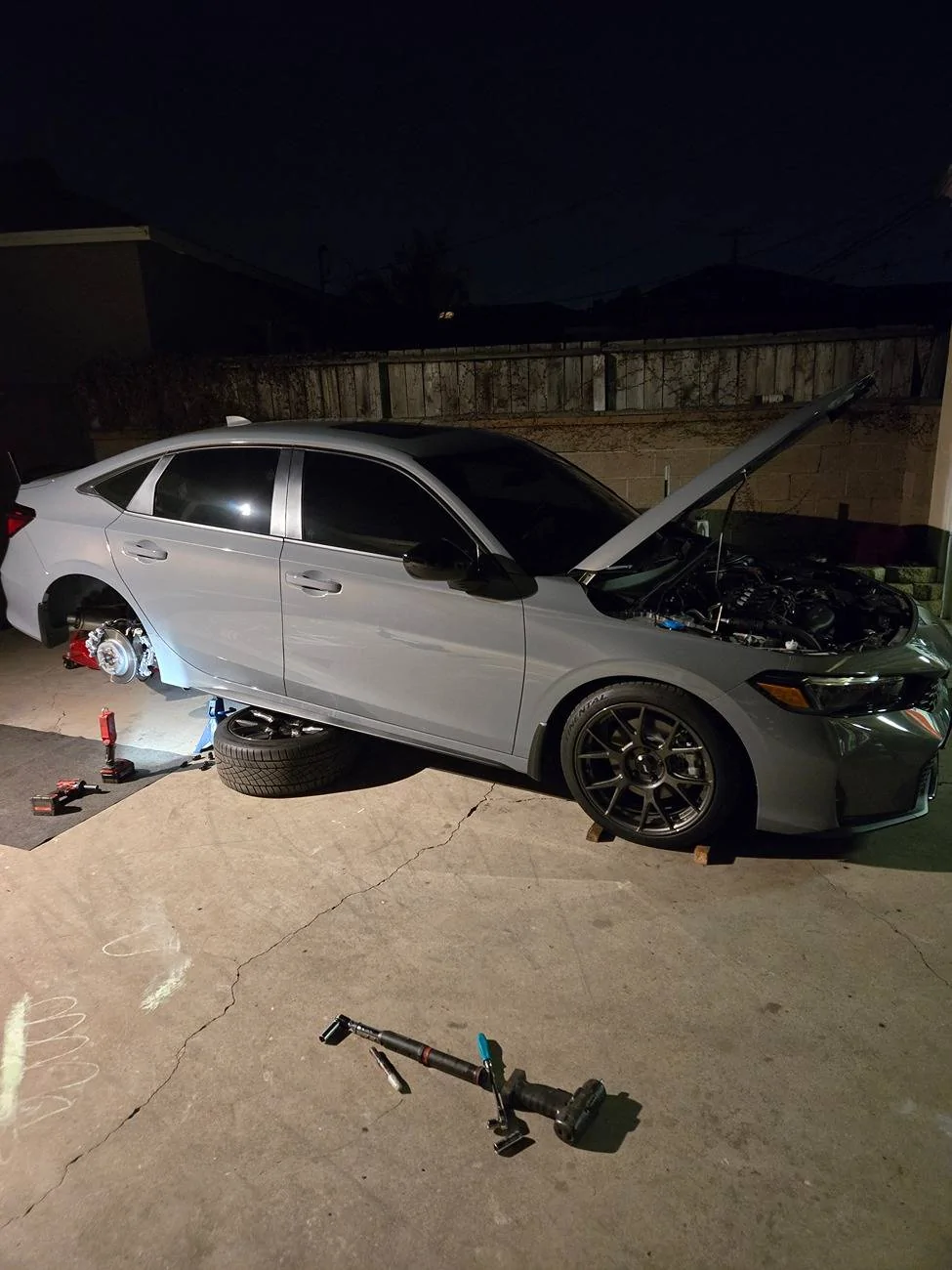

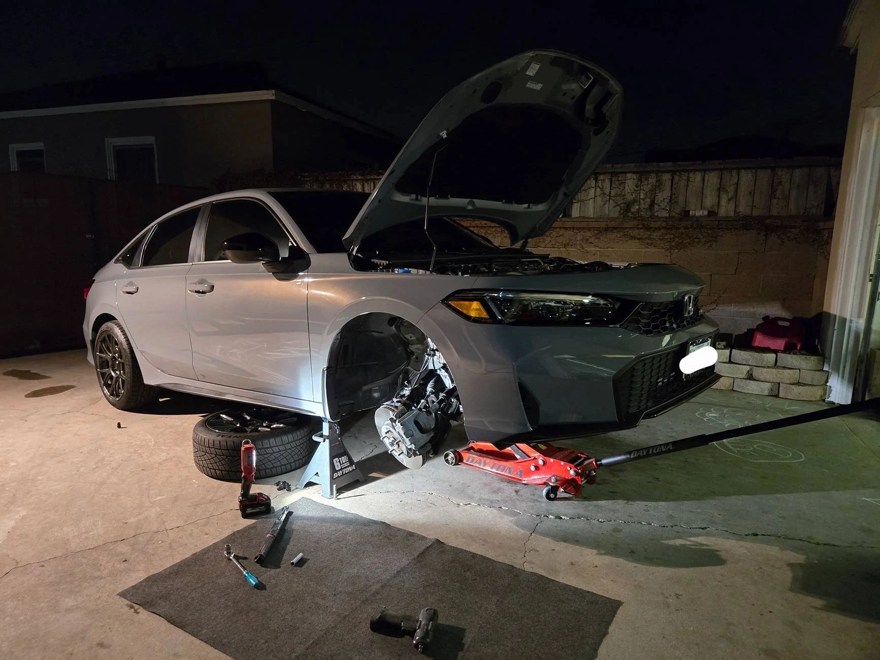

Just installed 11th gen SI pro kit lowering springs on my 2025 Si. The drop and gaps are great.
The ride is horrendous. Not sure if Eibach has actually tested these springs on a 2025, but it's bad. Bouncy, bumpy, rough ride. Car has 500 miles on it. Stock springs are honestly great, just too tall for me.
I will update after I put more miles on it. The 2025 Si gets a stiffer chassis and different shocks. Curious if that is the difference. Most 11th gen Si owners seem happy with the kit from my research.

Looks so good lowered. I wish I didnt have such crappy roads here.

Can run one size larger tire and stock suspension. Will close up the gap a little.
