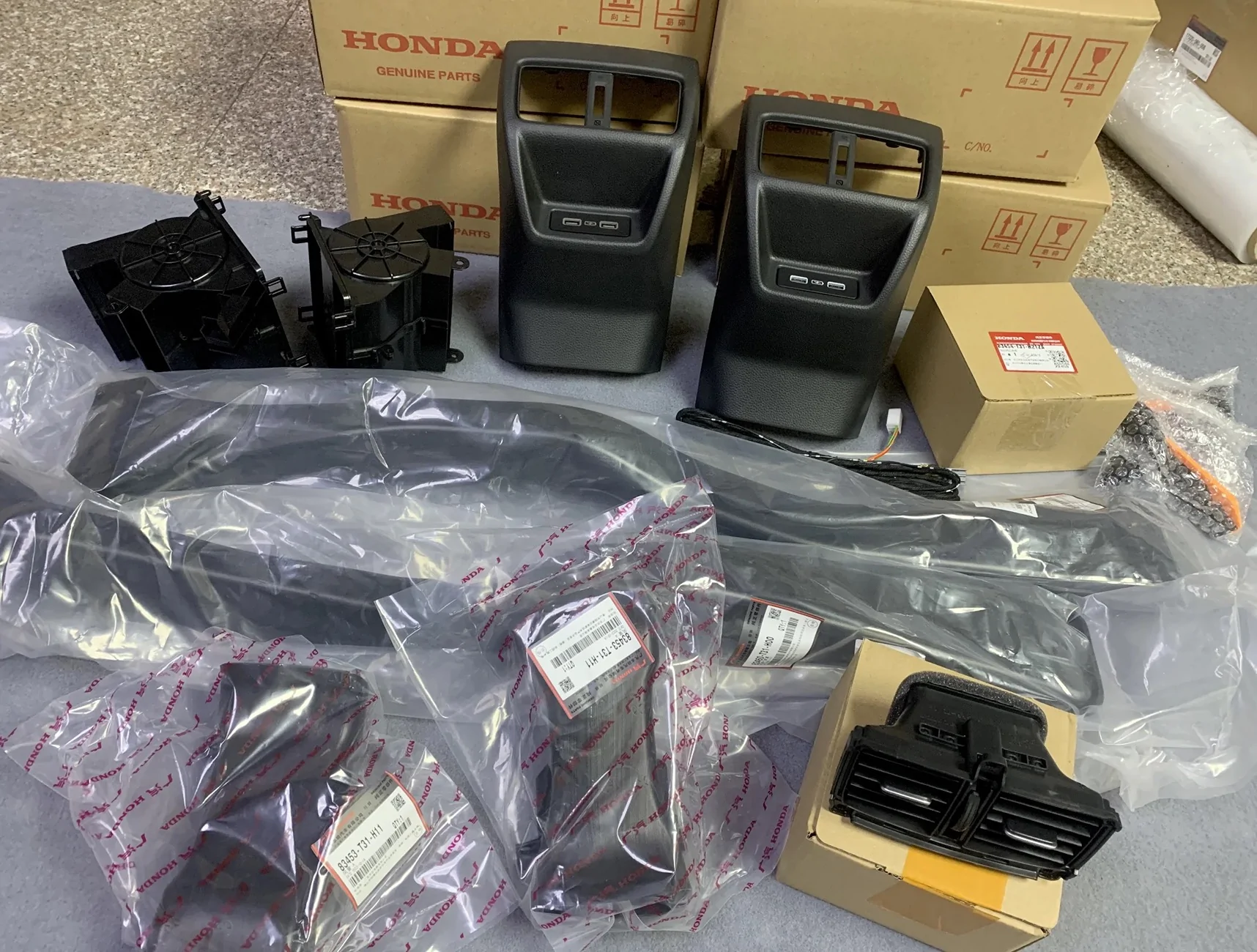

I’m looking to install rear A/C Vents and USB Ports on my 2025 Honda Civic Hybrid Hatchback Sport Touring using only genuine OEM Honda parts from either EDM or JDM.
It appears this has been done with a couple of FL5s. I’m looking for any experience or advice with sourcing the necessary parts for my FL4. Ideally it would be great to have access to both EDM and JDM Honda parts catalogs for direct referencing of parts needed; if anyone knows where to find either online, I’d appreciate any names and/or links.
I feel like I’ve read some conflicting information as to how much of the MIkstore kit uses genuine OEM Honda parts. It seems no parts come in Honda packaging but that Honda and the part number are stamped on at least some parts. Looking at this particular photo on their website shows parts with Genuine Honda packaging
I’m wondering if they’re putting together their own “kits” with genuine OEM Honda parts they’re able to source from their own or the Japanese market, unpackaging them to save on bulk-weight and ordering in the Civic’s case a common rear housing where the tabs need to be trimmed on some models so as to avoid having to have multiple kit configurations. And they don’t include the console box for similar reasons and maybe cost, instead expecting you to cut to fit the existing one.
If the kit is comprised of genuine OEM Honda parts, then I’m curious as to how they access the splitter since someone has said the piece is not available separately from the heater subassembly.

11th Gen Honda Civic Rear vents/USB port mod 1758221510016-o0

The only thing that mikstore provides that AFAIK can't be found elsewhere is the splitter. I don't think anyone has successfully figured out the part number for it. I have no idea if the mikstore splitter is even OEM. Unfortunately mikstore only sells the splitter as part of the full kit. Maybe you can get them on the phone and convince them otherwise.
Every other part can be sourced (assuming no back orders) from an OEM source.
If anyone has figured out the splitter part number please post it!
