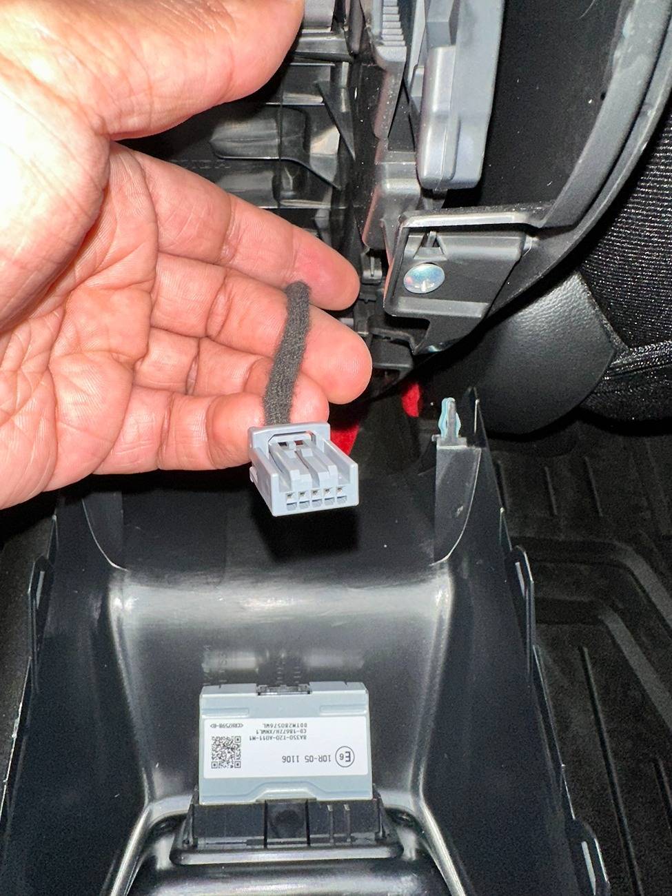

Apologies for the delay, picture and quick explanation below:

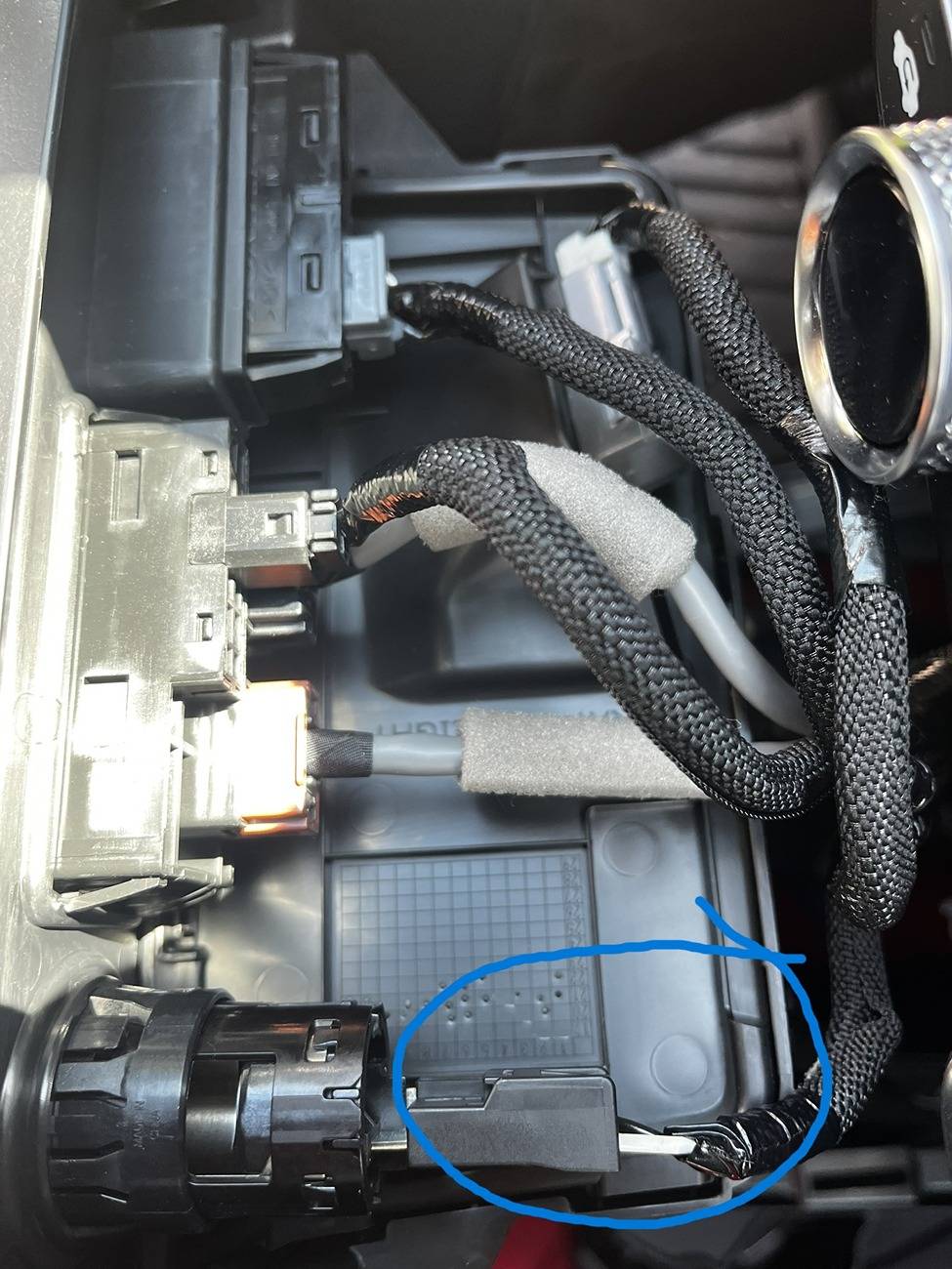

Below is the 12V/Cig liter connector
11th Gen Honda Civic Rear vents/USB port mod IMG_7136_1.JPEG

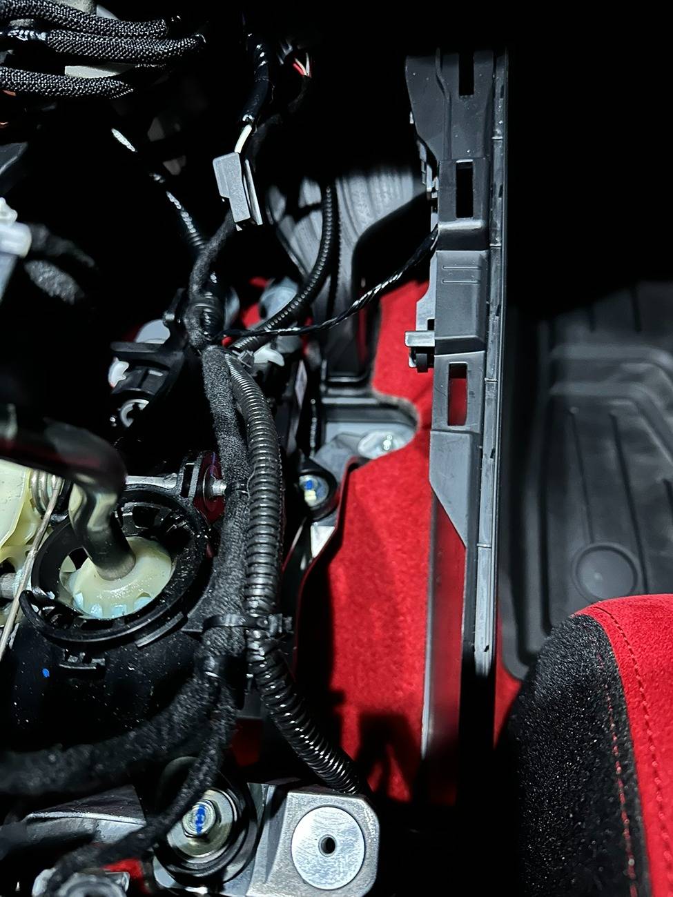

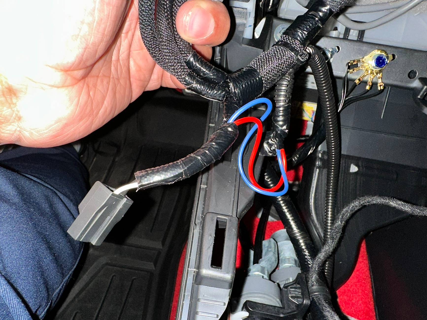

The harness you get from Honda is short and the connector doesn't work with the FL5, so you'll need to cut the unusable connector off and lengthen the harness to reach the Cig lighter wires.
When you cut off the unusable end, it’ll leave you with 5 wires. You’ll need to combine 3 of the 5 for power and the two for ground. Grey, Orange and Brown are Positive, Black and Blue are Ground.
Once you have them combined, lengthen both wires and tap into the positive and ground wires for the 12V/Cig Ligher (Black is ground, White is positive). I used electrical tape and some lom and ran the wire to through the shifter assembly to the back. I zipped tied it to existing wire while running it through some it’s not laying around loose.
11th Gen Honda Civic Rear vents/USB port mod IMG_0576.JPEG
11th Gen Honda Civic Rear vents/USB port mod IMG_0577
Run to the end and plug into the USB hub and snap everything back together.

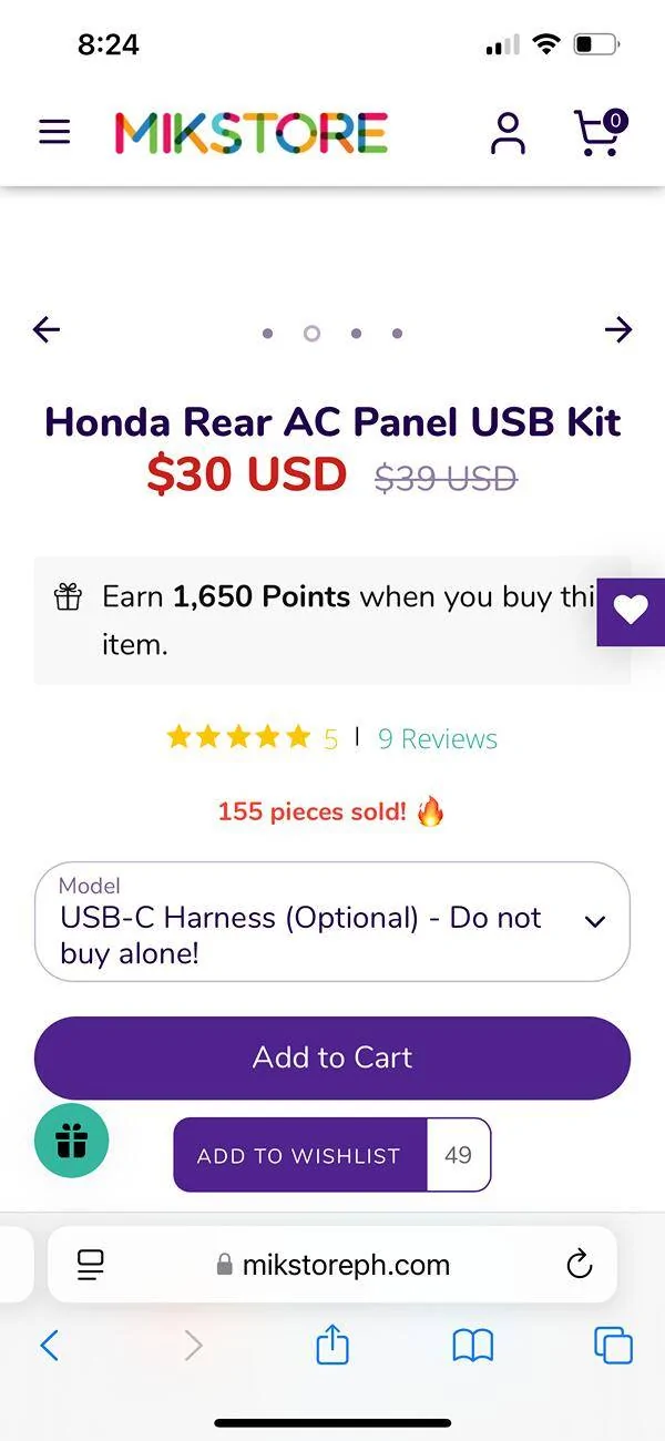

I know the MikStore has a USB C option, but I don't think the same harness will work. Whereas Mikstore will give you a "T" adapter that goes into the Cig light for the USB A ports, the wiring is apparently different for USB C ports.
EDIT: Link for the Mikstore
https://mikstoreph.com/collections/...ies/products/civic-2022-rear-ac-panel-usb-kit

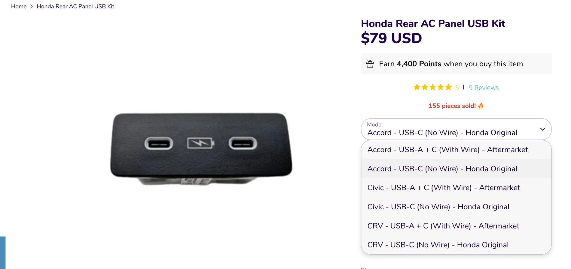

It's weird, because they don't offer harness for USB-C Honda Original.

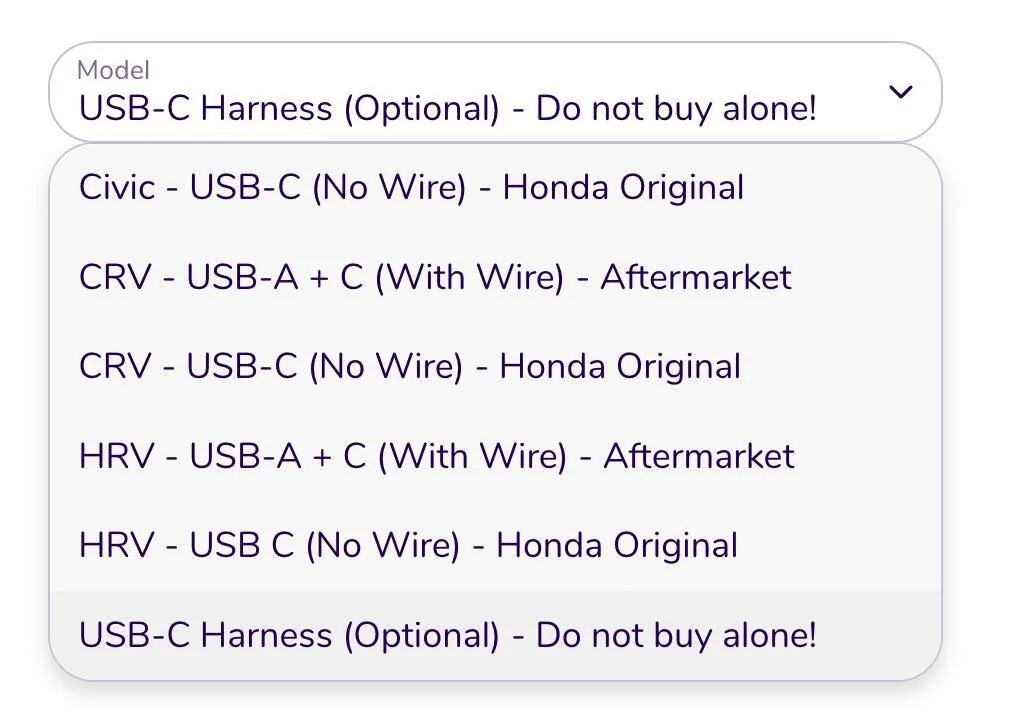

My bad, looks like the do sell USB-C Harness:
11th Gen Honda Civic Rear vents/USB port mod Screenshot 2025-06-09 at 6.16.07 PM
Seems like what I need:
1. Rear cover from any Honda dealer shop - 83451T20A41ZA.
2. USC-C + USB-C Harness from Mikstore.
