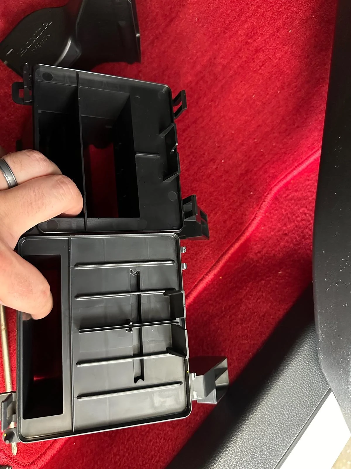

It isn't diverting any flow, it's opening a path for the air to make it to the back from any mode setting other than defrost. The photo below compares the oem floor tube (bottom) to the new splitter tube (top). When on the face setting, the HVAC door was closing off flow to the floor vents on the oem tube through the single outlet. With the new splitter, the door closes on the floor outlet but leaves the new rear outlet open. Essentially the air from the factory was hitting the blocked off portion of the oem tube with nowhere to go.
11th Gen Honda Civic Rear vents/USB port mod IMG_3947
There's a noticable reduction in airflow from the front vents with the rears open, but it's nothing horrible.

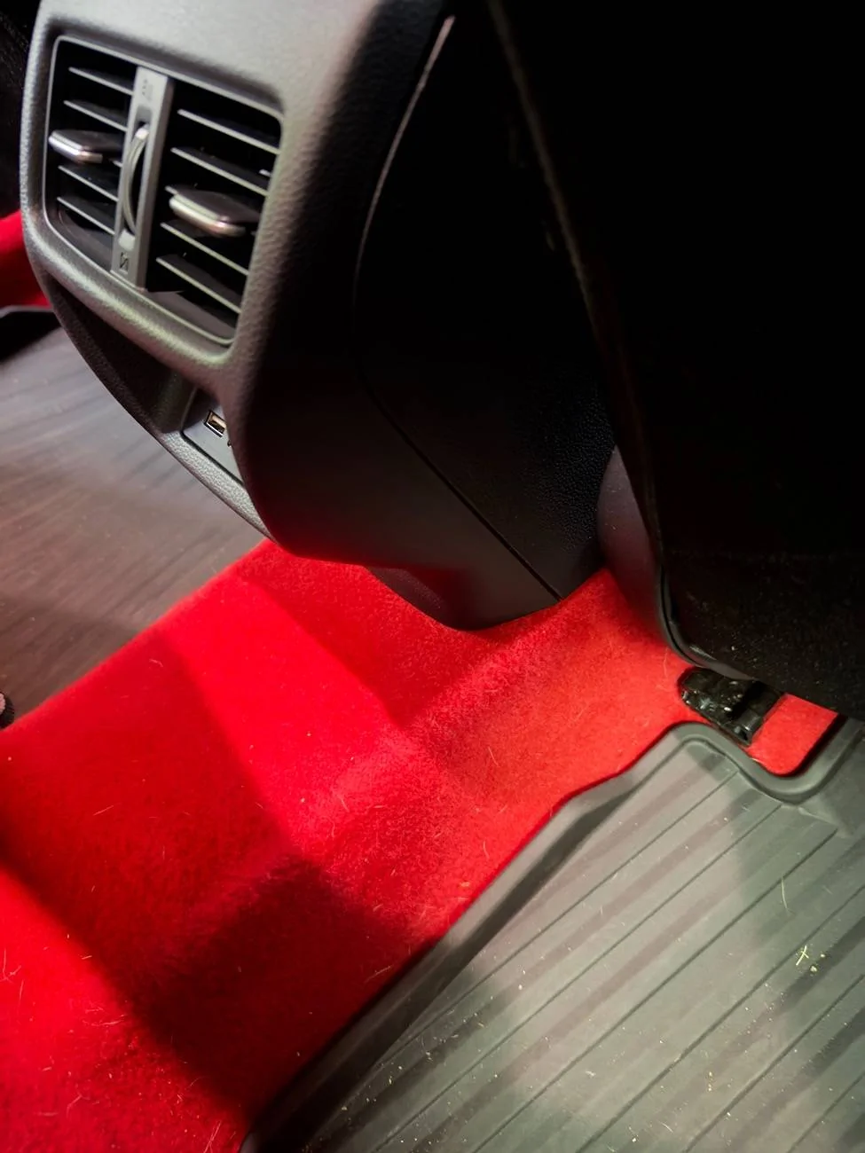

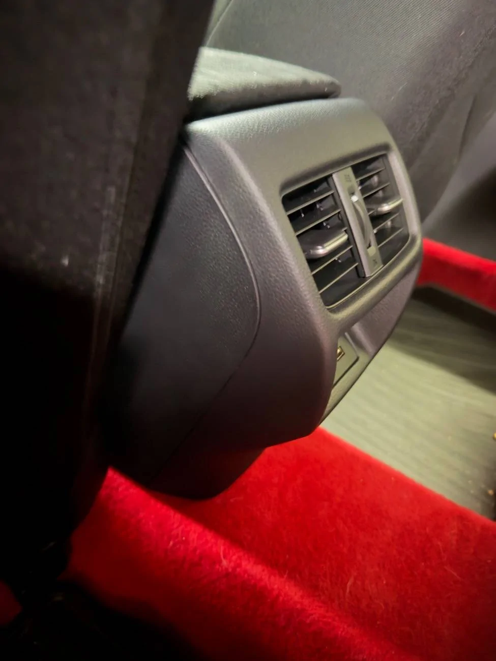

Install was easy, took about 1.5 hours and took my time dremeling and trimming the rear panel. I was expecting the shift knob collar to give me trouble but it popped off easily after rotating it 90 degrees and twisting back and forth while applying downward pressure.
The factory outlet that feeds into the footwell vents was a bit of a pain and I wound up breaking the two rear clips even when prying the tabs with a plastic tool so be careful.
Fitment on the rear panel is decent, the upper left won't sit flush even after all the trimming but it isn't something anyone would see.
Looks very very nice. Congrats

I would read "diverting" to be splitting off flow, not necessarily wholly redirecting flow. To this end, since the blower is the fixed constraint, and your feedback that front vent flow is reduced at a given fan speed, yes the floor vents would be reduced. If the blocked plate didn't allow flow, additional flow would go through the other openings unless there was a significant restriction that is likely stalling the fan a bit (which is unlikely for OEM). Perfect example of this is close all vents except one and you'll feel the air flow increase. Works the same in your home for central air.
For me I rarely have the AC on higher than lvl2 at 76F, so I could stand to crank it up a little if my kids get air in the back.

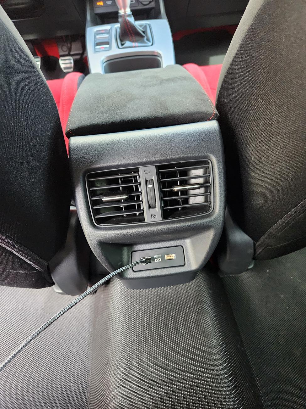

Just got mine installed. I'm very happy.. there is no discernable loss in flow from the front vents. The USB's are illuminated and the USB "c" is nice to have.

Fitment looks great from that angle. Any issues during fitting? Also, I’m assuming there’s a huge hole inside the glovebox compartment?
Fitment is great. Full disclosure I have a guy who owns a small car audio shop and I had him install the vents. He also hard-wired my dashcam. And no there are huge holes in the glovebox. Not even a small hole.

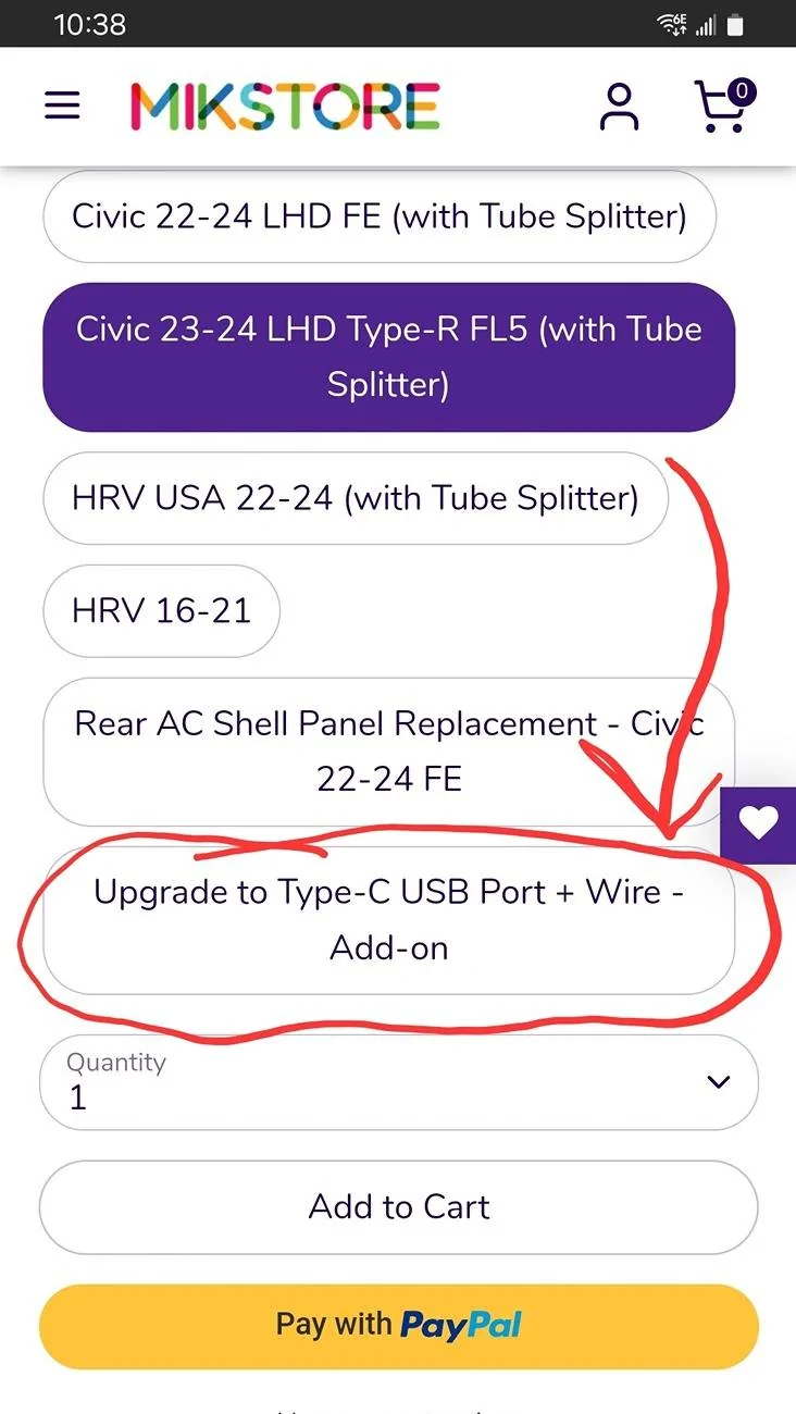

For those that recently purchased this item, does the kit already come with the USB ports or did you have to also choose the USB option?
How long did it take for the kit to arrive after placing order?

I think it only took a week or two. For international, I tend to just order and forget about it, it is less painful to think about how long it'll take. Haha.
When I ordered there wasn't an option for usb-c but it came with it.

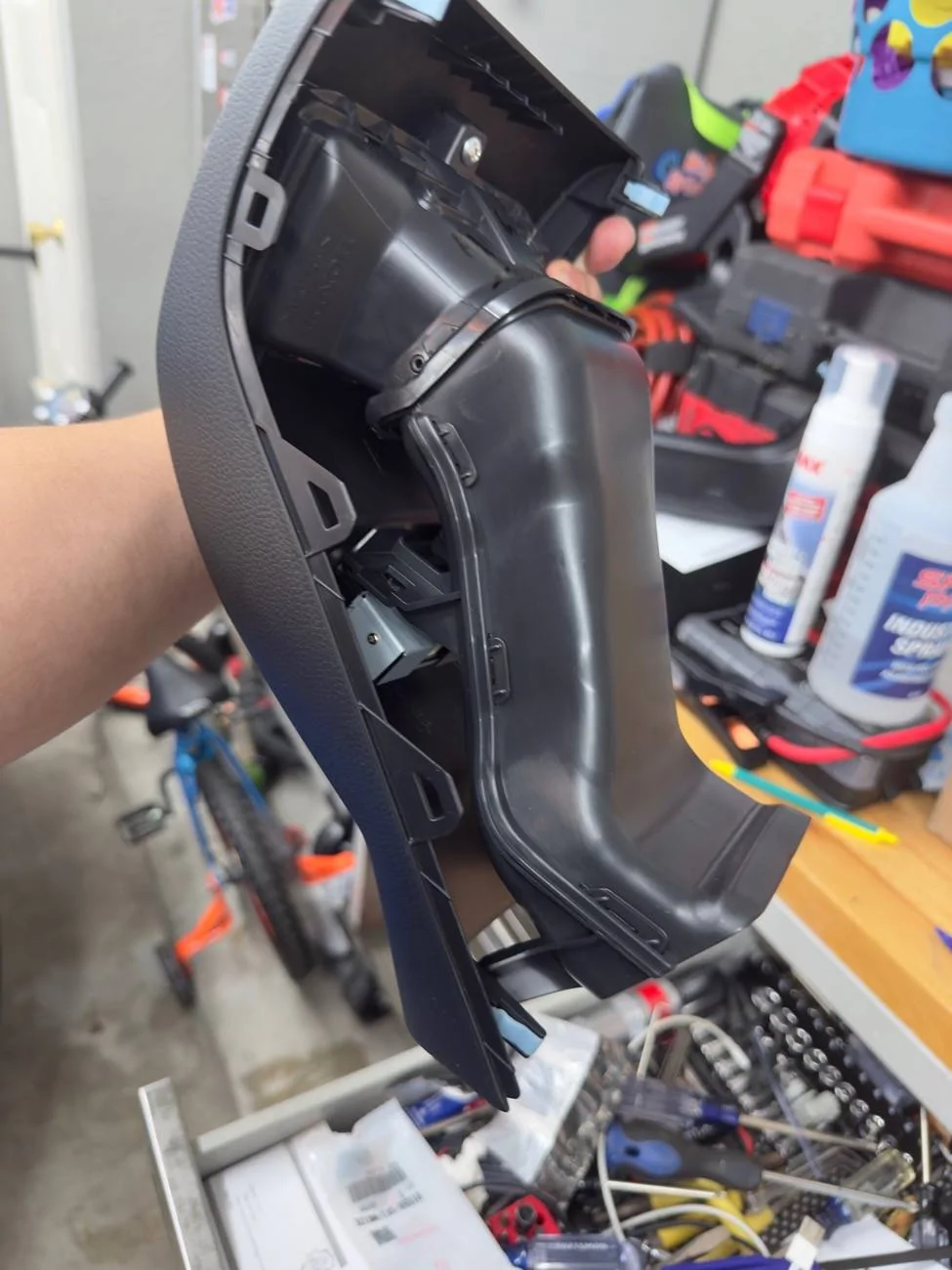

Ok to post on the thread I order the fl5 from milksostore but didn’t like the fitment of the rear vent too much. Somebody here put the OEM part number I bought them on JDM Yamamoto. This what I got:
83451-T24-T01ZA x1
83453-T24-t01 x1
83406-TVA-A01ZA x1
91550-SFJ-W01ZE x1 to the centrer console tube that comes from the Front
93913-24220x3 for the vent.
The usb connection it was transferred to the honda one and the fitment is without any weird spacing.

@Evox787 Cost wise, was it similar to getting it from the Mikstore?
I still got the mikstore kit + the oem vent because of the fitment and the modifications that needed to be done to the kit doesn’t really fit the way it supposed to. I pay 273.12 for the kit and 141.47 for the oem parts but I bought couple of bolts and clips extra that I did not use. Because I look for the oem parts ant the part that diverts the air isn’t sold separately from the heat core or the part that is under there it was expensive. But all works perfectly for me and the shipping was fast for both mikstore I got it like on 3 days after I ordered and the JDM Yamamoto like 5 days after order.
