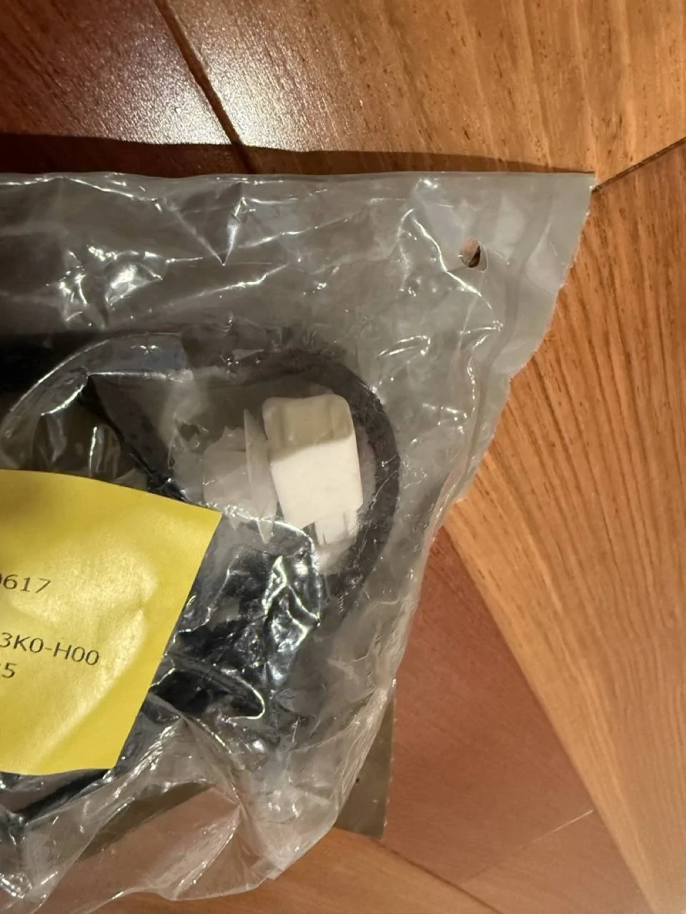

Not yet, I just received the parts. The problem is that the harness, 32114-3K0-H00, doesn't fit the USB-C. I plan to stop by the dealer next week and hope one of the technician can help me to find the right harness.

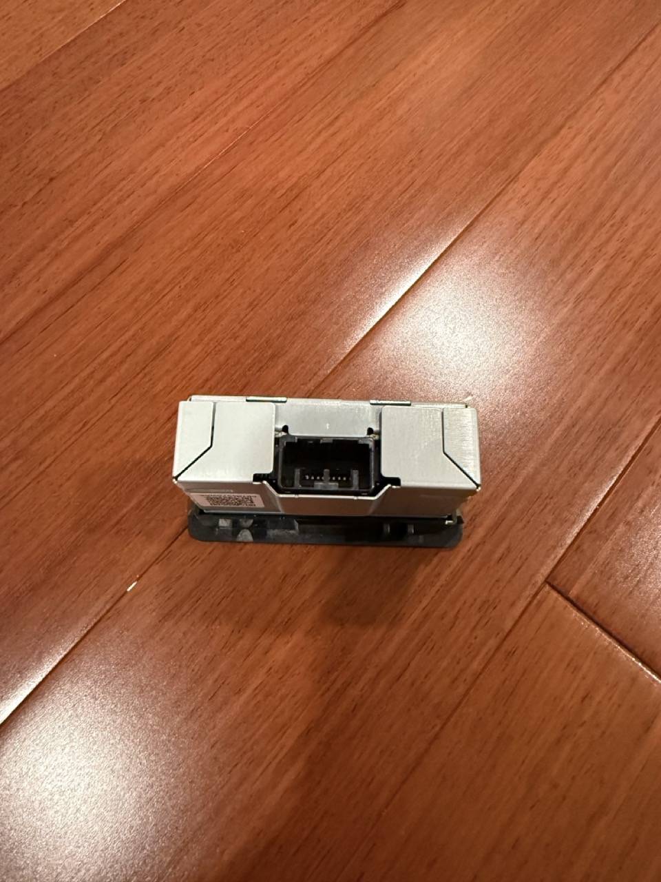

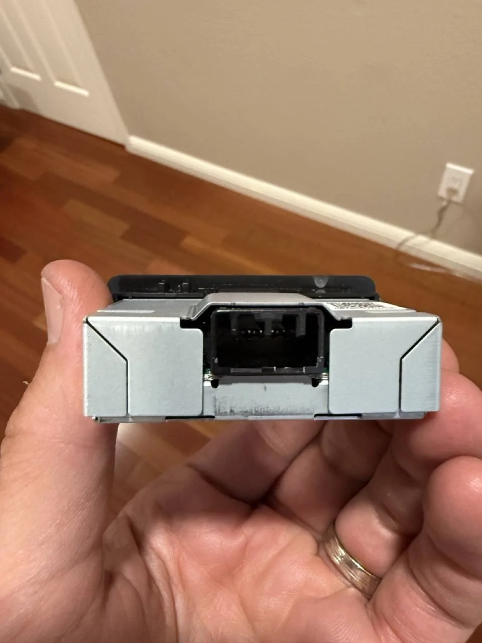

Mind taking a picture of the rear connector of the USB hub and the harness so we can see the difference?

I noticed the Integra A-Spec has different harness: 32114-T20-A40.
Maybe that harness has the right connector.

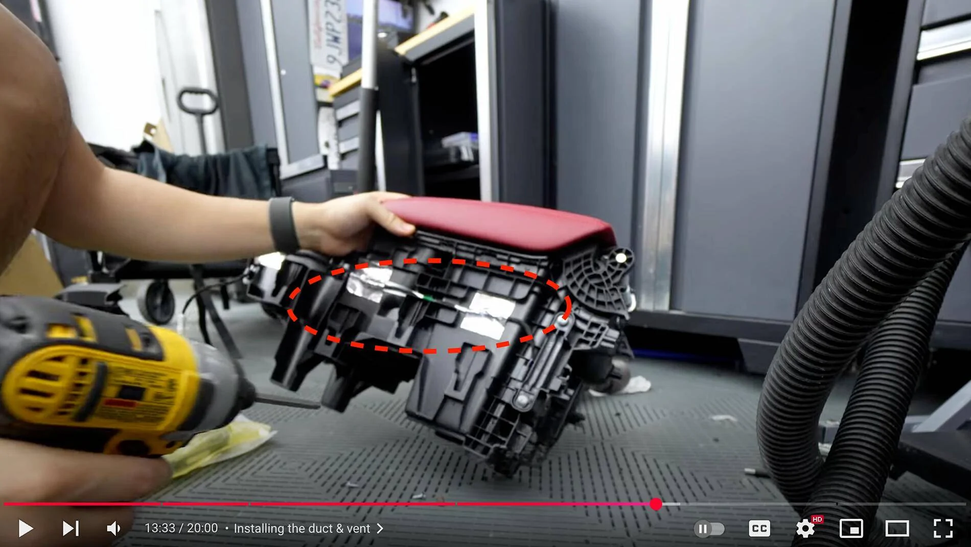

One more note:
- I saw this video (scroll to 13:00 min) posted by a member from Integra forum. He took apart the rear console and it looks like there is a cable inside the panel that came from factory. I wonder if it's the harness to supply power for rear USB-C?

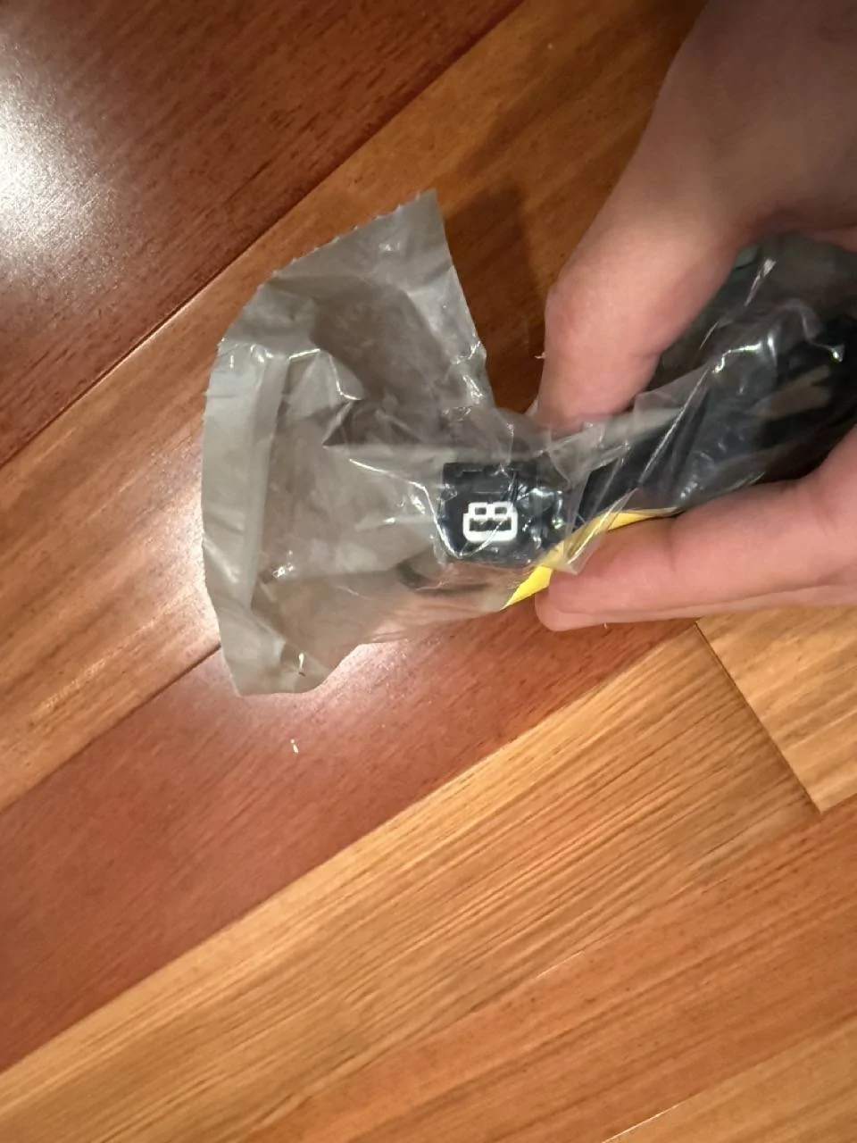

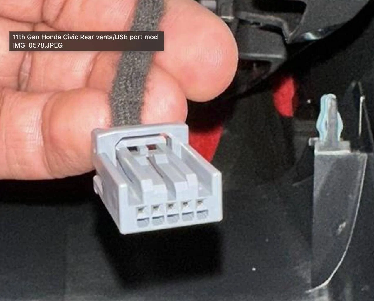

The connector at the back of the USB USB looks same as mine. The harness end looks the same as well.
How did you pull the connector out? I took off the rear panel and I see the cable on the side. But is it connected to some plastic to hold it?
I plan to remove the whole console in a few days anyway. Just curious now :)
Which connector? I had to cut the harness and tap into the 12V cigarette lighter. There wasn't anything to run the wire from the lighter to the USB hub in the back so I zip tied to keep the install clean.
Hopefully the other harness you order will fit. I'm curious to see if you'll have to cut as well or if it'll come with an adaptor to split power with one of the other ports in the console area.

One more note:
This cable is not related to the USB/rear vents. This goes to the immobilizer/key sensor held in by those two screws just outside/below the circle.
Right, I just read about it recently. It's still unclear how the rear USB-C is wired in Integra A-Spec with Tech Package. I thought that 32114-T20-A40 harness have some split cables, one part goes to the immobilizer/key sensor, and second goes to the rear USB-C. That's why I ordered the 32114-T20-A40 harness to try. Unfortunately, the dealer advice of using 32114-3K0-H00 was incorrect.
