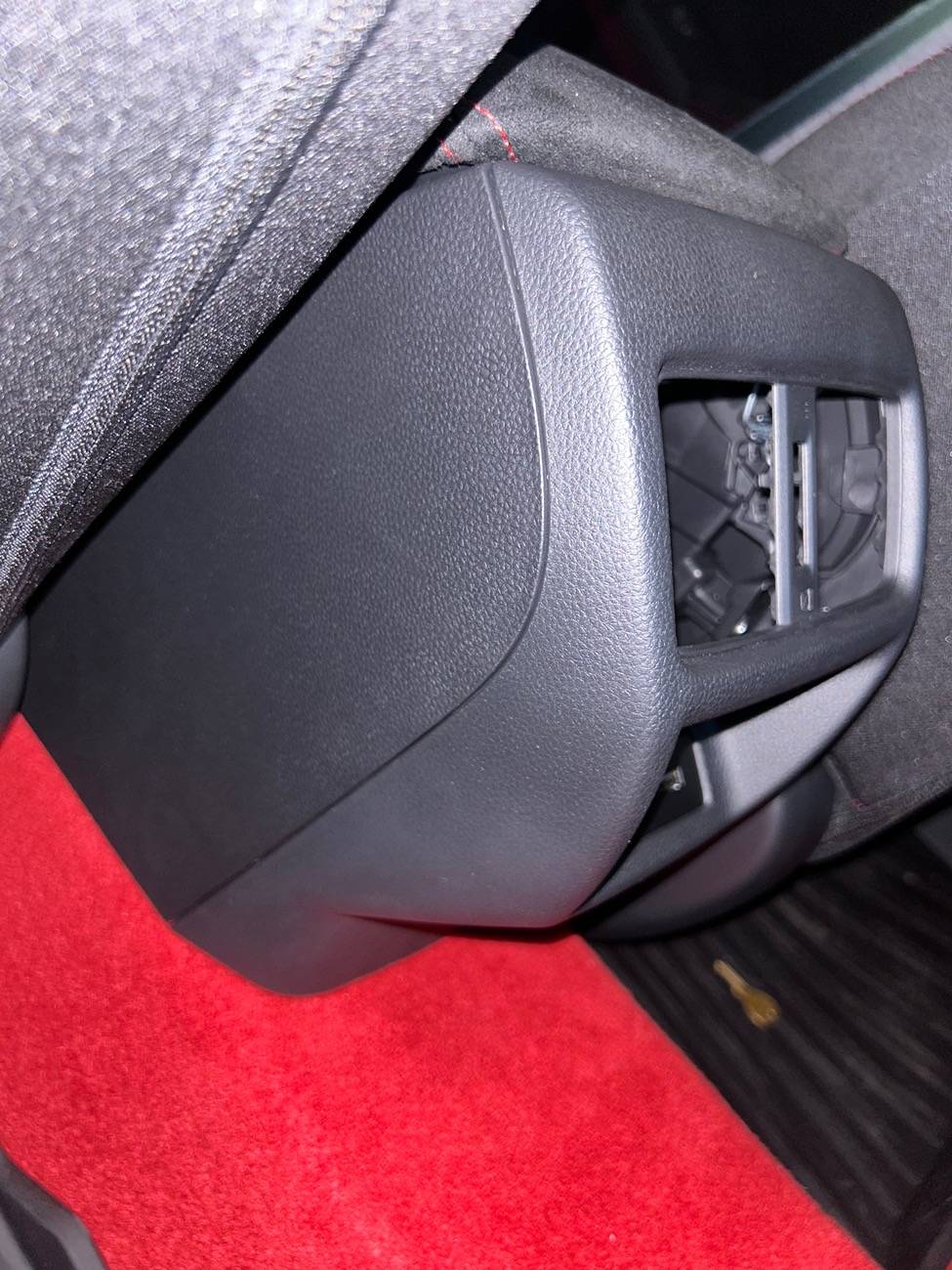

Installed the milkstore kit, had a gap that I couldnt get to go away, bought the OEM rear panel, gap is gone.
However, the air vent doesnt fit in the oem rear panel so now buying the OEM air vent...
Edit: Just kidding its $74 Im going to try to make the milkstore one work.

Update: the milk store vent doesn’t fit in the oem housing. What to do now… the oem housing fitment is much much nicer than milkstore
I have have the mikstore kit installed with rear jdm housing. I ended up using a dremel on the inner part of the jdm housing to allow the vent to fit flush. Definitely not what i was expecting to do but it turned out well in the end. After trimming, the screws are able to adequately hold the vent to the housing pretty flush. I also used some electrical tape on the inner part of the usb opening to hide any gaps around it.

Ok. Okay, we'll be waiting for your news. Good luck
Just installed. Took about 2 minutes. It’s perfect.
However, it’s now cost me like $150 more than the milkstore kit. I don’t know if going back I would do it. I’m glad I did, and it looks really nice, adds a needed feature to the car, but unsure if it’s worth the $400 I’ve spent at this point.

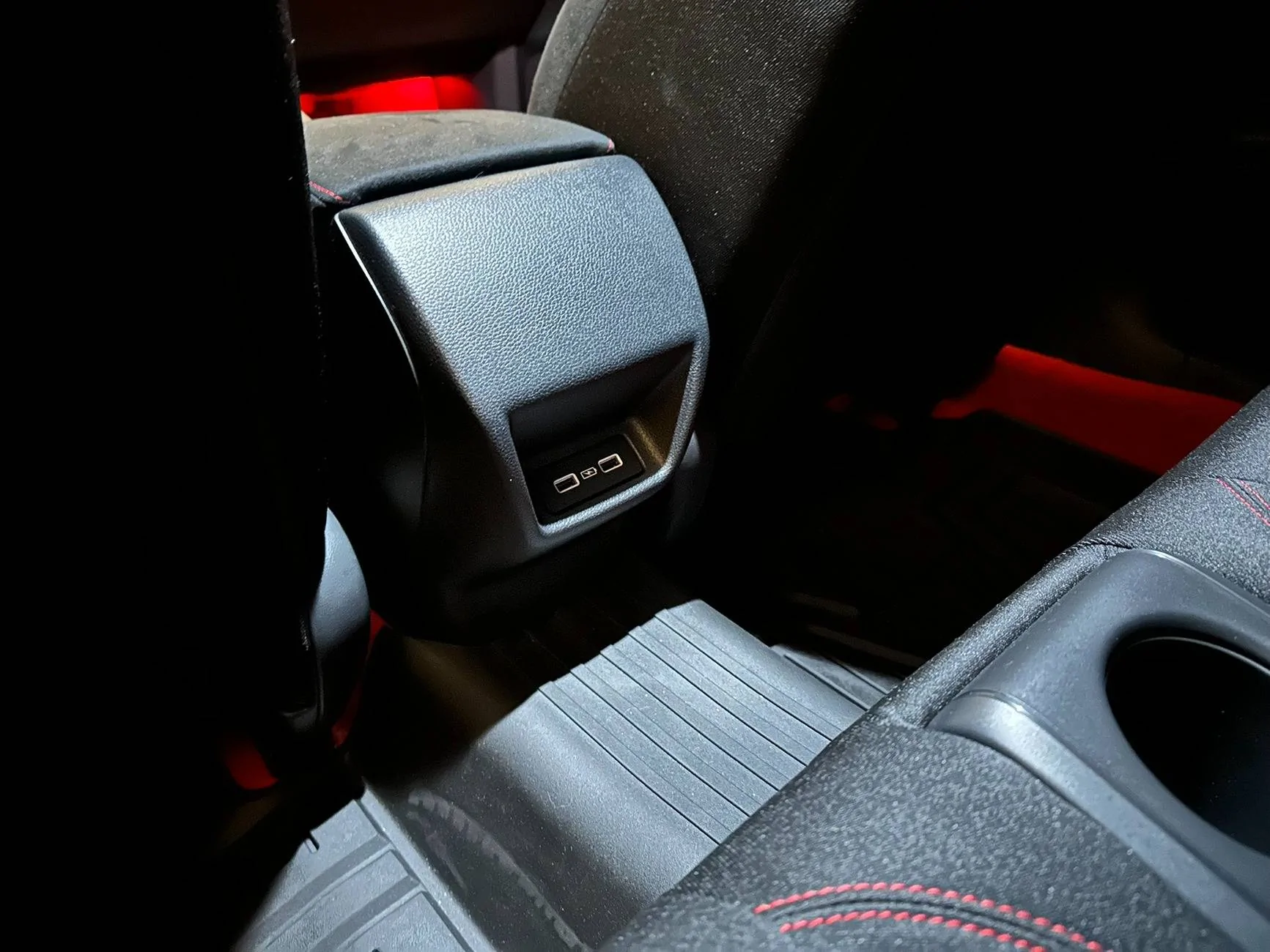

That's how I looked at it with the rear vents. The cooling in the rear seems to be sufficient enough without them, though it does a more premium touch to the car. I opted to just go with the USB ports at the rear, just spent just over a $100 to get the parts from my local Honda dealership, and a little DIY with the harness.
Do you have a list of the part numbers that you used? What was involved for the wiring?
Yup -
Rear Cover - 83451T20A41ZA
USB Ports - 8A350T20A01
Harness - 32114T20A10
As far as modifications go, you’re essentially cutting off the end connector that supposed to go to a port in the automatic shifter area on base civics. We’re extending the wire to go the cigarette lighter harness to get the 12V need. The USB port converts the 12V to 5A used for our mobile devices, so there no concern of damaging ports on phones/tablets.
If you need pictures, I’ll take some and post them up here.
