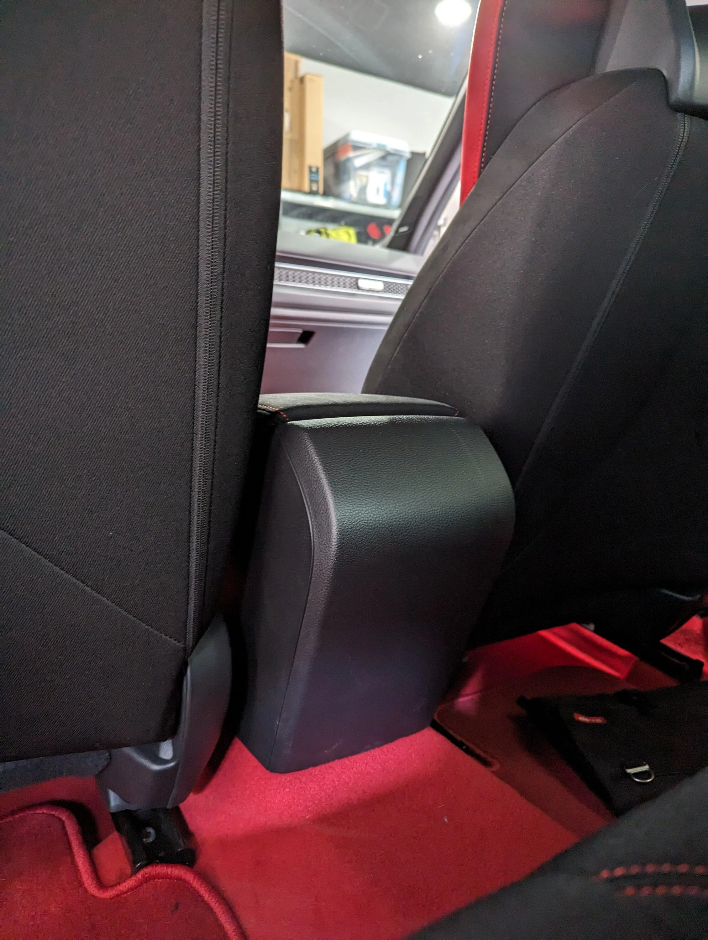

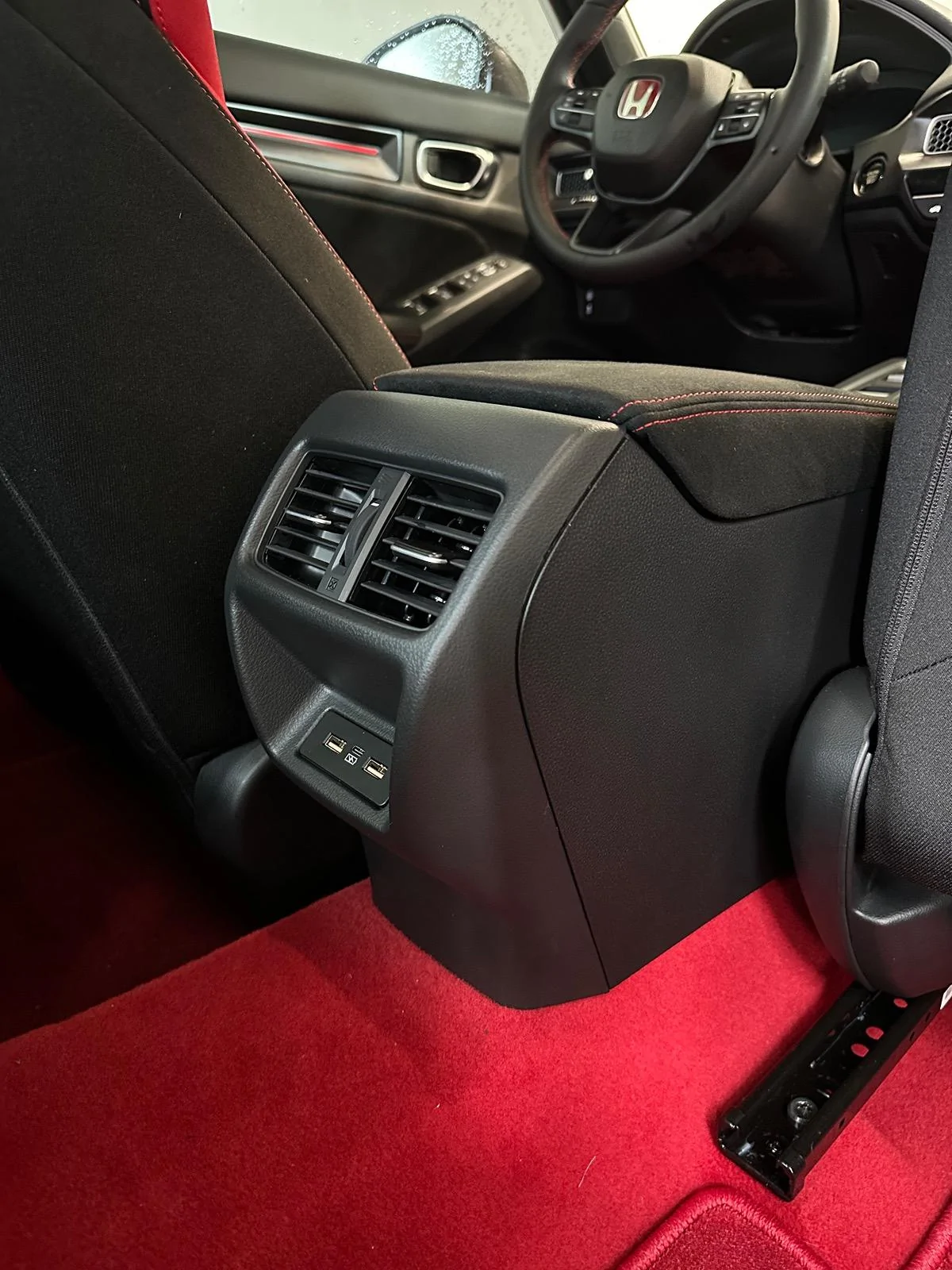

I installed the rear vent this past weekend.
Before:
11th Gen Honda Civic Rear vents/USB port mod PXL_20230813_143817018
After:
11th Gen Honda Civic Rear vents/USB port mod PXL_20230814_155101603

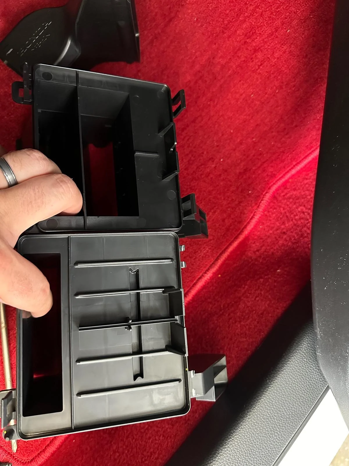

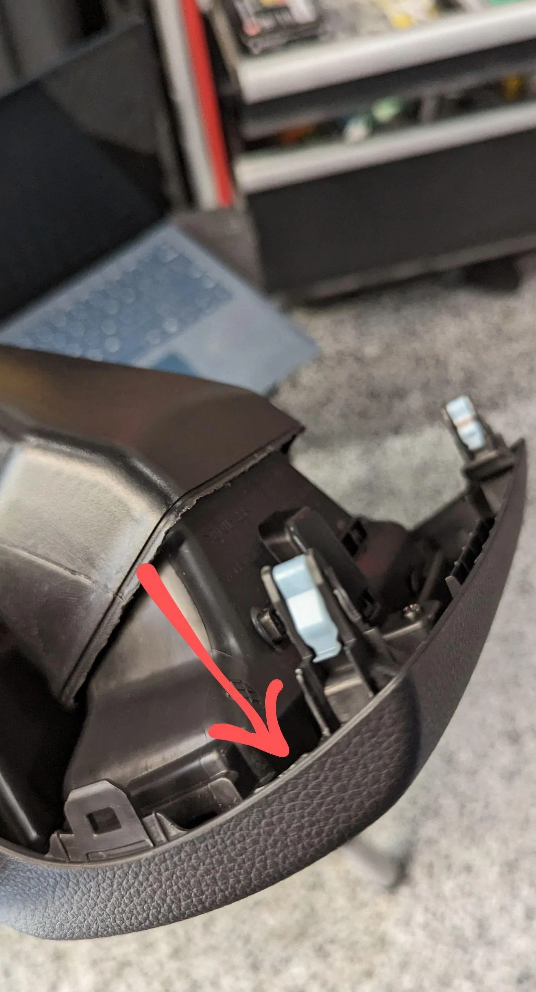

I also had a problem with the alignment. I ended up shaving the tabs shown below for a better fit.
11th Gen Honda Civic Rear vents/USB port mod Screenshot_20230814-105225

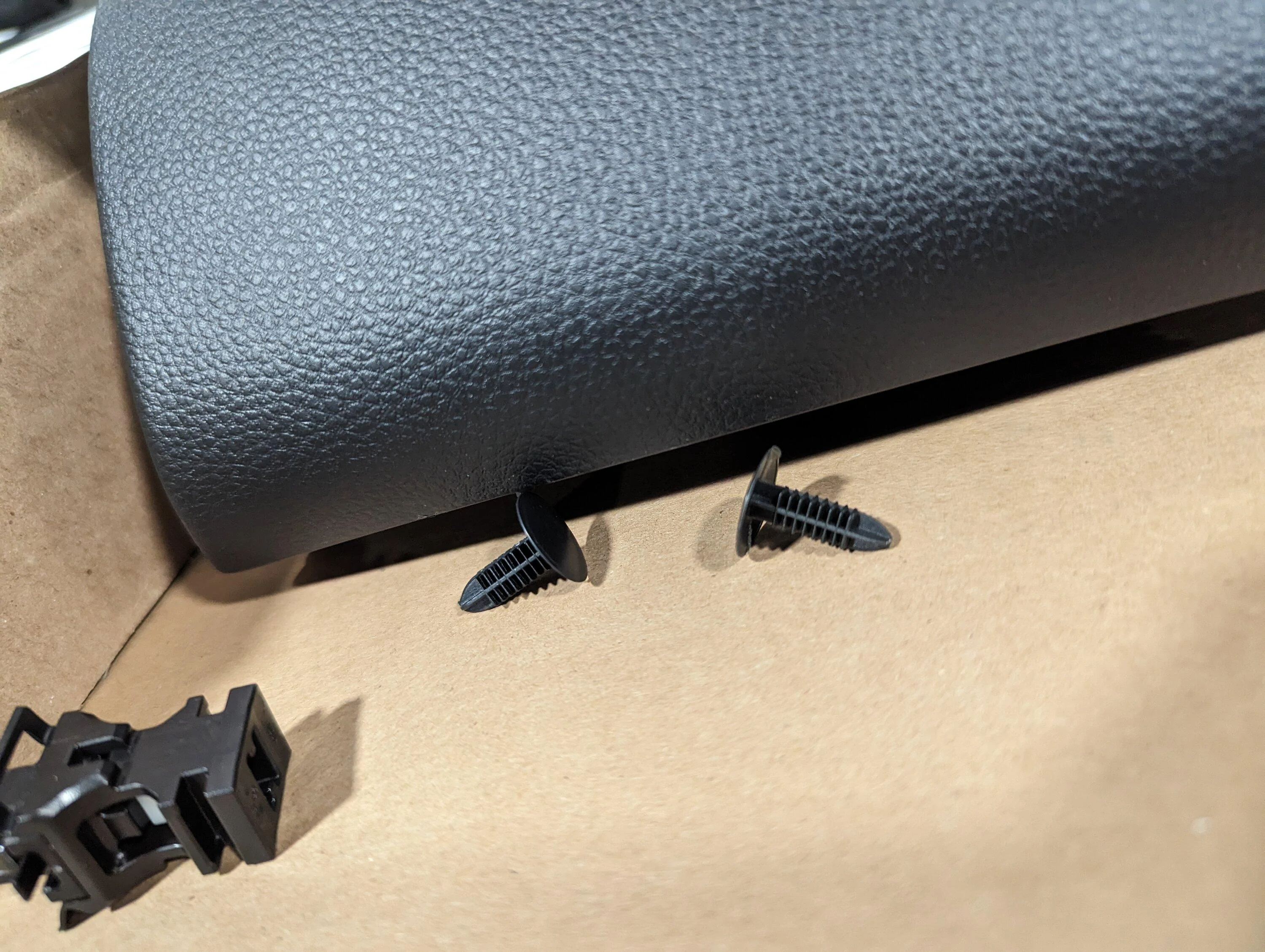

The only question I still have is: What are these plastic fasteners used for? Maybe the main air diverter? I couldn't find anywhere to fit them.
11th Gen Honda Civic Rear vents/USB port mod PXL_20230814_143106019
Ah, one is used at the front of the tube on the right side and helps connect it to the splitter. The other one is used at the back end where the tube passes through a bracket you'll notice the bracket had a hole in the middle. I also used some closed cell foam to make sure the tube won't slide or rattle.

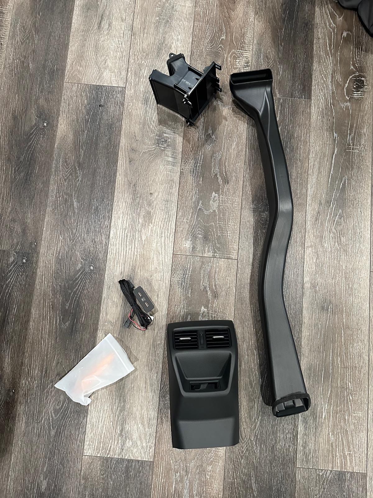

Kit came in today, hoping to tackle the install tomorrow. I really don't know why this doesn't come from the factory, it's 1-2lbs of plastic.
My son should be much happier riding home from little league.
11th Gen Honda Civic Rear vents/USB port mod IMG_3946

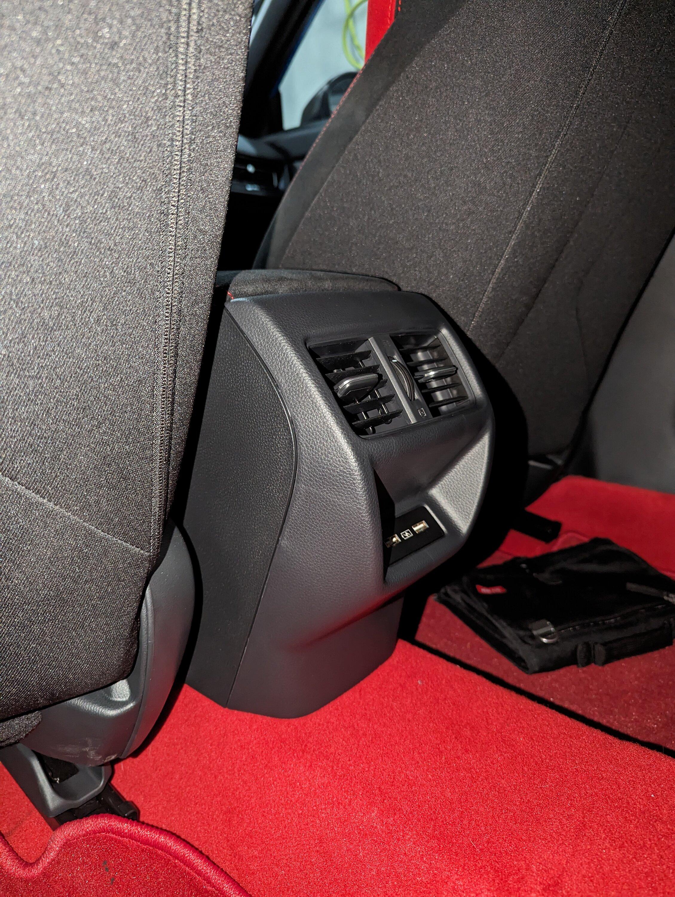

Install was easy, took about 1.5 hours and took my time dremeling and trimming the rear panel. I was expecting the shift knob collar to give me trouble but it popped off easily after rotating it 90 degrees and twisting back and forth while applying downward pressure.
The factory outlet that feeds into the footwell vents was a bit of a pain and I wound up breaking the two rear clips even when prying the tabs with a plastic tool so be careful.
Fitment on the rear panel is decent, the upper left won't sit flush even after all the trimming but it isn't something anyone would see.
11th Gen Honda Civic Rear vents/USB port mod IMG_3947
11th Gen Honda Civic Rear vents/USB port mod IMG_3948

I couldn't get mine to fit entirely flush either but unless you are looking specifically for that you won't notice it and tbh, I had totally forgotten about it until I saw your post.
My son absolutely loves & appreciates the vent! IMO, this is a "must do" if you regularly have rear seat passengers.
