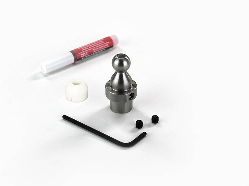

I'm really excited to let everyone know that we now have In Stock a short throw shifter for all 2016+ manual transmission Civics! This SiriMoto Short Throw Shifter is an adapter style design that installs onto the end of your factory shift lever. It results in an amazing 33% decrease in shift "throw"! Some of you may be wondering what exactly shift "throw" means, so I'll explain: Shift throw is simply the total distance you need to move your shift knob to switch gears, that's it! The 33% decrease applies to all gear changes too, not just 1st to 2nd. Having a shorter shift throw makes driving more enjoyable and your shifts faster as well.
Works on both turbo and non-turbo 10th Gen Civic models.
Key Benefits:
  • 33% reduction in shift throw!
  • Adapter kit allows for an easy install - Video installation instructions available (will be posted on our YouTube channel soon).
  • Optimal specs designed to adjust fore and aft travel.
  • Includes MIL-Spec thread-locker for permanent installations.
  • Knurled-end set-screws to prevent loosening, even when installing without thread-locker.
  • Covered by a 1 Year Limited Warranty.
  • CNC machined from high quality 301 stainless steel.
  • Can be ordered with an optional Ball-End replacement bushing, which is precision machined from acetal and replaces your factory bushing for a more solid shift feel.

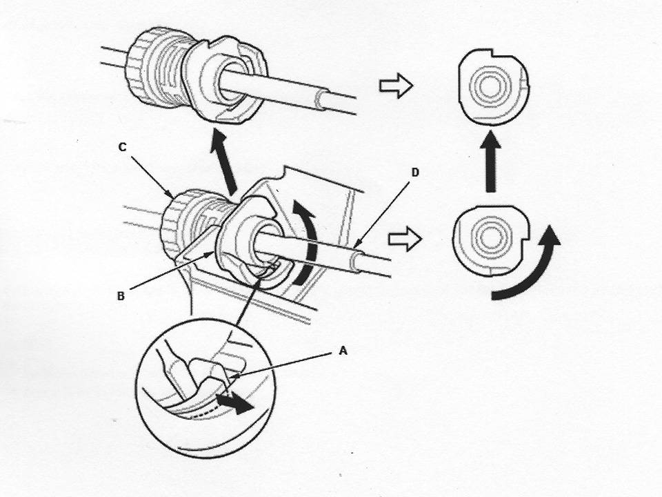

I installed mine tonight. Disassembly was going spectacular until I tried to remove the shifter cables from the shift tower. I could not get them off and was worried I'd break the plastic shift tower. I called ProCivic and the guy that answered admitted he did not have knowledge in that area and recommended I called email their techs. I explained that I had the car in pieces and was worried if I emailed I would not hear back this evening. I convinced him to try to find someone for me to talk to. After a few minutes on hold he returned and said everyone was busy but that an email would probably be answered first thing in the morning. After receiving no real help I tried for a bit longer and then decided to try to do the job with the cables still attached. It ended up not being that bad to work with while still partially attached to the car. The "ball end bushing" was a very tight fit and very difficult to snap into the shift cable end, however that is probably what makes it work well once it is in there.

Just to clarify, should they just "pop out" of the tower when pulled the direction of the visible opening? I pushed, pulled, and pryed (even with a large flathead screwdriver) with no success.

After you release the lock, you need to twist the cable collar counter-clockwise until it stops, then pull the cable up through the visible opening. It is a bit tricky I guess. The reason of course is that Honda wanted to make it very secure so it doesn't come lose on accident.

How do you "release the lock"?

Haha sooo.. went into second gear and heard a pop. Then the shifter when limp. Couldn't Shift anymore, so I pulled into the nearest parking lot. Pulled apart enough to see what was going on.
The short throw adapter fell off the Stock ball. So the cable was now detached. AAA toed it home and I went over the install instructions again and the shipping package. My dumb a** didn't use the included red lock "glu"
So fwy tighten it nice and good and use the red stuff haha.
