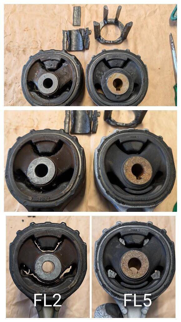

FL2 6MT

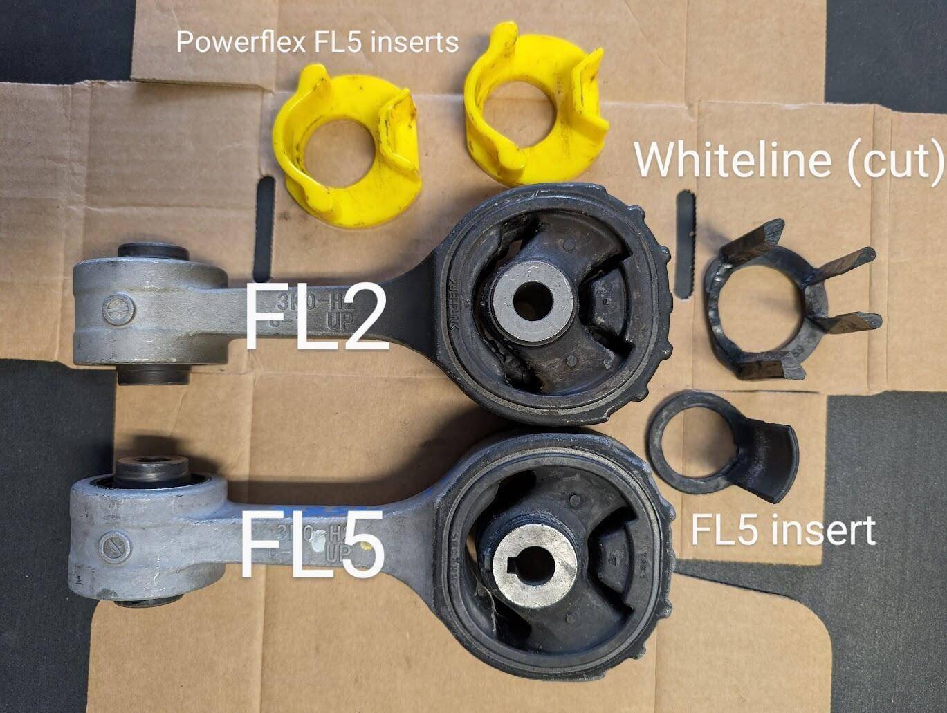

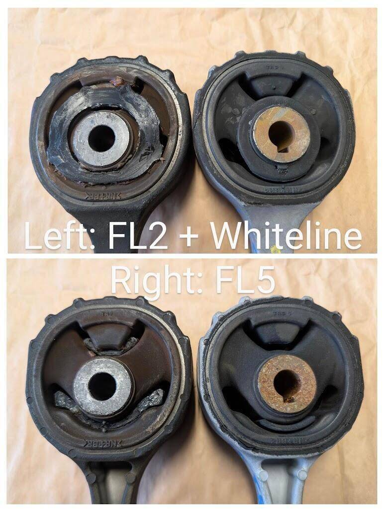

Now that the weather is cooler and I don't use AC daily, I swapped in the FL5 RMM with Powerflex inserts. Using this with AC on at idle causes harsh vibrations. This was the 7th time doing this. Took me less than 10 minutes. Would have been quicker had I lubed the ends of the RMM to make it slide in easier.
Top: FL2 RMM + OEM FL5 insert + modified Whitline insert
Bottom: FL5 RMM + Powerflex inserts
