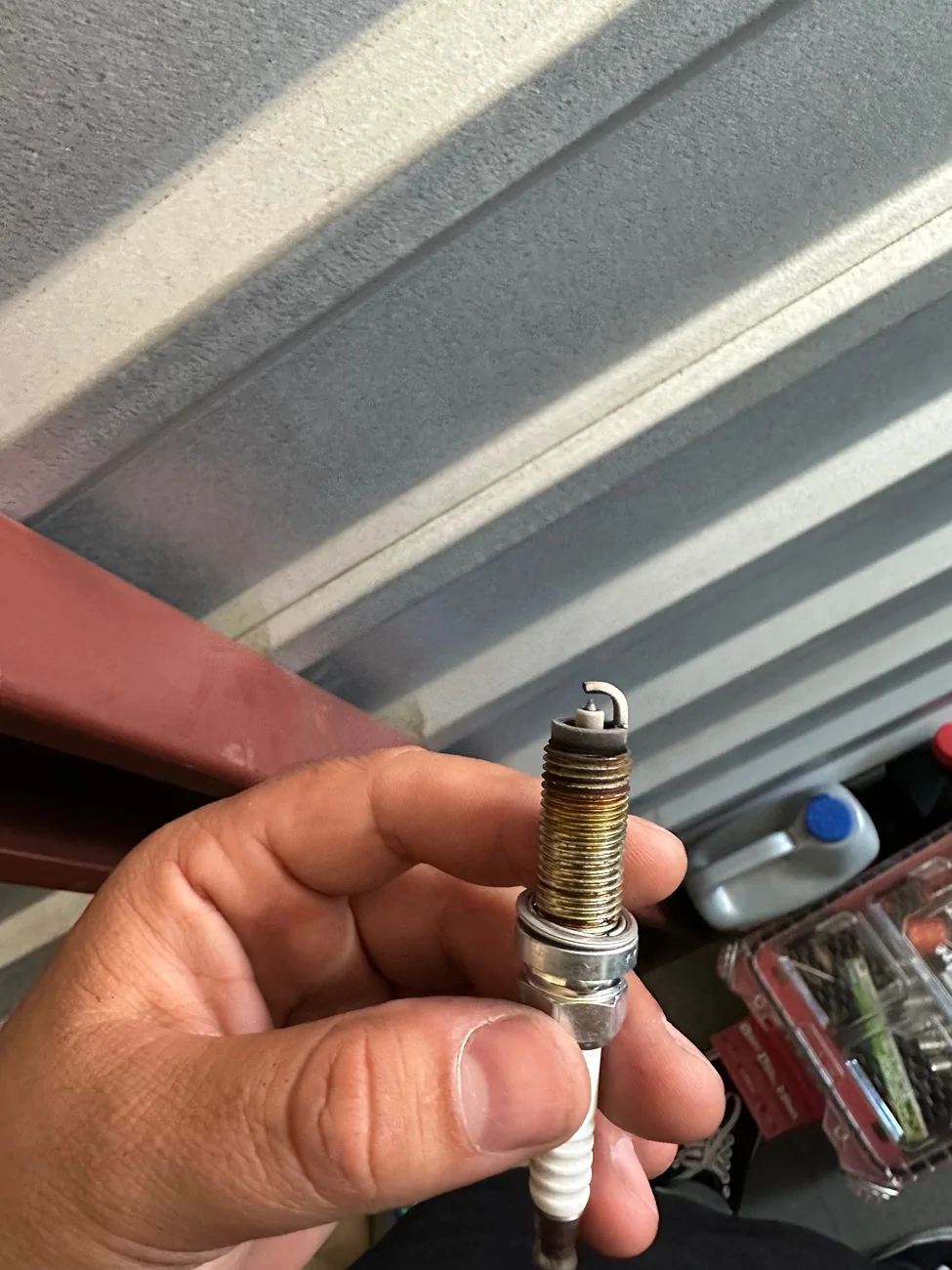

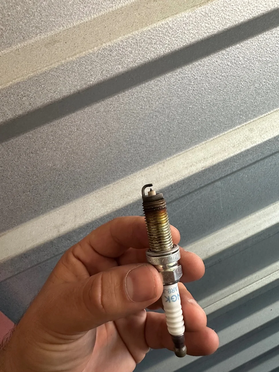

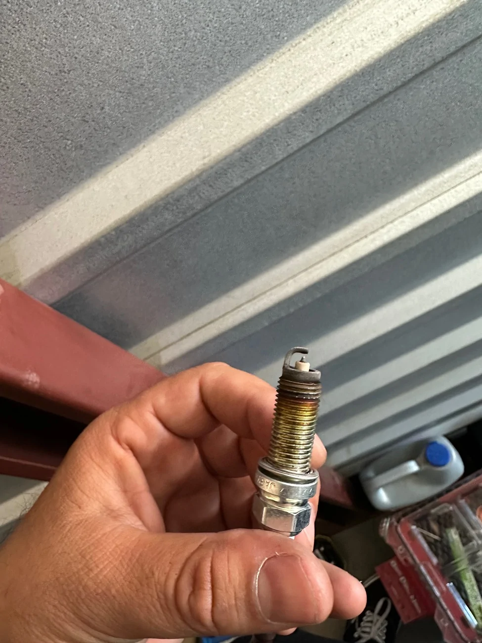

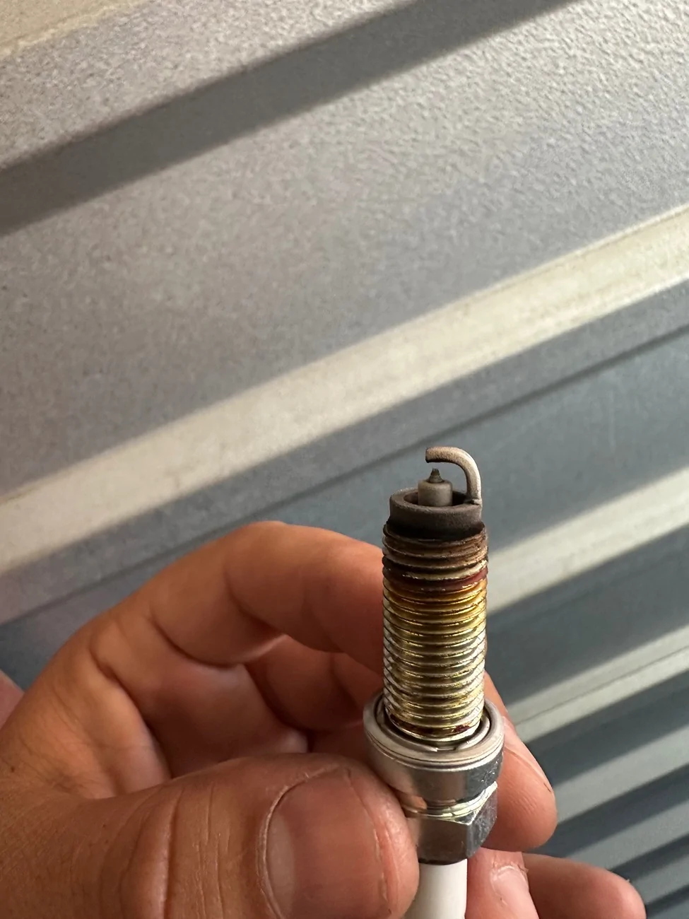

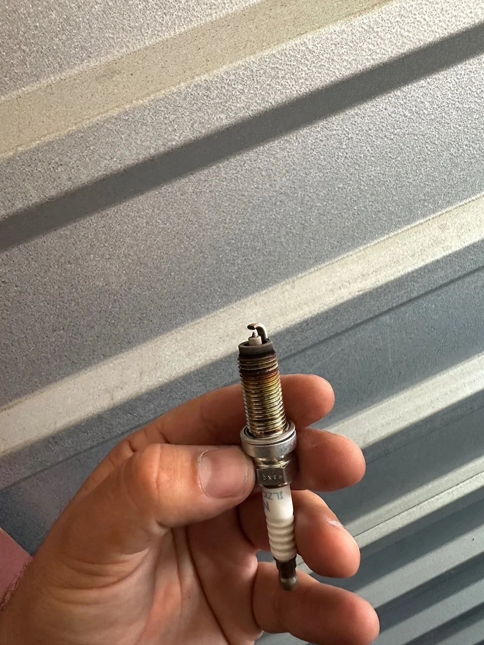

Pulled one out can anyone tell me if it’s normal ? Only 9k miles.
11th Gen Honda Civic Spark plug condition? IMG_0562
11th Gen Honda Civic Spark plug condition? IMG_0563
11th Gen Honda Civic Spark plug condition? IMG_0564
11th Gen Honda Civic Spark plug condition? IMG_0566
11th Gen Honda Civic Spark plug condition? IMG_0565

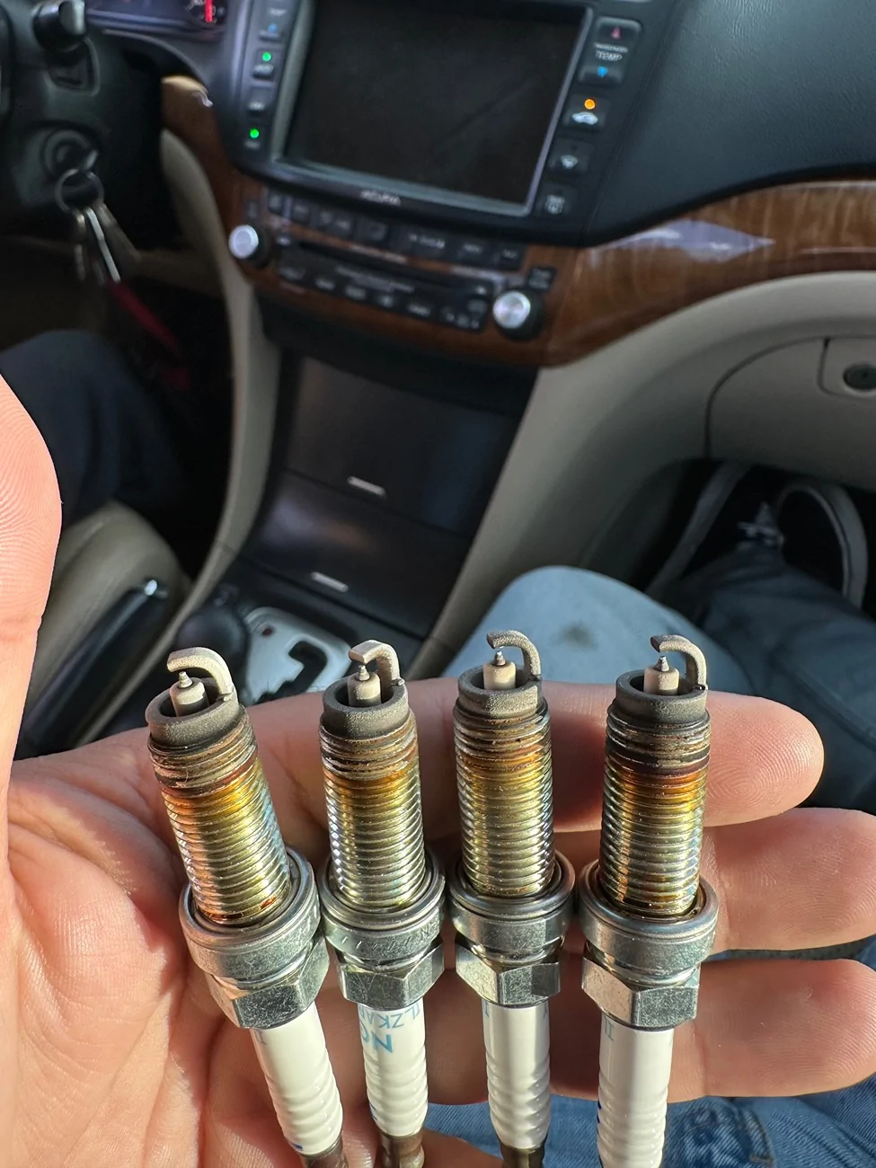

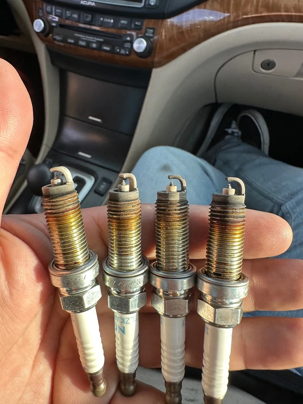

Reason I’m asking is a friend of mine who’s a mechanic said it looked like I was burning coolant. In my defense I am tuned, was running e40. Again this is only one spark plug. I’ll pull the other 3 tomorrow and post pictures I don’t known how to tell between good or bad spark plugs.
if you arent losing coolant or having issues then i wouldnt really worry about it.. id check gap as suggested previously.. also cant really judge much from A spark plug

Thanks. That’s correct no coolant was lost or needed. Car has about 8k miles.

looks good to me.. they all look like they burning the same.. i wouldnt be worried at all if you arent experiencing anything..

I don't see any issue with those pictures either.

They look normal. Burning coolant usually steam cleans everything in the cylinder(s), including plugs.
Borescoping is a good way to confirm head gasket coolant leaks, but use a good scope that won't lose the tip inside the cylinder. Otherwise look down the spark plug holes with a mini-Maglite. Piston tops should all look the same.
