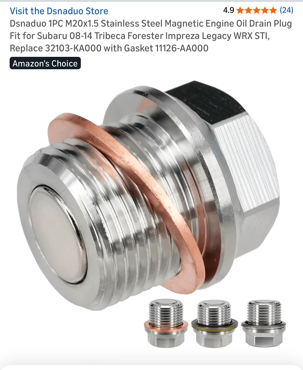

I ended up ordering other one instead will get replaced on the next’s change if everything goes well thanks for the recommendation, but also people here talk so much about the "impressive" quality of the JDM parts and everyone suck it up so much if you say something negative you get bombarded with you’re wrong and all that other nonsense. I thought that by getting a part from a "reputable" brand will not be affected. But like everything you overpay for parts to get played. Thanks for the recommendation will definitely check out the one I ordered had better reviews and is steel rather than aluminum also my EVO used to have magnet on the transmission and also a magnetic drain plug I assume that by putting one will have the same effect that on my EVO will no hurt anything.
Man, I would not roll the dice on an alphabet-soup brand from scAmazon either. WTF is "Dsnaduo" if not randomly-generated gibberish? You think they're going to back you up if the magnet comes out of that one? That company is in China and they're purposely setup to have zero liability exposure in the US market. That's the way all alphabet-soup brands on scAmazon operate.
The only company I would vouch for making aftermarket magnetic drain plugs is GoldPlug. I have also heard good things about Dimple, but haven't used them personally.

Thank you for sharing and catching that cancel the order and look up the Goldplug company thank you for the suggestion.

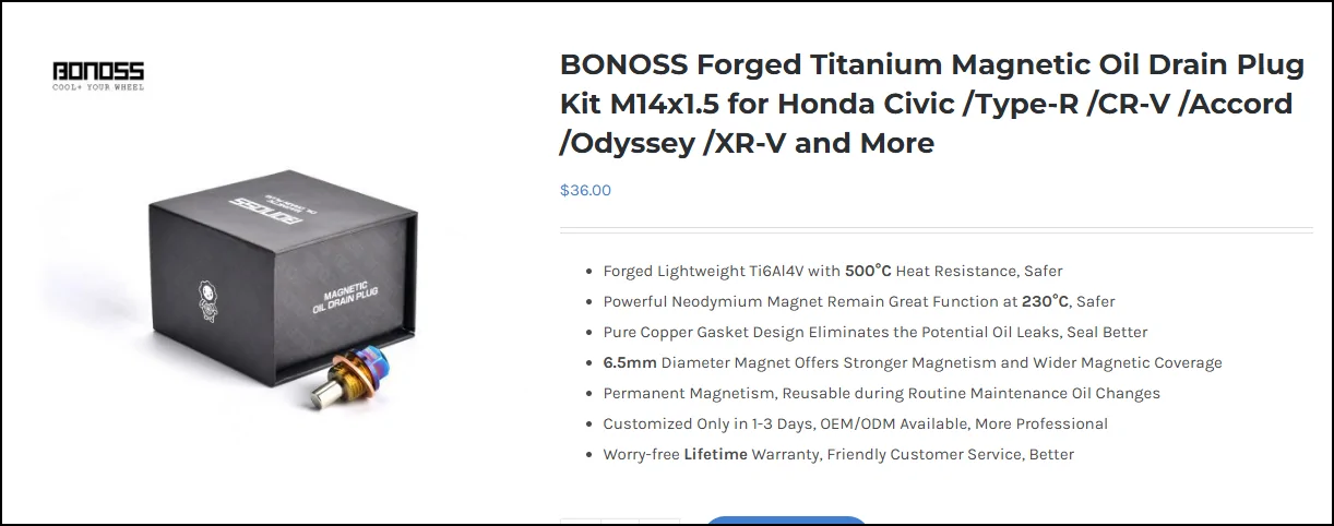

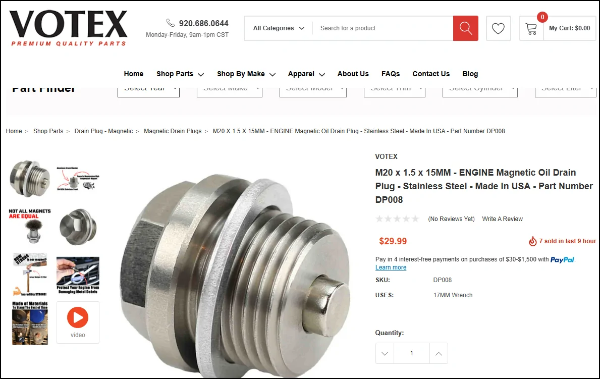

I ended up using a Votex plug for my transmission and a bonoss plug for my oil pan.
Quality and fitment was excellent. I have only put a few hundred miles on them, so don't know the longevity of them as of yet, but will keep an eye on it.
Overall they seem to be some of the better options.
https://votex-us.com/DP008?searchid=19077&search_query=dp008
https://www.bonoss.com/product/bono...Sd7wHRlD_a27W_y9NzoCxPWzvLISaxT4wNOWuoWj8DaYi
Votex is good stuff. This is what we run on all our shop cars and recommend to customers.
We do NOT recommend any aluminum plugs, regardless of reputable brand or not, for the same reasons already listed here.

Votex or nothing
