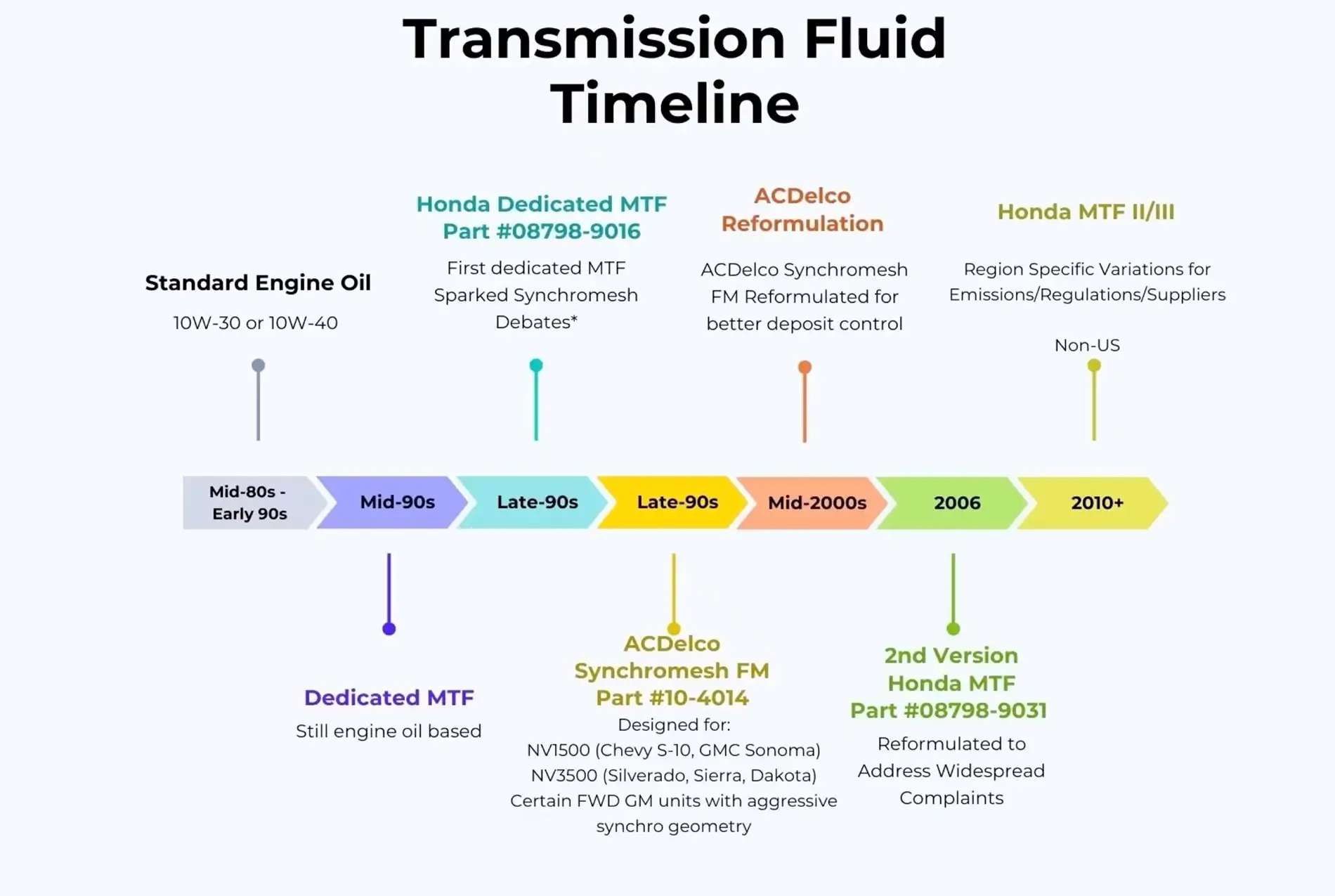

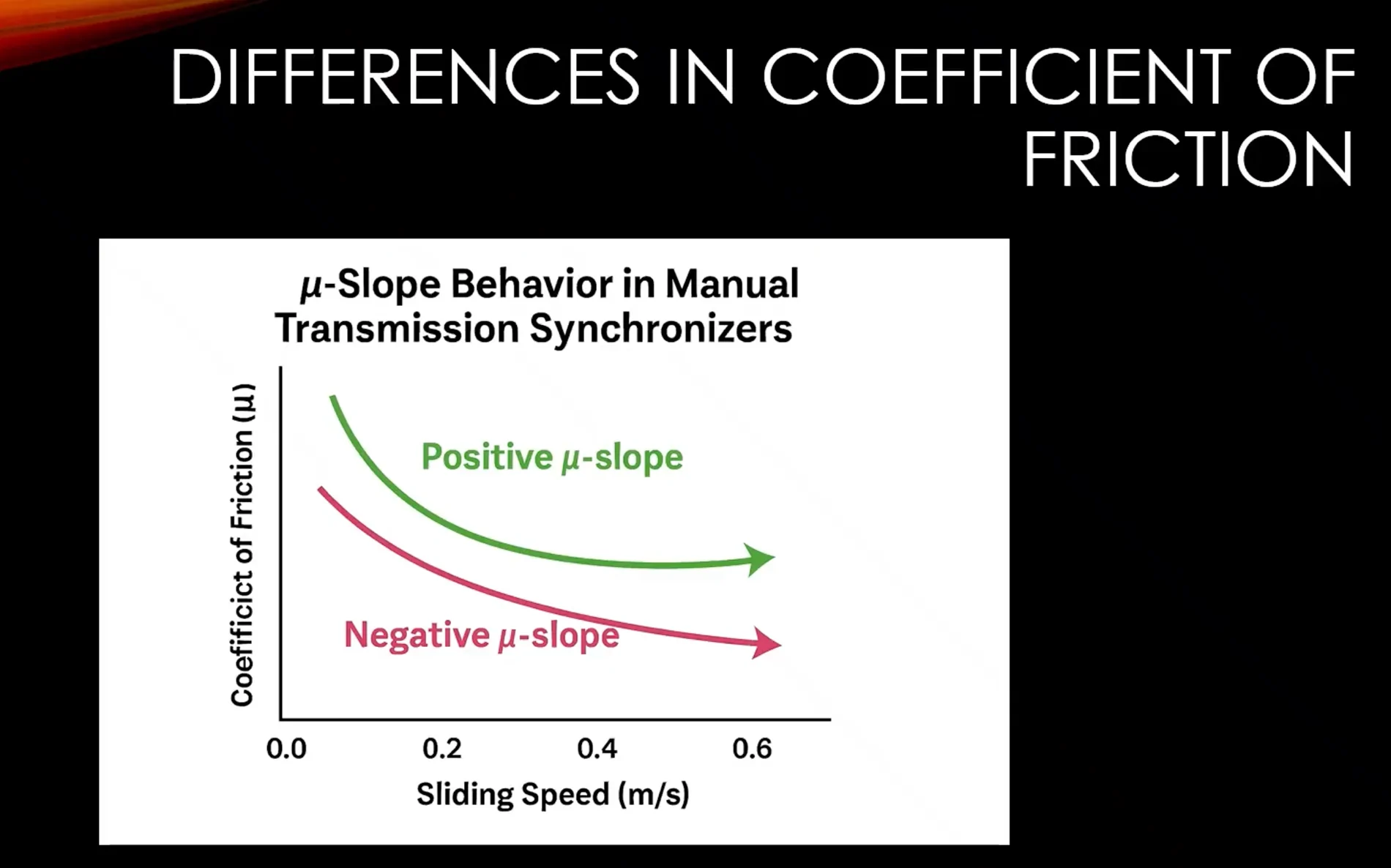

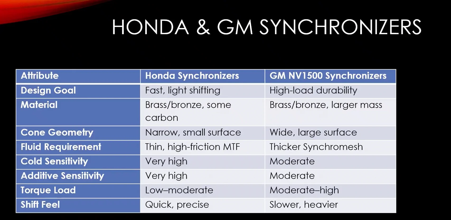

How often ( # of track days and miles ) are you guys changing the transmission fluid with and without a transmission cooler?
Without a transmission cooler:
every 3–4 track days
, or about 2,500–4,000 miles max
With a well-designed transmission cooler and actual temp monitoring:
every 4–6 track days
Also does anyone have Blackstone reports on this?
(I've just sent my second one in and every time I change the transmission fluid MTF - feels super nice ) I really want to track hard data on this as well. I'm keeping my car close to stock as a baseline for the 2 more years under warranty and seeing what are the limits within stock form, and adjusting service intervals accordingly. So far the engine oil data is excellent, now would like to start tracking the tranmission oil analysis data also.

The video’s engineering claim is that current Honda MTF is the more appropriate long-term lubricant for Honda/Acura manual gearboxes because its viscosity, shear behavior, and friction characteristics are described as being tuned to Honda synchronizer geometry and materials, whereas A/C Delco Synchromesh Friction Modified was developed around a different GM synchronizer/cone design and torque/load environment. It argues that the commonly reported smoother shift feel from A/C Delco comes primarily from its higher viscosity and different friction-modifier package, which can temporarily mask wear or soften engagement, but may do so by moving the synchronizer away from the friction curve Honda intended rather than by improving true synchronization efficiency or durability. The evidence presented is comparative and inferential rather than controlled test data: a historical timeline of Honda fluid evolution, quoted viscosity/API differences, and a synchronizer-friction model, leading to the conclusion that modern Honda MTF is the higher-confidence default for healthy Honda transmissions, while A/C Delco may be best viewed as a niche or temporary workaround rather than a proven superior fluid.

I really wish you'd quit posting AI slop on this forum.
Like for real. It's REALLY annoying. At the bare minimum, can you please stop posting it in my thread? Keep it in your own threads.
There are two main versions of the ACDelco Synchromesh fluid, 10-4014 (in the white bottle) and 10-4006 (in the black bottle.)
Both are very good fluids. The 10-4014 is labeled as "Friction Modified" however all manual transmission fluids have at least some friction modifier additives to help the synchros work properly, and my understanding is that 10-4014 just has more than the regular blend in the black bottle.
From what I've read, 10-4014 was specifically developed to resolve problems (warranty complaints) in one specific transmission, the NV1500 installed in late 90's S10s. The complaints surrounded gear grinds early in synchro life and without abuse. Originally, these trucks specified the black bottle Synchromesh (10-4006) and GM introduced Synchromesh Friction Modified (10-4014) in an attempt to stave off warranty replacements.
Hondas have had issues with early-onset second gear grind for decades at this point, and people have repeatedly posted success stories using 10-4014.
If you are not experiencing second gear grind, I'm not sure I would automatically jump to ACDelco 10-4014. It probably won't hurt anything though. And the viscosity difference isn't that big of a deal unless you live somewhere that it gets into the double-digit negatives every winter.
