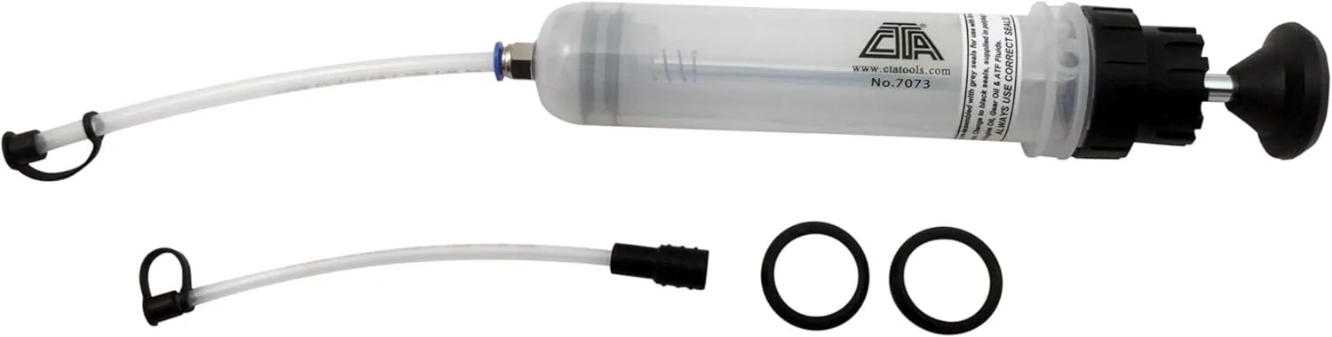

My goal is to change the gear oil every two oil changes, but want a quicker way to do it without taking the airbox out every time, and my understanding is the dealership has a method to do this.
Wondering has anyone tried to simply fill via a syringe via the 10MM check bolt and drain it from the bottom?
Technically this seems like it would work simply removing this 10MM Bolt while doing an oil change. Would this work Step 1) Remove 10MM bolt Step 2) Remove Trans Drain plug and Drain Step 3) Install Drain Plug with new Crush washer Step 4) Fill Trans Fluid with Syringe via 10 mm check hole 5) Install 10mm w/crush washer - Done.
CTA Tools 7073 Filling/Extracting Pump
11th Gen Honda Civic FL5/DE5 Transmission fluid reference 1772148519789-7x
https://www.amazon.com/gp/product/B015Q1JNBO/ref=ox_sc_act_title_1?smid=ATVPDKIKX0DER&psc=1
I checked this size of the hole of the check bolt and seems a small syringe would work.
It seems this technically would work and would allow me to change it more often maybe after every 4 track days, much faster.
Anyone tried this, or see a problem with it?
Thanks!

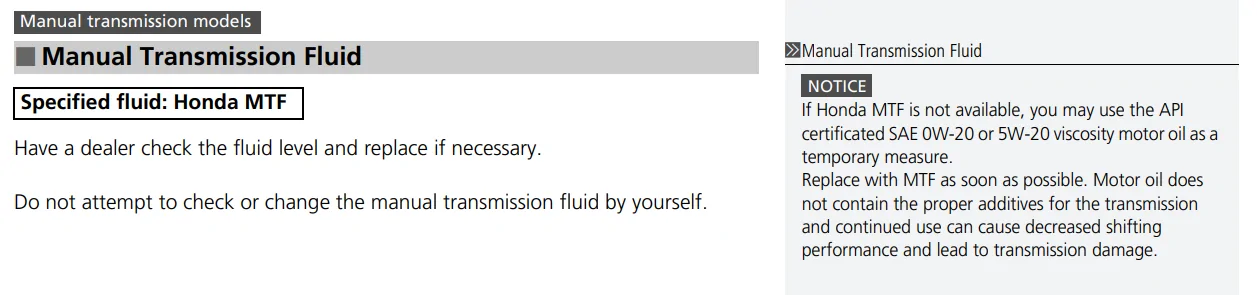

The OEM fluid in these cars is good old Honda MTF. According to the 2025 USDM Civic Hatchback owner's manual:
Honda doesn't specify a gear oil weight for this oil, however it's in the neighborhood of a straight 70W or 70W-75. Honda doesn't publish kinematic viscosities for MTF either, but these are the approximate kinematic viscosities of Honda MTF as reported by folks who have done VOA on new fluid:

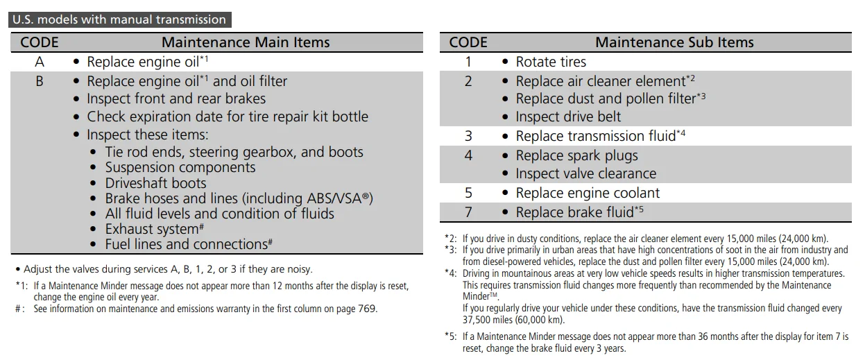

Service Interval
The "Honda Maintenance Minder" in these cars tracks various maintenance intervals including transmission fluid. When the car thinks it needs a transmission flush, it will show code 3 in the cluster, along with any other codes that may be active. From the 2025 USDM Civic Hatchback owner's manual:
And also:

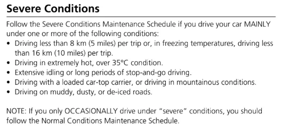

Note blurb #4 above: "Driving in mountainous areas at very low vehicle speeds results in higher transmission temperatures. This requires transmission fluid changes more frequently than recommended by the Maintenance Minder. If you regularly drive your vehicle under these conditions, have the transmission fluid changed every 37,500 miles (60,000 km)."

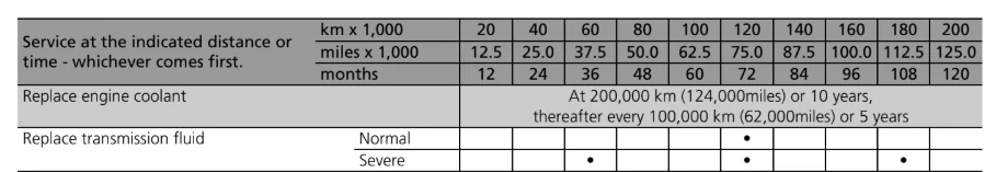

According to the UK 2024 CTR manual:
Honda states in the UK CTR manual that the transmission fluid should be replaced every 75k miles under "normal" use and every 37.5k miles under "severe" use. Severe use is defined in the UK CTR manual as:
Use your own judgement. It can't hurt to change the fluid early. In particular, many people advise changing the fluid after initial break in (600-5000 miles depending on who you ask.)

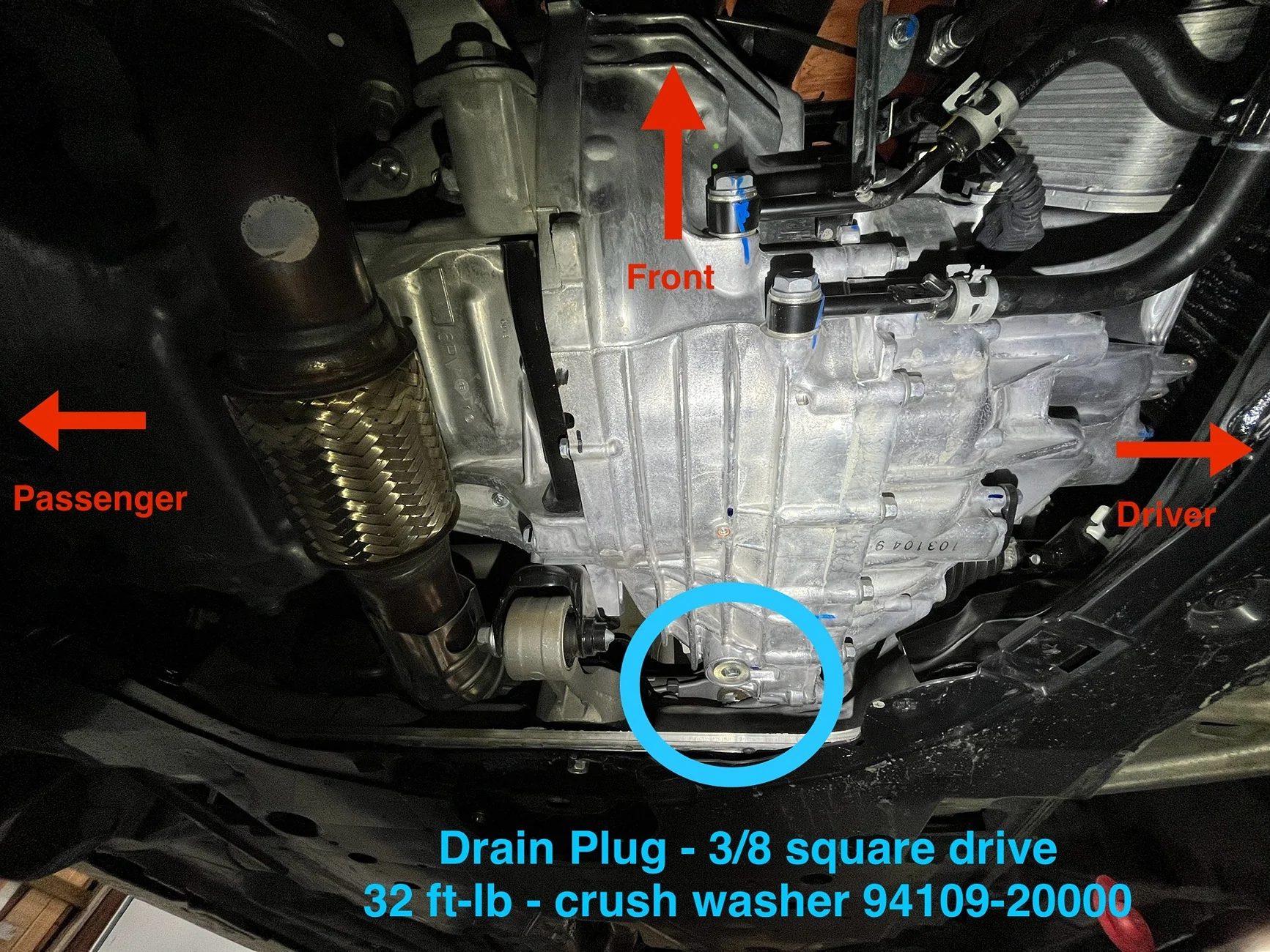

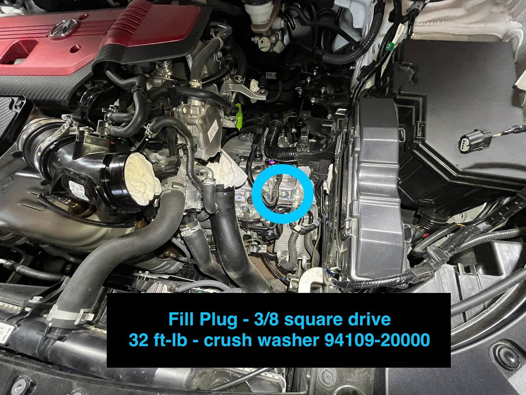

Drain and fill plugs
The drain and fill plugs share a crush washer and torque spec. They accept a 3/8" drive socket extension, or a 3/8" male pipe plug socket such as a Sunex 312PC. I would highly recommend a 3/8" male pipe plug socket, because I ruined one of my 3/8" drive socket extensions removing the fill plug. It stated to break at the ball detent. The fill plug is insanely tight from the factory and I'm not the only one to experience this.
The crush washer is Honda part number 94109-20000 and you will need two of them.
These plugs should be torqued to 32 ft-lb.

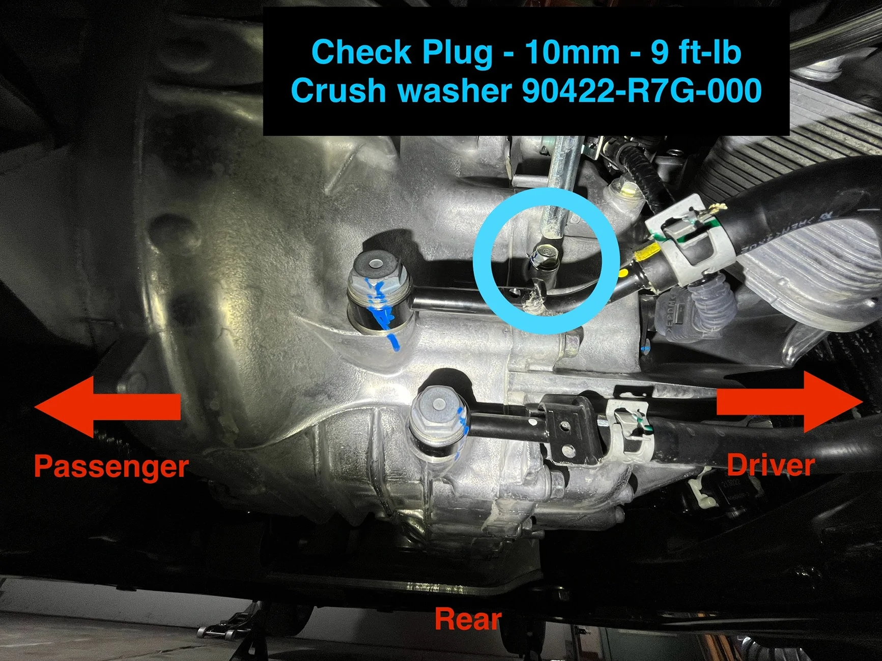

Check plug
The check plug is a much smaller bolt with a 10mm hex head.
With the car level, fill the transmission with fluid until it starts to run out of the threaded hole for the check plug.
The crush washer for this plug is Honda part number 90442-R76-000.
This plug should be torqued to 9 ft-lb.

You will have to remove the airbox to access the fill plug, which is on the top of the transmission. For instructions on how to remove the airbox, reference the first part of Acuity's instructions for accessing the cable shifter bushings. In fact, consider replacing the cable shifter bushings at the same time, since they're nearby. You might also consider deleting your clutch master cylinder damper, which is under the battery bracket.

The drain plug is on the bottom of the transmission:
The check plug is on the side of the transmission facing the front of the car:
The airbox in these cars comes out ridiculously easy compared to almost every other car I've ever worked on.
Remove the sensor and pull it back, release two snap-in clips for some other wires, four 10mm bolts, a 5.5mm bolt on the hose clamp, and it's out.

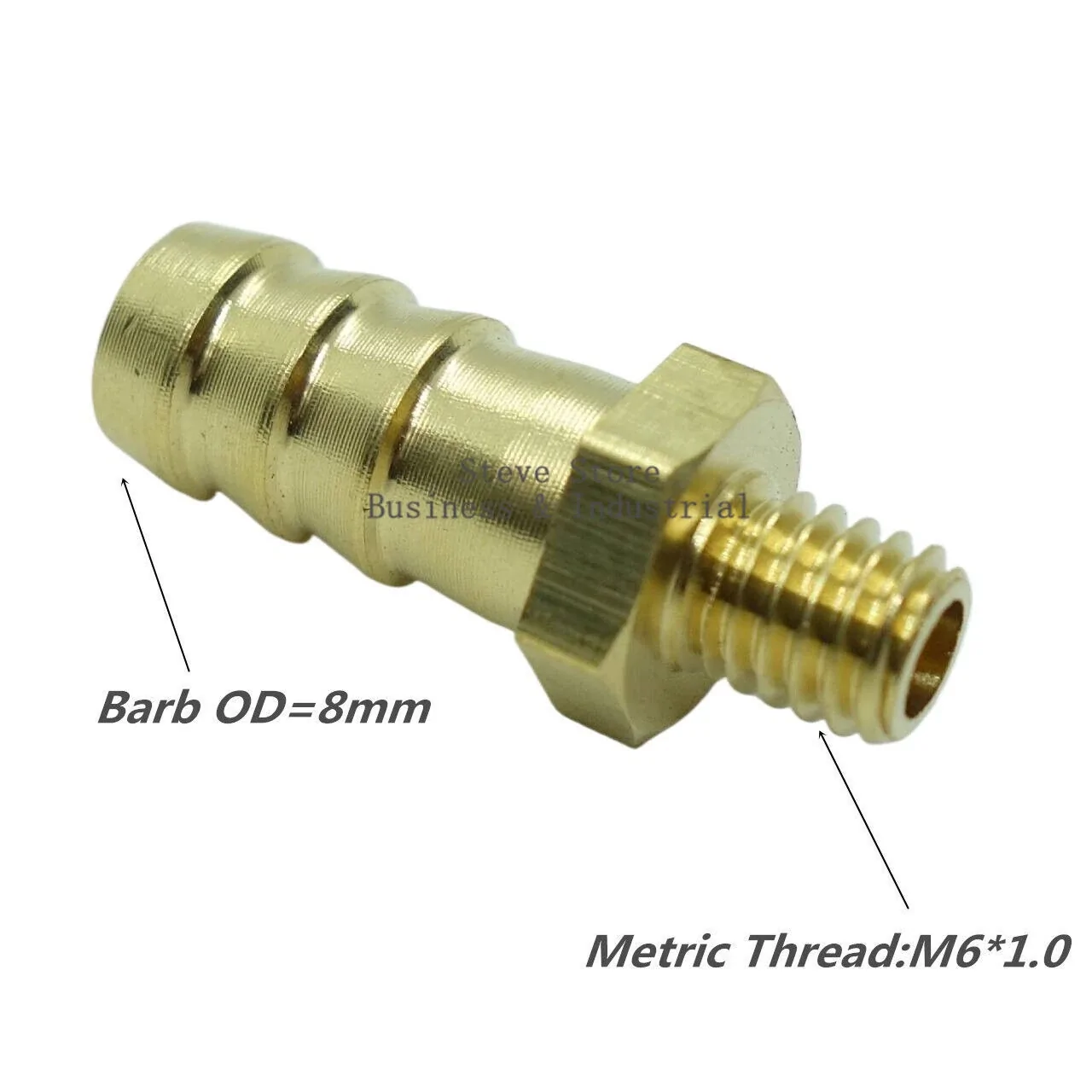

You will waste far more time than that attempting to pump fluid in through that tiny hole with a syringe. I believe the threads are M6?

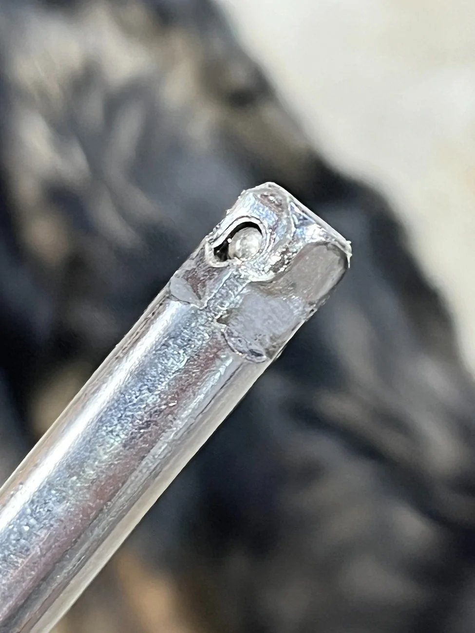

If you are serious about doing this and want to spend some money and effort to gain any sort of efficiency, I would recommend purchasing something like this:
11th Gen Honda Civic FL5/DE5 Transmission fluid reference 1772151082454-rc
That could be threaded into the check hole. You'd want to add a rubber washer or similar to form a temporary seal. And double-check what the treads actually are, both size and pitch.
And then getting what you need to hook that up to a fluid transfer pump of some sort. This could be as simple as a repurposed brake bleeder with a large enough reservoir, for example:

Motive also has a larger version of their brake bleeder (one gallon vs 2 quart) that's specifically for this type of thing: https://www.motiveproducts.com/products/powerfill-pro-1-gallon-tank
I like that it has a ball valve, but I'm not sure what all fittings you would need. If you were to use the M6 to 8mm barb fitting like I posted, I would want to connect it to one of these:
https://www.motiveproducts.com/coll...eplacement-quick-release-male-female-fittings
That would let you make an adapter that you can thread on without a bunch of hose getting tangled.
Motive also sells spare clamps, hose, etc:
https://www.motiveproducts.com/collections/replacement-parts-accessories
I have one of those and they are excellent for this kind of job. Transmissions, differentials, transfer cases etc. Also, it's big enough to get a gloved hand inside of it, so I can wipe it out when switching from trans fluid to gear oil.
