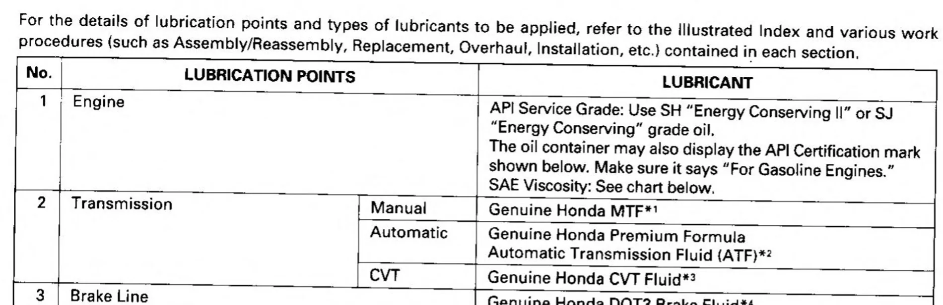

I have come across so much uninformed nonsense on this topic. It's actually worse than the uninformed nonsense regarding engine oil, because while using "MEGA-BRAND X" instead of "brand Zā„¢ " likely will do no harm assuming they're both API engine oils, gear oil is a much broader spectrum with much looser requirements and far more varied applications. Only knowing a small part of the picture when it comes to gear oil can easily result in going wrong.
Starting off with the science

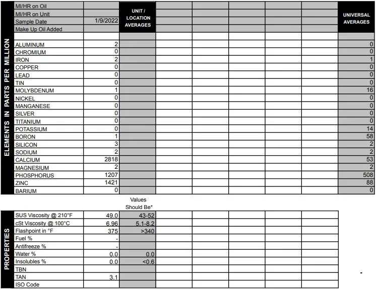

The Honda MTF recommended by the US owner's manual is, quite literally, an engine oil with different additives. There's actually not a lot to it. Labs like Blackstone use ICP spectrometry to determine the elemental composition of used or new oil samples. Here's a "Virgin Oil Analysis" or VOA showing what's in the US-made "Honda Genuine" MTF:
Credit to himemsys at BITOG for that.
The main additives here show up in the form of calcium, phosphorus, and zinc.
VOA Interpretation
Here's what subject matter expert MolaKule (someone who works in this industry and has formulated lubricants) has to say about the above lab result:

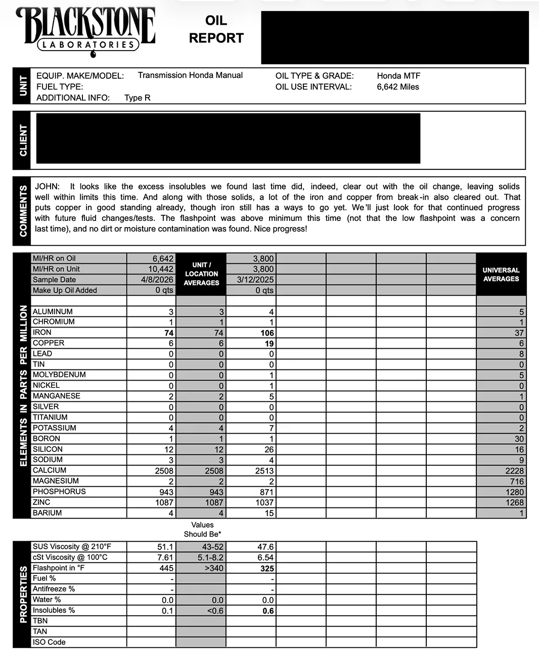

For a few smackeroos, send your used trans fluid off to a lab such as Blackstone or SPEEDiagnostix and find out what wear metals are floating around in there. They will send you a UOA or Used Oil Analysis looking something like this:
Credit to @johnloov for that UOA.

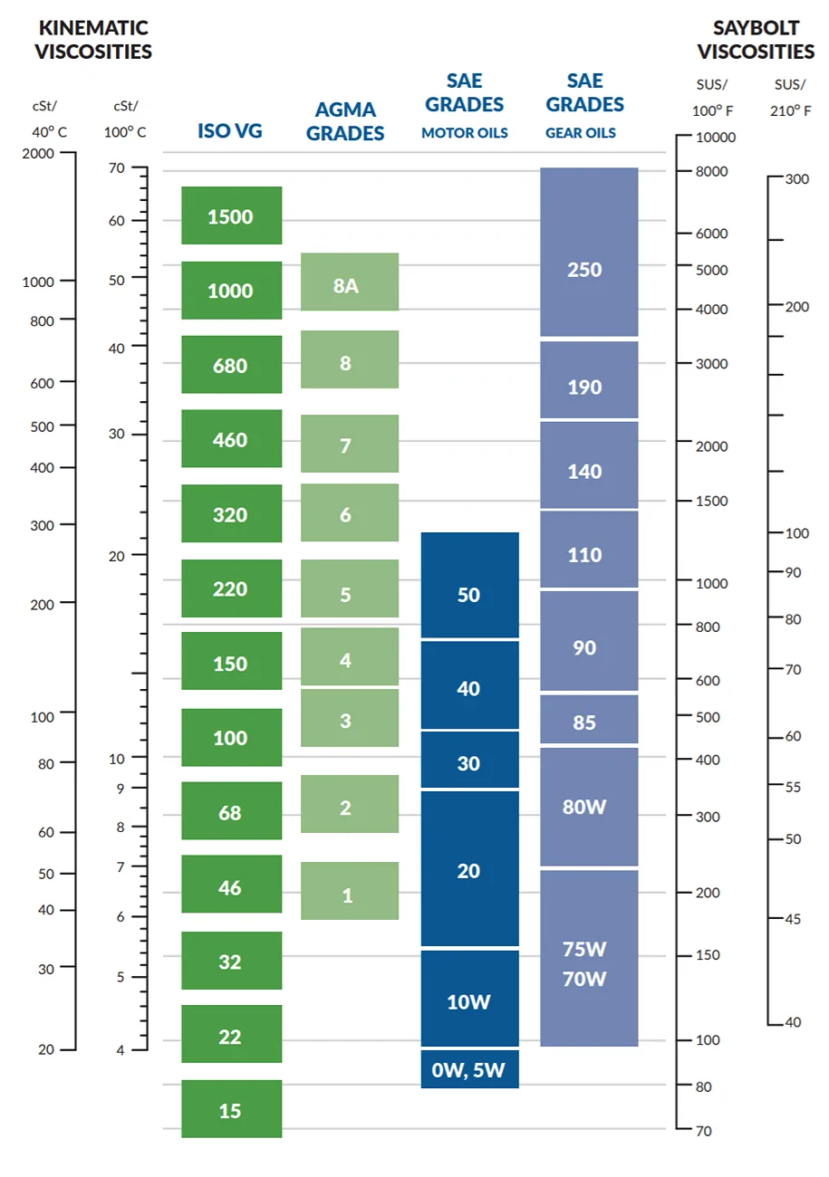

    • Honda MTF is quite thin, somewhere between a 70W-75 and a straight 70W.
    • If that sounds thick, it's not. It's closer to 0W-20 motor oil, however gear oils and motor oils use different scales in order to avoid customer confusion.
    • Using a gear oil close to the Honda MTF spec is likely a good idea if you live in an area that gets extremely cold winters.
    • Going up in SAE oil weight may be a good idea if you never deal with extreme cold, or you track your car regularly.
    • I cover various fluids organized by oil weight in this thread.

This is why it’s critical to change your motor oil and transmission oil frequently in breaking in both. Removing contaminants until you see a stabilization in Parts per million. Looks like the engine is stabilized, but the transmission needs a few more flushes. The transmission fluid on my Type R transmission after two changes is still off the charts — consistent with lake speed juniors analysis on his Toyota, which means I need to flush out all contaminants from the transmission to maximize longevity as all break in metals float in the fluid and caused the most damage with the engine and transmission. It also explains why my transmission feels much better every time I change the fluid and there’s a question as to is peopleā€˜s perception to changing to a different brand the difference or the fact that they’re flushing out the transmission fluid no matter, you have to clean those wear metals out. Data data data is the only truth we can empirically measure. This is exactly why in my first startup we analyzed all flight data recorder data, and built systems for the major airlines, and we adjusted maintenance schedules based on data. This transmission fluid data proves you need to flush it out much more than I expected. I should’ve been changing it with every engine oil change (2-3k miles) until I saw ppm stabilize. It’ll be interesting to see other people’s Gear oil analysis, and parts per million and see if it performs better than the OEM fluid.
