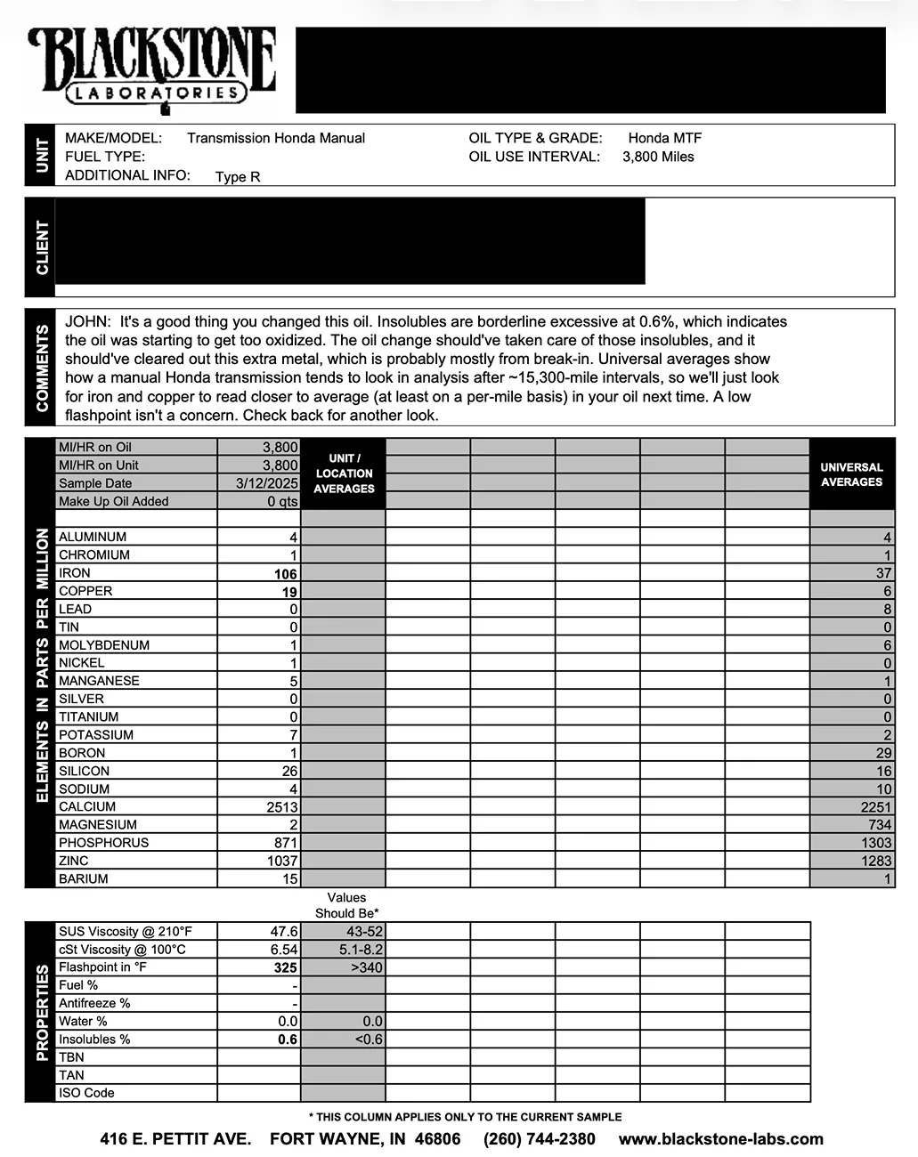

Here is my Blackstone report after 3800 miles with the Factory fill - Tracked mostly 80% of those miles at Laguna Seca. In two weeks we will have the 10,000 mile report, and it was also mostly 80% driving to track and racing and back into the garage. I will drive 4 track days at COTA and ~2000 miles before the next transmission MTF fluid change and sync with my oil change to see if that service interval is best. I'll stick with Honda MTF as a baseline then experiment with other brands. If anyone has a Virgin Oil Sample of MTF, please provide it as a baseline.

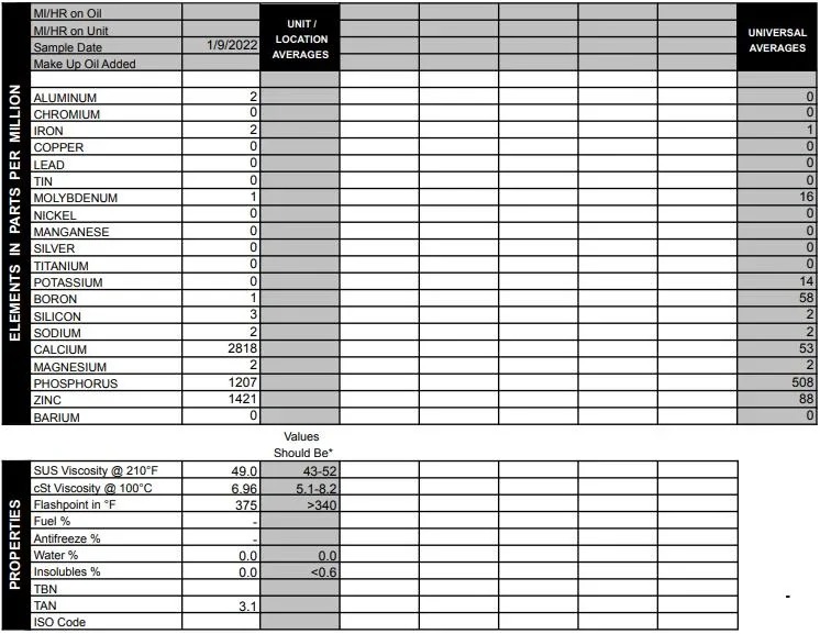

This was posted as a VOA of Honda MTF on BITOG by user himemsys:

Here is what I am deducing high level from that data:
1) Flashpoint 375 down to 325 - Inline with heat
2) Iron 2 up to 106 - big jump - real wear metal in oil
3) CST 100c - still in grade - 6.96 down to 6.54
4) Silicon 3 up to 26
The first transmission fluid change - I assume also had break in contaminants
I'll probably stick with changing the oil and transmission fluid together at 4 track days and ~2000 miles. I was advised I could go two oil changes before changing transmission fluid, but that may not be the case on a stock setup without an oil cooler.
Appreciate the feedback

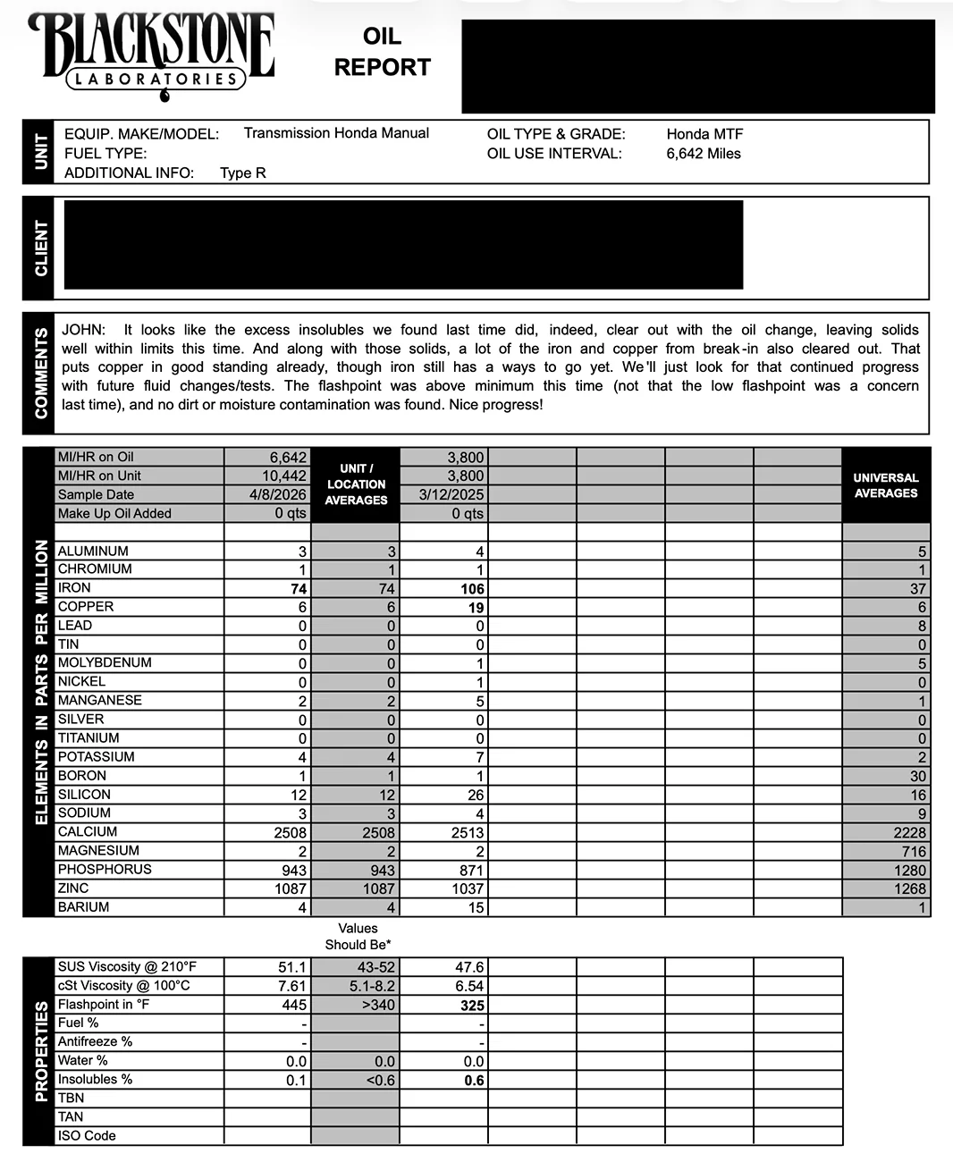

Here is the latest Blackstone results from the transmission fluid.
This was about 10-12 track hard track days - 6,642 miles since first change with MTF - 10,442 total miles on car.
It was much better results than I expected vs first change. Flashpoint 445F. Has Honda changed the formula?
Now curious what transmission fluid was in there from the factory that didn't perform as well, or was the initial break in that aggressive?
11th Gen Honda Civic FL5/DE5 Transmission fluid reference 1776781283485-tj

Interesting regarding the flashpoint. I don't know what would change that.
(Not saying it's impossible that it's the same fluid, but I just don't know.)

Here is another interesting observation after racing on the latest MTF transmission fluid. After the first flush the transmission felt much better and after the second flush it felt even better, and now I'm wondering is that what we all should be doing - flushing out break in metals during the initial break multiple times within 10,000 miles. Maybe 3k, 6k, and then 10k. It takes 10,000 miles also to break in and flush out all engine break in metals as we proved in the engine oil thread, and that was also backed by Lake Speed Junior.
It seems it's the case with the tranmission fluid. There is a big difference between my first change and second change.
This weekend I ran two advanced sessions at COTA and my friend also ran two days in yellow in my car, so total of 4 track days. The car got absolutely hammered.
It's looking like I will change the transmission fluid every 8 track days ( ~4000-5000 miles ) and see if that interval works out. It seems the change interval initially from the data should be at 3500 miles or so based on the data.
Honda may have changed the MTF formula - I'll check the bottle and report.
Appreciate scientific feedback.
SampleMilescSt @100CFlashpointInsolublesIronCopperRead
Virgin Honda MTF06.963750.020Baseline
Honda OEM Fill Transmission Fluid 3,8006.543250.610619Dirty / loaded up
Honda MTF 2025 USA Dealership 6,6427.614450.1746Much better

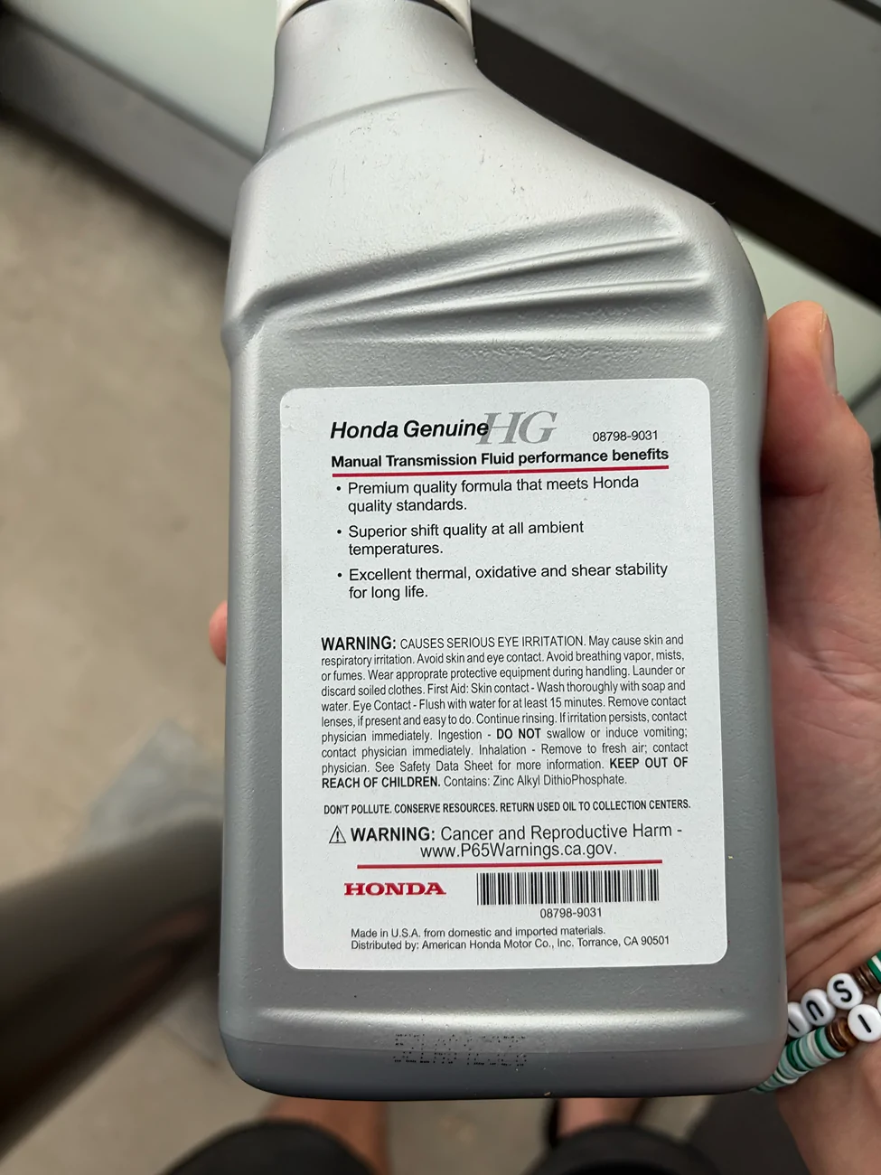

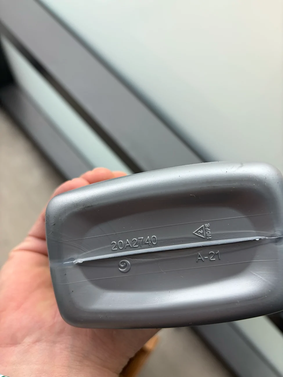

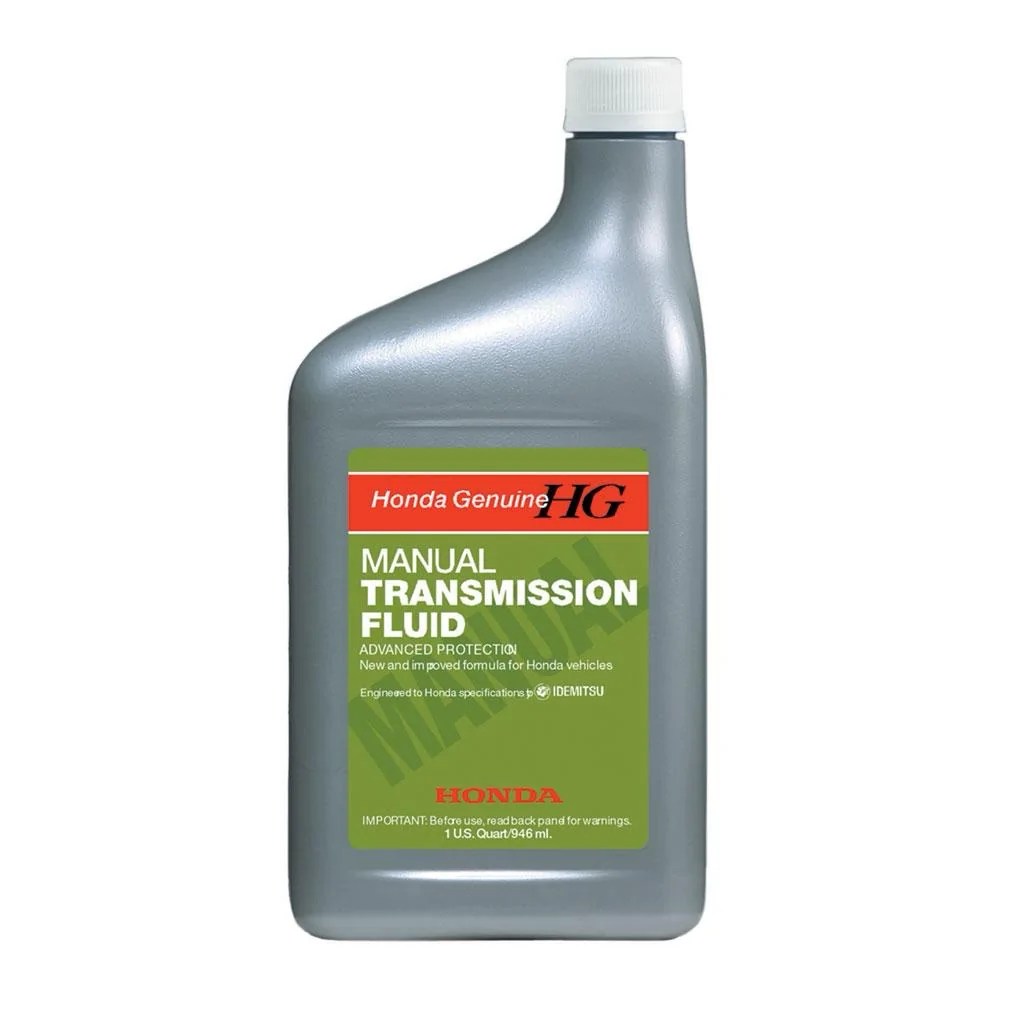

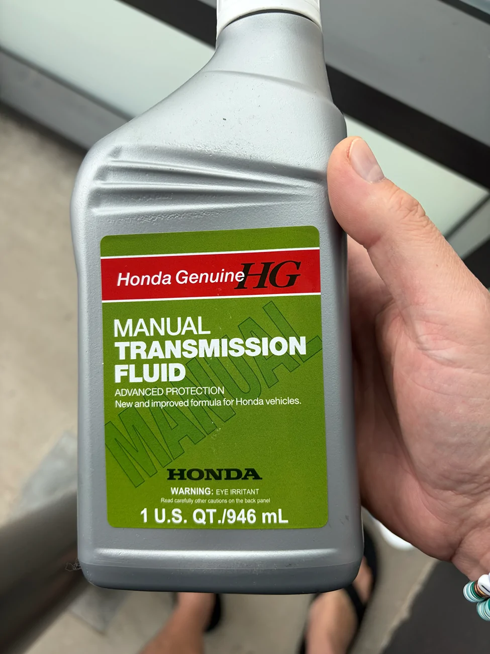

Looks like this is a newer bottle version - which says "New and Improved Formula" - I'll maybe send in a virgin sample to get it tested or just take another drain at 6000 miles and see how it performs. The newer bottle style looks like it was circulated in ~2024 ( Need to confirm ). I assume like the engine oil industry, they are constantly making improvements without announcing it. Also I smelled it, and I made a mistake saying my previous transmission fluid was burnt - it had the same burnt smell new - so making a correction on that observation. It does seem with the much higher flashpoint, Honda did some reformulation and the new formula did very well compared to what came in the car.

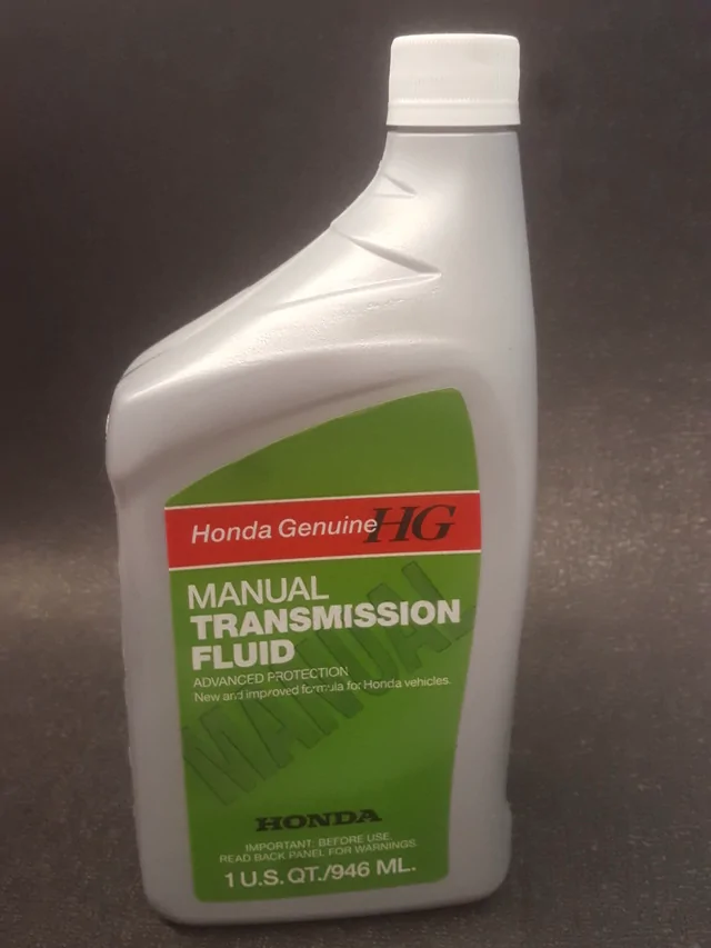

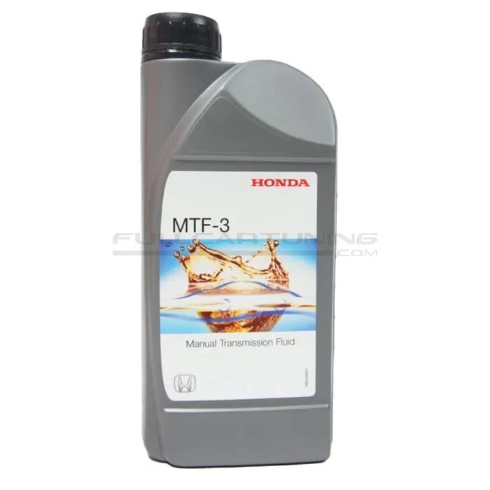

older bottles look like this -
11th Gen Honda Civic FL5/DE5 Transmission fluid reference 1776800409942-32
11th Gen Honda Civic FL5/DE5 Transmission fluid reference 1776800427227-e5

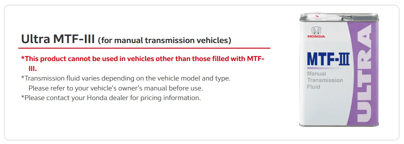

Note that the bottle you posted says that it's made in the USA.
Here's what's listed on the Japanese Honda site (used Google Translate)
11th Gen Honda Civic FL5/DE5 Transmission fluid reference 1776867160897-54

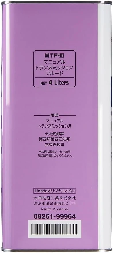

I found a part number for it of 08261-99964.
Here's a side view of that can:
11th Gen Honda Civic FL5/DE5 Transmission fluid reference 1776867465067-wk
Using my phone's camera translator, the Japanese writing appears to be boilerplate saying that it's manual transmission fluid, not to set it on fire, that it's a class IV petroleum, follow the manual, and an address in Tokyo.
It also clearly says made in Japan, in English.
So at the bare minimum, the Honda MTF available here in the US is not made in the same place as the MTF available in Japan. Doesn't mean the formulation isn't at least similar or even the same, but different supply chain all the same.

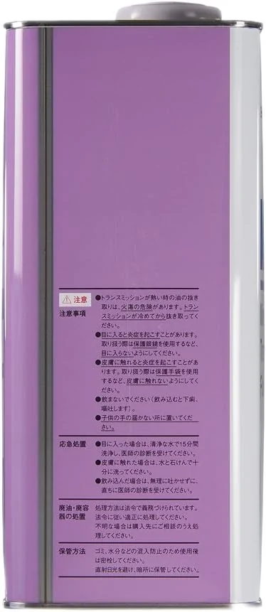

Here's the other side:
11th Gen Honda Civic FL5/DE5 Transmission fluid reference 1776867486361-wo
I used my phone's camera translator and that appears to be mostly boilerplate safety info. Nothing too interesting.

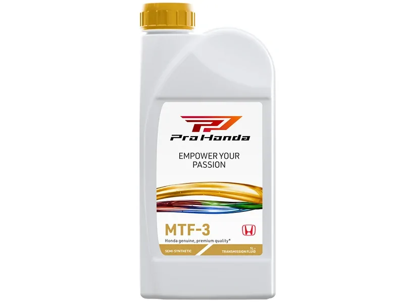

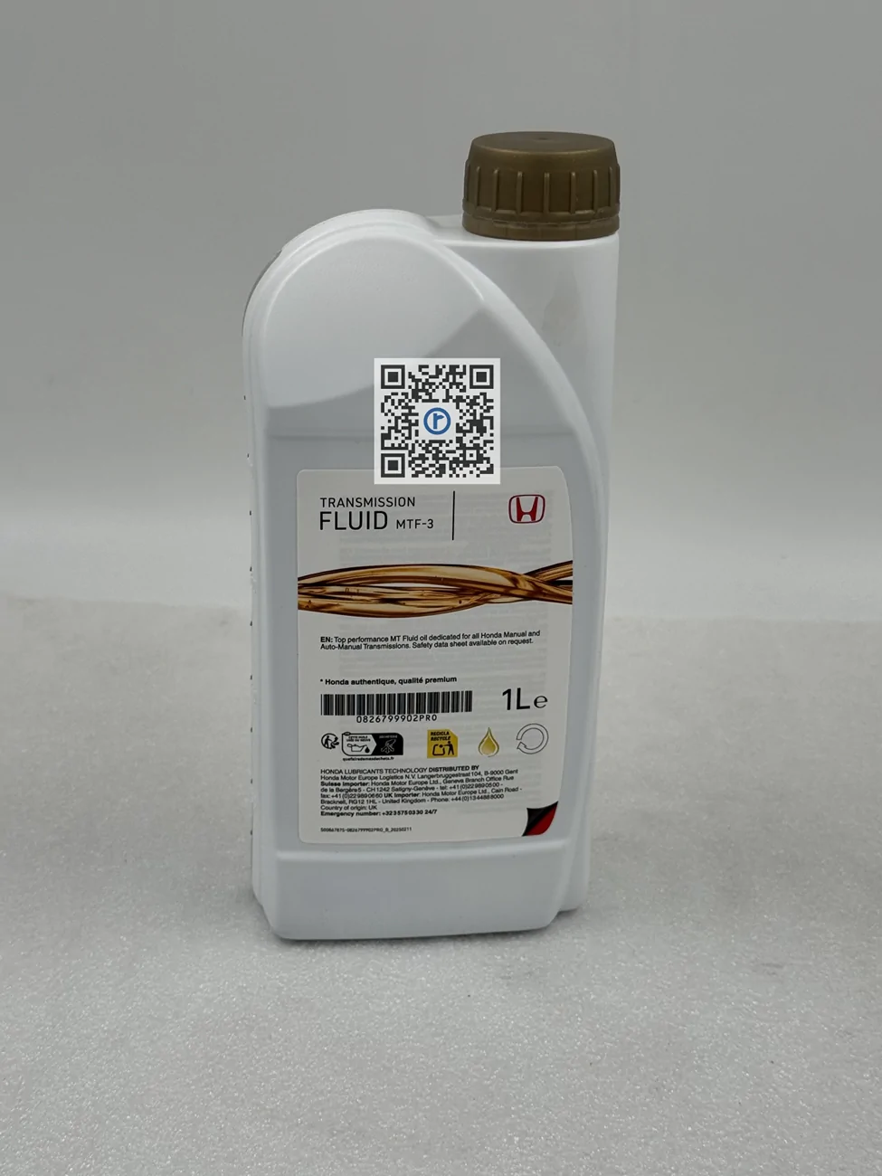

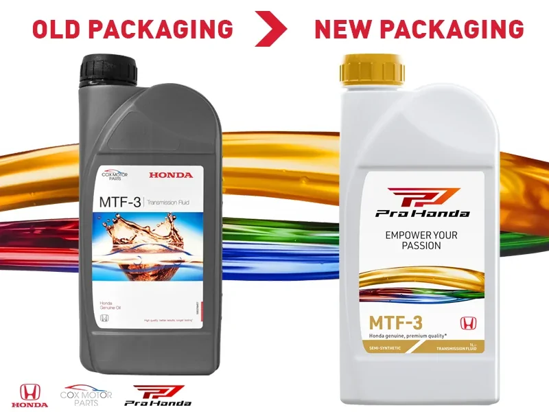

Here's another variant, this one appears to be sold in the EU.
Part number 08267-99902 (I see 08267-99902-HE and 08267-99902-PRO, difference appears to just be packaging.)
11th Gen Honda Civic FL5/DE5 Transmission fluid reference 1776868304810-m4
11th Gen Honda Civic FL5/DE5 Transmission fluid reference 1776868341823-a
11th Gen Honda Civic FL5/DE5 Transmission fluid reference 1776868385410-42
Appears to be made in the UK:
11th Gen Honda Civic FL5/DE5 Transmission fluid reference 1776868674293-nx
If that's hard to read, near the bottom it says: "Country of origin: UK"
