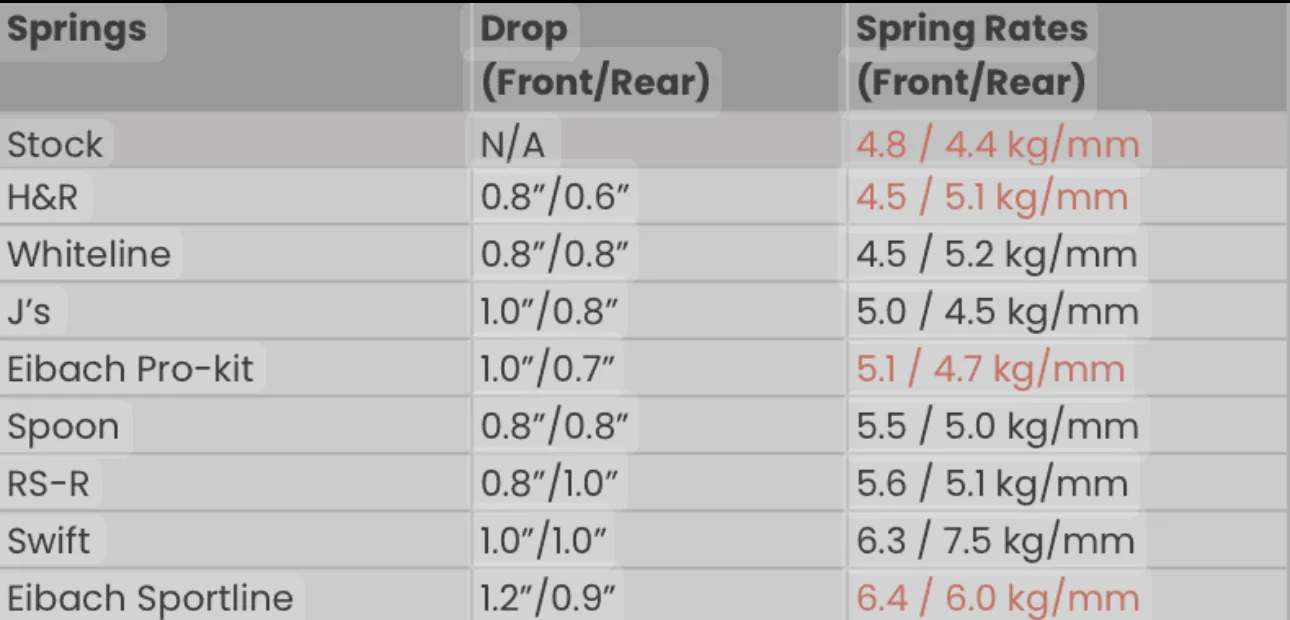

From what I’ve read from other’s experiences, spoon springs with the ITS module makes the ride too soft/sloppy. Therefore, I went with Swifts + ITS module and love it.
I thought about swifts springs but a few reviews said the ride was too harsh with the stock ads . But again everyones needs and wants are different . Also for me Spoons are the perfect drop Oem+ not to aggressive about a 3/4” . You
Might have a nice combo to with the type S module and swift springs to compensate for the stiffer swift springs . It’s so nice we have so many options for our individual needs for this awesome FL5 platform👍🏻👊🏻
