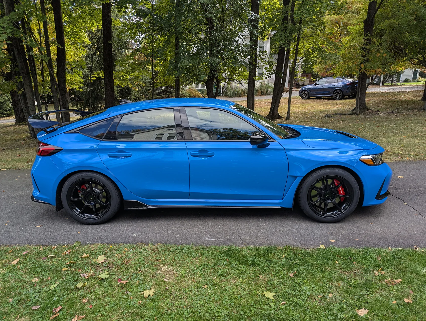

My winter setup is enkei ts-7 18/9.5+45 with dws06+ 265/40/18. no rubbing. solid performance. very comfortable ride. I have mild winters so no need for snow tires.
