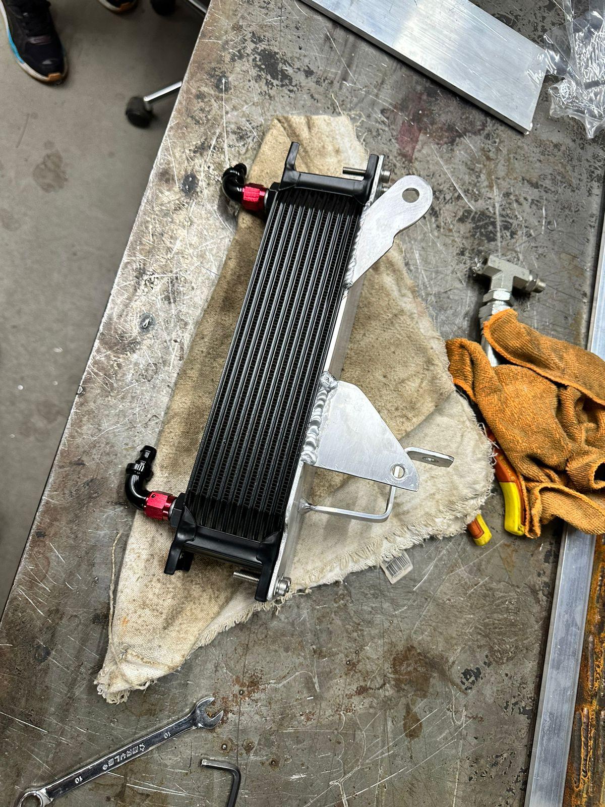

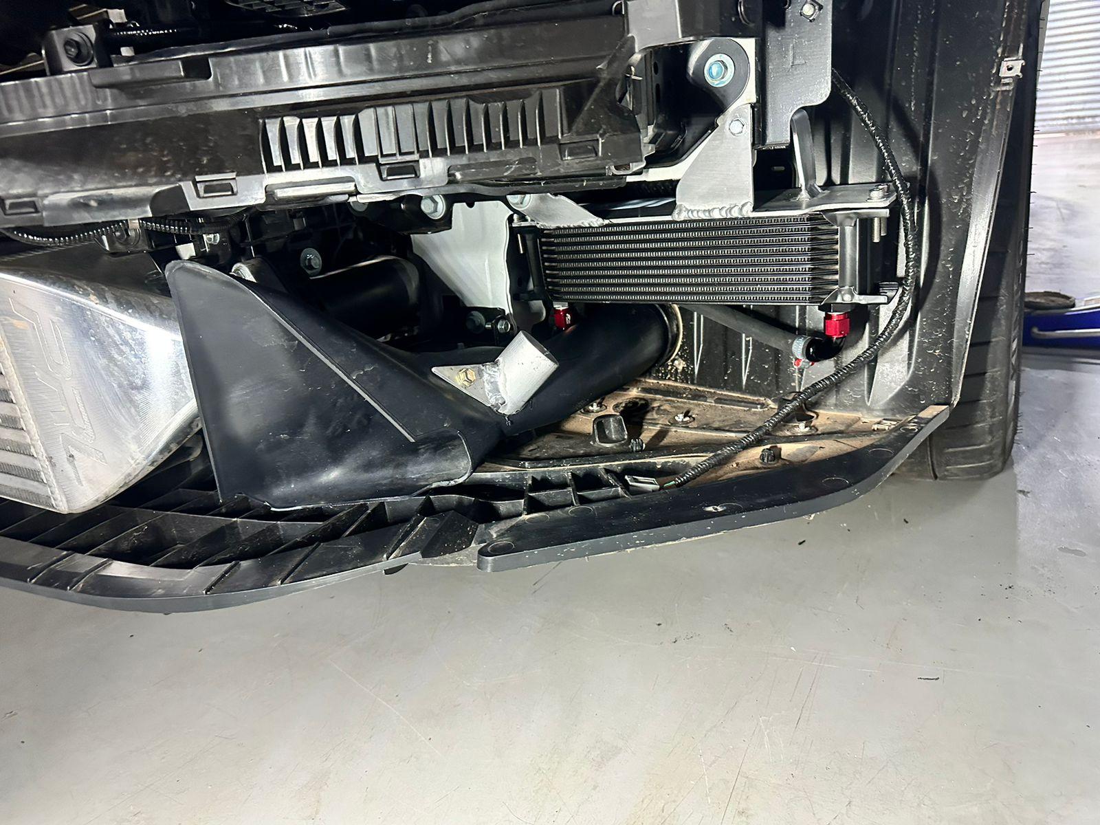

FIrst thing I made an aluminum bracket to bolt it into existing mounting points. (just because it says R somewhere, doesn´t mean sh*t has to be billet lol)
11th Gen Honda Civic Vito.FL5 Oil to Air transmission cooler install WhatsApp Image 2024-02-12 at 22.22.28

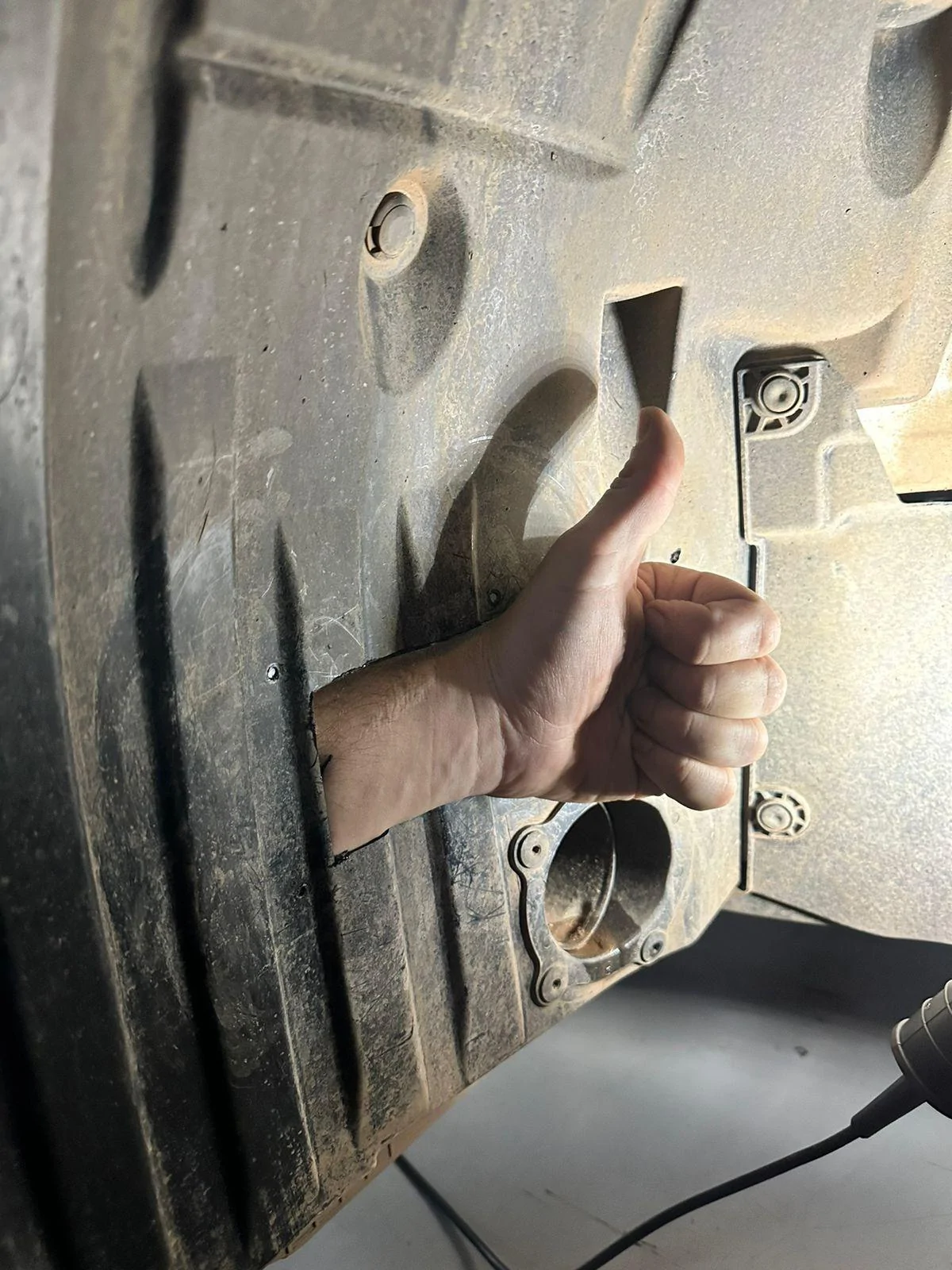

Next thing I made a vent on fender liner. (is this what this is called?)
11th Gen Honda Civic Vito.FL5 Oil to Air transmission cooler install WhatsApp Image 2024-02-12 at 22.22.27

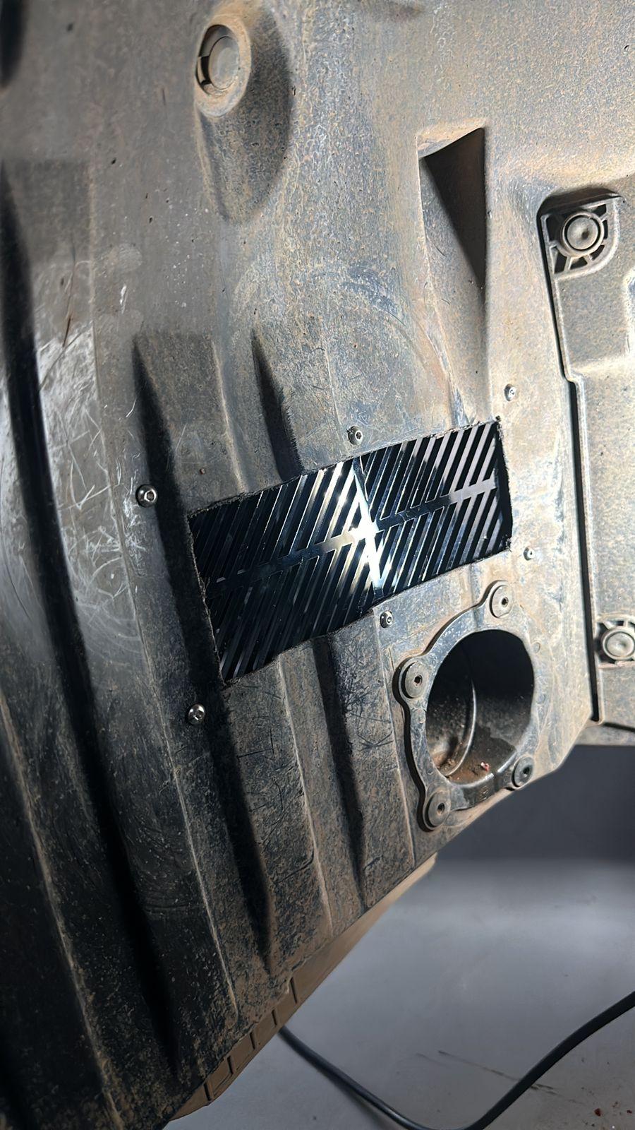

Then I laser cut a grill.
11th Gen Honda Civic Vito.FL5 Oil to Air transmission cooler install WhatsApp Image 2024-02-12 at 22.22.26

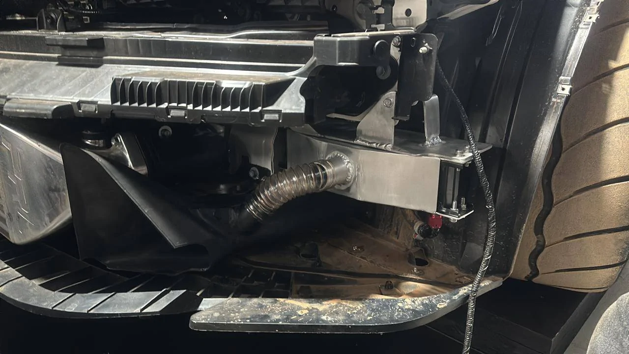

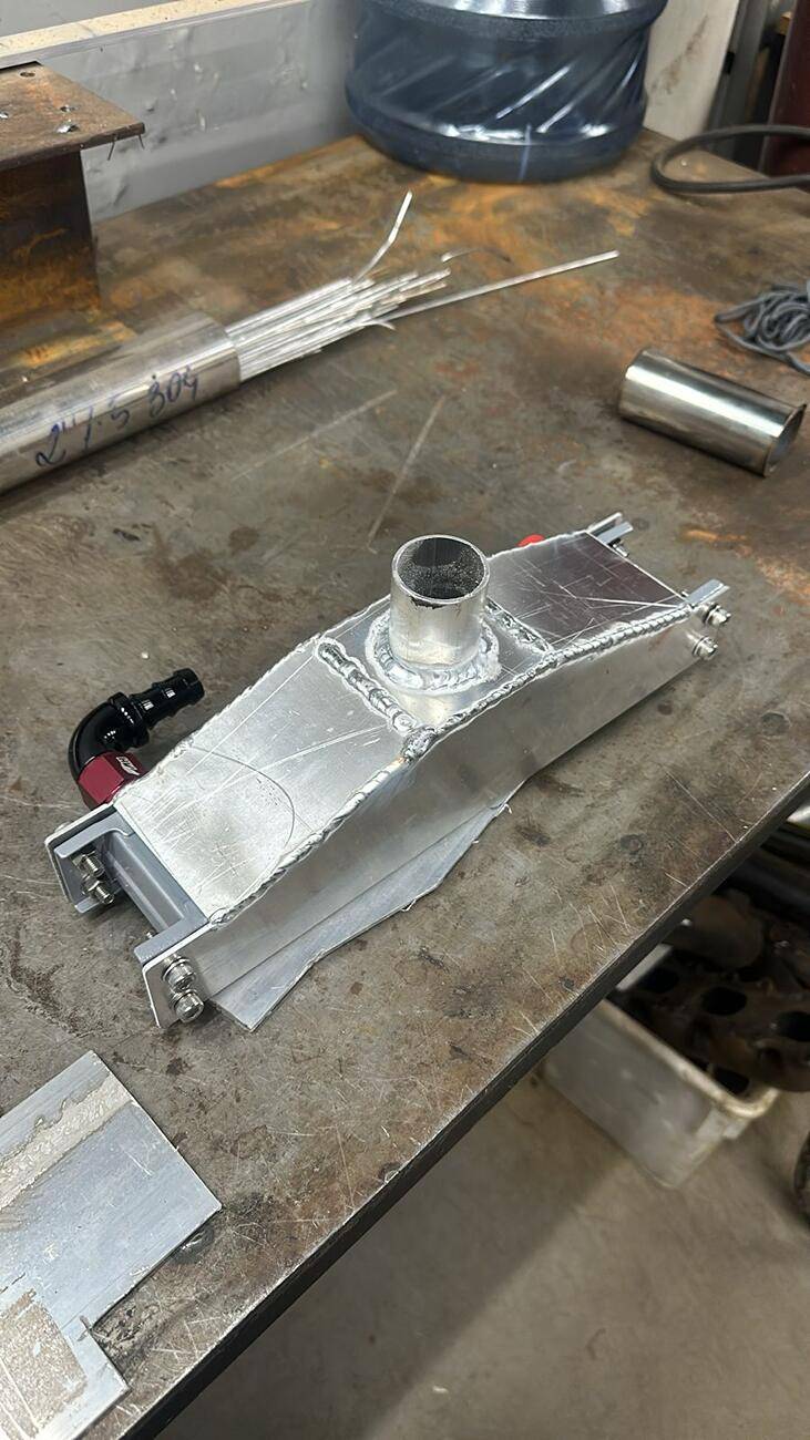

Then I put everything together, and I made a small vent to get some airflow in this area. If that is not enough I will put 2 80mm high power fans in the radiator... But I honestly think this is more then enough.
11th Gen Honda Civic Vito.FL5 Oil to Air transmission cooler install WhatsApp Image 2024-02-12 at 22.22.25

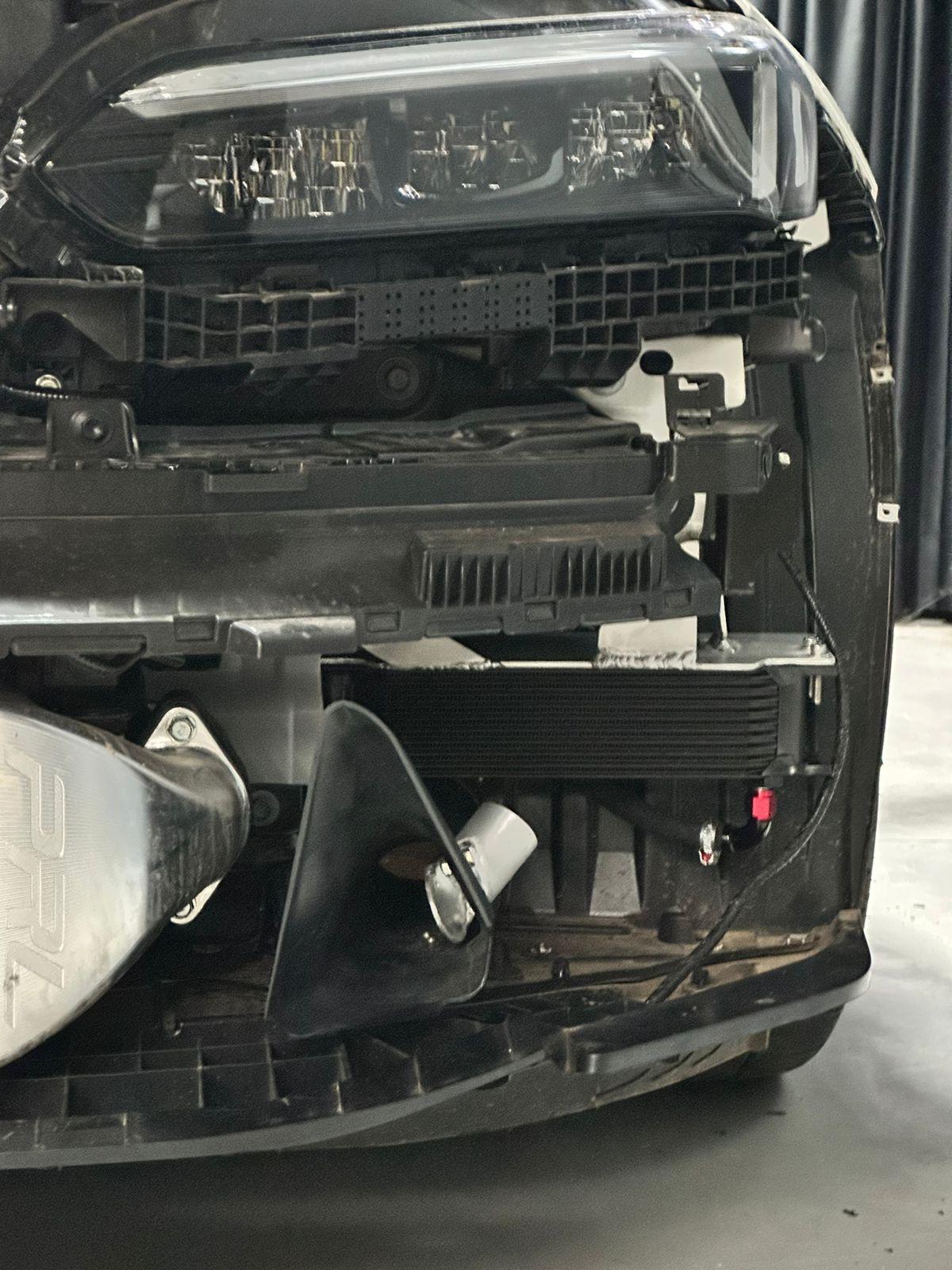

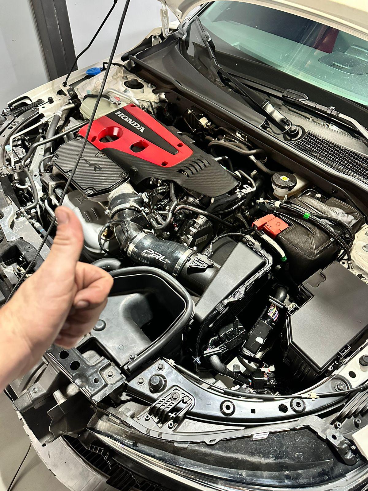

Looks decent.
11th Gen Honda Civic Vito.FL5 Oil to Air transmission cooler install WhatsApp Image 2024-02-12 at 22.22.22

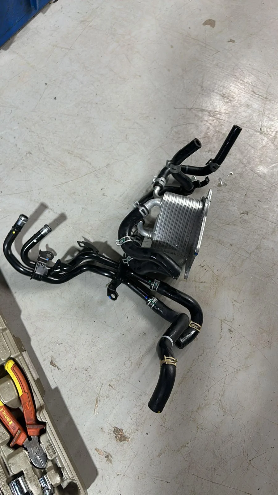

Garbage out!
11th Gen Honda Civic Vito.FL5 Oil to Air transmission cooler install WhatsApp Image 2024-02-12 at 22.22.24
11th Gen Honda Civic Vito.FL5 Oil to Air transmission cooler install WhatsApp Image 2024-02-12 at 22.22.23

Looks decent.

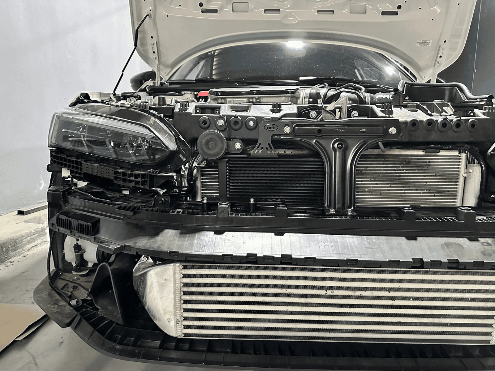

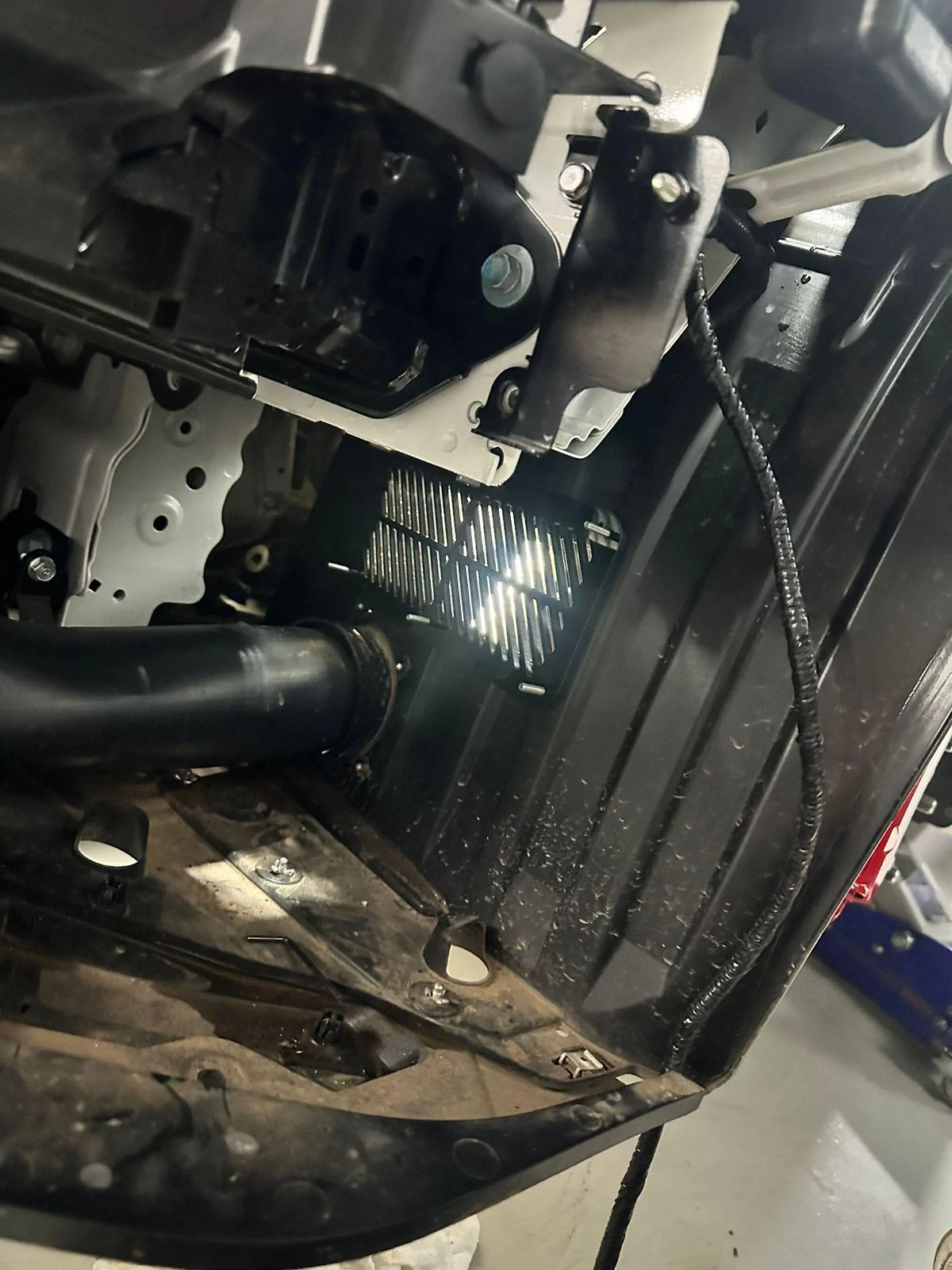

Got the engine oil cooler installed today. Didn´t like the kit.
Hoses are a bit too small for my taste, and the rub on many sharp edges, I took a lot more work to get it properly installed than I expected.
but it is there:
11th Gen Honda Civic Vito.FL5 Oil to Air transmission cooler install 1707870344524

I’m expecting the same when I Install mine, modification to not make it rub.
