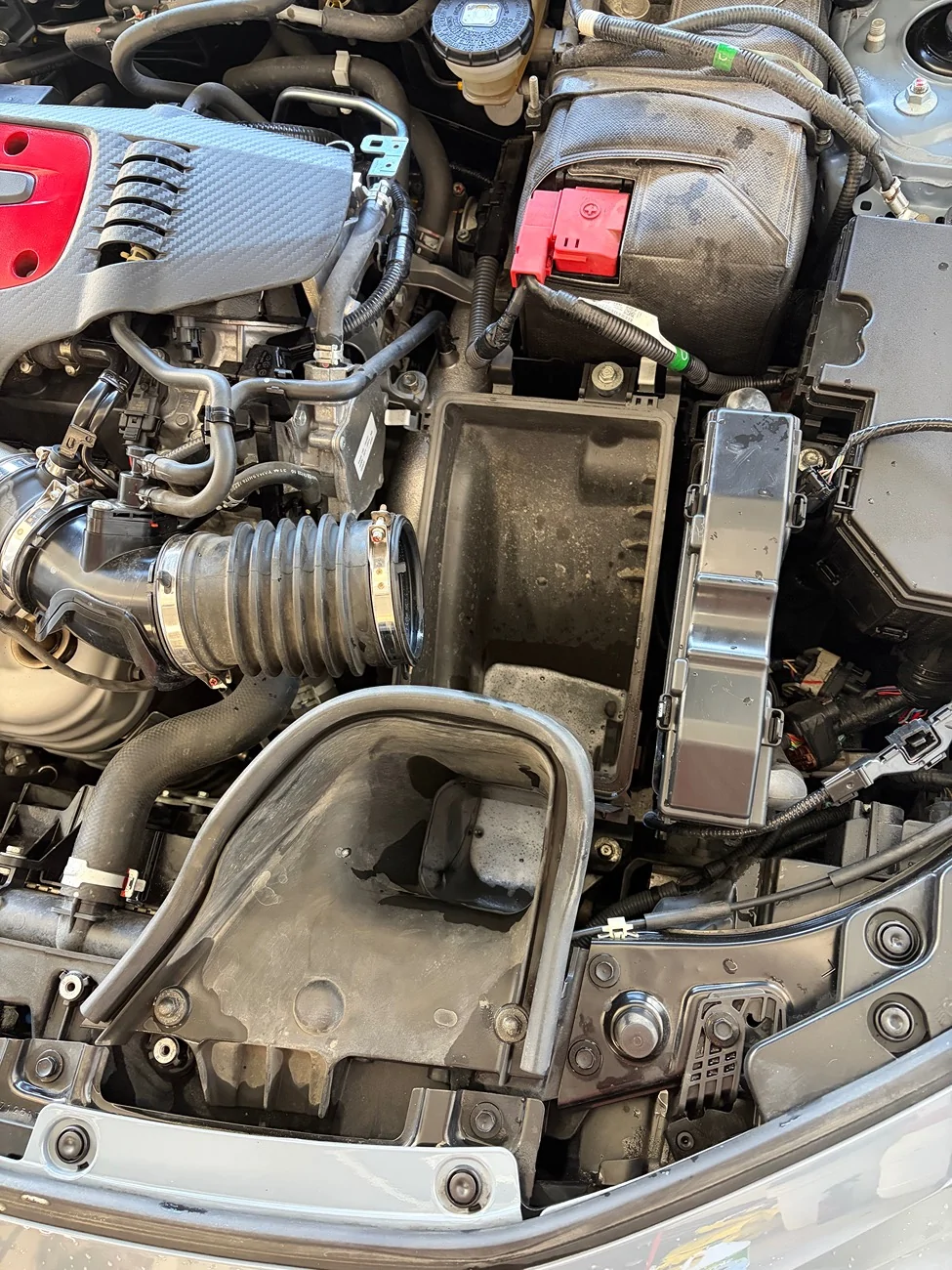

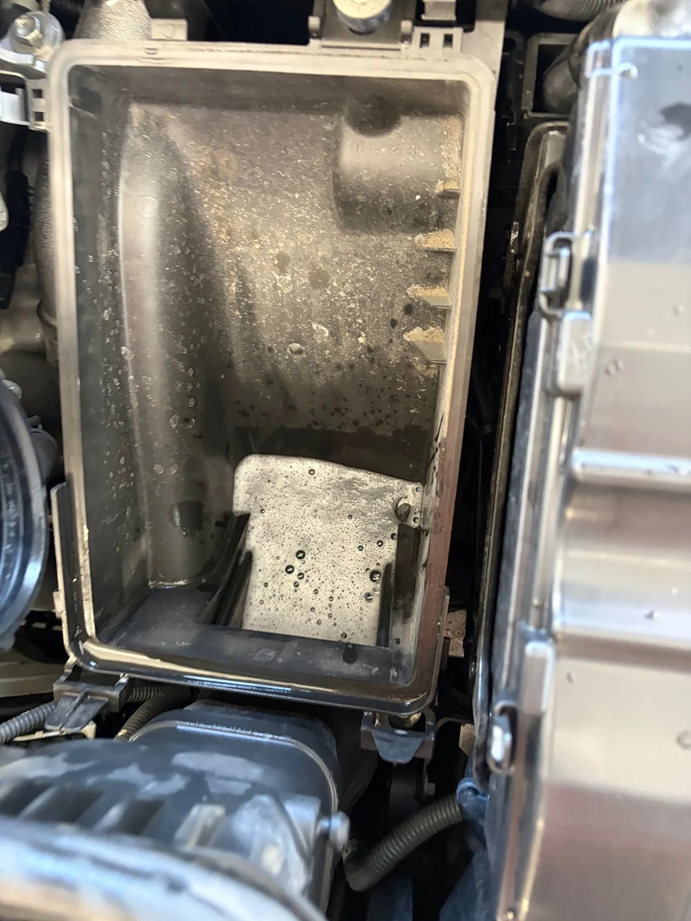

Got a bit too liberal when trying to remove the dirt and disease in the bay. I opened up the intake box and cleaned out all the water before starting the car. You've been warned !!!!!
11th Gen Honda Civic Washing the engine bay? The OEM intake does NOT have a drain!!!! IMG_8019
11th Gen Honda Civic Washing the engine bay? The OEM intake does NOT have a drain!!!! IMG_8018

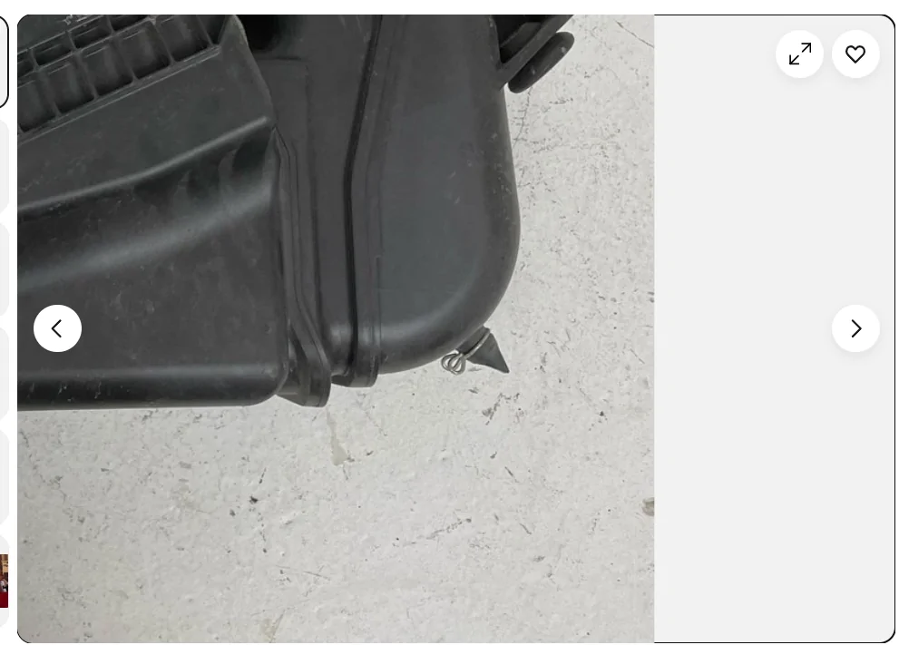

I think there is a drain hole from what I remember...has a weird rubber reed looking thing and you can see it if you take that intake box out and look under it. maybe it's clogged
11th Gen Honda Civic Washing the engine bay? The OEM intake does NOT have a drain!!!! 1779053688197-7
