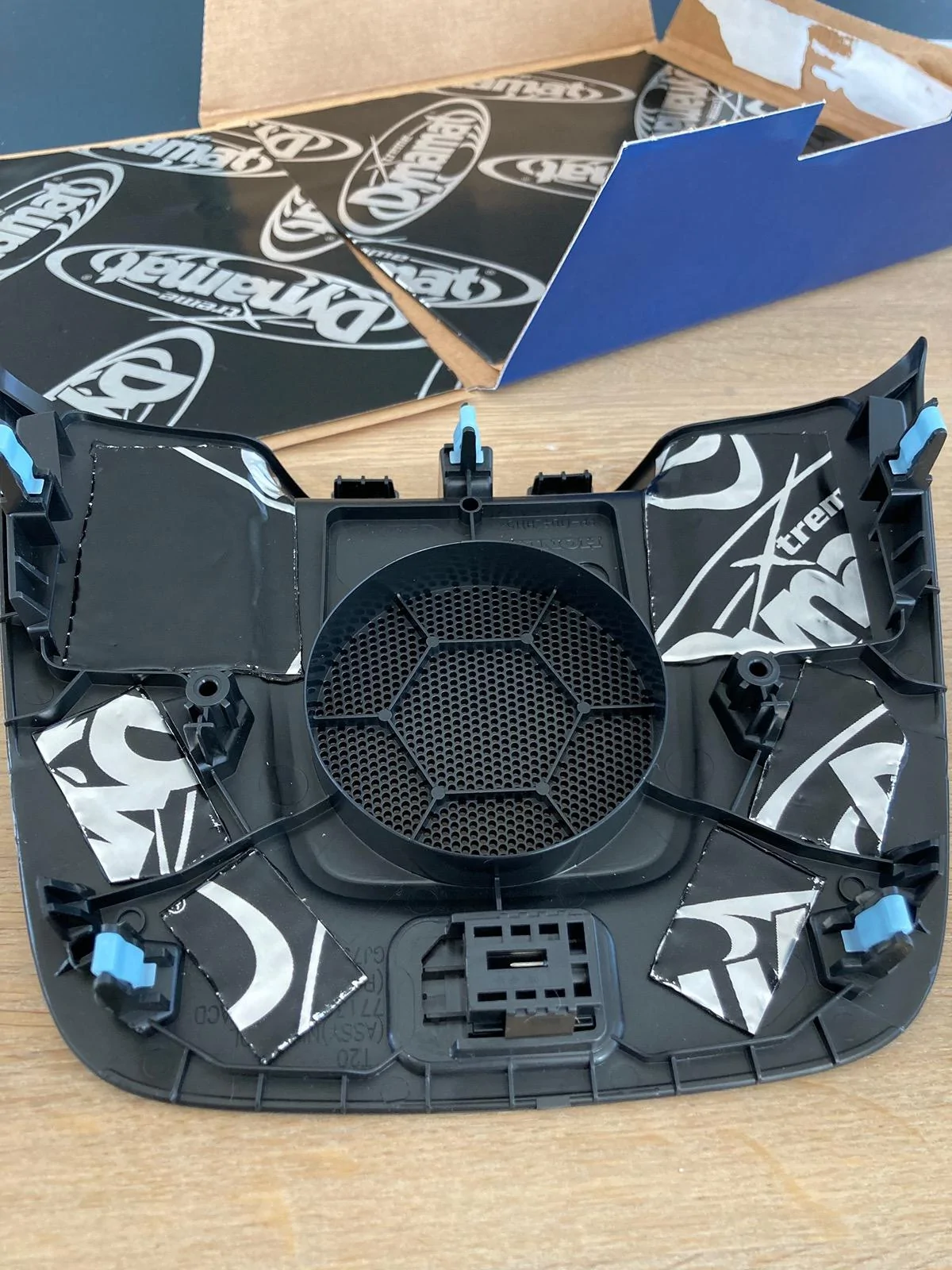

Finally got around to fixing the annoying dash rattle behind the infotainment screen. Pretty easy job in the end. This was after the dealership trying to fix it three times. Couldn’t see any evidence of a fix other than them maybe tightening the screws.
How does dynamat resolve the issue? Is that panel itself vibrating?
My guess is it just deadens any vibrations/sounds . It doesn’t appear it’s for contact areas to minimize tolerances of contact .
It’s vibrating when the dash is cold. The Dynamat adds mass and stops vibration (there’s a neat video online where someone applies a small square to a cymbal and it totally deadens the sound). Anyway it’s worked for me. I also reached under the dash and applied some there as the general dash area now vibrates on coarse roads. So far it’s working.
Credit to HATTRK for this fix.
