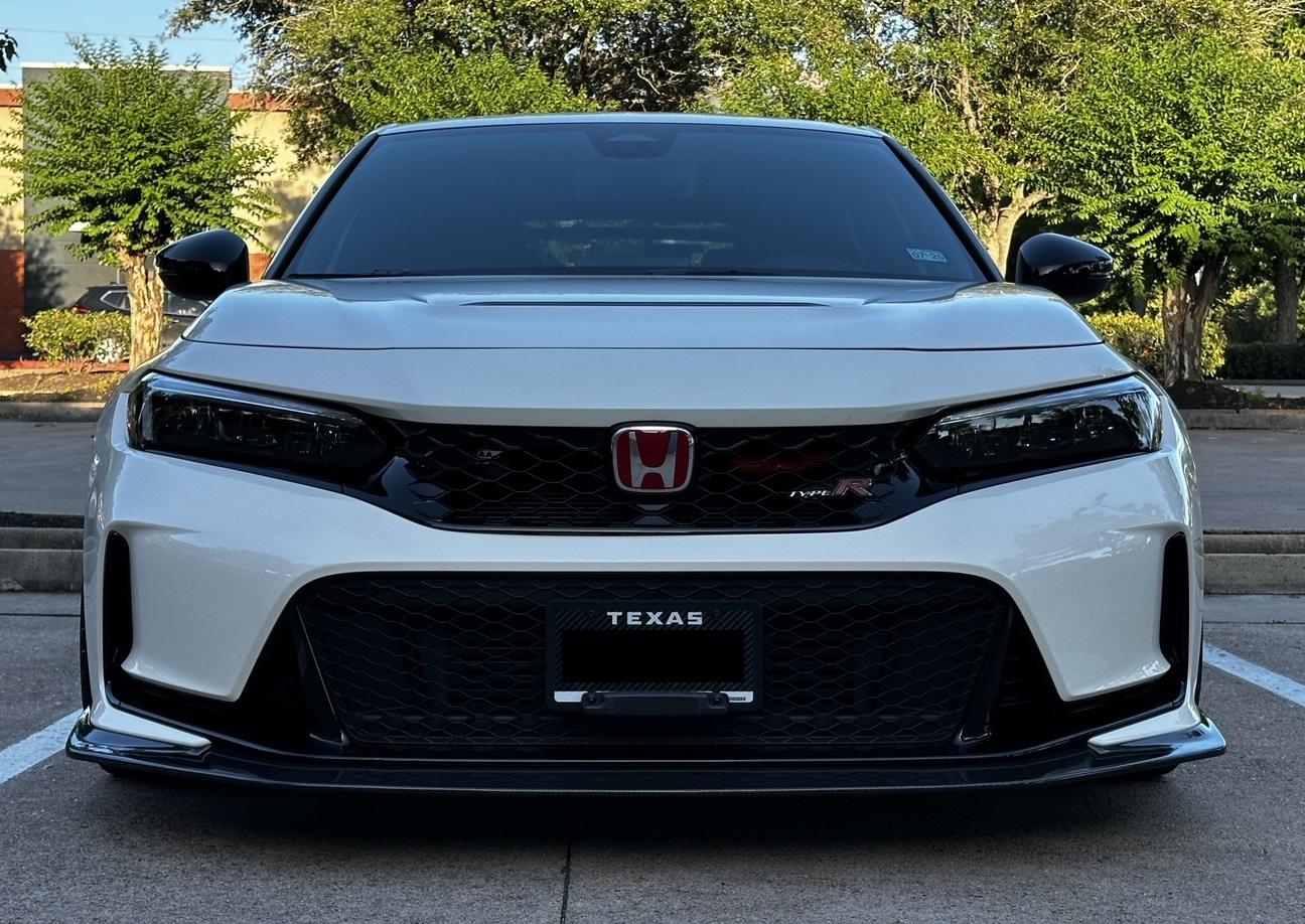

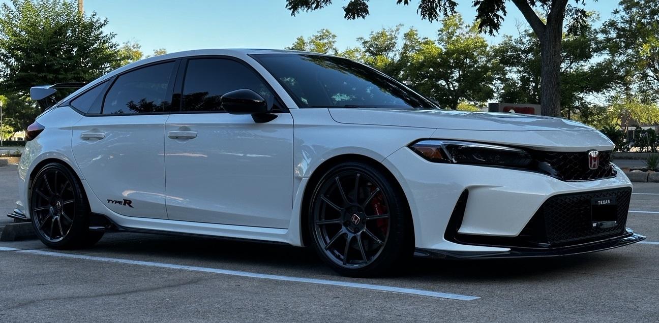

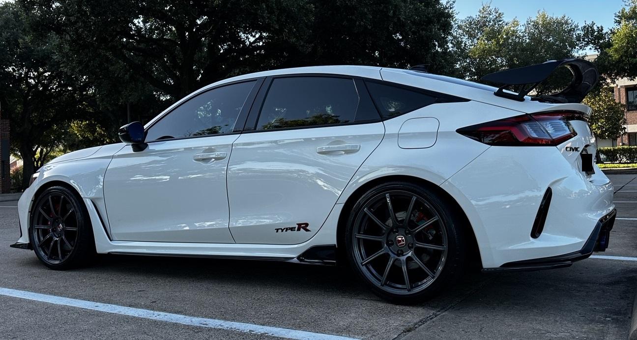

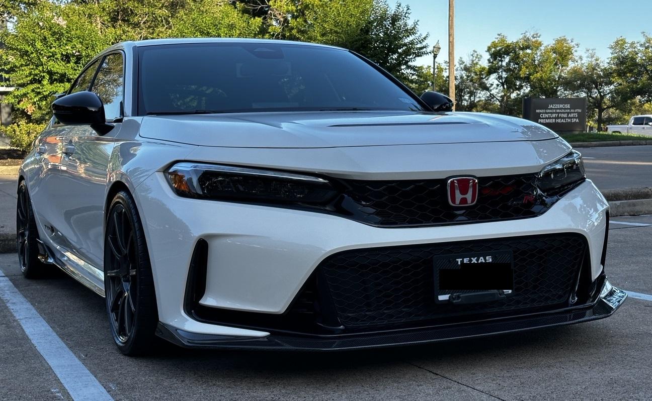

sugarl4nd
Andre
Aug 29, 2023
131
189
Sugar Land, TX
2023 FL5 CW & 2021 FK8 LE Phoenix Yellow
After weeks of taking parts delivery, manage to spend some time to install the following :
- DBA 4000 (T3) Rotors - both Front & Rear
- Project Mu PS brake pads - both Front & Rear
- Carbon Fiber EPR Front Lip & Carbon Fiber APR Rear Bumper Skirts Add-On
- Mugen LED hydrophilic mirrors & Dogfight Rear View Mirror (both have matched blue tint color)
- Mugen Alcantara Shift Knob & Mugen Scuff Plate (got both from King Motorsports)
- ALPLUS Fender Areo Guards
- Spoon oil cap, radiator cap and reservoir cover
- PIAA Twin Tone Sport Horns (you could see the red/silver on the left side of the front H emblem)
- Lasfit LED Turn Signals & Phillips LED Reverse Light
Currently waiting for a few more parts to complete my FL5; due in July, August & September ;).
I just did quick wash ...

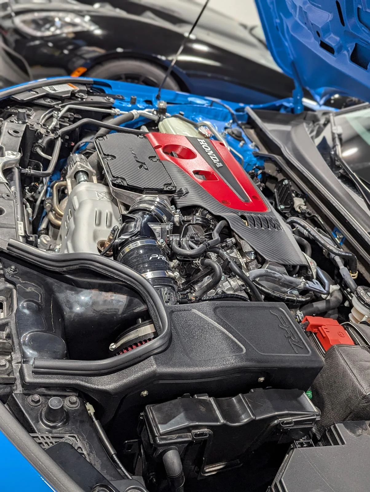

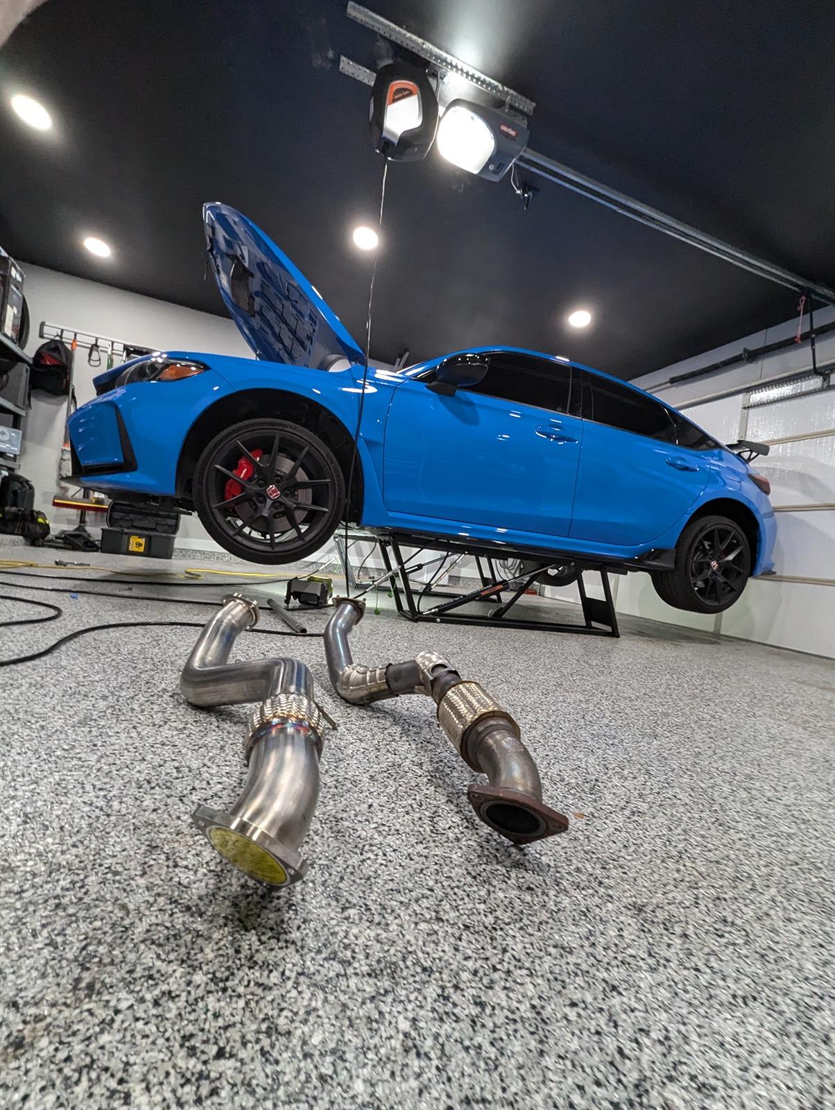

New Endless pads after obliterating the OEM's on a couple track days
TSP Downpipe finally in. Huge PITA.
PRL front pipe in. Super easy install. Fits like a glove.
I am curious, what was hard on the downpipe install? I have had my OEM downpipe in and out a couple times doing random stuff and thought it was quite easy to remove/reinstall. Just seeing if it was something with the aftermarket downpipe or if the OEM one fought you.
evlsmurf
May 18, 2017
344
313
2016 Subaru Impreza Sport
You didn't have to fight the downpipe studs/bolts? That seems to be the biggest issue people have. The studs can snap pretty easily. I never did it on my FK8, but has planned to soak the crap out of them with Sea Foam.
Bazgab
Rob
May 31, 2023
171
215
Raleigh, NC
Oh, yeah the studs are by far the worst part. I had to fight with mine, maybe I blocked that trauma out, haha.
I replaced them all with titanium hardware so it is so much easier now. That makes sense in that case, if you have the OEM hardware it is stressful and slows you down a lot (potentially a whole lot if a stud/bolt snaps off).

johnny.silva7
Jonathan
Apr 17, 2023
99
193
Austin
(FL5) Civic Type R, Viper TA
1. Removing the nuts off the DP studs without completely galling the threads.
2. Attempting to remove the studs for replacement (could never find a solution that didn't require a welder). Would love help/advice on how you did it.
3. Angling out and pulling the actual DP from the engine bay. There is a proper way but every YT video skips it.
4. Squeezing the new DP with the OEM heat shield in place.
I've worked on many cars in the past, and for the simple task at hand, this was unnecessarily tedious.
