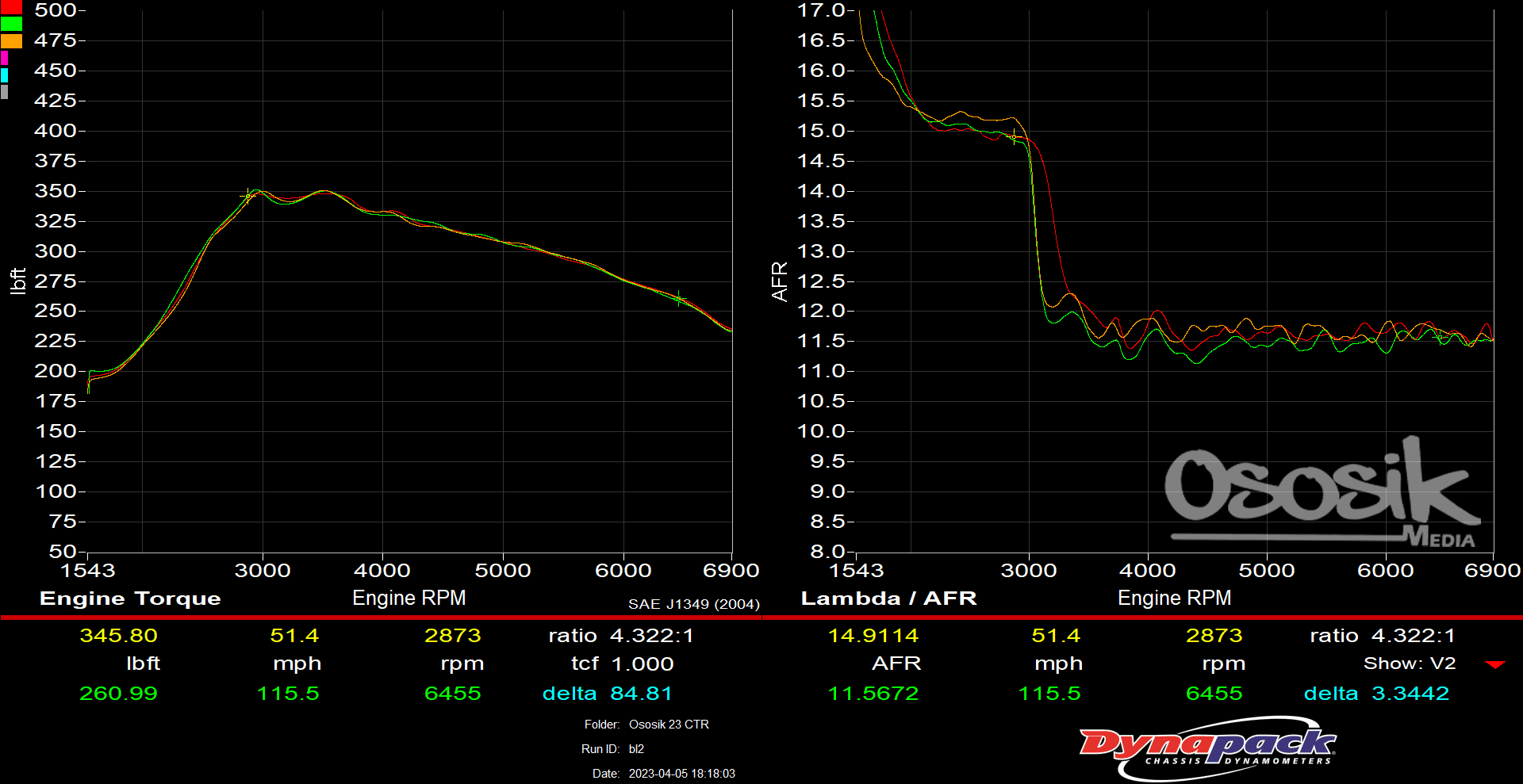

Below is a graph that shows the AFR & TRQ curve on a 100% stock 2023 Civic Type R (the o2 reading was placed in the rear tailpipe). We also tested this on two different types of dynos and locations.
