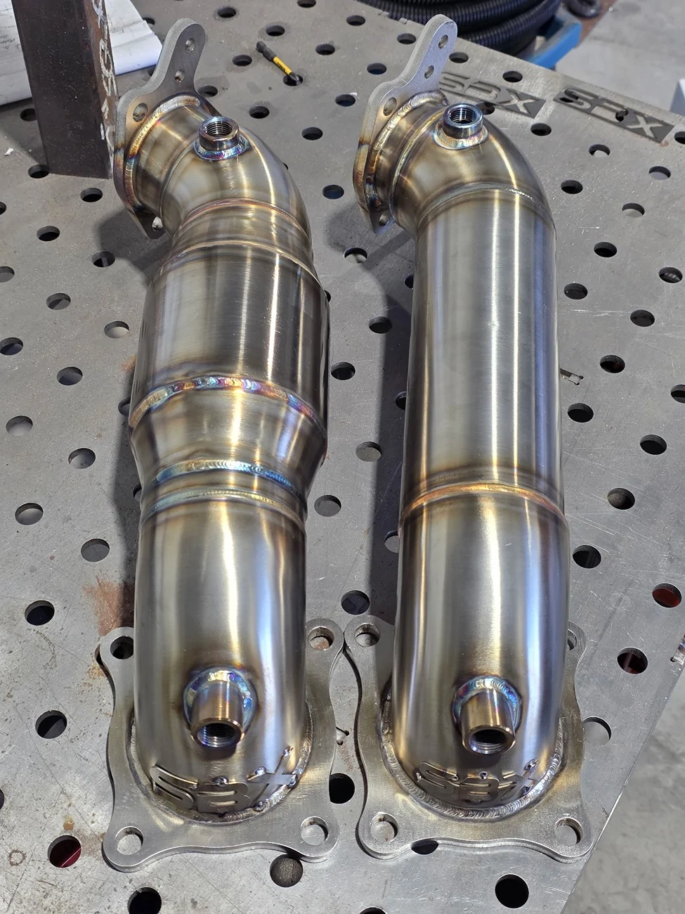

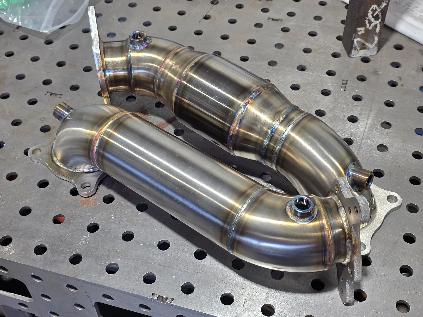

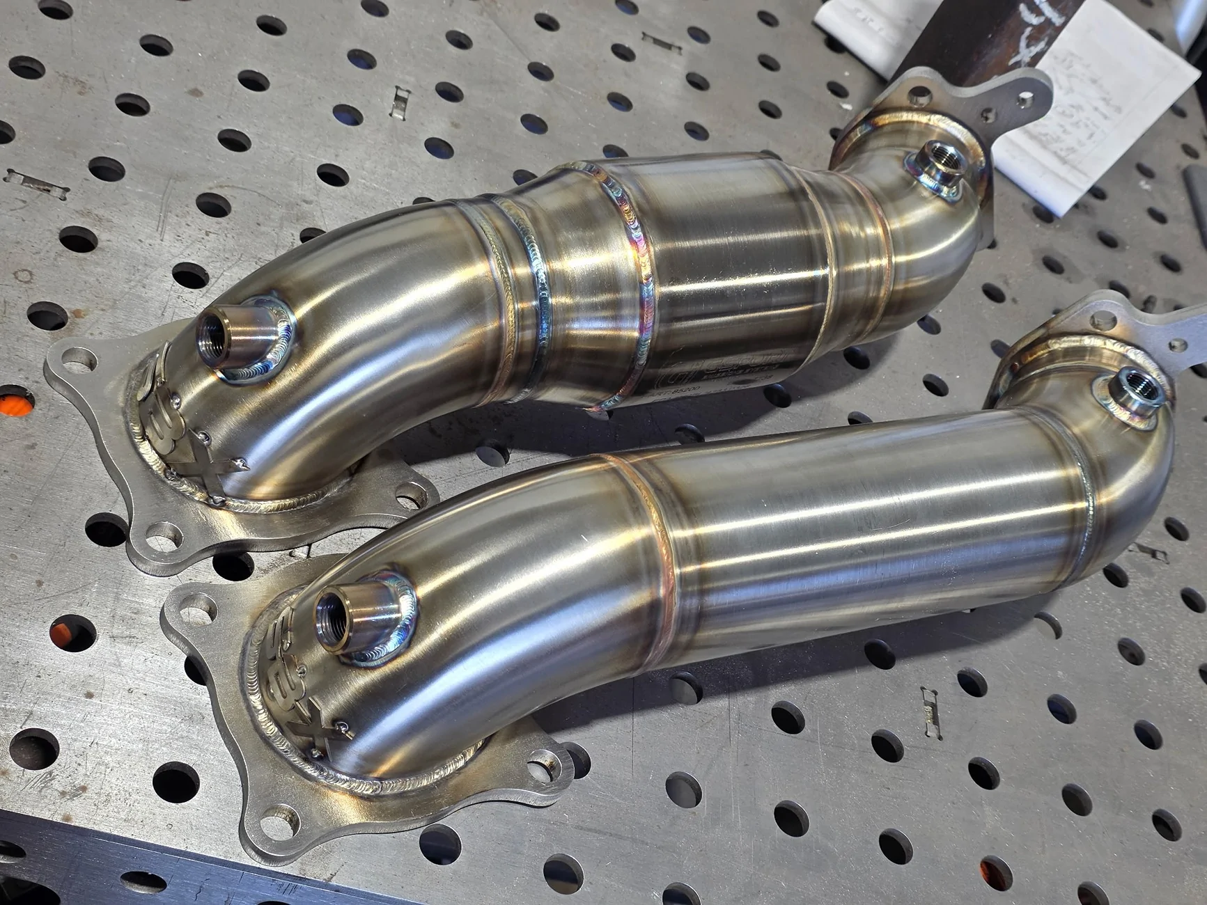

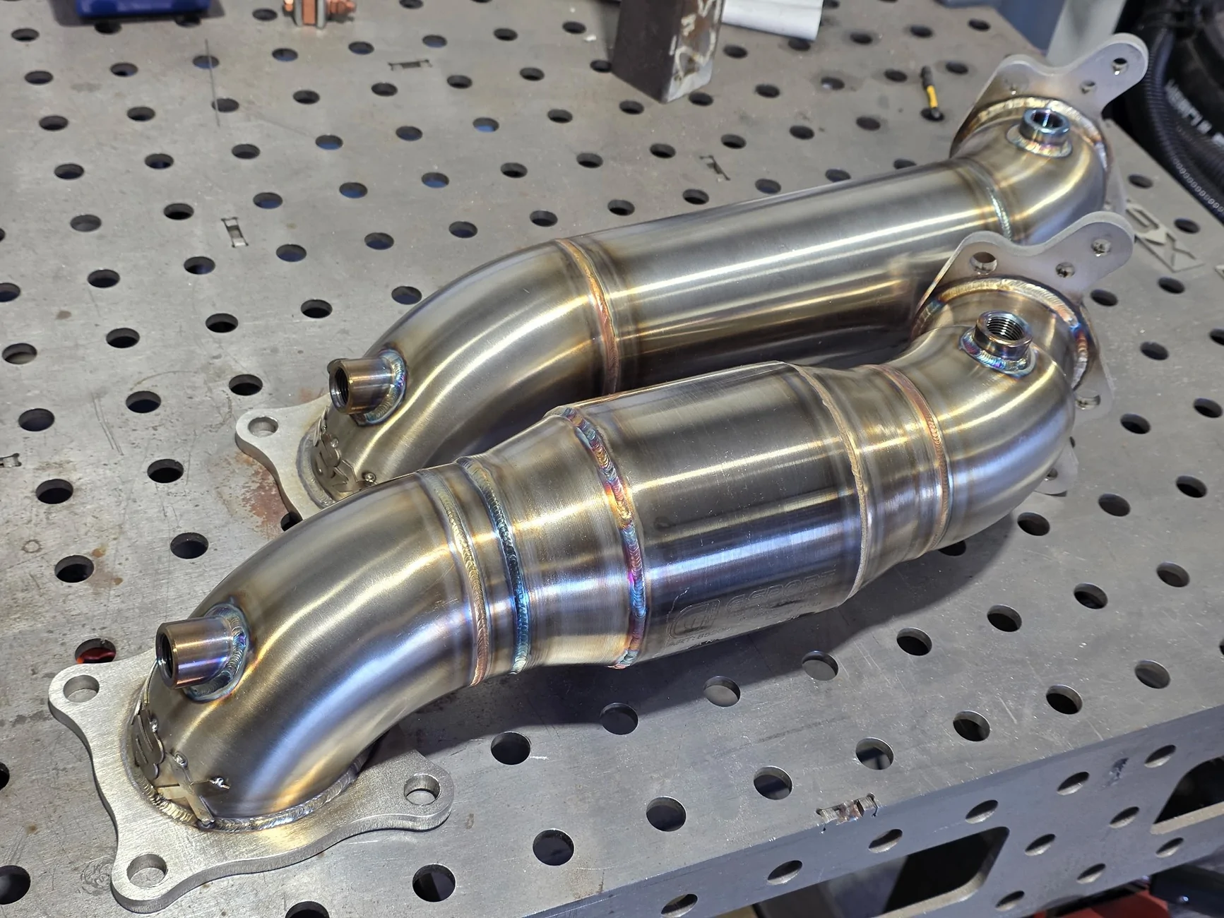

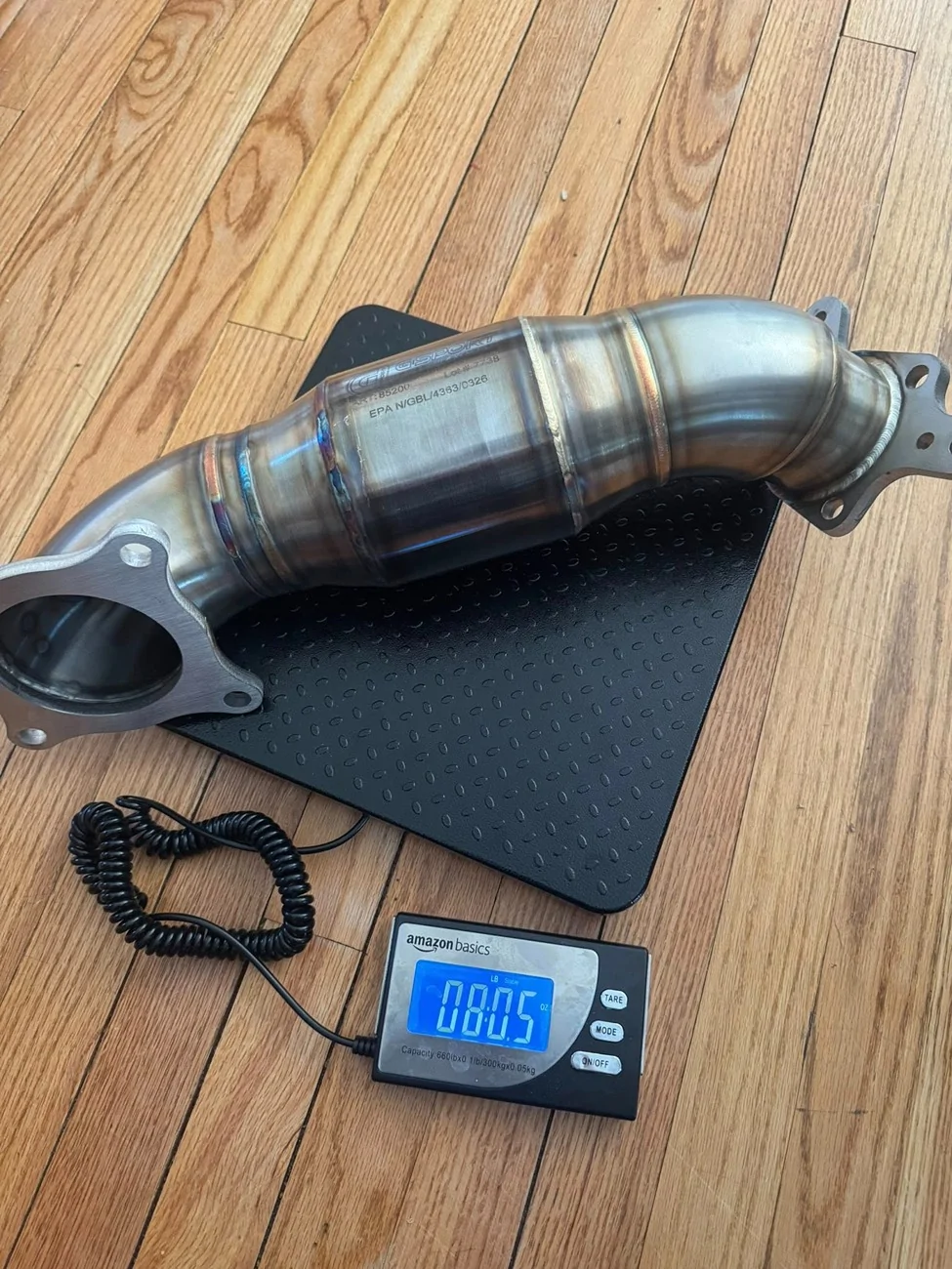

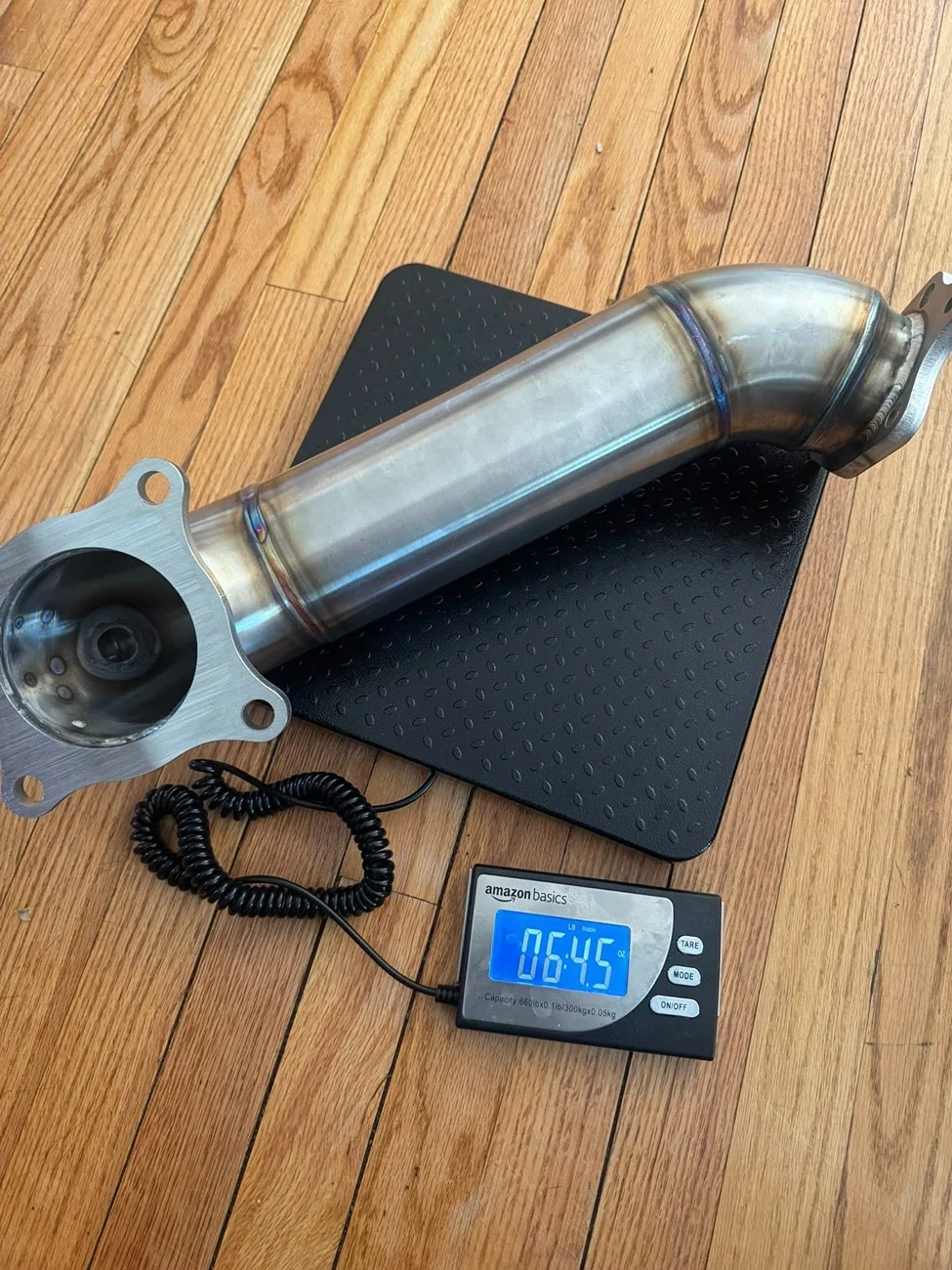

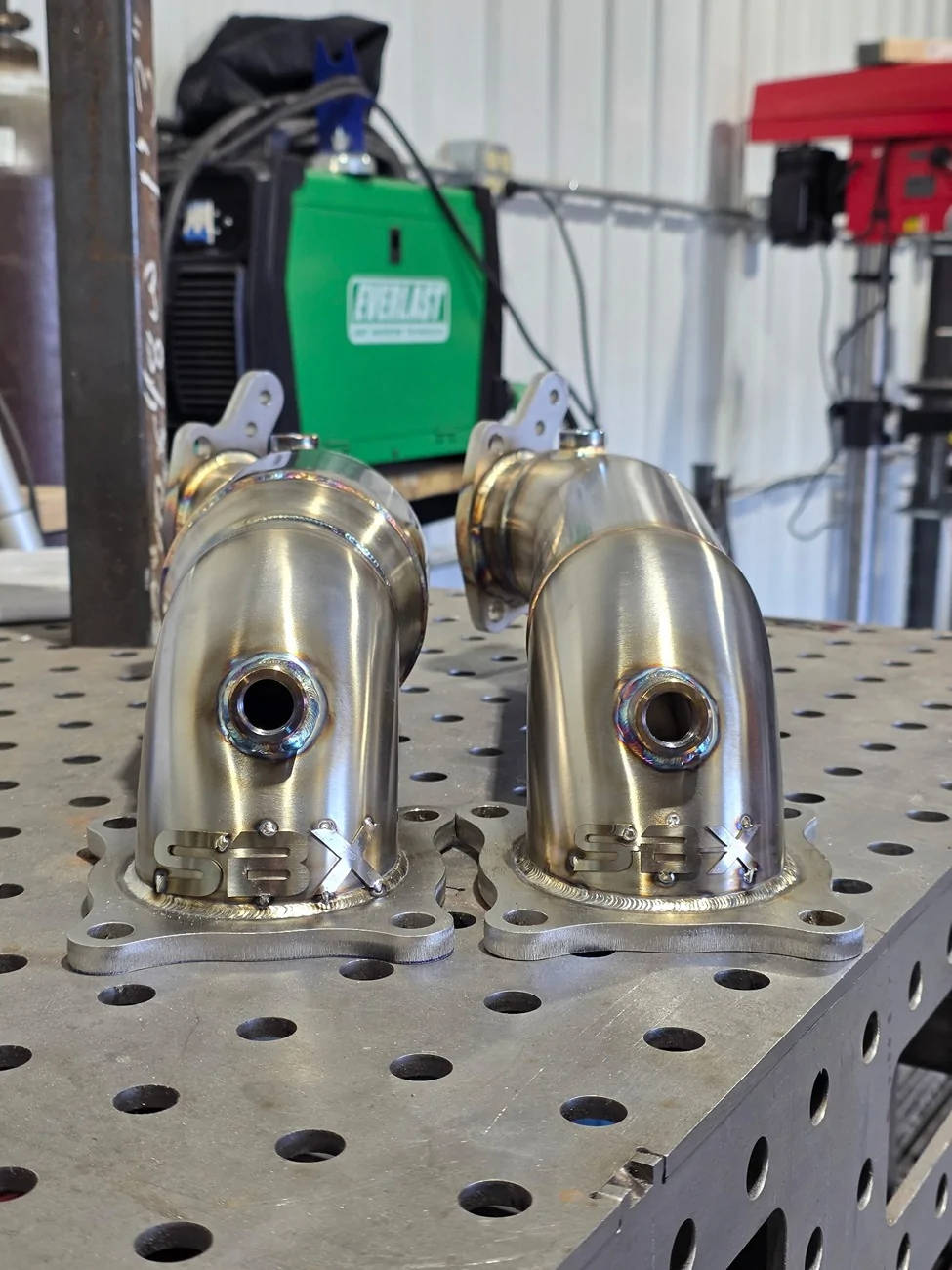

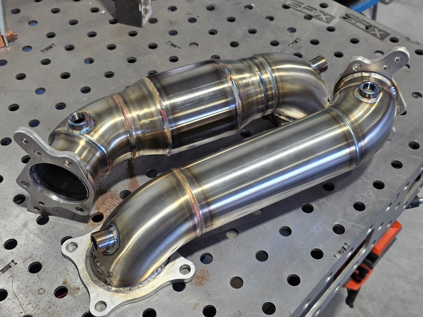

Prototypes on the scale. Daily update
Looks awesome using mandrel bends with welds stacked like dimes. I have to ask...On the PIC with the cat, why is there another welded pipe section on the inlet transition cone that is not used on the straight downpipe? Since the PICs are of prototypes, is the end state for production to offer two downpipe options (i.e., one catted and one straight) or one downpipe option that includes a V-band connection to run cat or straight?
For cross reference, the OEM downpipe with heatshield installed weighs 12 lbs. 9.98 oz. (5,726 g) and has a outlet ID of 2.09" (53 mm). The raw TSP downpipe uses cast ends, weighs 14 lbs. 1.79 oz. (6,401 g), and has an outlet ID of 2.83" (72 mm).
nice catch and awesome specs you gave thank you!. The additional welded section on the catted version is there because the GESI body changes the transition geometry and packaging requirements compared to the straight pipe version. Mandrel bends are tough to do for this tight packaging thats why most cmpanies use cast becuase of that and its cheaper. The extra section allows it maintain proper flow transition, cat placement and overall fitment while keeping the routing and flange alignment where I wanted it.
At this time the production plan is for two dedicated downpipe configurations:
• Straight-through competition version
• GESI catted version
Rather than a modular V-band swap system which I would never do for a crapload of reasons such as good luck getting those off after awhile and also modular means more places for leaks and intall error etc.
The FL5/DE5 packaging around the turbo/downpipe is tight so the prototype are evolving a bit from the original prototypes and drawings.
Also appreciate the reference measurements and weights definitely useful for me. One of my primary goals with the design is to maximize post turbo flow area while maintaining OEM-like fitment. Like I said mandrel bends are tough but its doable and I will not release it till I get it perfect. Just today I decided I wanted to change the spec a bit at the flanges lol....

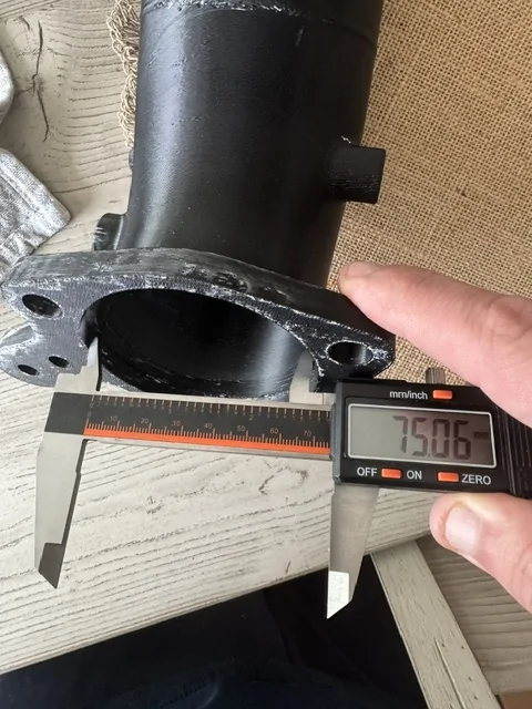

Sorry for the delay and thank you for that info and link I will check it out.
Update on the progress. I sent it back to fab to adjust the specs they were smaller than my CAD specs I had. I did do my CAD for CAST elbows thats one issue because mandrel bends are totally different ballgame. I am going to try and get close as possible to these specs. See pics that is my 3D printed model off my CAD. Should have it back next week sometime then its go time. Def appreciate the support. I wish I could keep prices down but its impossible doing this on such a small scale :(
