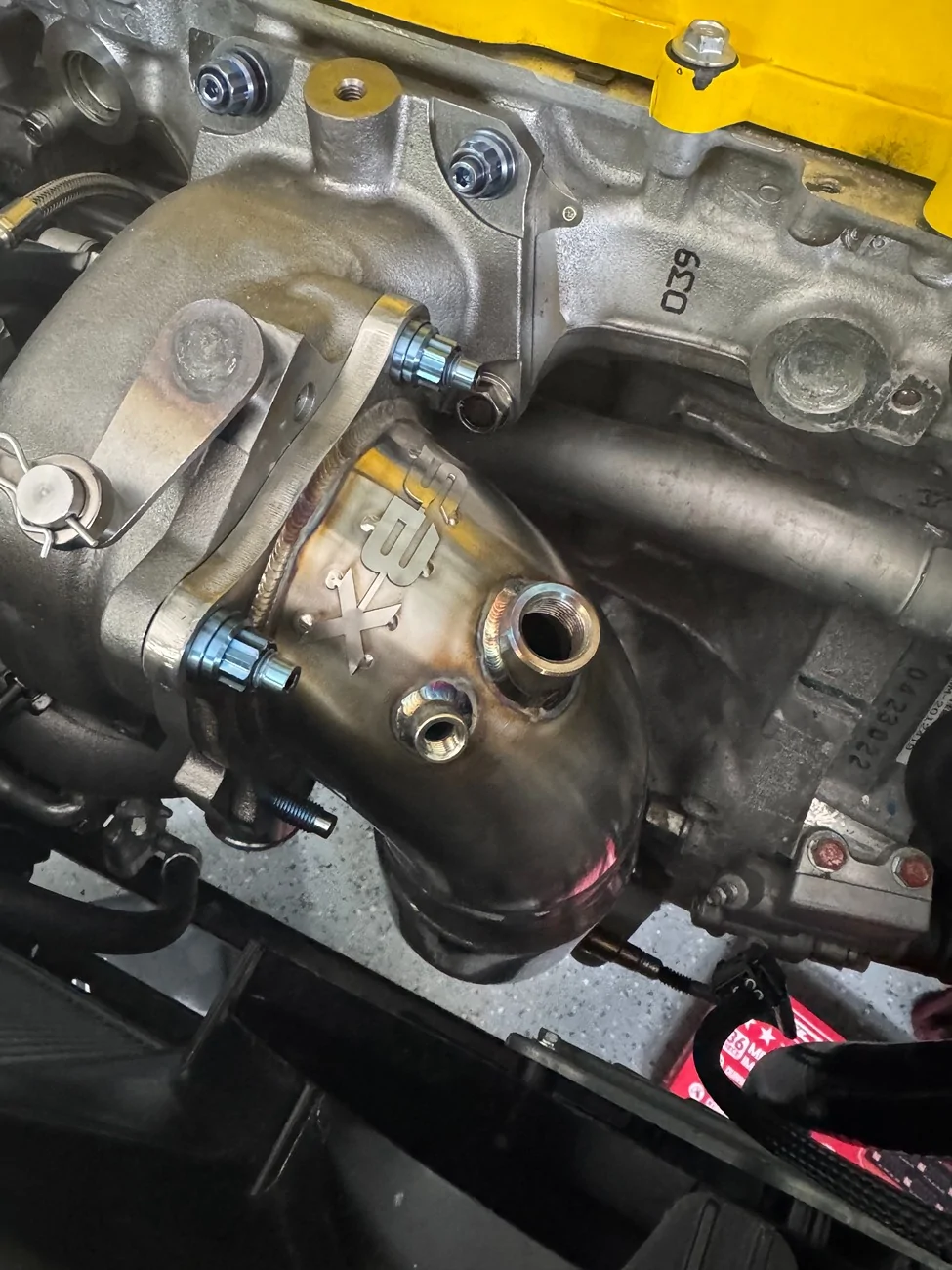

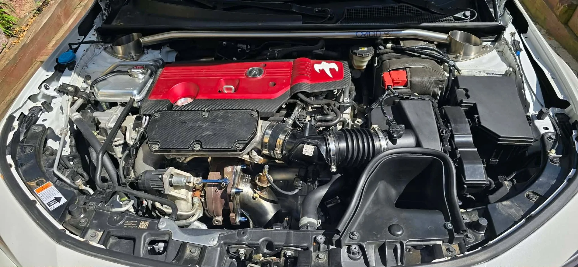

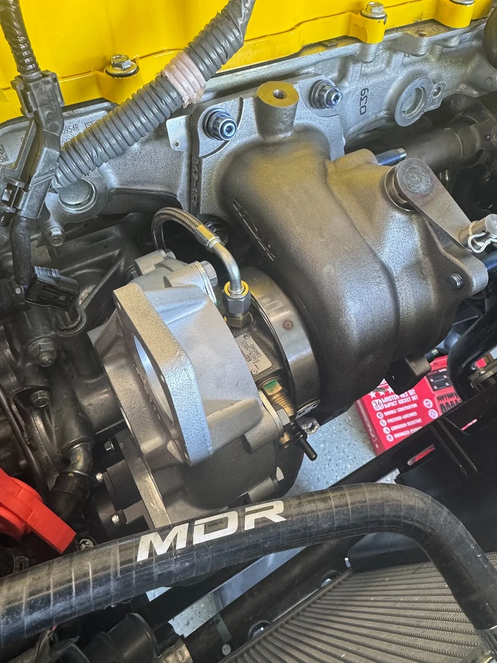

Updates.....
Will have some data on Tuesday it looks like here is some updated pics. The prototype is not that pretty now cause we had to cut off the 3.5 inch elbow to put the 4 inch elbow on :) also I did not put the heat shield option on the protoype. I have an extra bung for the backpressure sensor to go on. anywhere here it is. Pre order open next week just waiting on the price quote for the 4 inch elbow. Oh and the SBX logo will be the opposite way. it matched up well with my Spoon exhaust front pipe which is 66 and change mm

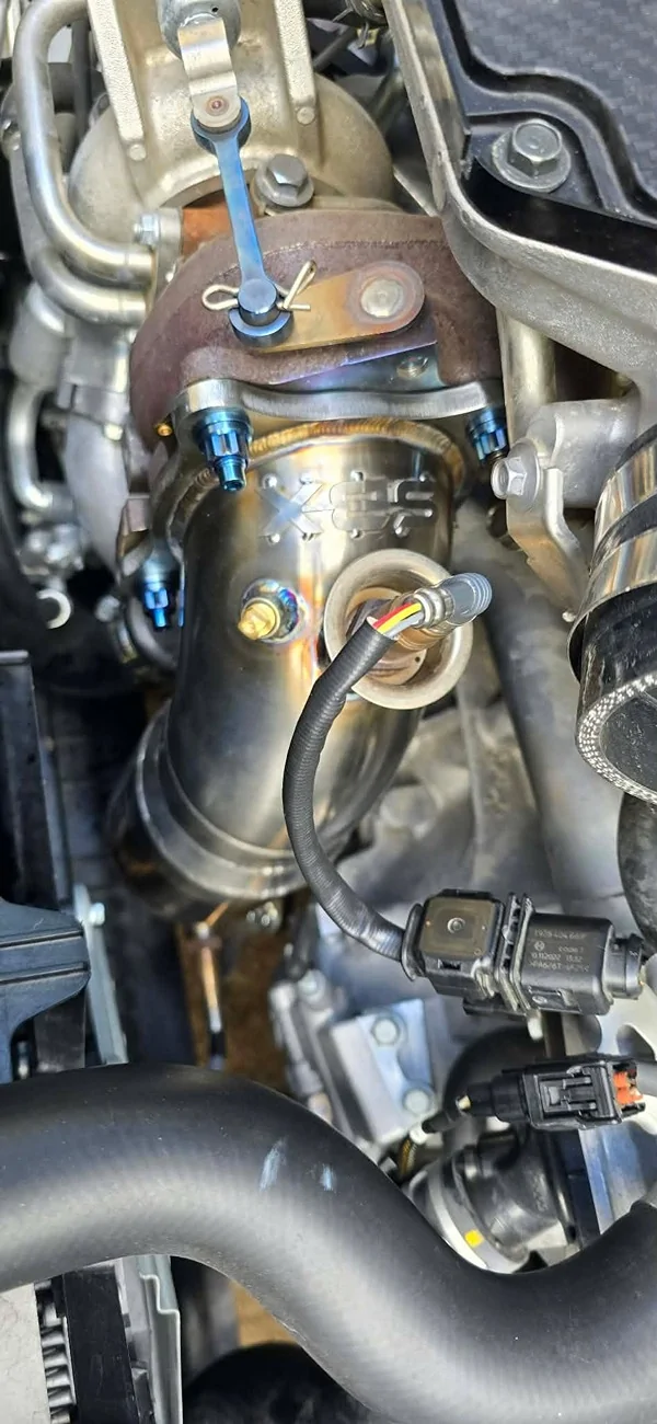

This downpipe looks promising. Cant wait to see it finished up
Thanks, I am really trying to make something great that actually works! They are all hand made so going to be limited runs each time.
Right now a customer of mine has it on his STOCK DE5 testing it and he is going to the dyno on Tuesday night to compare stock vs with the downpipe and also backpressure on the SBX and also checking no CEL. I figured what better than me testing it? Customers who will be honest with feedback. He is sending it back to me after that so no bias free shit.

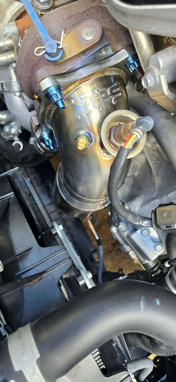

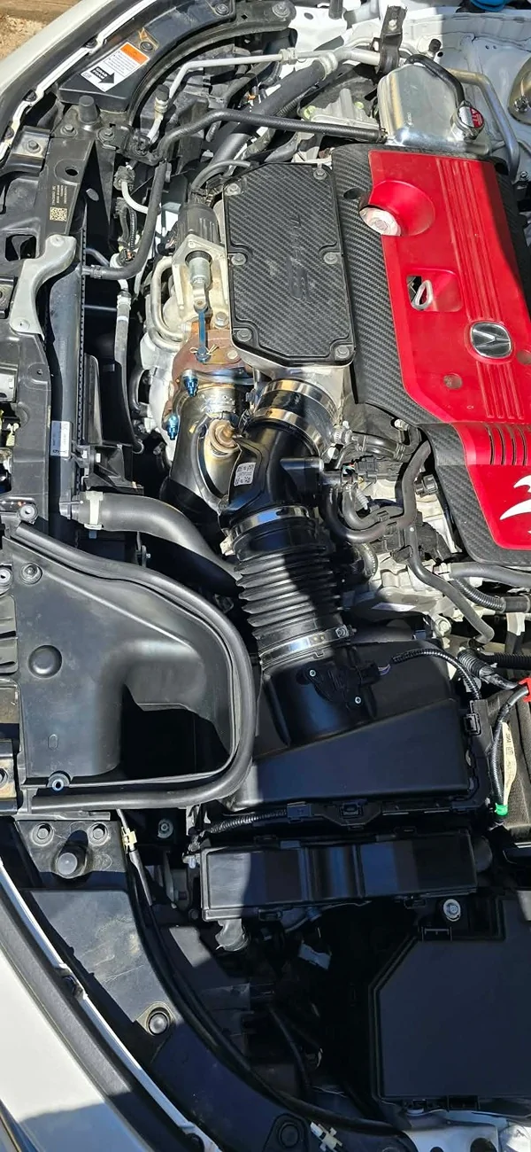

2024 Honda Civic Type R
DE5 test car install went well besides one stud he left before it snapped LOL first video is OEM second video is SBX Downpipe he is going to do some revs later he is on his way out in his vet for a car show. Will post it later of the revs. Also the extra bung is for my backpressure sensor ignore it
