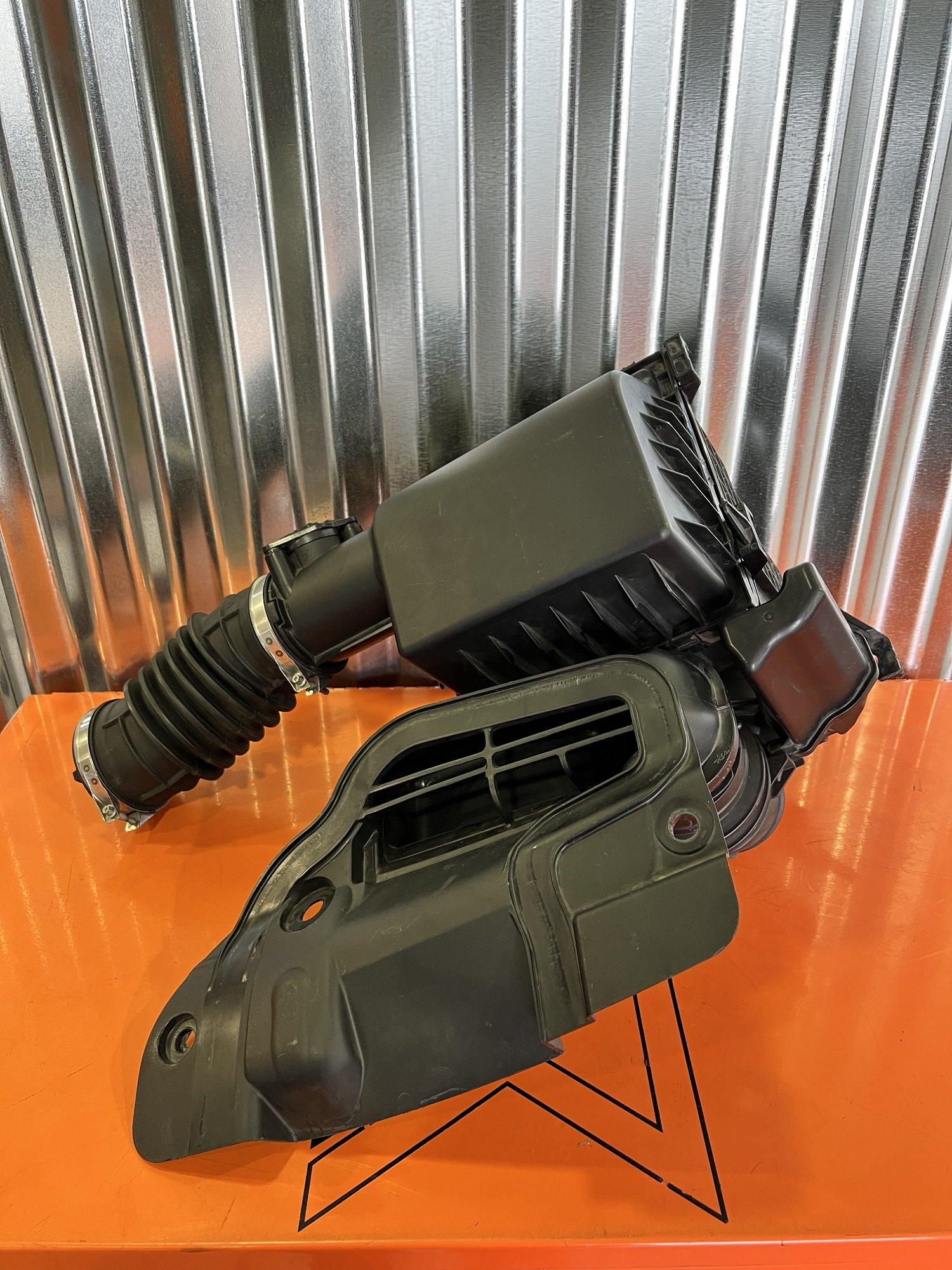

OEM 2022 Honda Civic Si Intake System

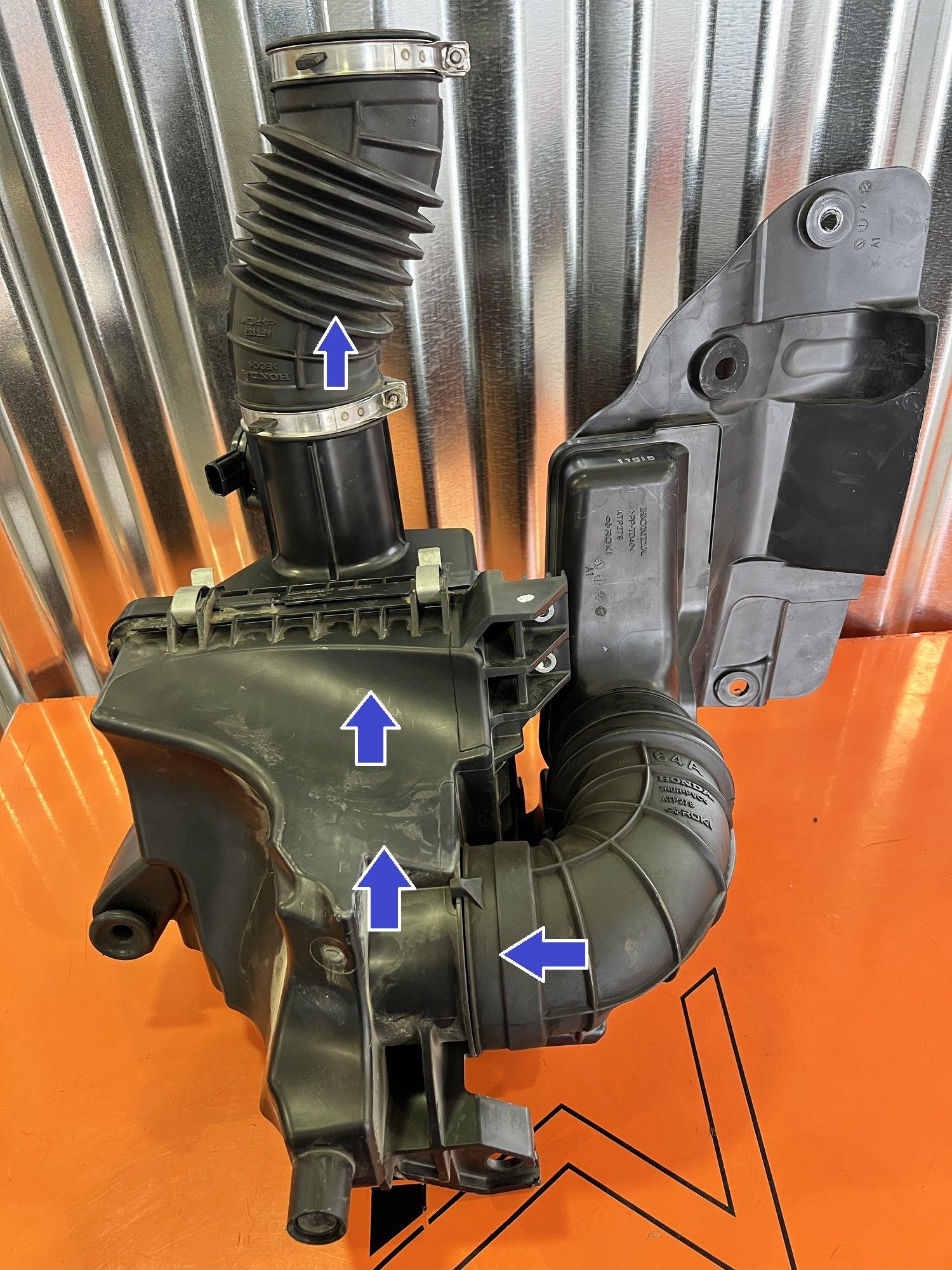

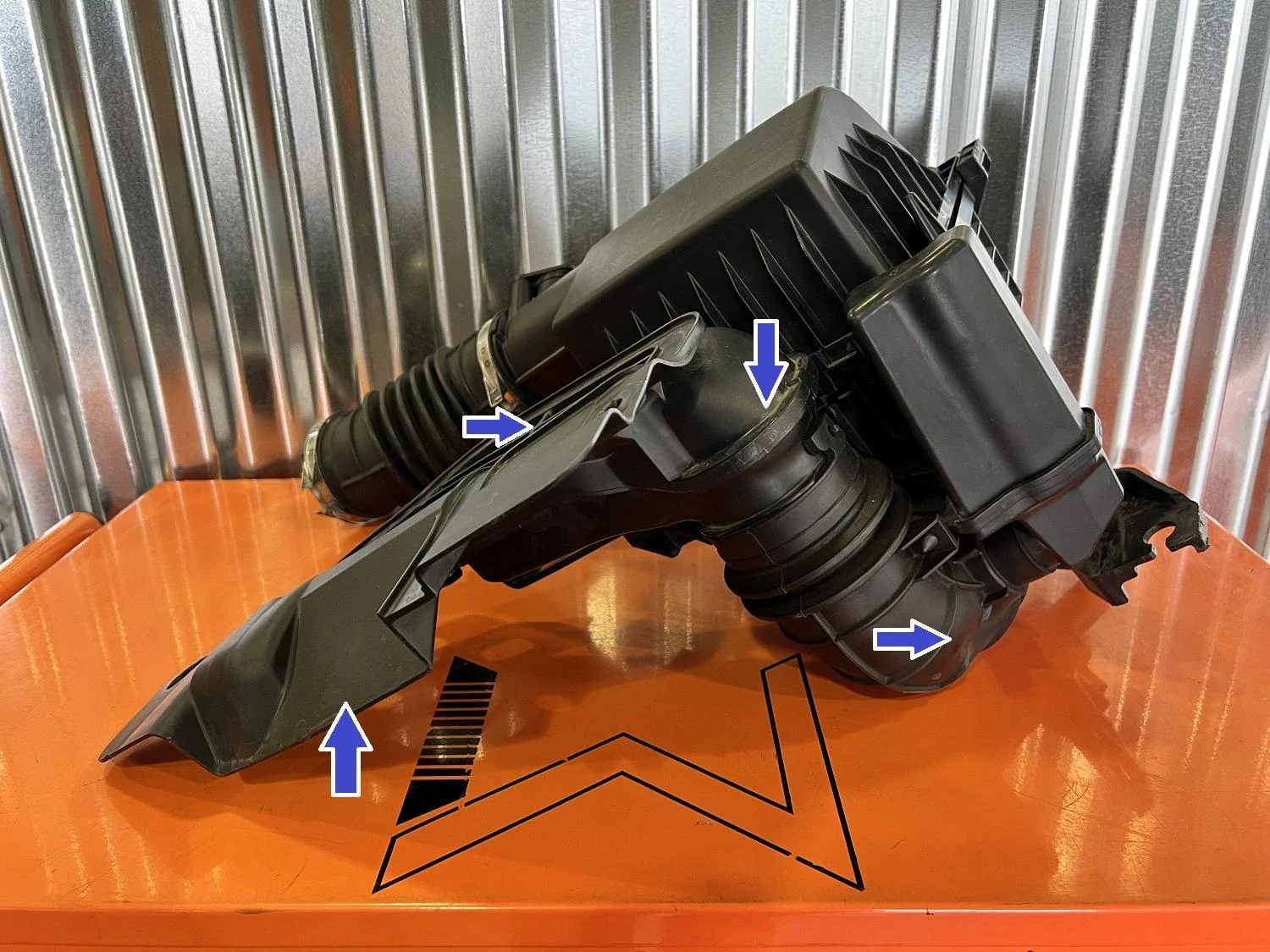

SIMILAR TO THE INTAKE SYSTEM FOUND IN THE 10TH GENERATION HONDA CIVIC (2016-2021), THIS INTAKE IS SURPRISINGLY BIG. IT HAS A LOT GOING ON. THERE IS AN INLET SCOOP THAT SITS JUST ABOVE THE FRONT BUMPER (ON SOME MODELS). THERE ARE A PAIR OF RUBBER TUBES TO DIRECT AIRFLOW, A BIG RESONATOR ON THE SIDE OF THE FILTER BOX TO KEEP THE INTAKE QUIET, AND A TWO-PIECE AIRBOX FOR THE FILTER. THE MAF HOUSING IS MOLDED INTO THE AIR BOX LID. THEN CONSIDER ALL THE CLAMPS AND HARDWARE TO SECURE IT AND YOU HAVE A RATHER COMPLEX SYSTEM. I MEAN, JUST TAKE A LOOK AT THE OBSTACLE COURSE THE AIR HAS TO GO THROUGH JUST TO GET TO YOUR TURBO INLET PIPE!!!

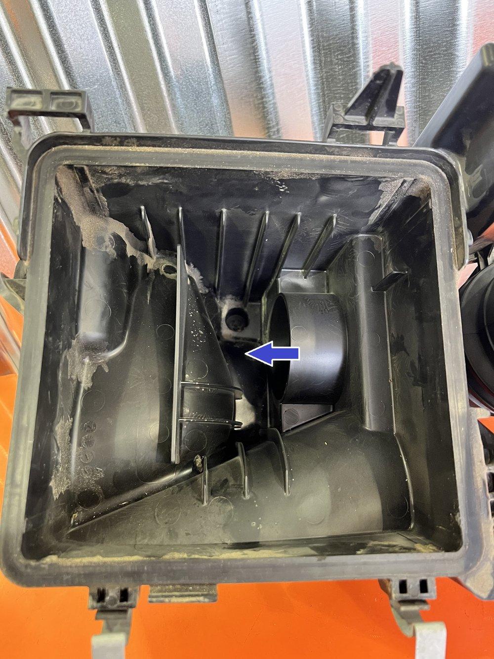

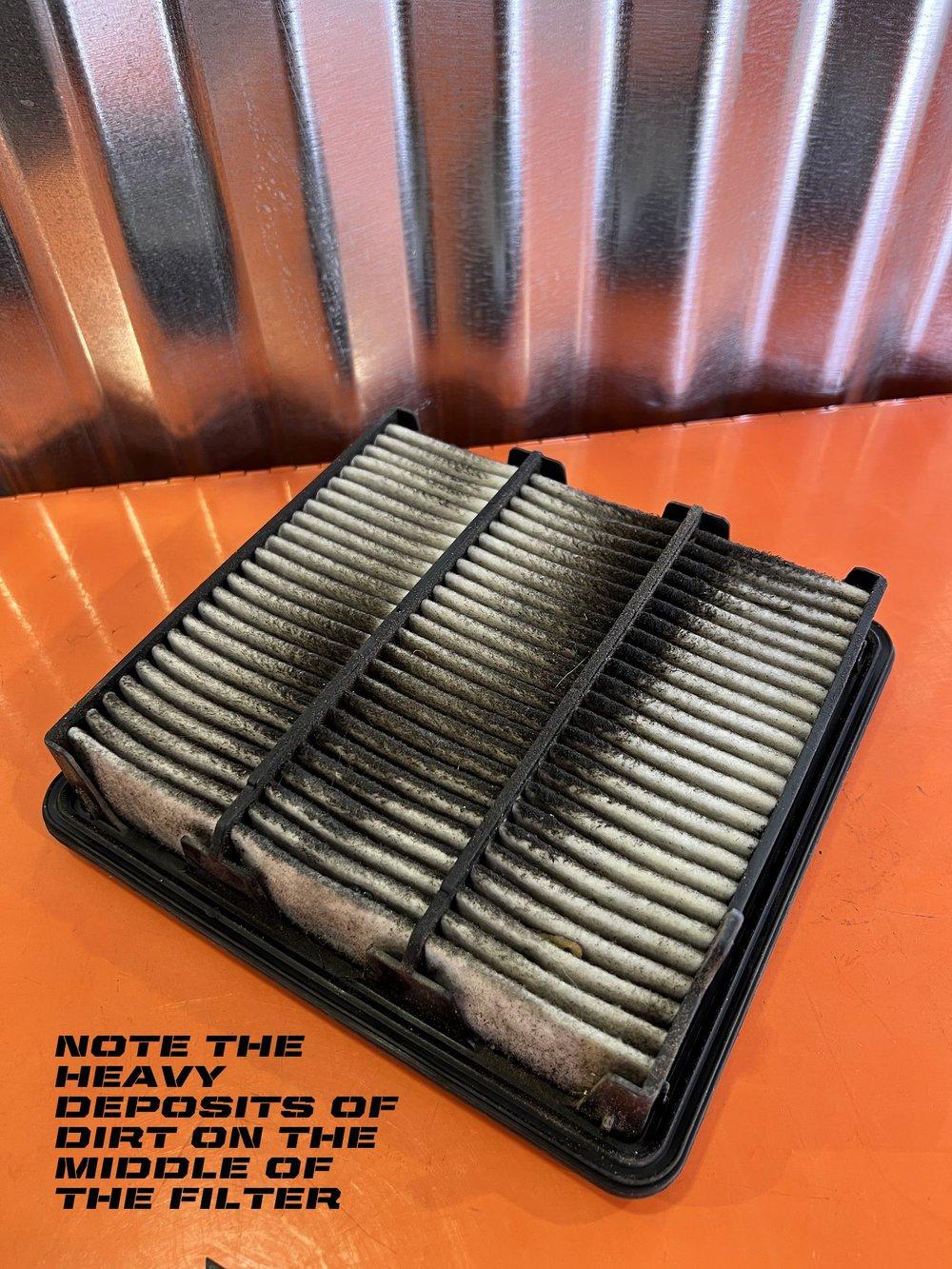

Now is it a bad intake? The answer is no. It does a great job of getting fresh cool air from one area and one area only - the inlet from the front bumper. It's nice and sealed so it won’t capture much hot air from the engine compartment that can hinder performance. But, this intake is not without its flaws. For one, the air going into the airbox comes from a source on the side of the airbox which makes the airflow not that smooth. Also, it doesn’t use the full surface area of the filter in reality and the airflow slows down considerably because of it at that point. You can see in these images of an OEM filter with only 11,000 miles on it how the dirt is concentrated in the middle of the filter.

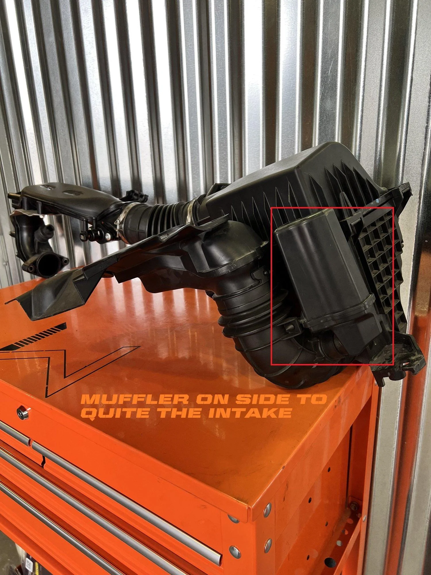

Lastly, for that ricer in all of us, this stock intake is quiet. Like, too quiet. I mean look at the size of the resonator on the airbox to take away all of those fun “swoosh” noises. Speaking of swoosh noises, let's be real here, how important is that for you? A fully sealed intake is a quiet intake. This is great for getting the coolest air possible, but you give up the cool sounds. Should we do an open filter style intake to increase the noise? Is a trade-off in some power worth the smile you get when you smash the gas? Let us know in the comments below.
