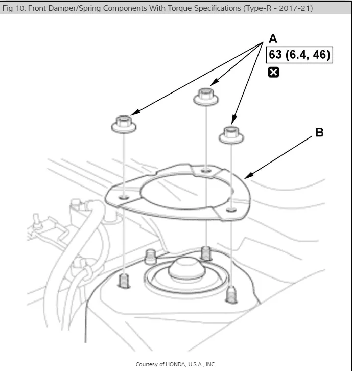

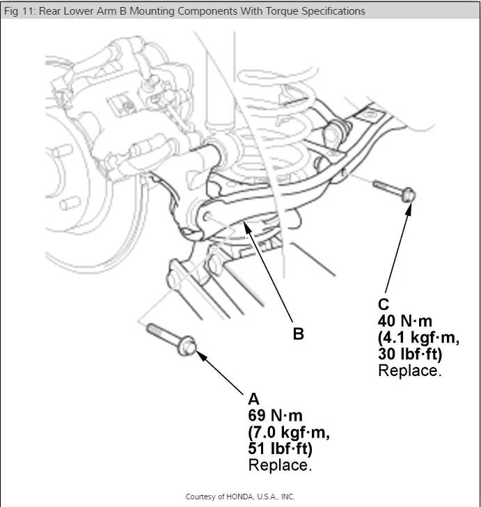

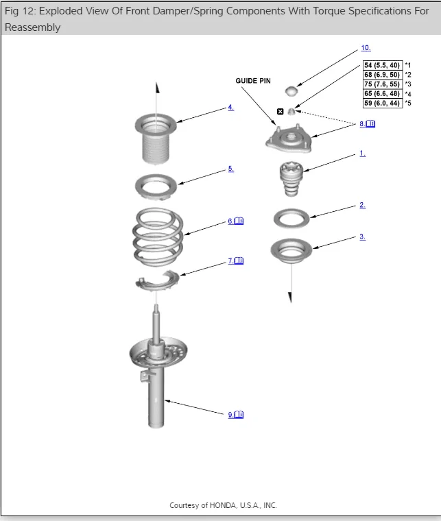

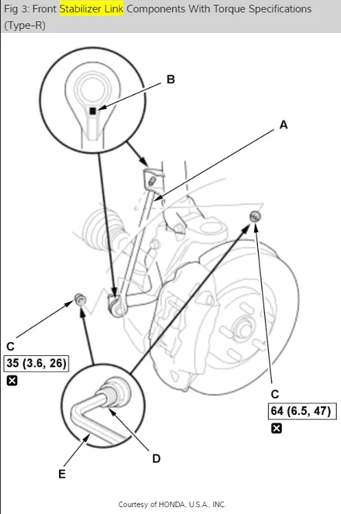

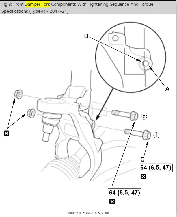

the OG way to lower a car just wondering i noticed you didnt torque any bolts after reinstall
I did, just not on camera ?
I went of FK8 torque specs since my prodemand doesn’t have the complete specs for a 2023 yet.
Attached are the torque specs, go by the 3rd number which represents ft/lbs

center nut for CTR is 44 ft/lbs
