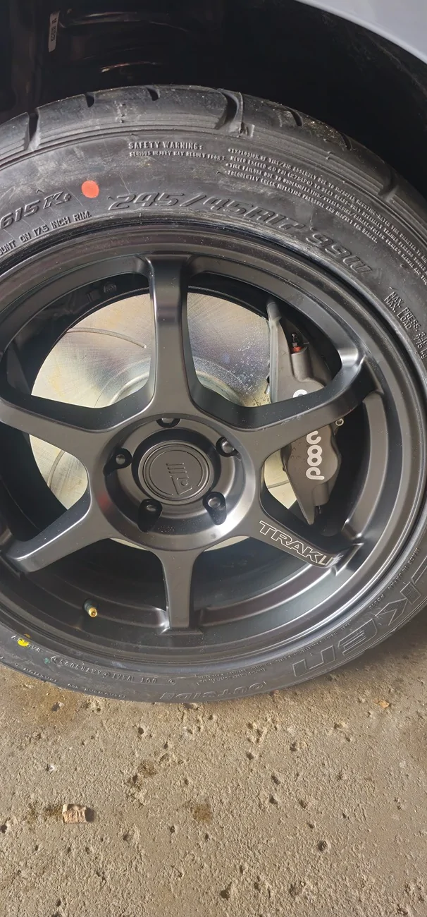

Come spring I was ready to hit the track for the 1st time! Other then the basics of tires, brake pads, and brake fluid. I was gonna leave it alone and just get seat time and learn the car. Before I could manage that though I found an amazing deal on a TSP BBK that was never installed. So I had to buy it! I mean the cost of consumables in the long run! That led to needing wheels that would clear the brakes. Decided on the 17x8.5+35 Motegi wrapped in a 245/45/17 Falken 615K+ for a cheap but trackable set up. Slapped some Porterfield R4-E pads on and to the track we went. My Local track being Blackhawk farms Raceway In South Beloit IL.
