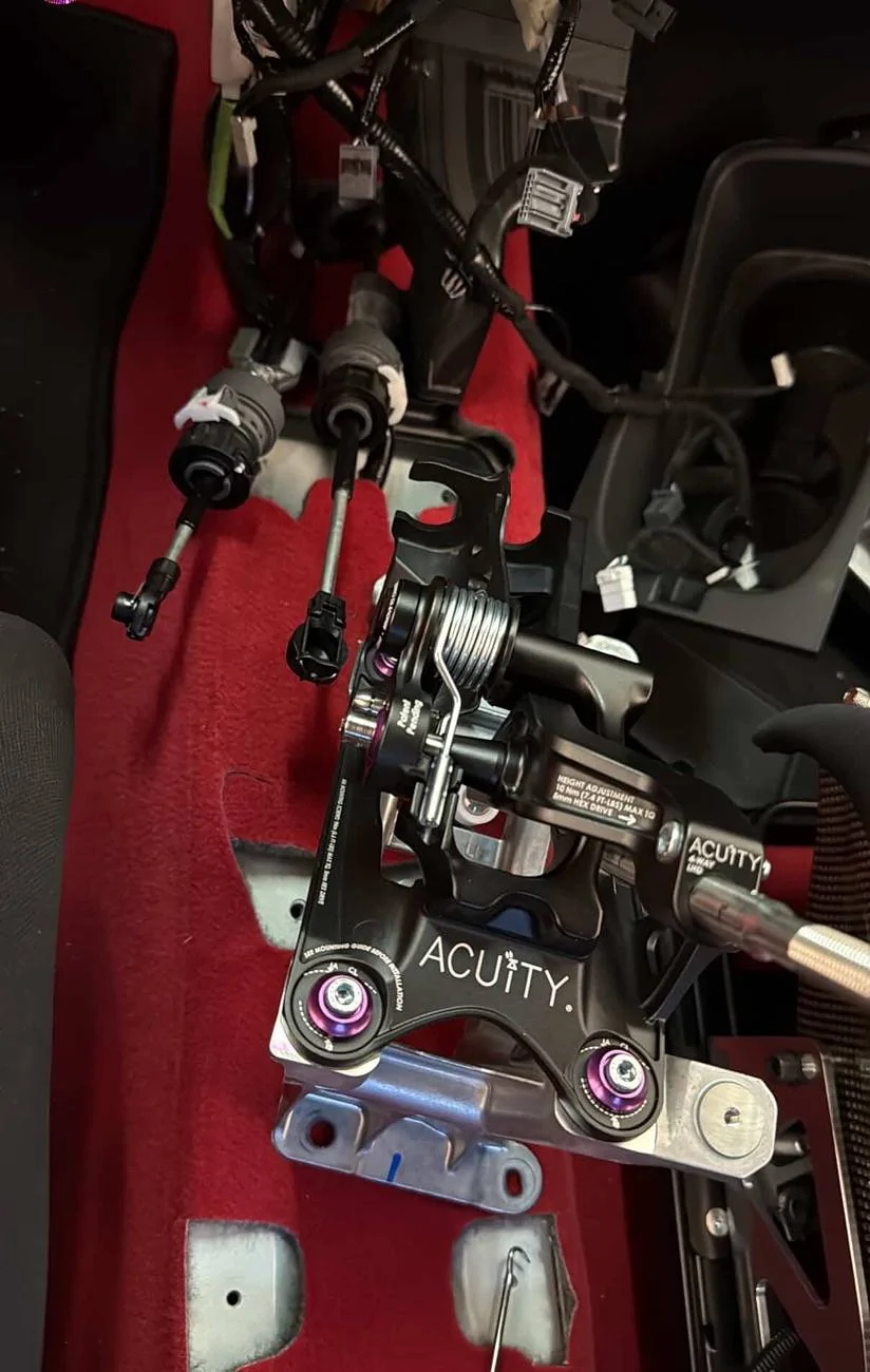

Does anyone have an idea of what settings to use to make it as close to stock throw and gate spacing as possible? I have mine on the way but want to ease into it. I had hybrid racing before but felt everything was too big of a jump from stock.
Also - anyone have close up pics of the pivot points? I don't see the traditional ball seat hinge.
See if this pic helps

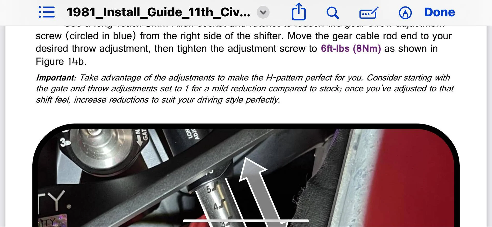

According to the installation instructions on their site, they write that position 1 on throw and gate will offer a slight reduction vs stock
