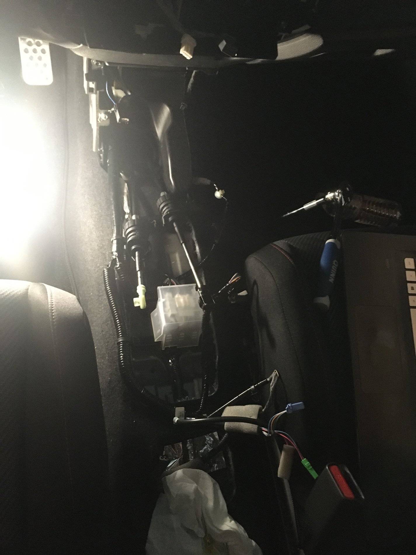

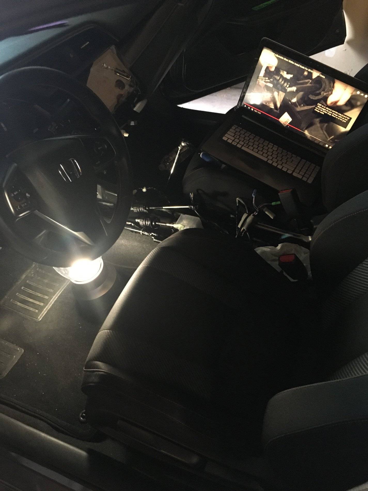

Halfway home. Taken two hours so far. This has not been easy for me, and although I anticipate reassembly being easier, without a video showing the parts I fear some clips and wires won’t be so easy to figure out (especially since I also have the console illumination wires).

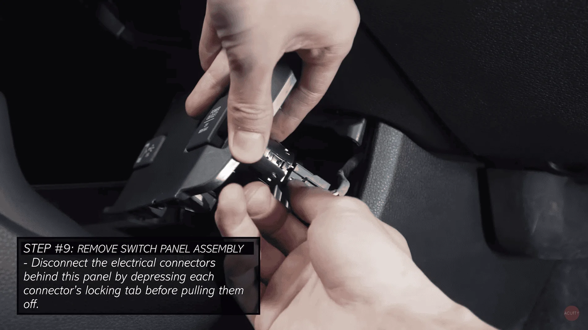

I noticed you mentioned needing a video during install. By chance, did you see the install video or console removal video on our Youtube (also linked to on our site in the install area).
Let me try to hit all of your notes below. Let me know if I miss anything. Happy to help. :)
Regarding the cigarette lighter socket, I'd pull the panel (you can do this without removing the top part of the console, don't worry) and recheck the connection. I've disassembled the shop test Si probably 50 times and have never had a clip not be able to go in fully yet, so I think this can be resolved. The 10 gens' console is pretty robust.

Thanks for the quick reply! Yes, I followed the video closely. I just meant when it came to reassembly, since the video says "reinstall everything in reverse order" or something. Yet, the new shifter doesn't have clip ports for the wires to go into, so automatically it's not going to be reverse order. Things like that.
I'll see if I can pull that part out without taking everything else out, but since I'm going to find a remedy for the shift boot collar eventually, I know I'm going to be digging into it again someday.
