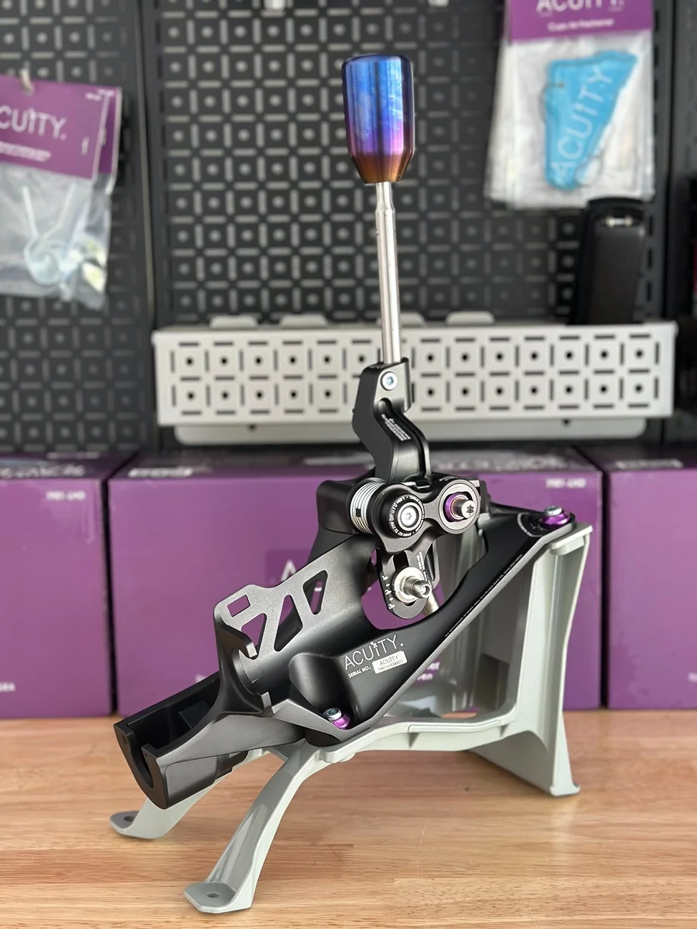

Hey Guys
We are always stocked up on our favorite shifter solution for the 11th gen Civic platform. the Acuity shifters work for all 11th gen Civic manual transmissions, we strongly suggest that you pair with the Acuity cable bushings. We rank this as one of the best mods you can do on the new Civic as it completely transforms the car to a much more sportier feel and enjoyment.
FEATURES:
  • Gear throw can be adjusted between 50% shorter and 20% longer than stock, and gate spacing can be adjusted between 35% narrower and 50% wider than stock.
  • Shift knob height is adjustable within a 75mm (2.95") range, and the shift knob position can be adjusted laterally for driver preference.
  • Centering is decisive, snappy, and quiet, thanks to a 50% increase in spring force over stock and padded spring legs.
  • Precision, self-lubricating joints for consistent, quiet operation and stiff, all-metal frame for reduced compliance and improved shift accuracy.
The shifter comes with the medium spring with option for lower or higher spring if needed which can be changed out at anytime

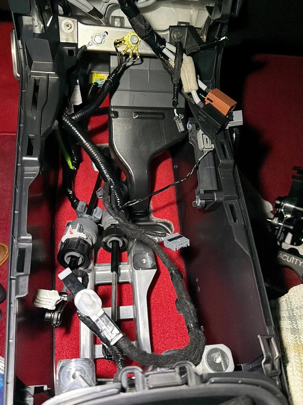

I ordered the Acuity Shifter the night I picked up my CW FL5 and installed it the day it arrived. As anyone who's installed this attests, it's the best upgrade to the OEM platform money can buy; shifting is solid, you don't have to hunt for Neutral, and you know when you've engaged the gear.
The original shifter seems to be made from nylon plastic that flexes when you shift. The solid aluminum Acuity 4-way Shifter removes any flex.
You can do this upgrade without removing the entire console. The only two pieces of console I removed were the Shifter Surround and the Upper Console Panel and their related wired connectors. The Acuity instructions have you remove the entire console so that installation is easier to access but this isn't necessary IMO.
