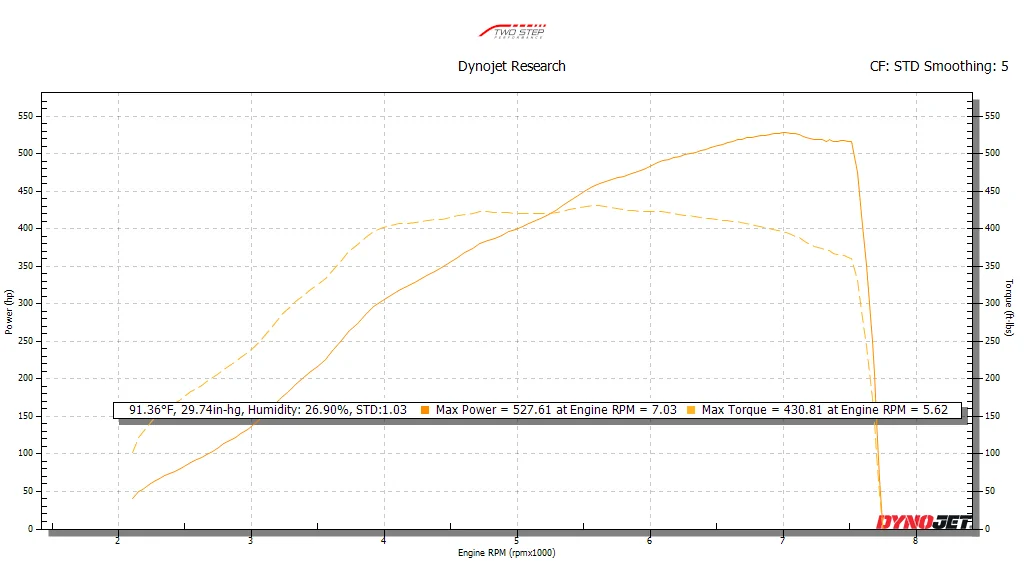

Stage 0 will hold anything that 99.99999% of people with a 1.5T can throw at it. Its the factory Type R clutch. Our FL5 with this clutch currently makes 527whp/430 ft lbs. The biggest reason to not get a stage 1 or stage 2 clutch with this kit is that you will likely encounter shift lockout at high RPM.
