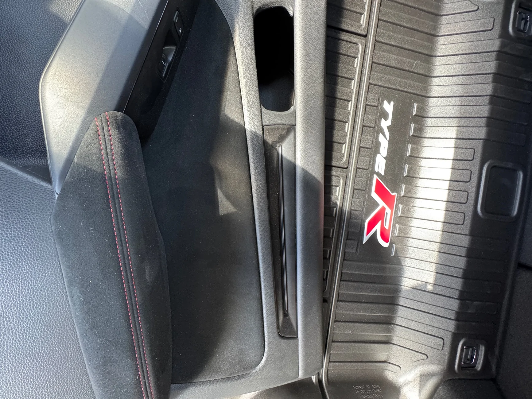

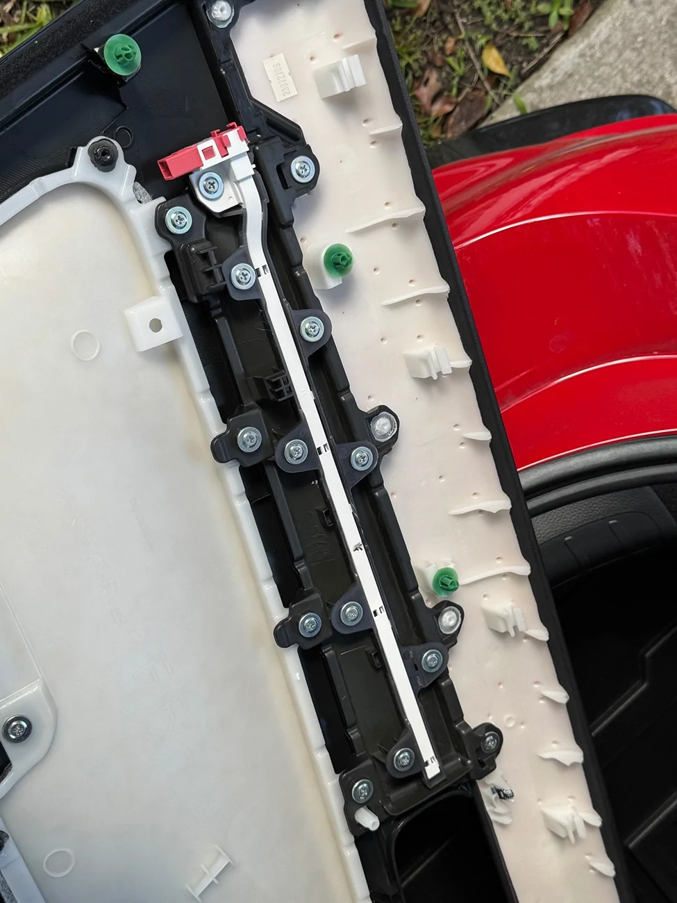

So I know this is old, but I found the front door panes locally. I’m gonna attempt to put the led strips on the rear doors,
11th Gen Honda Civic Ambient lighting strip on rear doors? IMG_8019
11th Gen Honda Civic Ambient lighting strip on rear doors? IMG_8018
