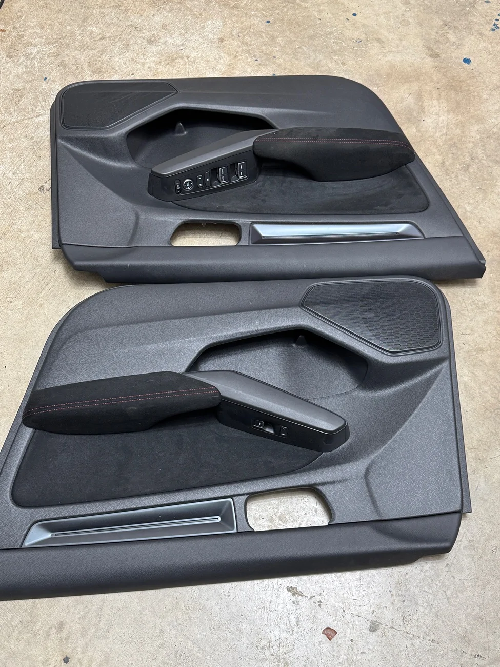

I have an addiction, called Facebook marketplace. One night before bed I came across a set of front panels, driver and passenger. You know the once’s with the led strips that look nice at night, Now why did Honda charge me 52k for this car and not include those 10 dollar leds is beyond me.
11th Gen Honda Civic Led light strips on rear door panels. IMG_8037

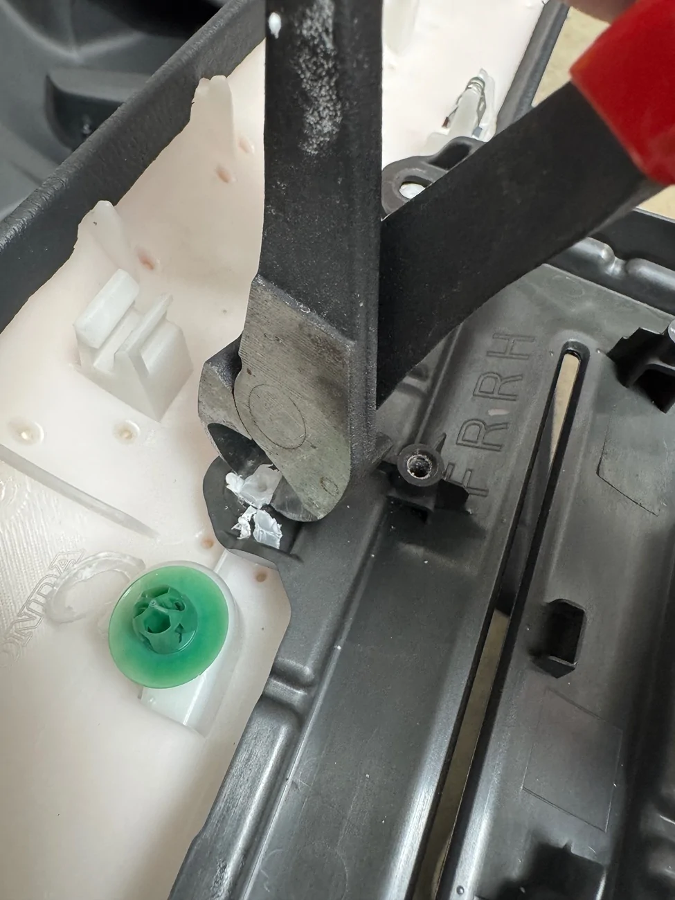

So here I am trying to attempt to put those leds into the rear passager panels. And have them work exactly the same.
So I saw someone post that Honda won’t sell you the lights without having to buy the whole panel, I think that stupid in their end.

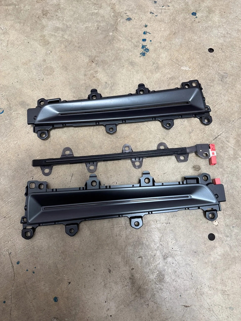

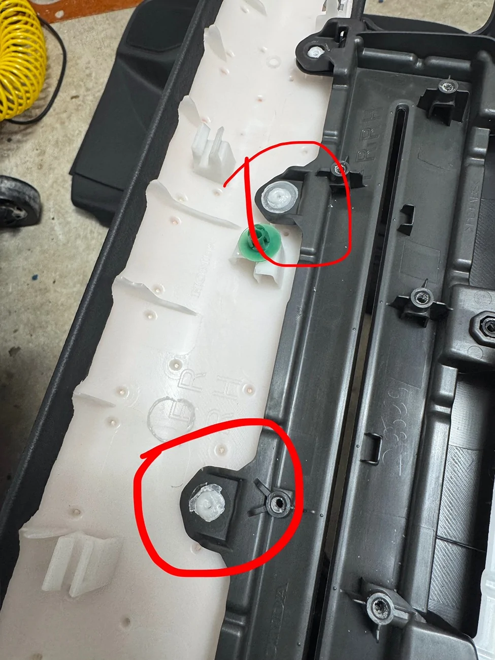

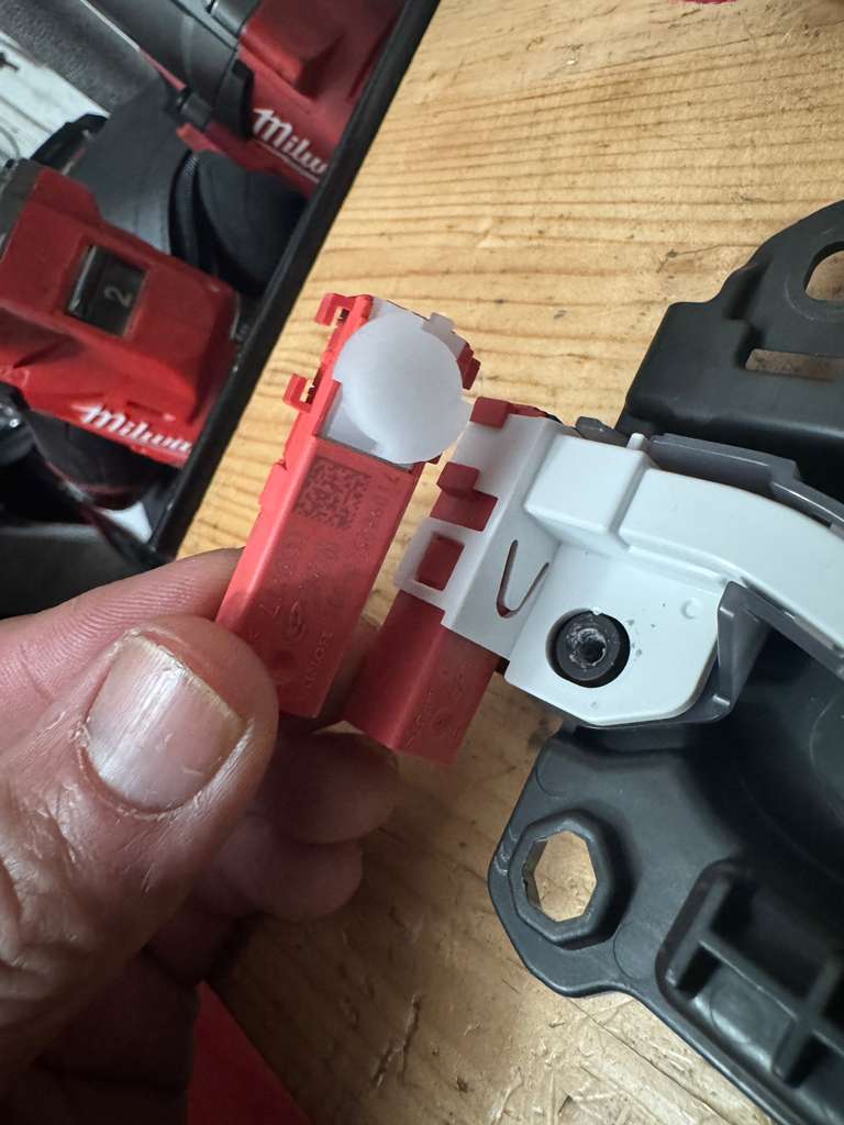

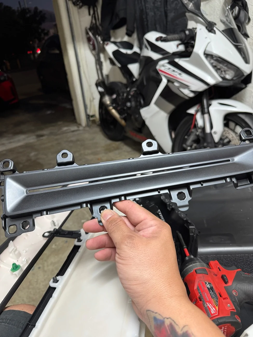

So to remove the light and its assembly it’s a bunch a screws, plus 2 tabs that you have to break.
11th Gen Honda Civic Led light strips on rear door panels. IMG_8045
11th Gen Honda Civic Led light strips on rear door panels. IMG_8046
You are left with this
11th Gen Honda Civic Led light strips on rear door panels. IMG_8049
11th Gen Honda Civic Led light strips on rear door panels. IMG_8051

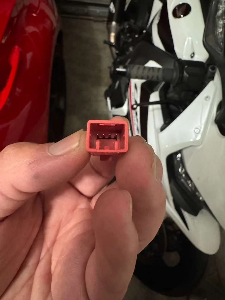

now the wiring part I haven’t figured it out. Yet I literally got them today, but this is the plug
11th Gen Honda Civic Led light strips on rear door panels. IMG_8041
It has 4 pins,

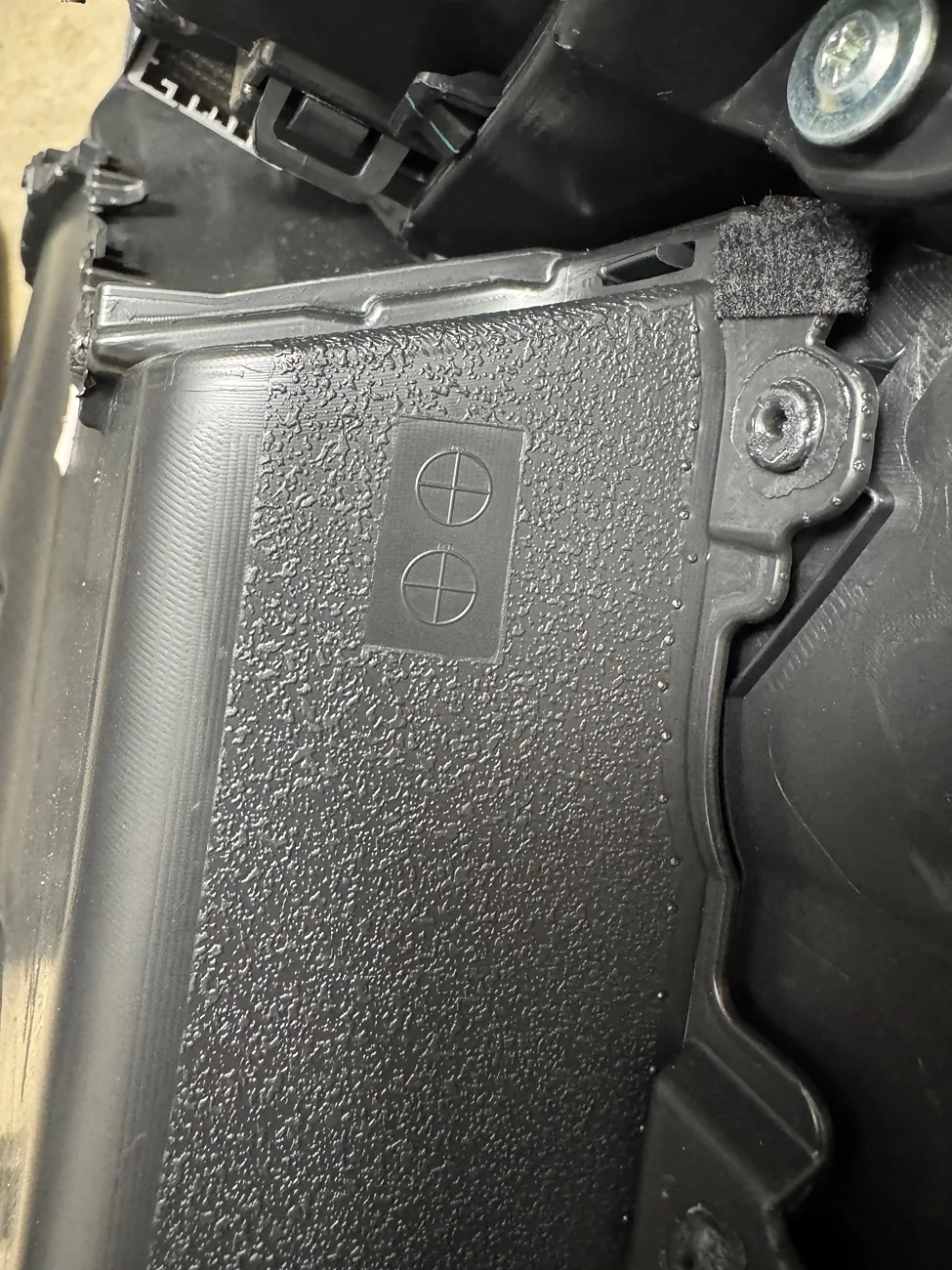

also I notice on each door panel you have these hole marks, I’m pretty sure it’s to wire the OEM pocket lights. But those things are ultra expensive so I’m gonna try to wire something else there.
11th Gen Honda Civic Led light strips on rear door panels. IMG_8038

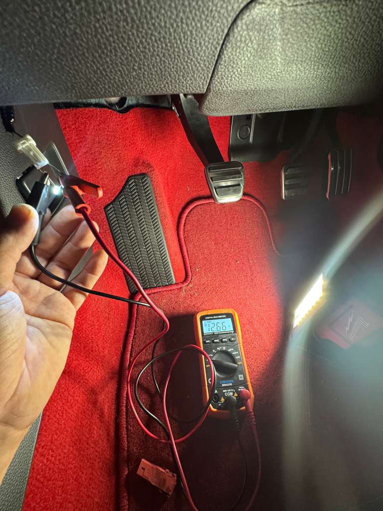

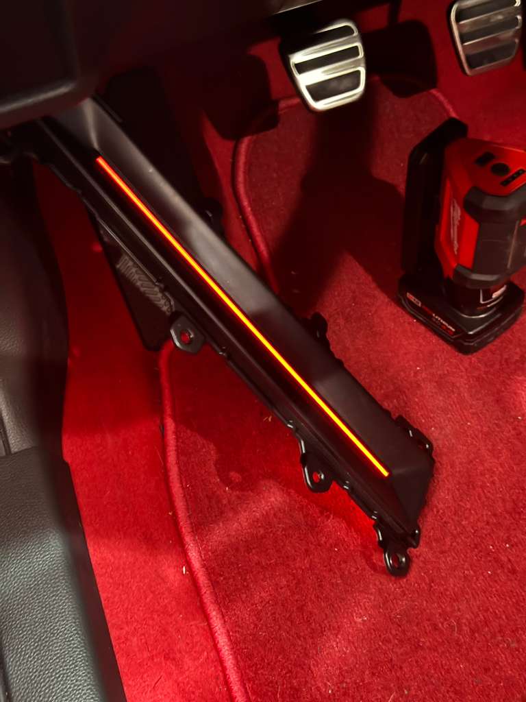

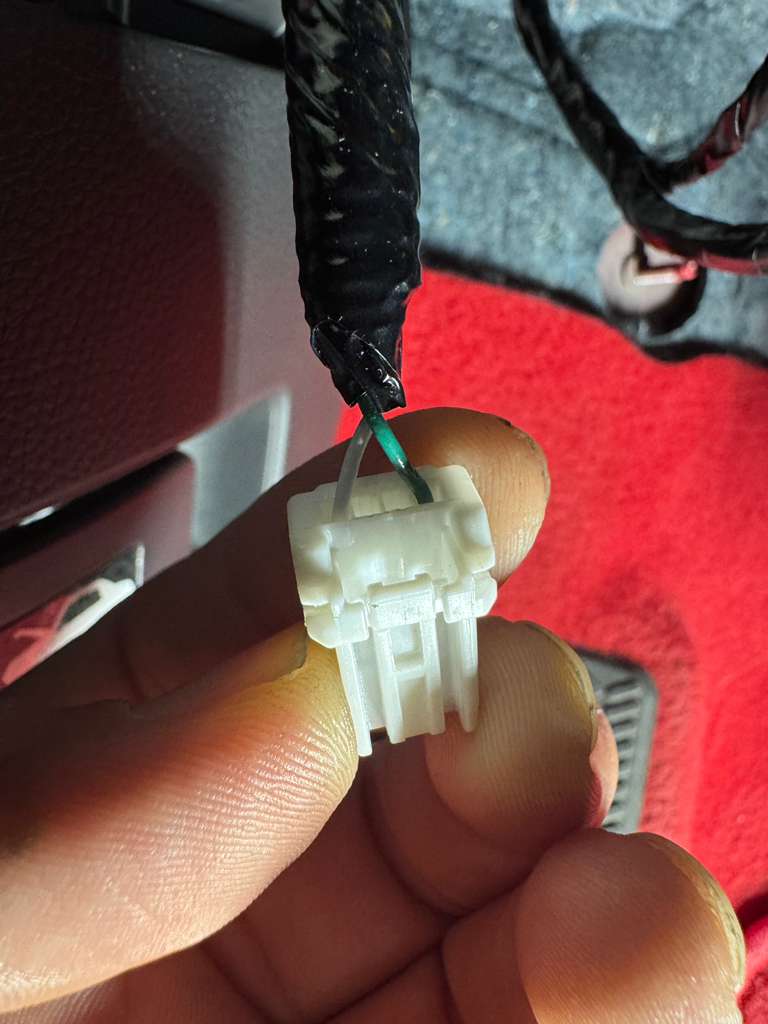

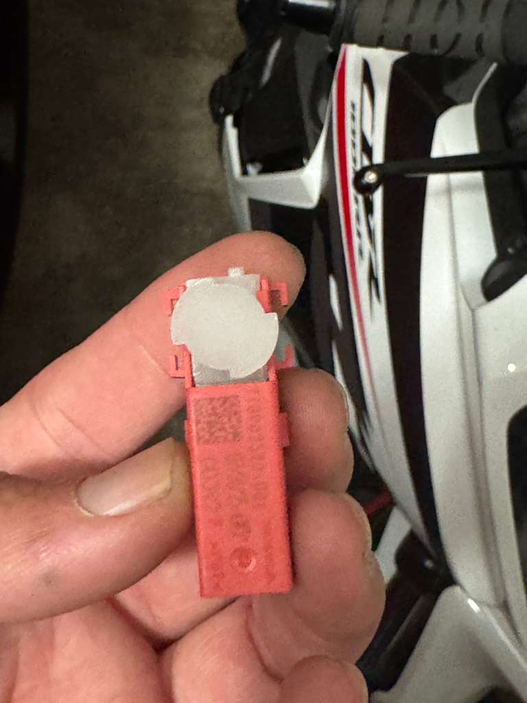

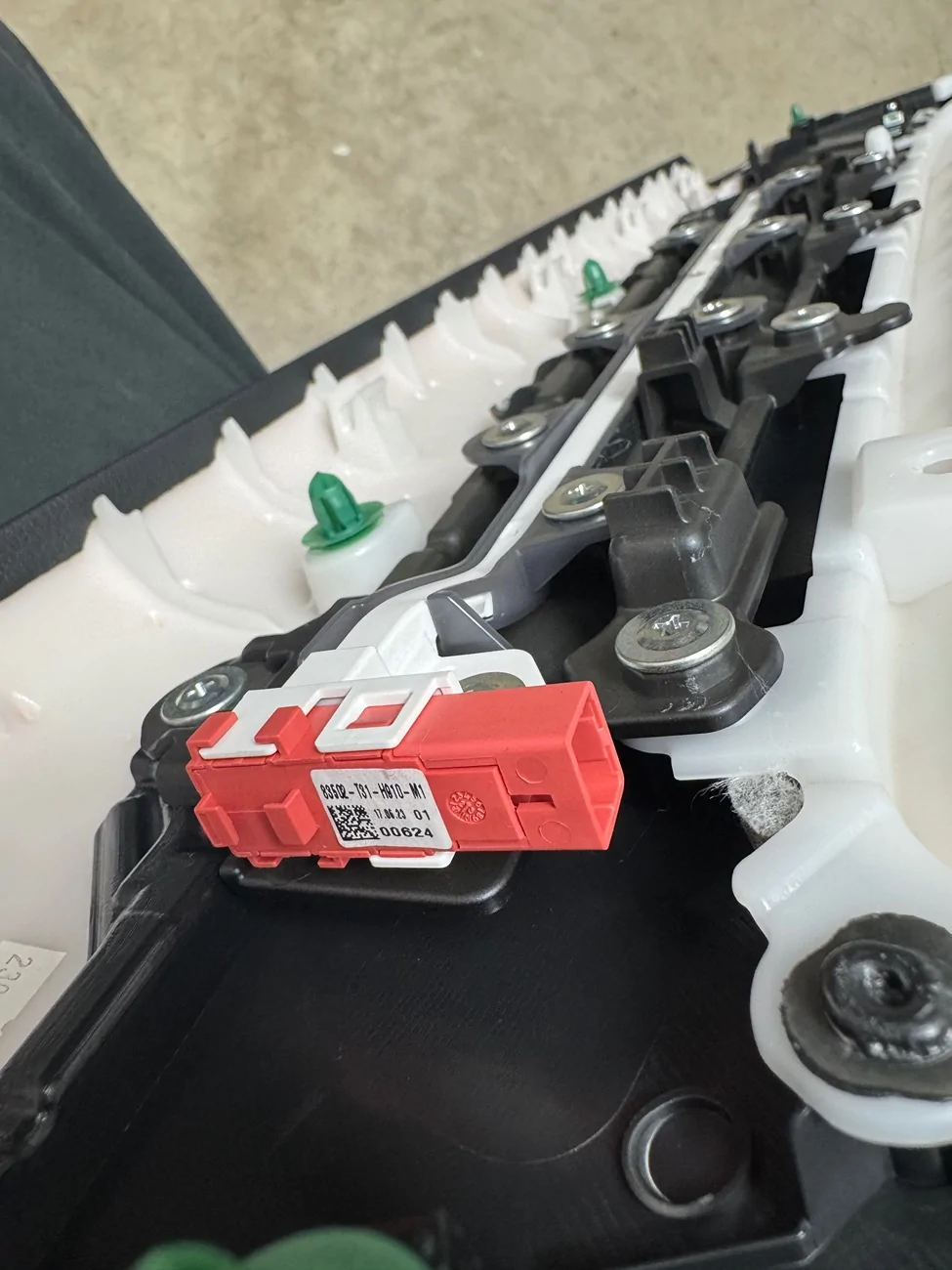

Ok so small update. The red footwell lights are the same unit as the led strips. same plugs
11th Gen Honda Civic Led light strips on rear door panels. WhatsApp Image 2026-02-18 at 9.32.35 PM (5)
11th Gen Honda Civic Led light strips on rear door panels. WhatsApp Image 2026-02-18 at 9.32.35 PM (4)

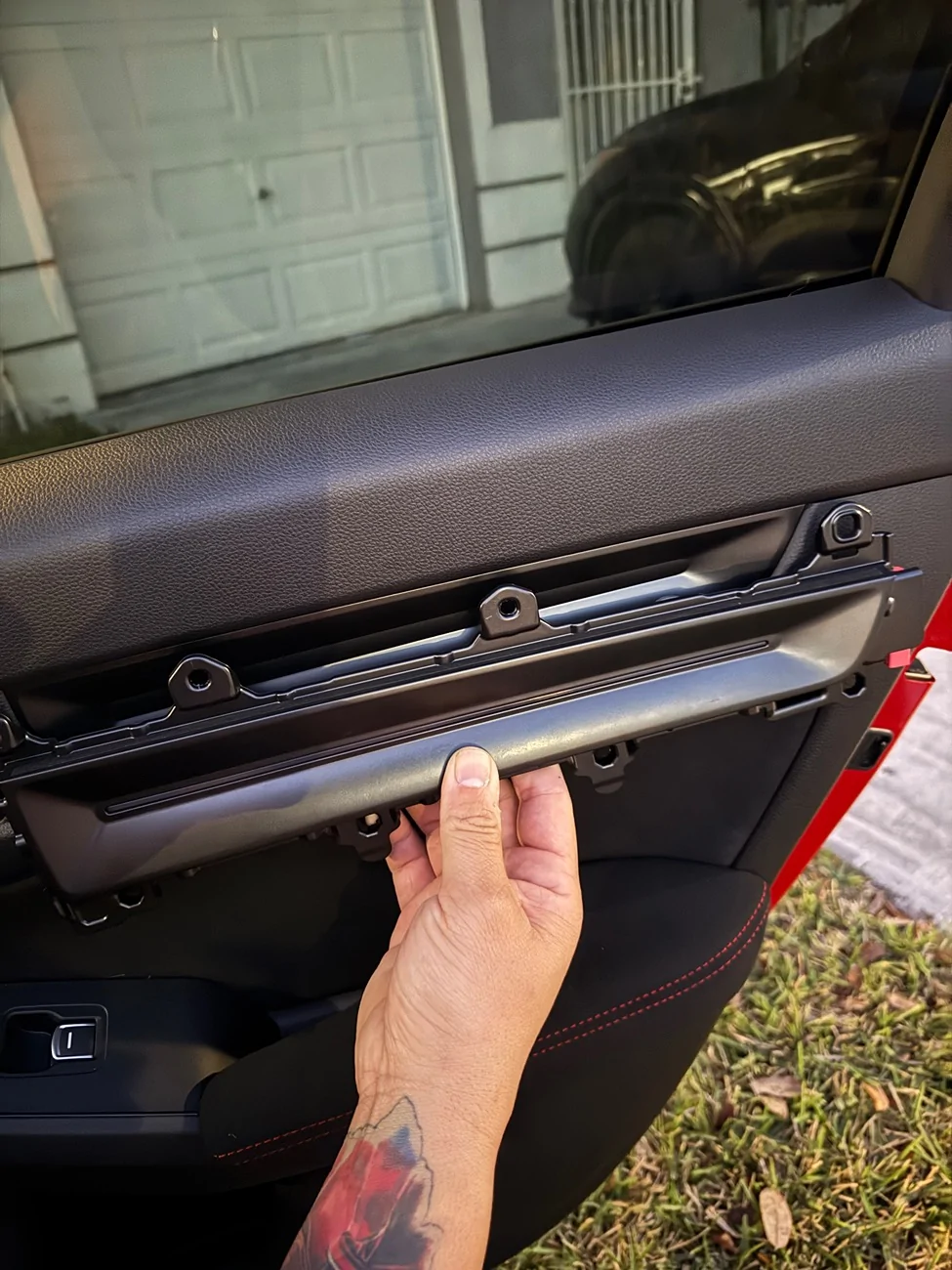

since i dont have a harness im going to have to make one, borrow power form the plug that is running the lower footwell led light. This should work and have the same on and off effect also voltage for that footwell light is 12v if anyone is curious.
11th Gen Honda Civic Led light strips on rear door panels. WhatsApp Image 2026-02-18 at 9.32.34 PM

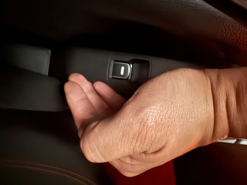

i thought about borrowing power form the passenger window switch since it lights up but i don't think it will work the same as the footwell and front led strips. wont really find out until I take apart that rear passenger door panel.
11th Gen Honda Civic Led light strips on rear door panels. WhatsApp Image 2026-02-18 at 9.32.35 PM (2)
This kind of a pain the ass just to get them lights back there but it should be worth is in the end. the led unit only uses 2 pins out of the four + and -
11th Gen Honda Civic Led light strips on rear door panels. WhatsApp Image 2026-02-18 at 9.32.35 PM (1)
11th Gen Honda Civic Led light strips on rear door panels. WhatsApp Image 2026-02-18 at 9.32.35 PM (6)
I hate electricity lol but this should not be that hard to wire into. just a bit of a pain having to take apart the door panels and run the cables.

if anyone has an idea what kind of plug that is or what its called, please let me know.

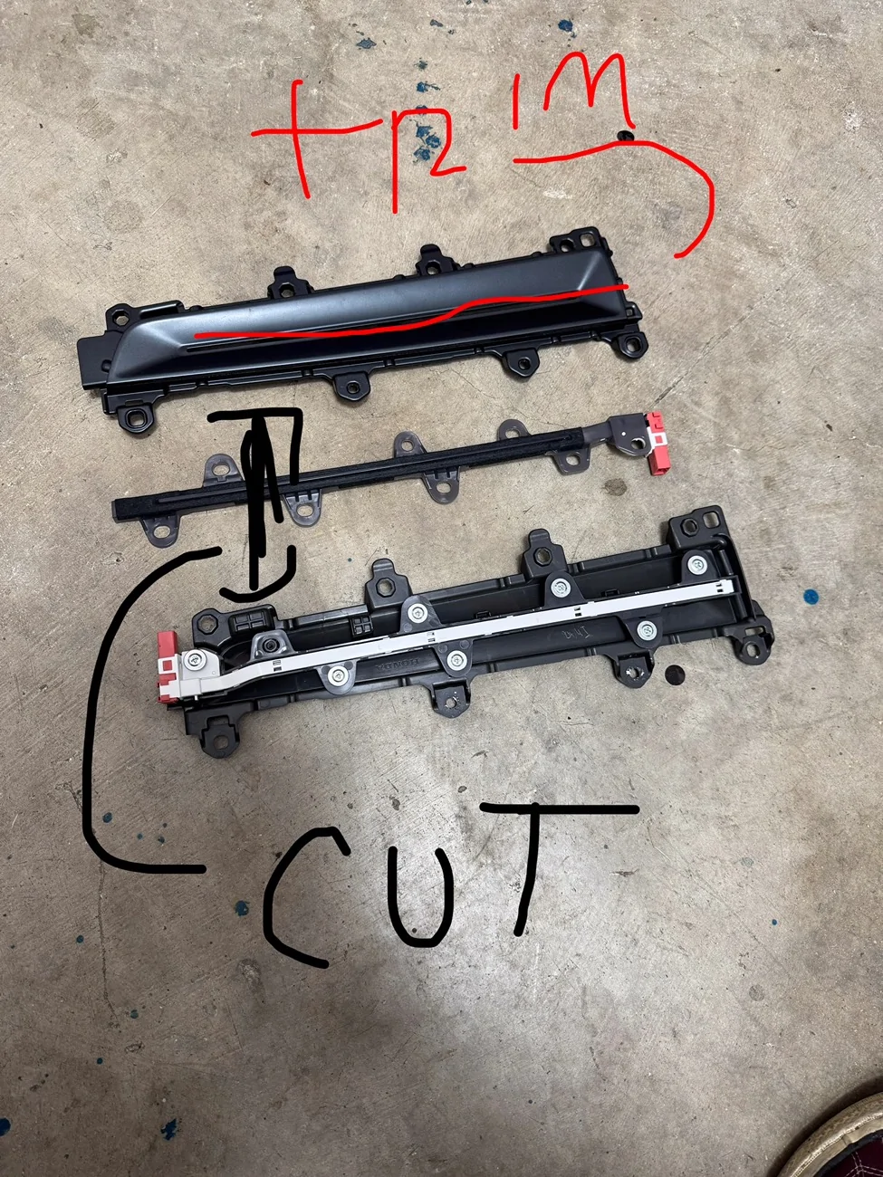

And just like that this little project is at a stand still the front panels are longer than the rears
Do you think you could trim the panel plastic? Or would you not be able to make it look good
No it won’t look good, you can trim the light piece, but I would have to make the slit on the actual piece to fit in the led light. It’s not hard, but I don’t have the tool to make that sliver of a cut. It’s a very thin line.
