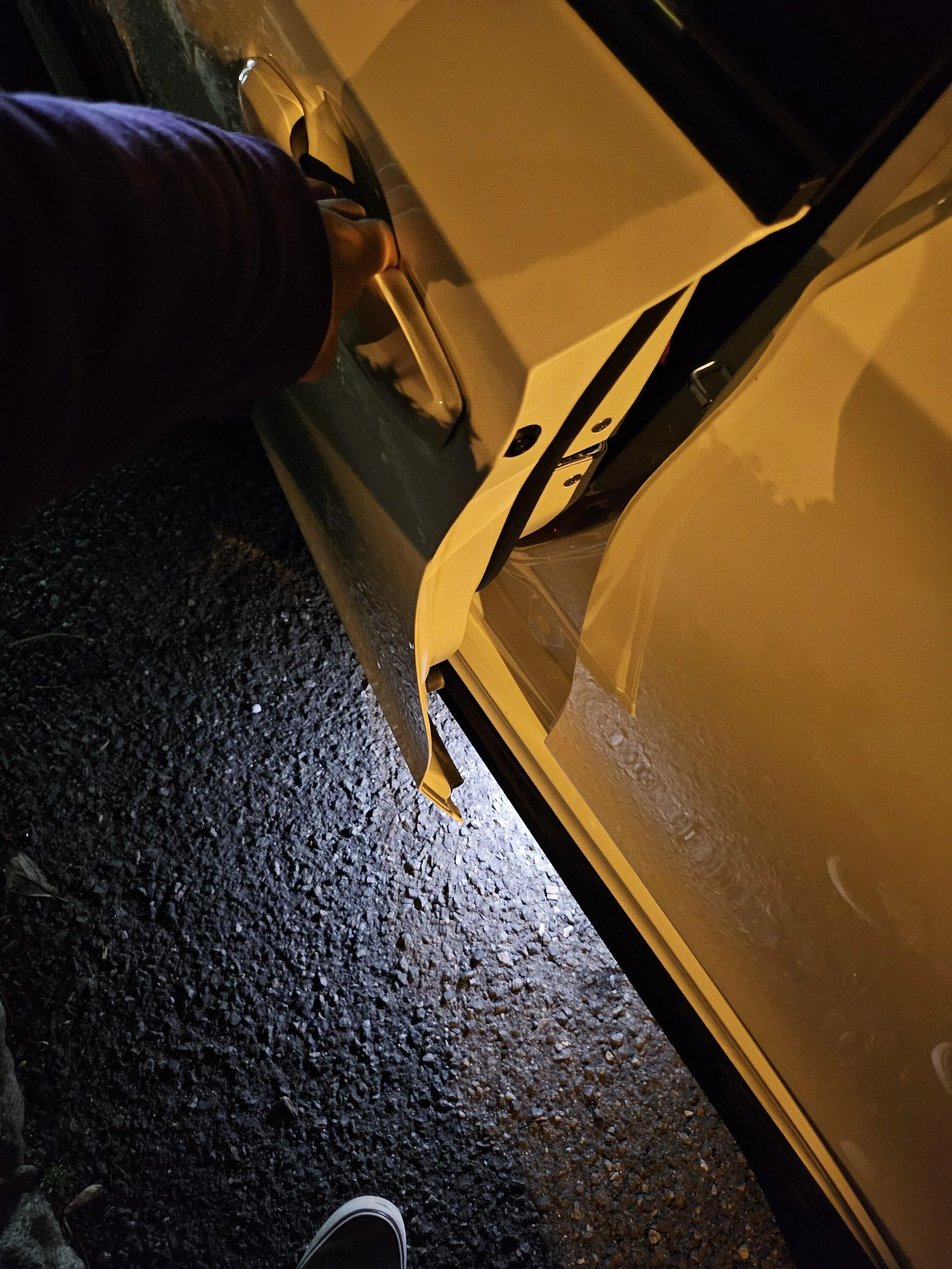

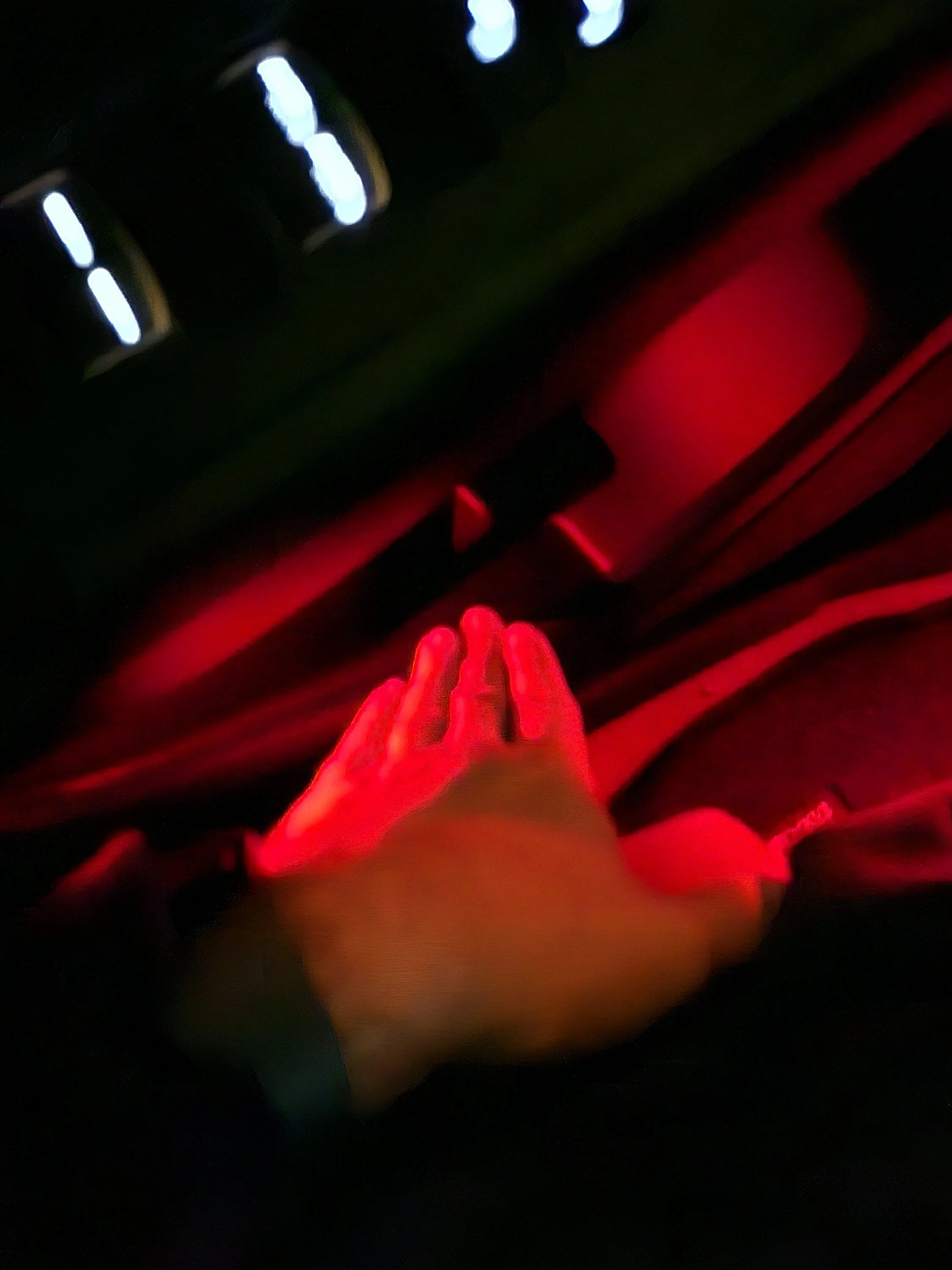

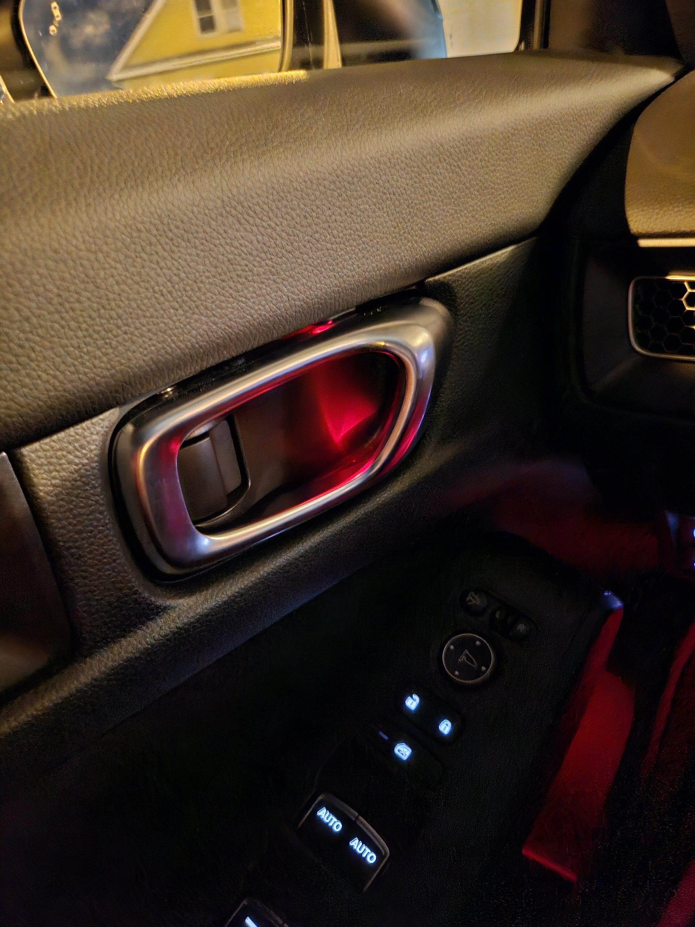

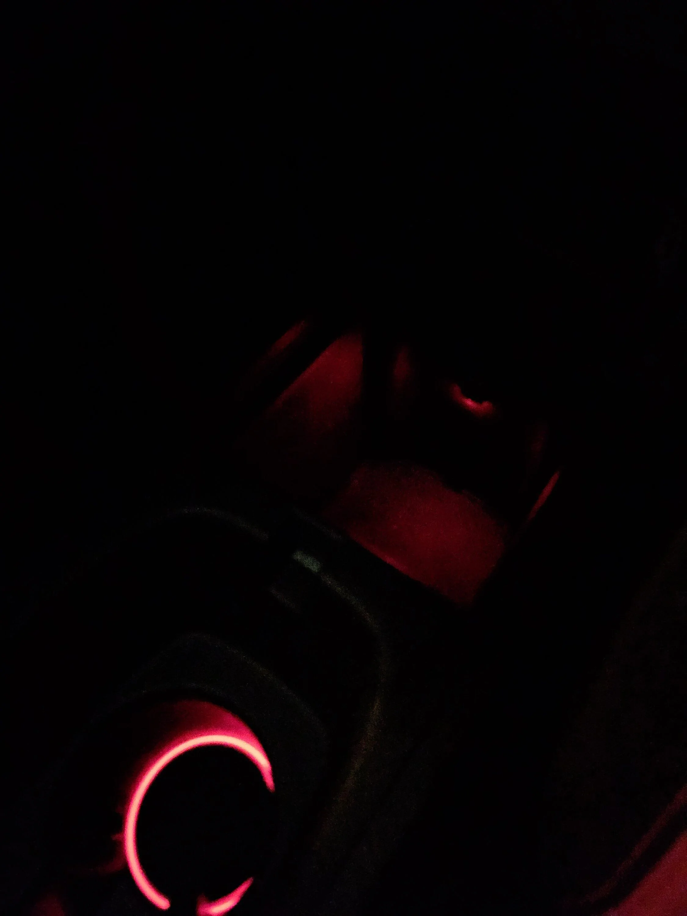

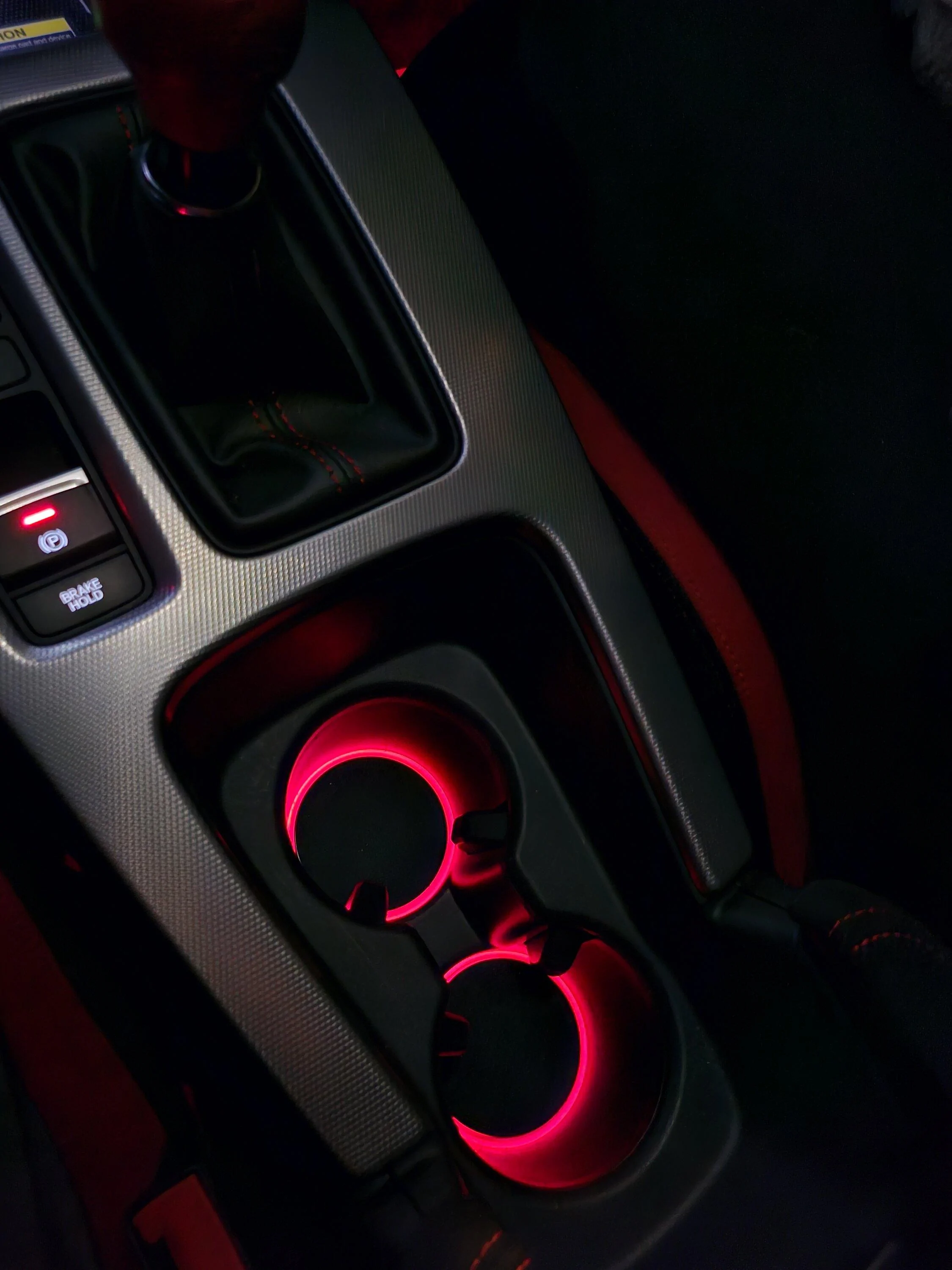

Just back from the shop again they had to wire the cupholder lights so they stay on while driving... that said the lights are super low key in person- the camera makes it seem like they are alot brighter. They do dim with the instrumdnt brightness slider- overall very happy with these. The puddle lights are great!
