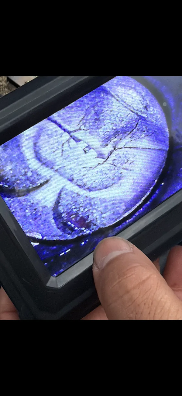

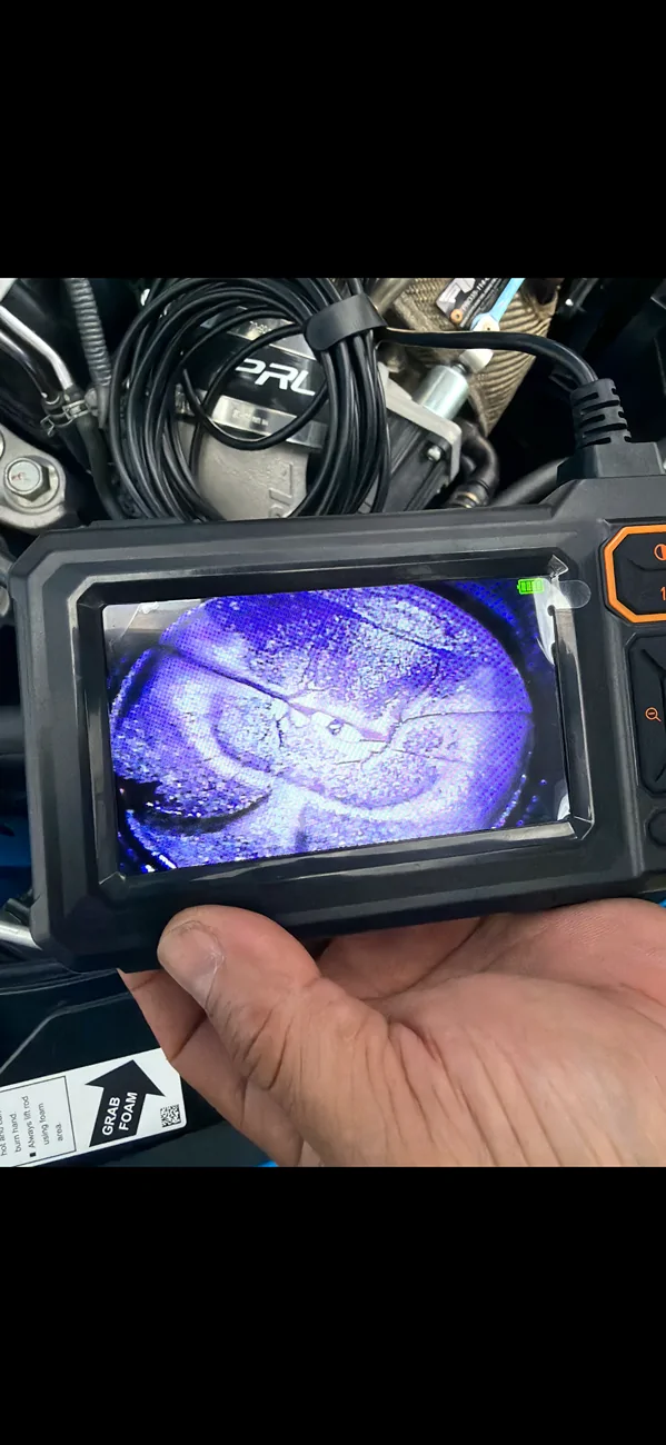

After the vehicle was tuned, the engine began experiencing issues.

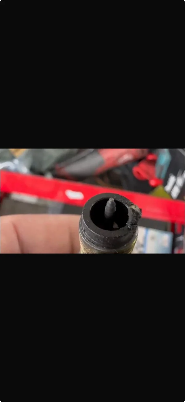

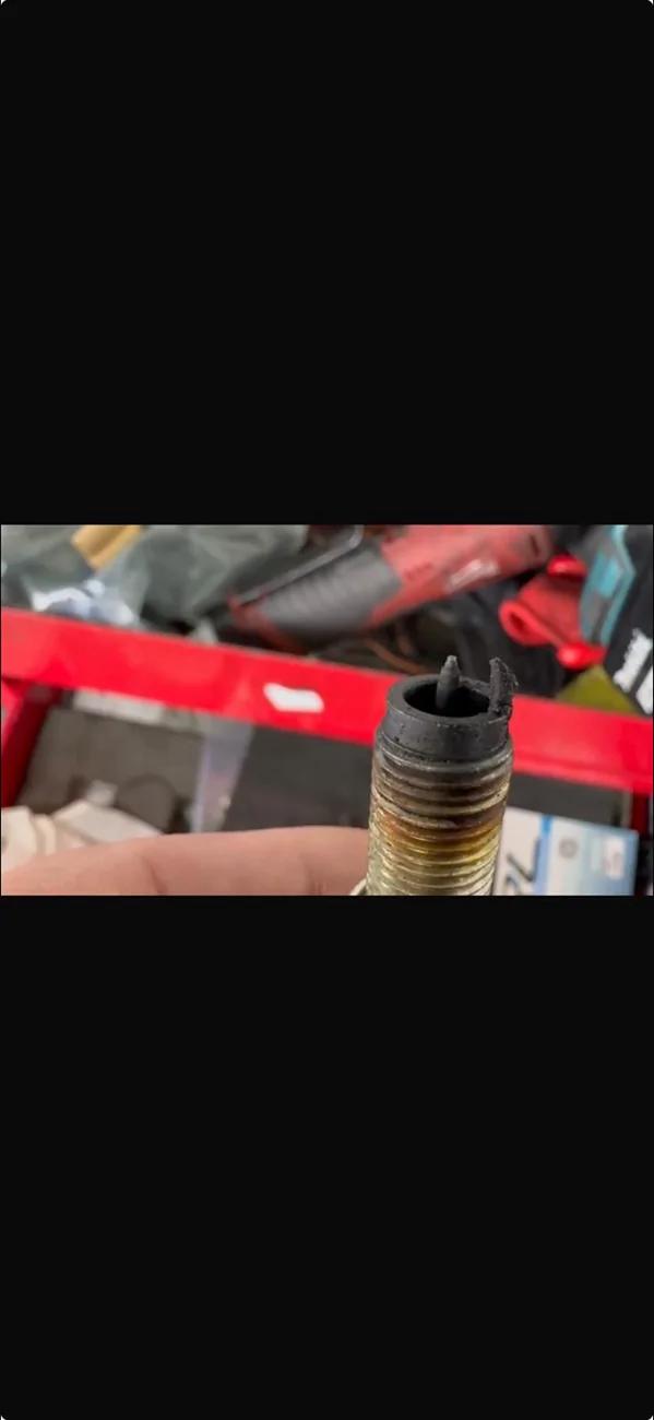

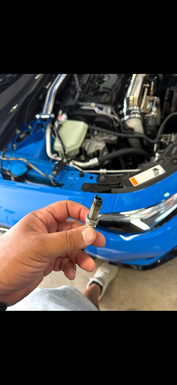

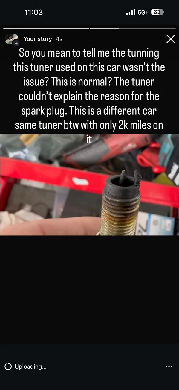

One of the major concerns surrounding this vehicle is the condition of the spark plugs. The tips of the spark plugs broke off. When the owner asked why this happened, there was reportedly no clear explanation. Alejandro from S.E.S. installed FK8 spark plugs as replacements.

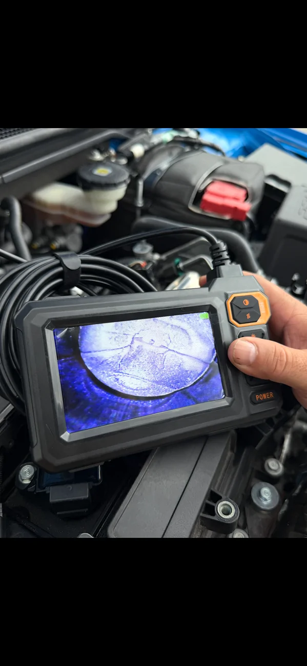

The owner later used a camera to inspect the cylinders and found light scoring on the cylinder walls. According to the owner, S.E.S. stated that the scoring was normal and not something to be concerned about.

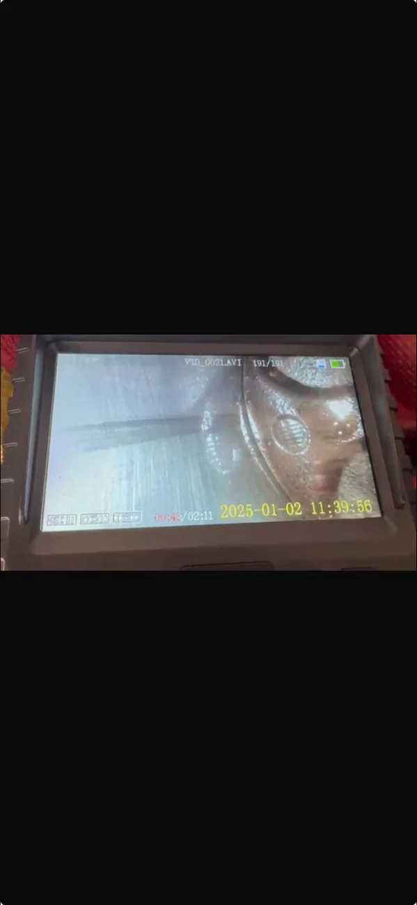

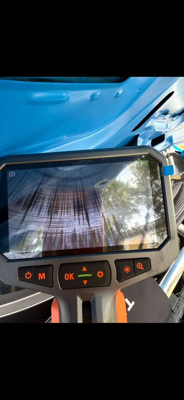

After the custom S.E.S. tune was installed, the vehicle began smoking and consuming an extreme amount of oil.
The spark plugs were inspected, and once again, the tips were missing.
A camera inspection of the cylinders showed significant scoring. Compression testing was also performed, and the compression numbers were inconsistent between cylinders.

S.E.S. then provided a revised calibration. After that, another set of spark plugs lost their tips, followed by misfires and additional issues.
